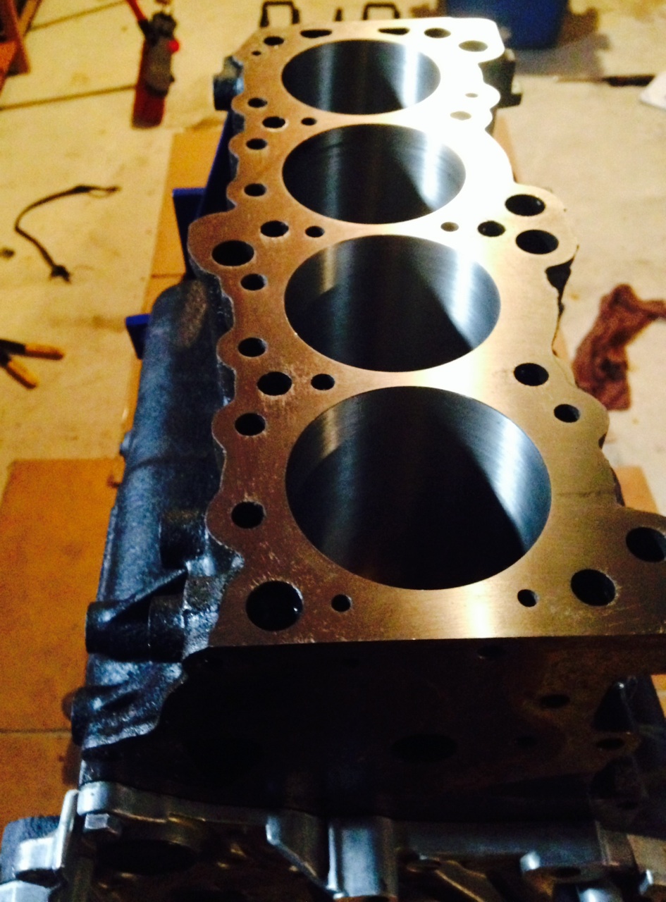

Well the harness is done until I can get the engine back in, I think it turned out looking awesome, now just hope it all works properly.
Measured the oil clearances and they are very tight, but within spec.
Picked up a new block as well thanks to John (pushit2.0). Smoothed out the oil galleys and de-burred it to all my tools could reach, thanks man!
Going to run ARP on the rods/ mains and head studs as well. Still debating the regular ARP, H11's or L19's. Also thinking of running a Kiggly HLA Pressure Regulator any opinions? (will be running lots of boost)
Will also be grabbing a 2g head from Tyler here soon.
