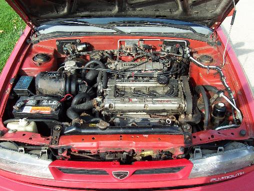

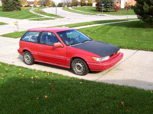

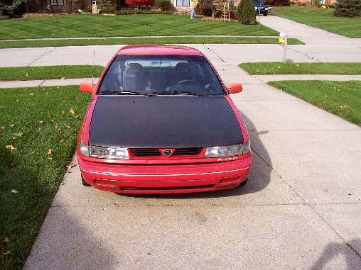

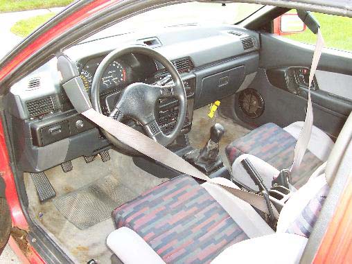

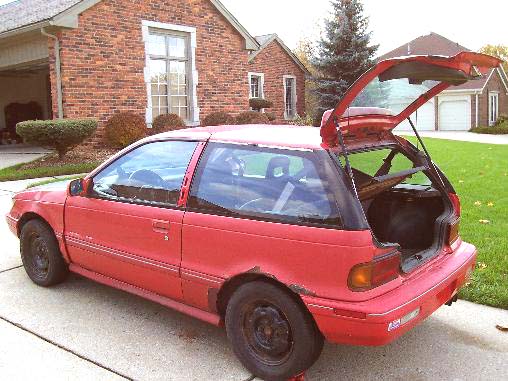

I put a deposit on this last week. It's in Detroit. I should be heading out tomorrow evening to go pick her up! I'm sure most of you know what this is already, so no need to go into details. It's bone stock. Doesn't start though.

timing belt, fuel pump, transistor/coil pack, ecu, spark plugs/wires, you get the idea.

Yup. He said it cranks, says it has a spark, has compression. So it's looking like fuel, or some sort of bad sensor somewhere. He says it doesn't even hiccup like it wants to start, it just cranks. When I get it, I'm going to go back over everything. First thing I'm going to check is the timing belt. Then crank it and recheck compression, spark, and make sure it's getting fuel. If it's getting all that, well then that'd lead me to believe it's not getting the correct mixture of air/fuel, and I'll probably hook up a logger, start going after different sensors.
I figured with him saying it cranks and has good compression, well I can work with that for $675
