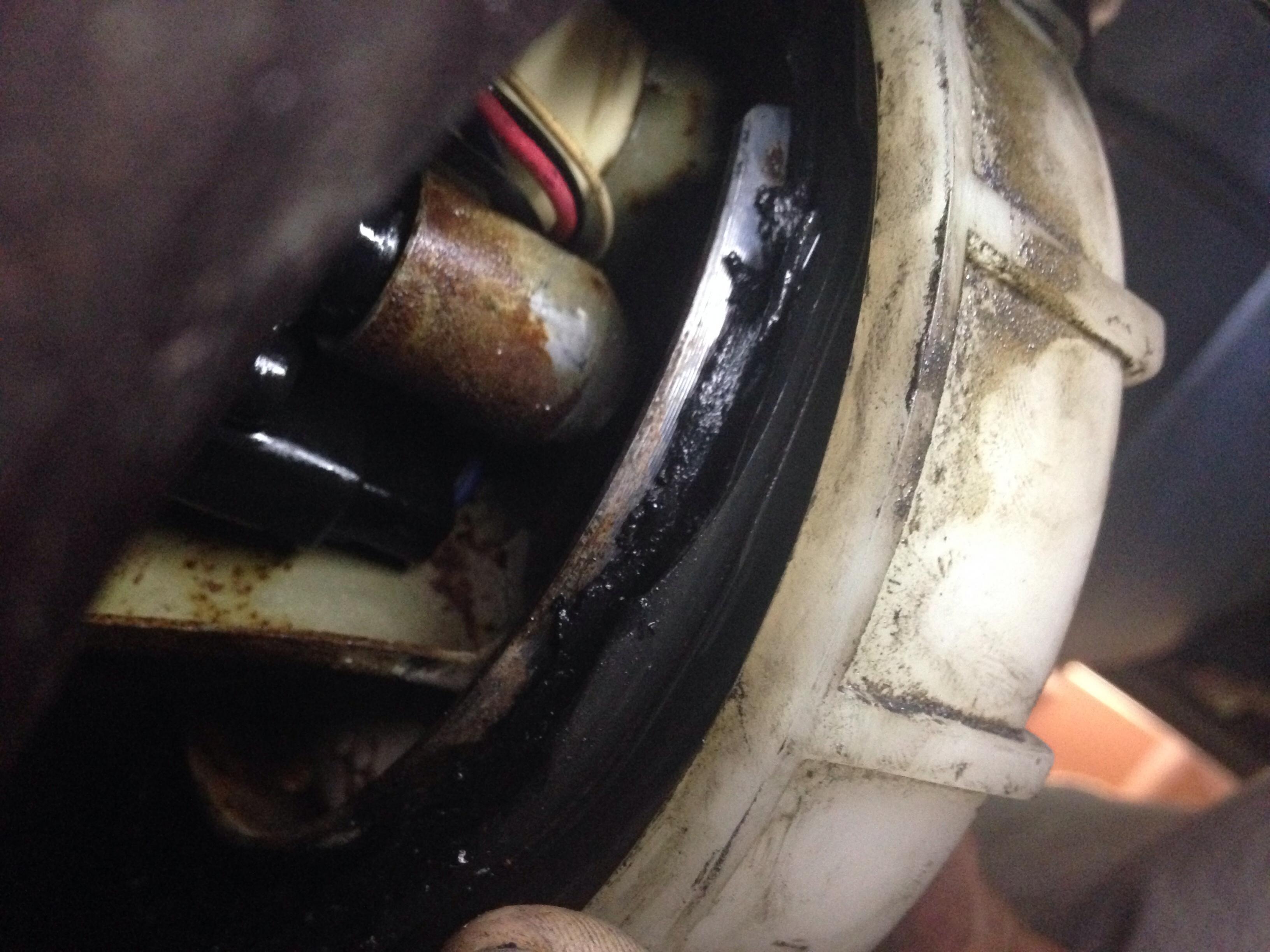

Turned out that it is completely saturated and torn up pretty bad. I did Read that they could be tricky, so when the new one comes i'll be sure to take caution.

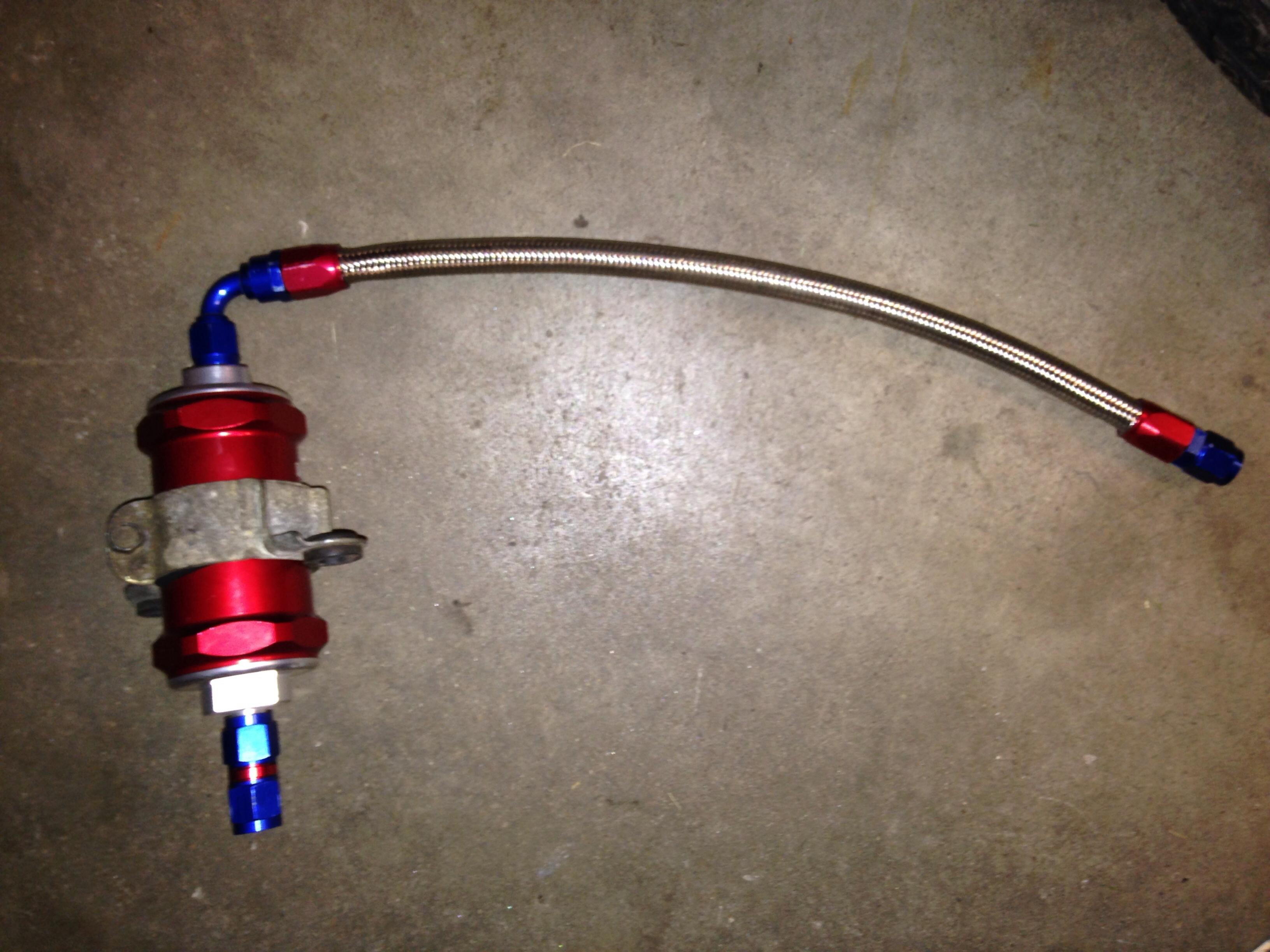

Anyone have a tank to filter line with a male -an fitting?
or
A fitting for the fuel rail -6 AN (For the inlet, not sure if it matters)http://www.streettunedmotorsports.co...l_fittings.htm
Going to be putting this in with it.
