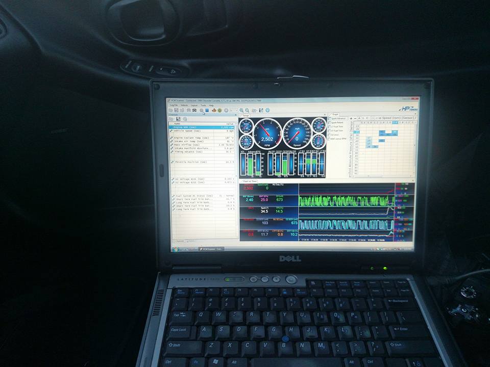

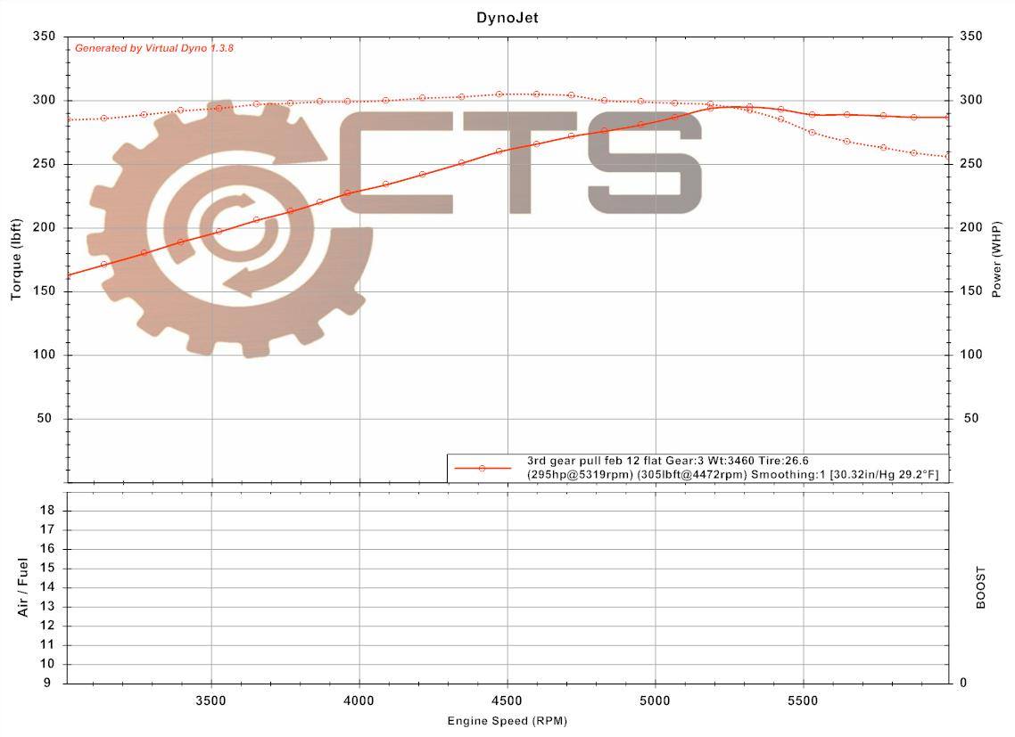

Switched out all the lights as the stock ones were garbage. Also got in some base pulls today.
Car feels strong and flat, virtual dyno logs confirm.
Now to wait for the rest of the parts to come and the snow to go away, I am curious to see what I can get out of it. Ideally another 10-15hp, will see what the tune unlocks and the upgraded power duct I have sitting here.

Car looks great, but I'm confused on that dyno chart. That was a virtual dyno sheet, yet it stamps it as being from a dynojet?

It's basically saying that it's reading equivalent to a Dynojet, in theory.

I see the virual stamp in the upper left now.
Otherwise I was going to say, seems like a gateway for any kid with a laptop now to make their own fake dyno graphs and passing them off as actual ones.
"FS: 800hp Camaro, dynojet sheet provided!!!" (**but actually on a virtual dyno with car weight set to 8000lbs and 25" wheels**)

It already runs rampant on the Evo forums. People claim huge numbers using these fake, easily manipulated, "dyno" charts. There is one remote t00ner in particular that is notorious for this. He'll ask people what their goal is before he starts tuning them and at the end makes sure the chart exceeds the customer's expectations. The best is when said customers then go to a real dyno for a dyno day or whatever and get all bent out of shape when they're down on power by about 150whp
It's a decent tool when setup and used properly. The weight of the car + driver has to be entered accurately (which it appears Swanny did), along with a few other parameters, and making sure the road is perfectly flat without any strong winds. It's best to use the same road each time to create a legit comparison.

Easy to fudge numbers on this software or a real dyno for that matter. It's a tuning tool and as accurate as the end user. I've actually worked with Brad a little bit on some development of car information and have used this software since 2011 I think?
I weighed the car and if I were to throw it on a dynojet I'd expect it to belt out 300/300. Hoping I can get it to 325, time will tell.

Agree if you have good inputs you can get good/useful outputs, not denying that at all. And also agree you can fudge numbers on an actual dyno too. But not every kid has access to a dyno and access to tweak it. And those who have invested in / purchased an actual dyno I'd imagine are less likely to throw garbage info around like everyone does daily on the internet. Every swinging dick has a laptop though, guess I didn't know it was already a prevalent issue in the Evo community. Guess I need to start looking at these charts closer lol!
Anyway, sorry didn't mean to redirect your post here lol. I'm sure you're using it properly and as a tool. Car looks great man!!

No worries man! I always like a good discussion, this is as good as a place as any.
It's a solid tool for the diy crowd. Ideally it is used at a drag strip so the diy individual is being safe and repeatable. Plus you'll see the change in mph to validate any inputs.
I've tested this on cars from 300-900whp, numbers always check out if your inputs are spot on.
