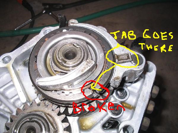

OK, well I got the new 1-2 and 3-4 forks today. I ordered a new 5th gear fork. There were 2 different ones the dealer had. I just picked one, hopefully it's right.
Jet I figured out where that tab goes that you were talking about. But this little ring thing is broken. Is that called the selector ring? I guess I'll have to put one of those on order too.

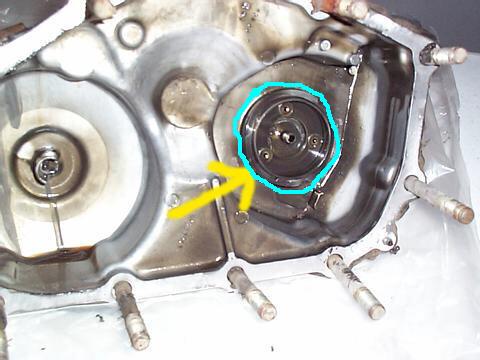

Also, VFAQ mentions this spring. My tranny does not have this spring. The whole little dealy that is surrounded by the turqoise circle, i do not have. What's up with that? Anyone know what it's called so I can order it?

I would go perpendicular and above or below a good amount. I don't know if I would mess with it though. The holes are actually what make the fork weak. Adding more will probably just make it worse. I would put a smaller pin in if you do it.
That broken piece is the slider or selector ring.

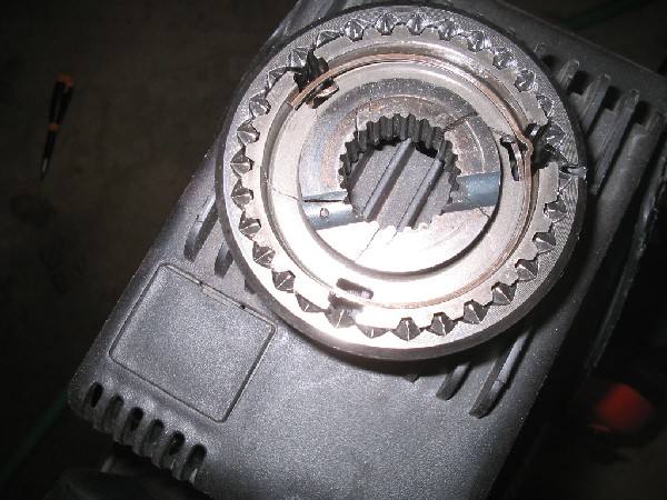

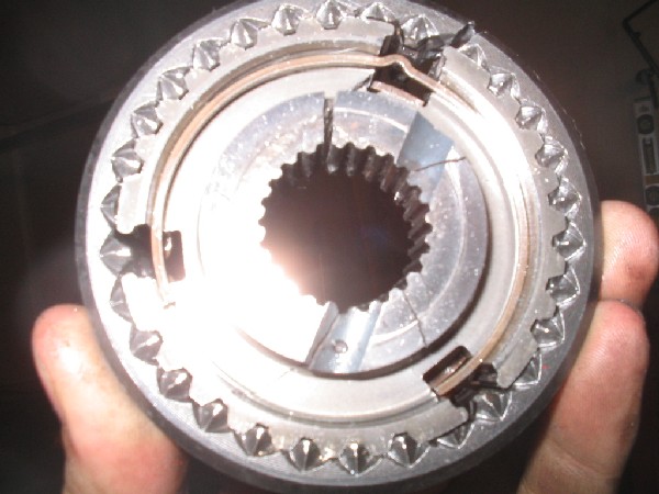

More pics to show the carnage.
My trannies outcome...
-broken 5/R fork
-broken 3/4 fork
-broken 5th gear slider AND gear
