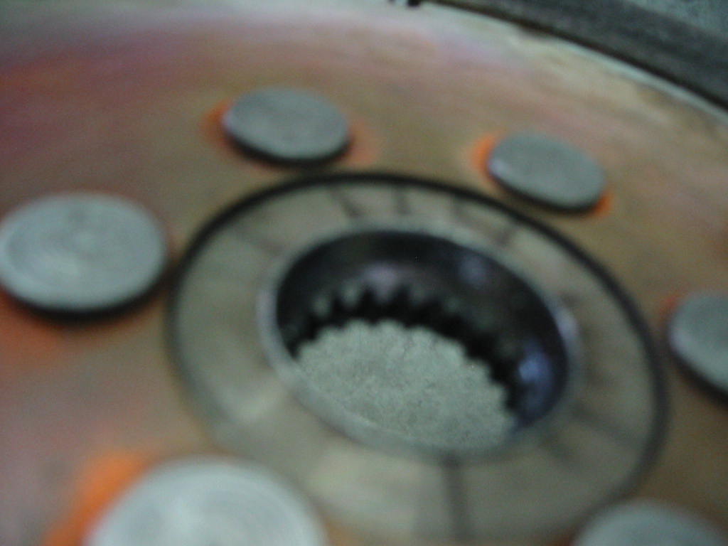

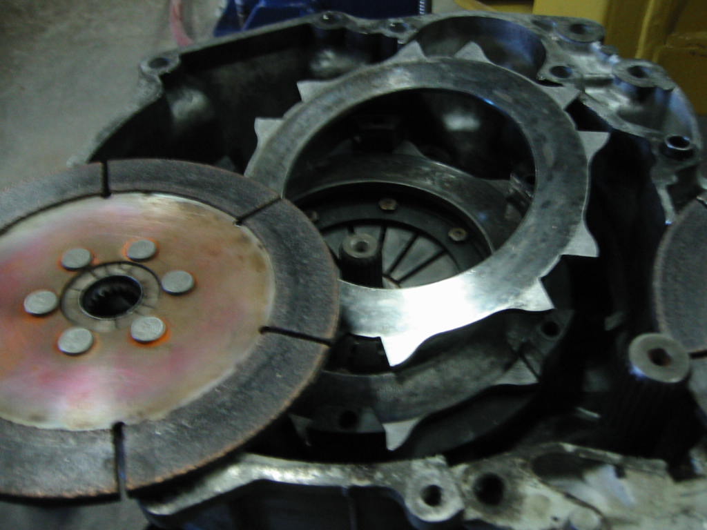

Well, I got to pulling off the tranny finally and found the problem I had a month ago when I last drove it. Seems as the Mitsu input shaft isn't long enough to fully engage both clutch disks on the QM setup. The input shaft chewed up the part of the disk splines it did engage and bored a hole a few mm bigger than the original splined hole. The good thing is there is no damage except for the disks themselves, bad thing is I can't just button it up and race this Saturday. I'll get some pics of the carnage up tomorrow.

No, I just found out from some of the NABR guys that there were specific DSM instructions to put one of the discs backwards, which I didn't get. All I need are new discs, everything else is fine.
