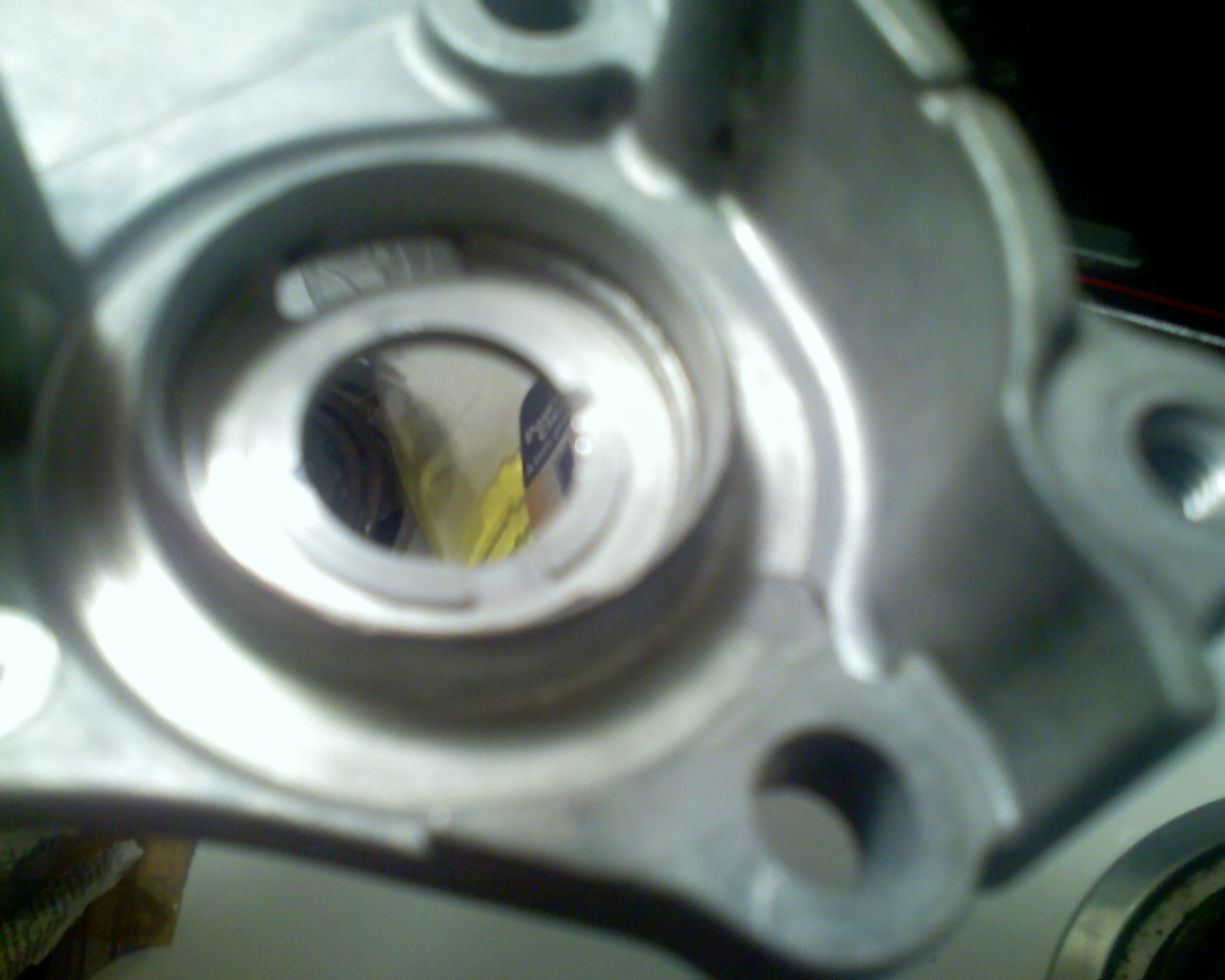

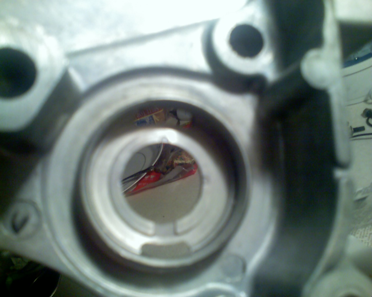

Re: Front Cover - OIL seal installation question
Hi JET-
Thanks for the reply. It was for sure not in backwards. The little spring is towards the inside of the engine.
Here is a picture. I don't see how the oil seal will go past this little ledge.

Old 04-16-2007   #4
Take a picture of the seal in. There should be a few slits in the seal where you can see the metal inside, those should go towards the outside of the engine.

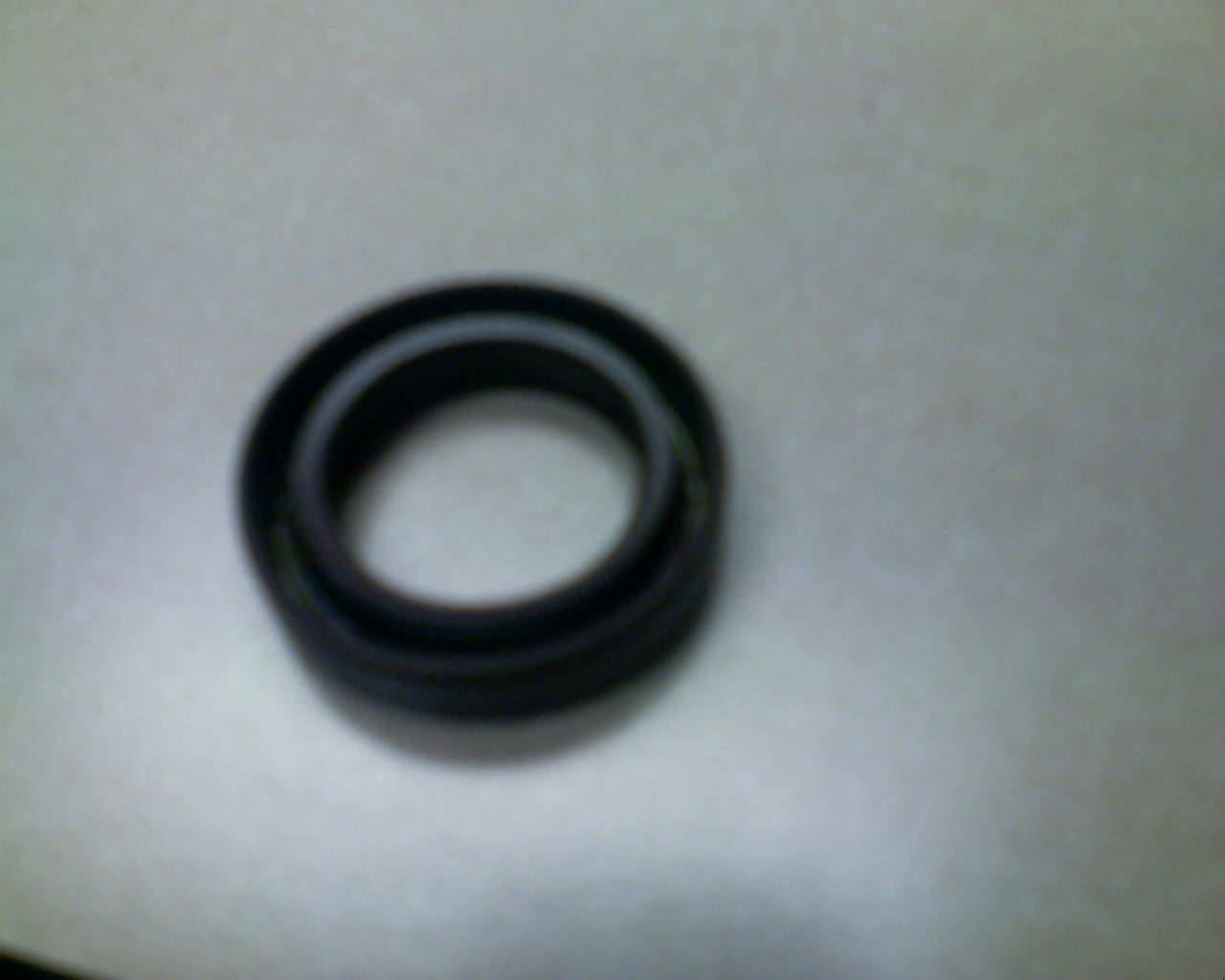

Not a great pic but here is a pic of the underside of the oil seal. You see where it's open. Under the inner lip is a little spring that goes all the way around the circumfrence. The outter lip is what is butting up against that little ledge I was talking about. When the oil seal is pushed into the front cover with a socket, it's not sticking up at all. It sits just below the aluminum surface. I'm putting it in the right way, I was just wondering about how far it was supposed to go down.
I examined the book this morning and looked at the CAD print. It does look like they are showing the open space in there. It's not much, maybe 1/16+" I want to say it's suppose to bottom out at that little raised edge that you can see in my first pics.

Old 04-16-2007   #6
Yeah, that must be all that it goes in. Your casting must have been pretty shallow.
Thanks JET. I'll put it back in and let it bottom out at that ledge. I removed it very carefully with an angle claw tip screwdriver. It's a brand new oil seal, I just removed the seal to show you pics.
I put engine RTV around the outside of the oil seal also.
