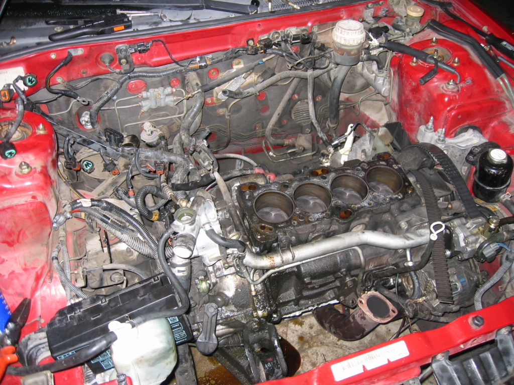

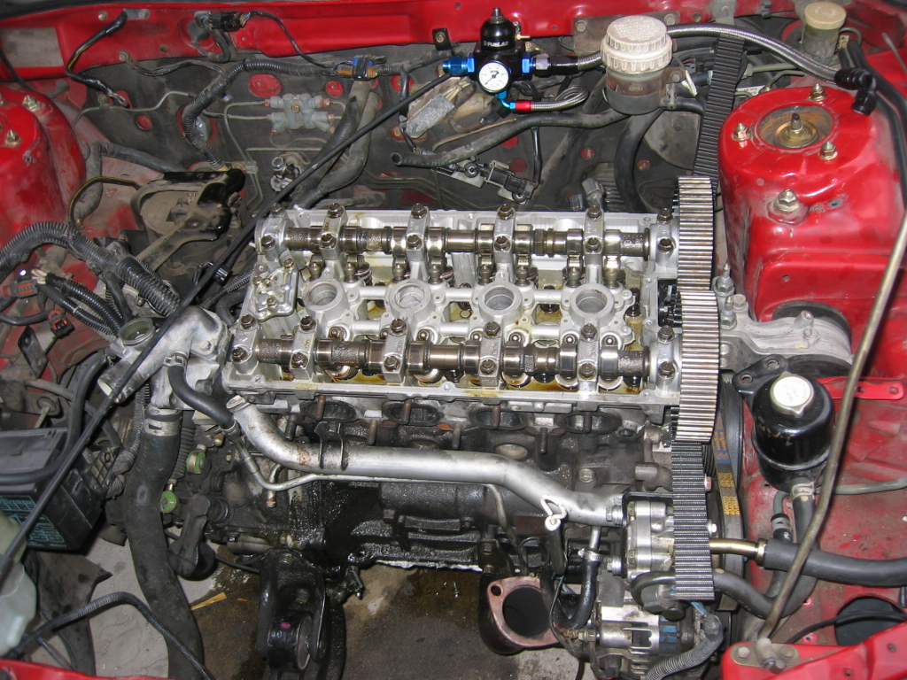

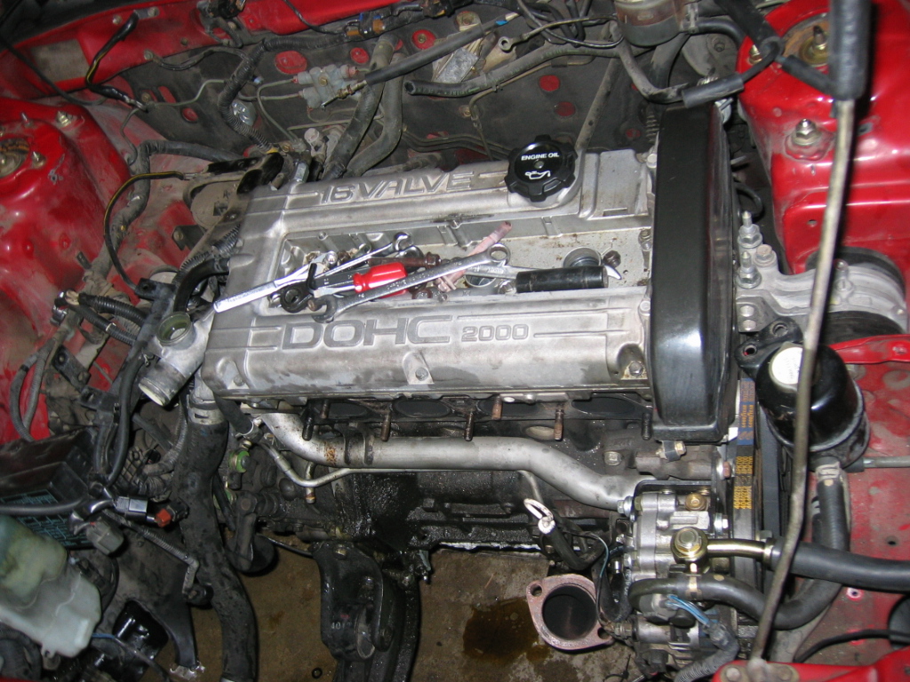

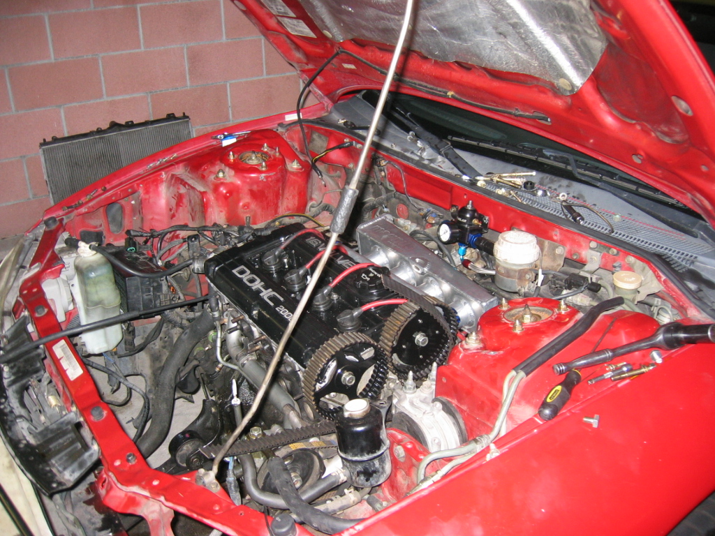

The project is coming along nicely. Last night i got home at around 6 pm and started crankin on it at around 7 until around 1:30. Managed to get the engine bay stripped down to basically the wiring harness and a block and tranny (no head).
This morning i woke up and got right to it. (im worthless in the morning and day.) I got the new throttle cable in, got the head loaded and in (wished i could have used my ARPs from the 6 bolt, oh well). The intake mani is on, Turbo, WG and manifold are on, timing belt is retensioned and on, needed to remake the bracket for the coil packs because there wasnt a hole close enough to the top of the head so i had to use a lower hole and extend the bracket with the trusty ol welder. i made a bead on the ends of all of my ic piping so it can hold more boost, then repainted them black. Got the FPR mounted and hooked up, along with the fuel rail.

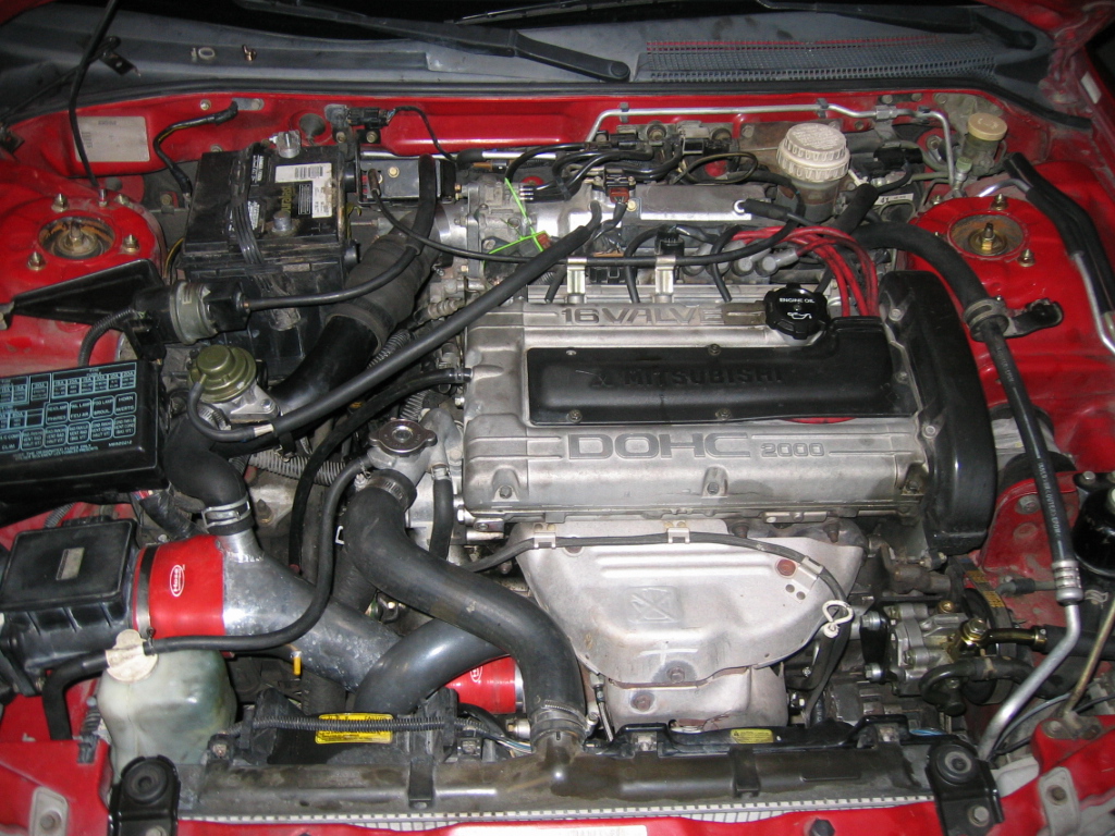

Here are some pics to start.
Picked up the car looking like this http://www.dsmstyle.com/forums/showthread.php?t=16956
Here is a couple pics before i really started the build. I changed the rims, added a side skirt from my White GST and painted it red, painted the mirrors red as well. The middle picture is me and a couple friends Count the dsms... Also not shown is my white gst which is hiding on the side of my house. Third pic is of the engine bay before the build

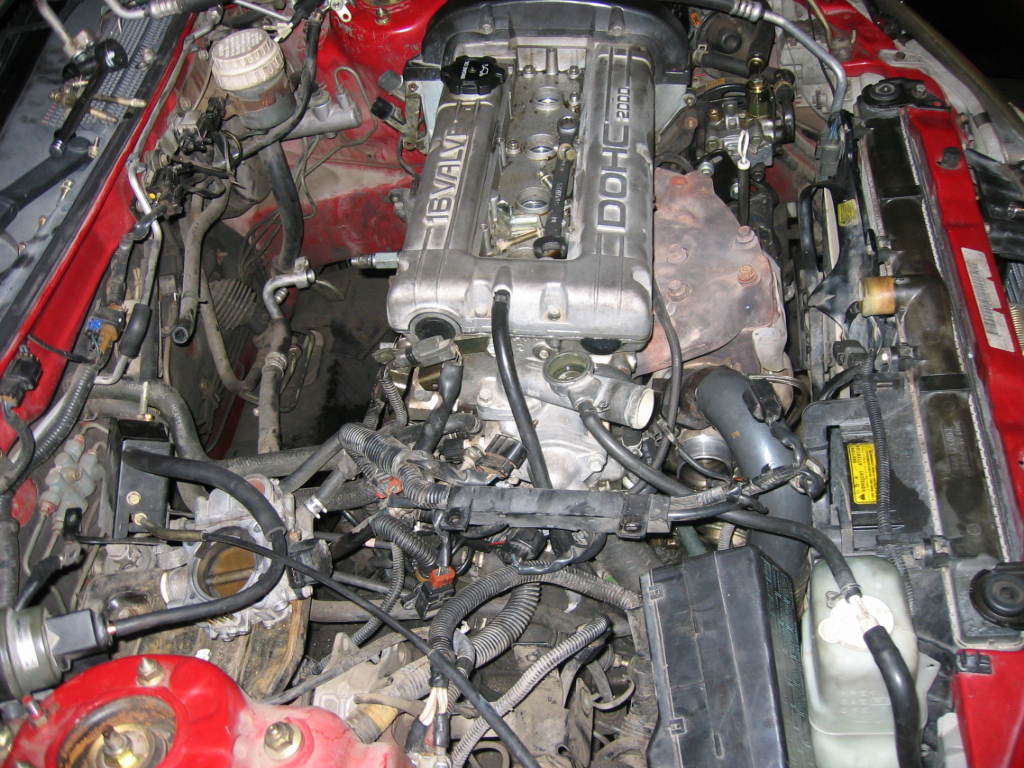

Here are some pictures of the progress of the build.
More pics coming tomorrow of hopefully a finished project.

Couple typical things though. I have a couple boost leaks that i have to take care of, it sounds like around the intake mani and throttle body. and i have an exhaust leak, which im going to have to figure out.
The car pulls insane. The lowest my boost controller is allowing is 27PSI, but on the dsmlink it shows little to no knock at that high of boost.
