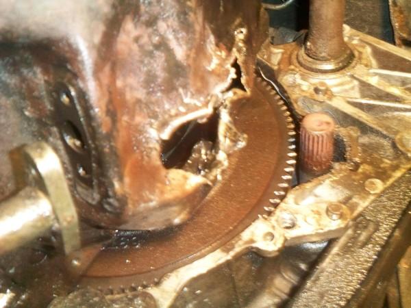

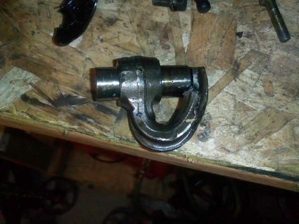

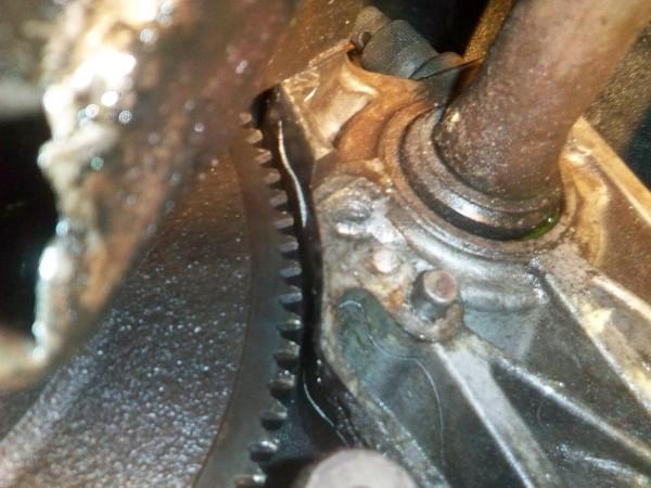

Here is some pictures of the destroyed 7 bolt some people have seen this some haven't enjoy thanks for looking
Name:	big hole in my pan.jpg
ID:	9618   Click image for larger version
ID:	9619   Click image for larger version
