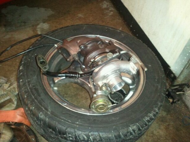

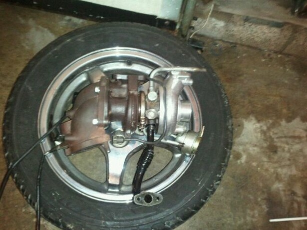

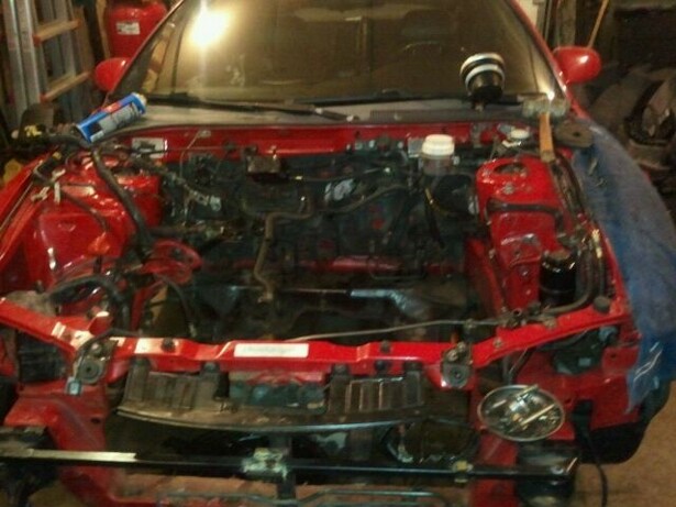

Considering I'm Fwd and with the 16g E85 I'm just going for about 350 whp for now.
ID:	11643   Click image for larger version
