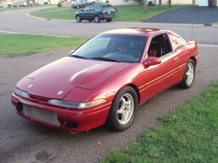

To cut, or not to cut?
I did a photoshop of my bumper uncut and cut. I'm not sure on what to do.. If I cut it, I will get more flow to the radiator and eliminate the possibity of over heating. But it looks cleaner without it cut. What do you guys think?
UN-CUT:
CUT:
Clean look or mean look?

A cut bumper can look very clean and aggressive IF cut properly, smoothed, then painted.

Un-cut looks better but cut is gonna be better performance wise, so I would recommend cut.
Edit- Get rid of those fog lights while you are at it.

I usually don't like the cut look, but that looks mean if that's what it will look like. I'd go with cut.

I'm not sure the extra surface area is going to solve all your problems. I would start by making sure that all of the air coming in the front cant go anywhere but through the radiator by blocking areas where airflow can go around the IC and radiator. Then maybe vent the hood if you still have cooling issues.
Also your headlight intake probably isn't helping in the cooling department. By letting that air into the engine bay it's increasing the overall air pressure resulting in less air thru the front of the car.
So I would say uncut. Because if you are overheating, I don't think that will fix it.
