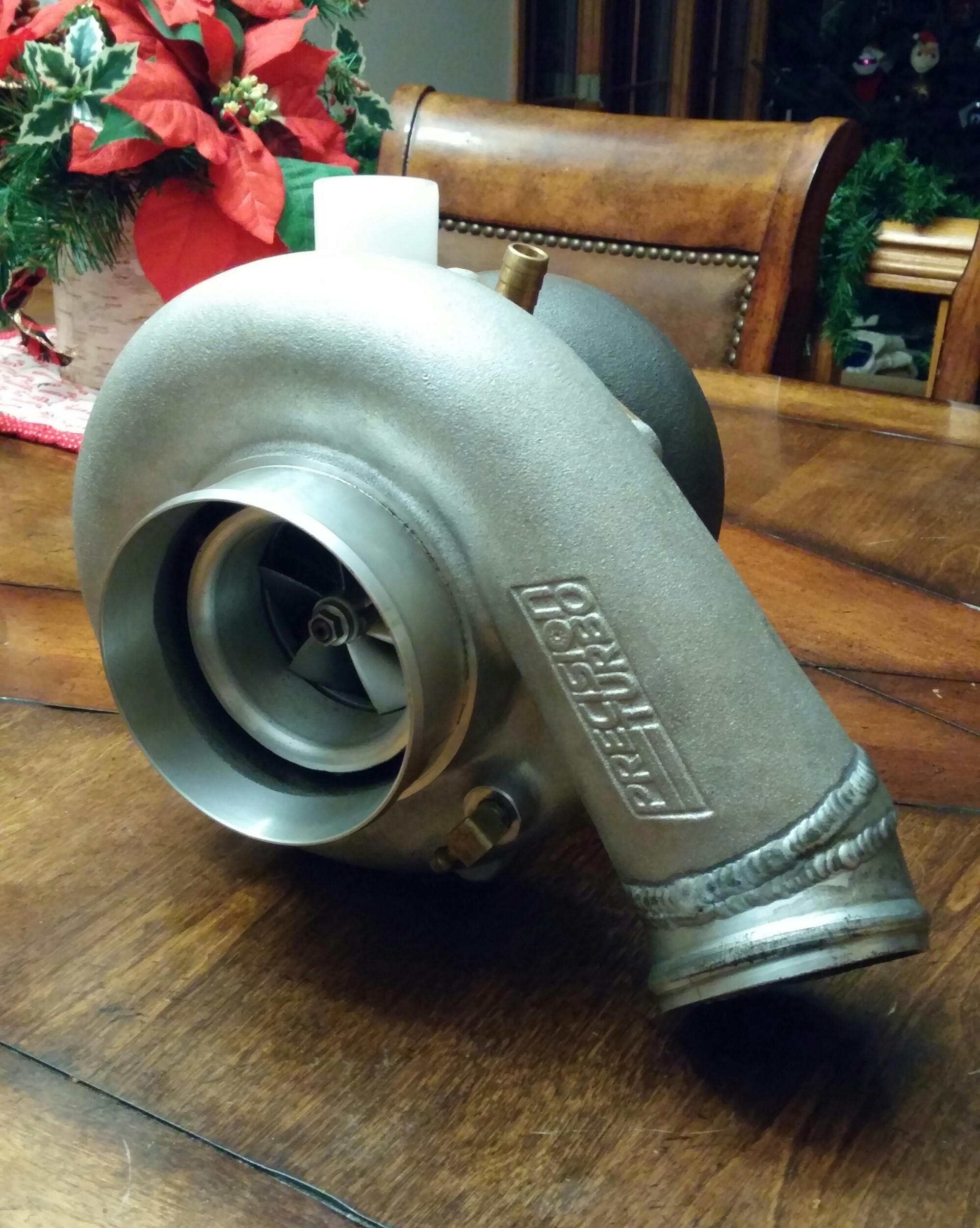

Figured id start a new thread for this years winter/spring build and all the rest off the stuff that goes down with the car.
Specs:
1995 eclipse gst awd converted
Welded diff
Gutted
All autometer carbon fiber gauges : boost, oil pressure, coolant temp
Battery relocated to the trunk with cutoff switch
Thats all as far as the car sits right now.
List for this winter :
Pte 6766 .96 a/r undivided t4 (have)
6 bolt 2.0 .020 block
Pauter rods
Wiseco 1400 hd 10.5.1 pistons
Stock polished and balanced crank
6 bolt stockport head (have)
GSC s3 cams
GSC adjustable cam gears (have)
GSC power division springs and retainers
GSC power division zero tick lifters
GSC valve stem seals
Supertech valve guids
Not sure on valves yet standard size tho
Arp hardware
Kiggly main griddle
Acl bearings
Built trans (not sure who yet)
SD
Jmfab drag intake manifold
Theres the plans for the motor some things i havnt decided on quite yet but input is good. Kind of a big goal for me right out of the gate but go big or go home. Alot of time and money will be invested and cant wait to start putting her back together. Will keep posting updates as the build continues. Enjoy

Posts: 791
Re: 800 hp goal Dsm build
Make sure you post date and time when you dyno! I would like to be there for this dyno session.
Old 01-06-2015   #16
Murlo26
Murlo26's Avatar
Location: Lino Lakes
Drives: 17 Honda Accord
Posts: 4,041
800 at DB, that is big time.
This should be a pretty cool build when all is said and done.
Maybe i am wrong on this, isn't the exhaust housing on this turbo a bit small for 800 at DB? I know on my t4 6266 I ran a 1.0A/R but that was twinscroll, so probably not the same at all. Actually the more I think about it, single scroll that is a huge A/R I think.
Carry on
Old 01-06-2015   #17
dsmDolney
dsmDolney's Avatar
Join Date: Jan 2014
Location: Blaine, Mn
Drives: Racecars
Posts: 679
It is a pretty big housing for sure. Itll be nice when its done to look at what ive built. 800 is goal even if i come close to it itll make me happy.
Tyler
2011 Subaru Sti 11.0 @135mph
