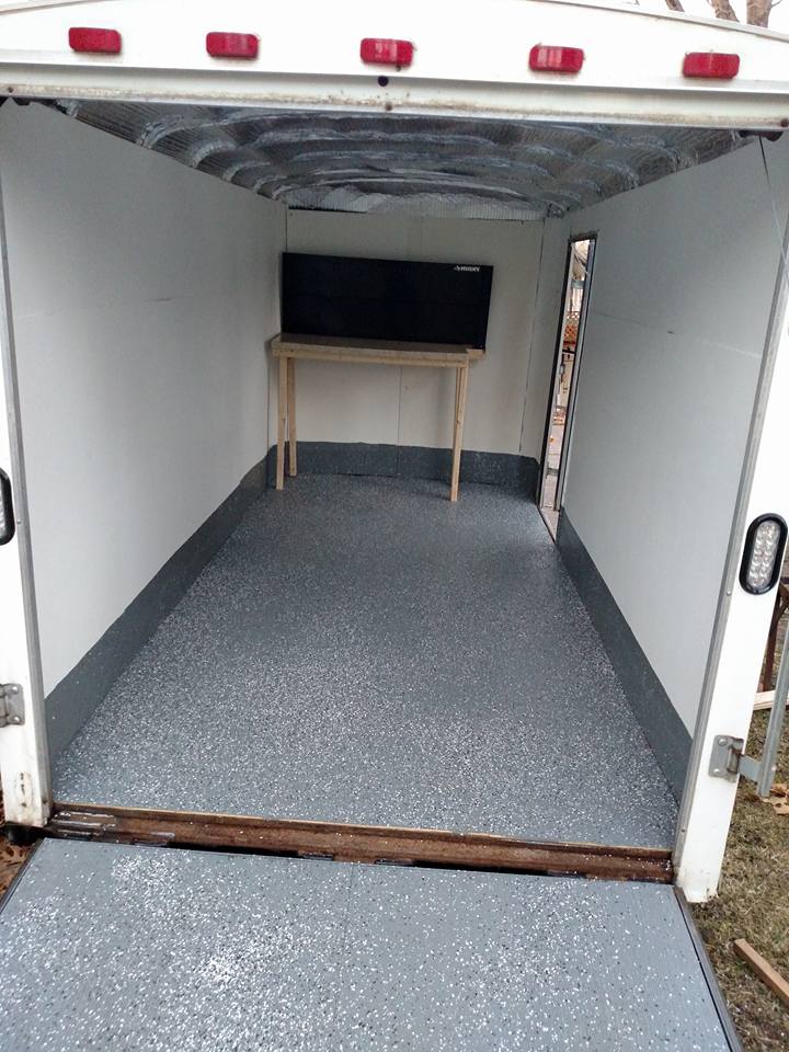

Busy weekend.
Insulation complete
Walls painted
Trailer floor painted
Shelf system starting to come together
Wiring/Lights complete
Rot on rear of trailer fixed.
I just put the shelf in there quickly to triple check dimensions. I'll level it out here and screw it down shortly and then start to figure out where I am mounting motorcycles/run the 100v electrical plug-in for the generator.

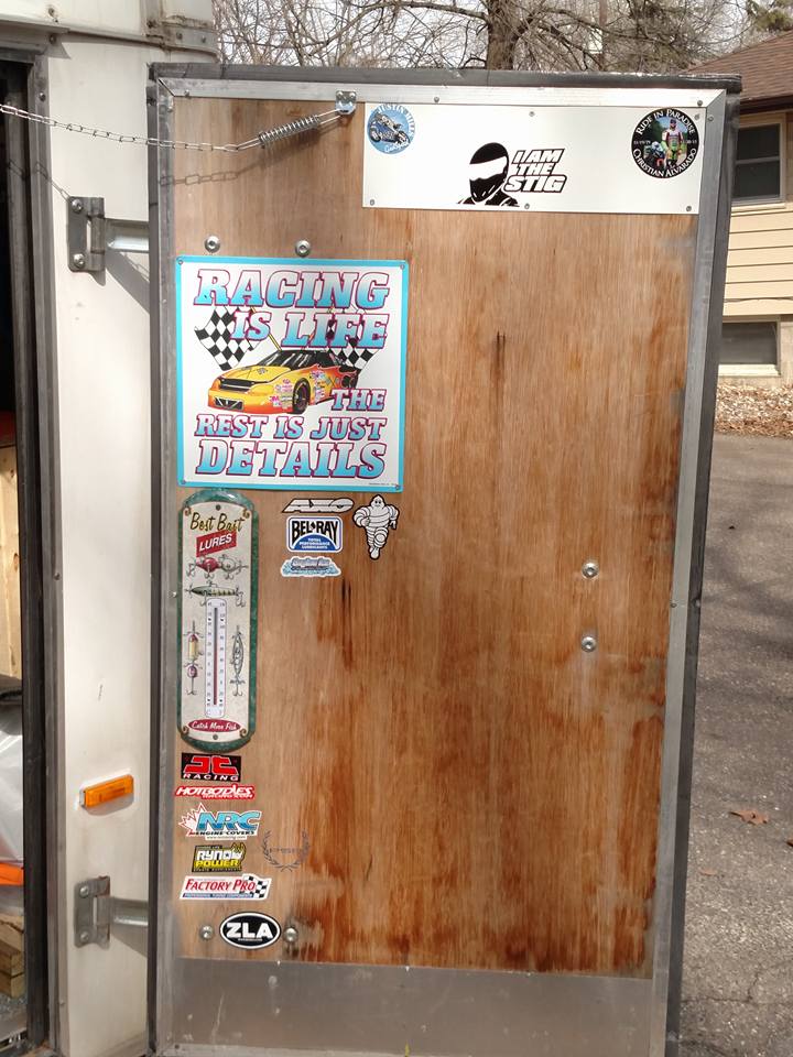

I got some interior work done last night and some door "art"
Name:	trailer interior half completed.jpg
ID:	15817   Click image for larger version

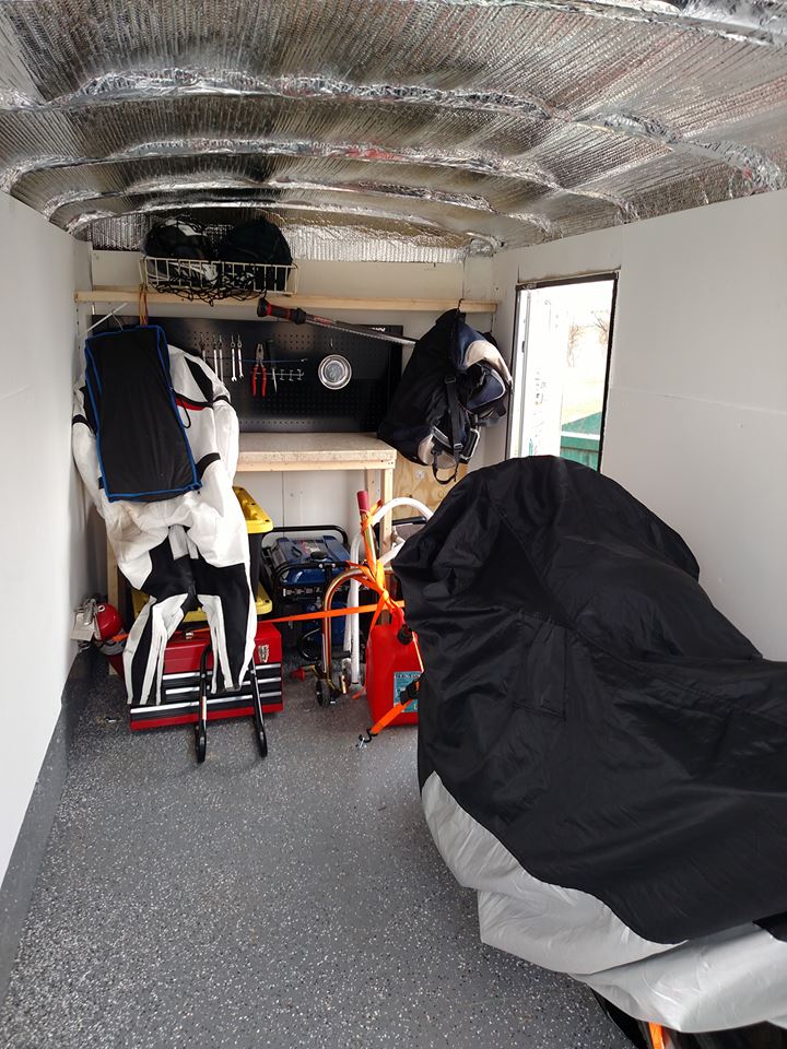

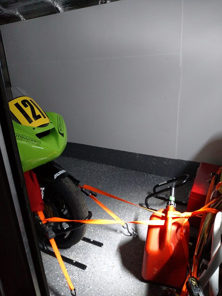

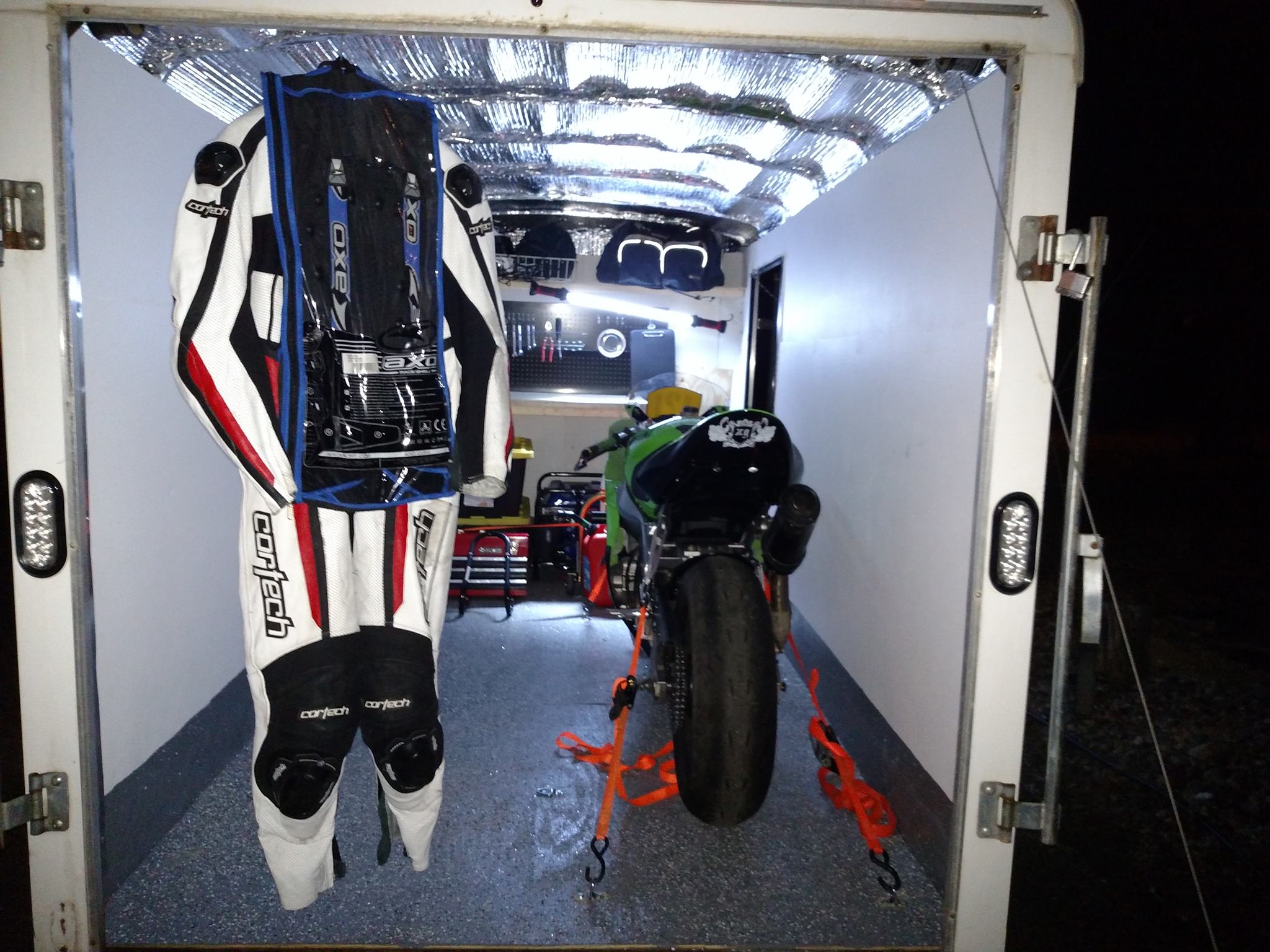

Few pictures of it loaded up for my trip to the dyno. I'll make those updates in the other thread.
2 are of at night loading up/nearly done. The one in the AM after the 4.5 hour drive. (notice the gear bag fell down, need a 2nd bungie cord, spare helmets worked so that's done, few tools fell of peg board, suit hanging in back fell, so I moved that to the front after a gas stop 1/2 way thru the trip).
I still need to:
create a place for my tool box (on the tail of trailer)
make some tweaks to the shelf setup (I may mount the metal pegboard on the wall and make the shelf a fold down on the side to reduce tongue weight)
Make a spot to hold the ez up
Make a spot to hold the folding table and my cot for sleeping
Few more shelving locations
110 plug in setup
Touch up/paint exterior in parts. I am thinking of running it no stickers to avoid anyone figuring out the goodies inside.
Future:
Install 12v battery setup
stereo system
Ceiling vent with fan
Interior door lock

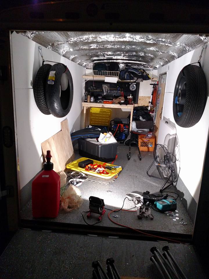

Started loading the trailer last night....
Name:	trailer at night loading.jpg
