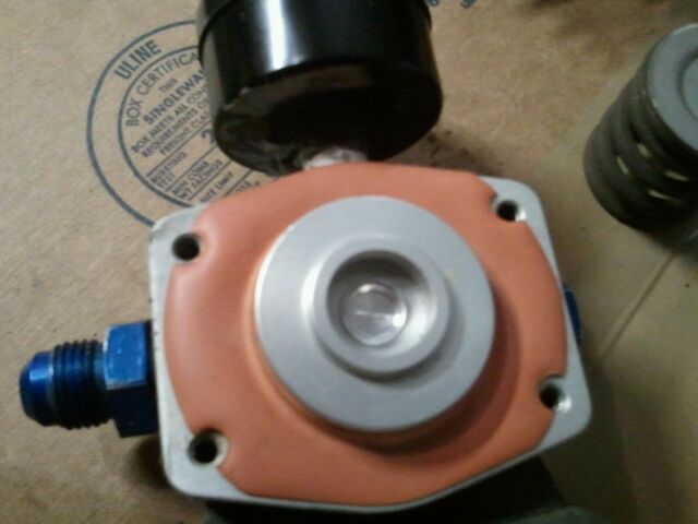

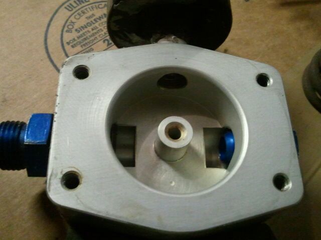

Diaphragm
ID:	13943   Click image for larger version
ID:	13944   Click image for larger version
BW8776, e-85

was not wet either on top of it when I took it apart
BW8776, e-85
