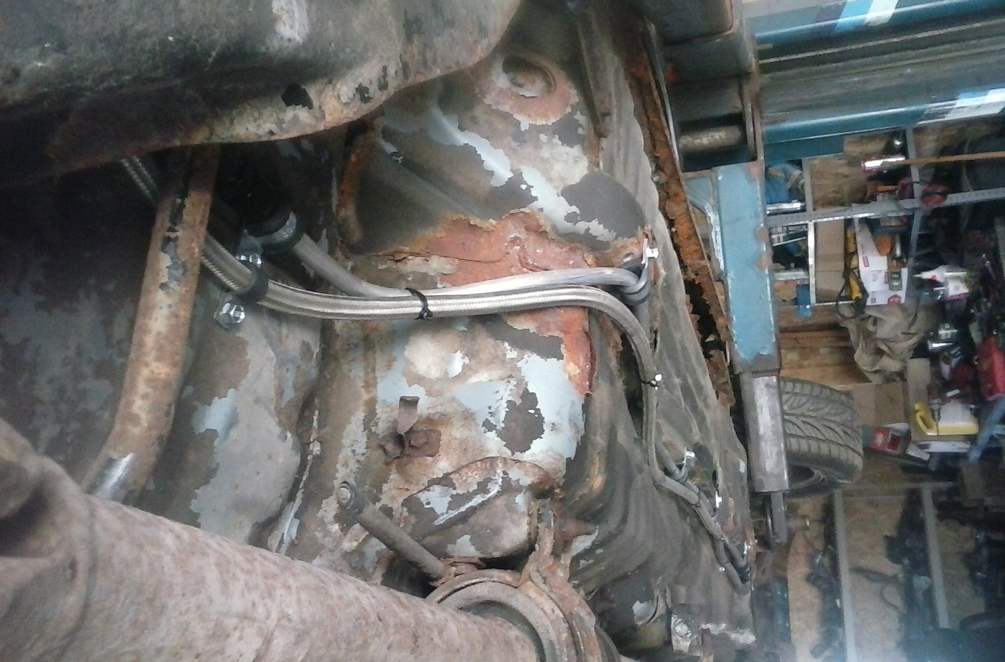

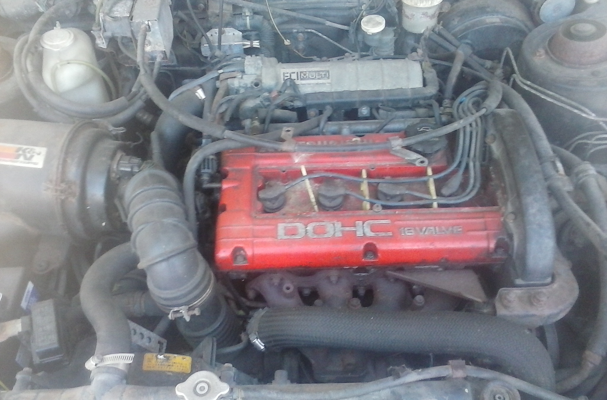

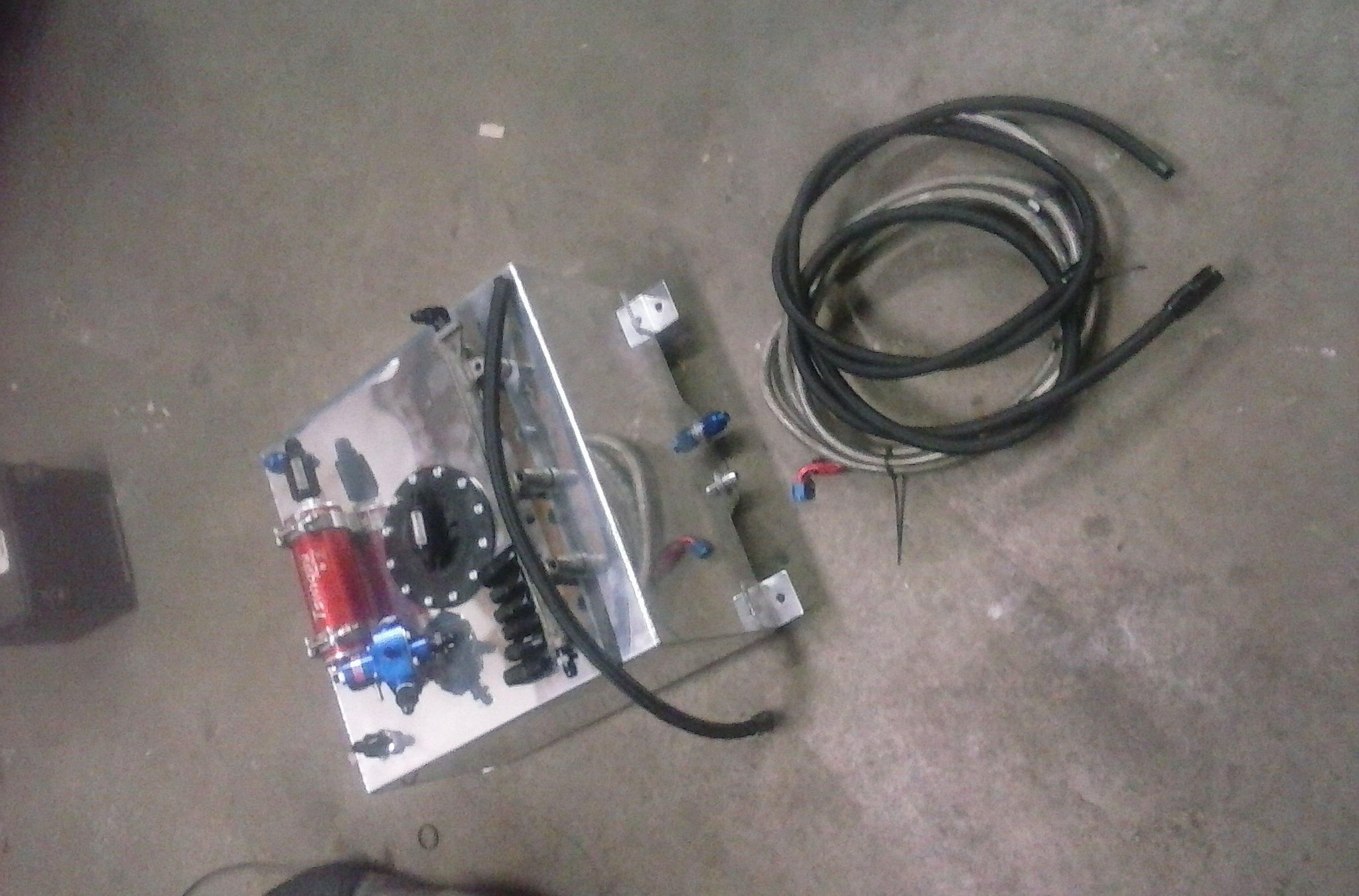

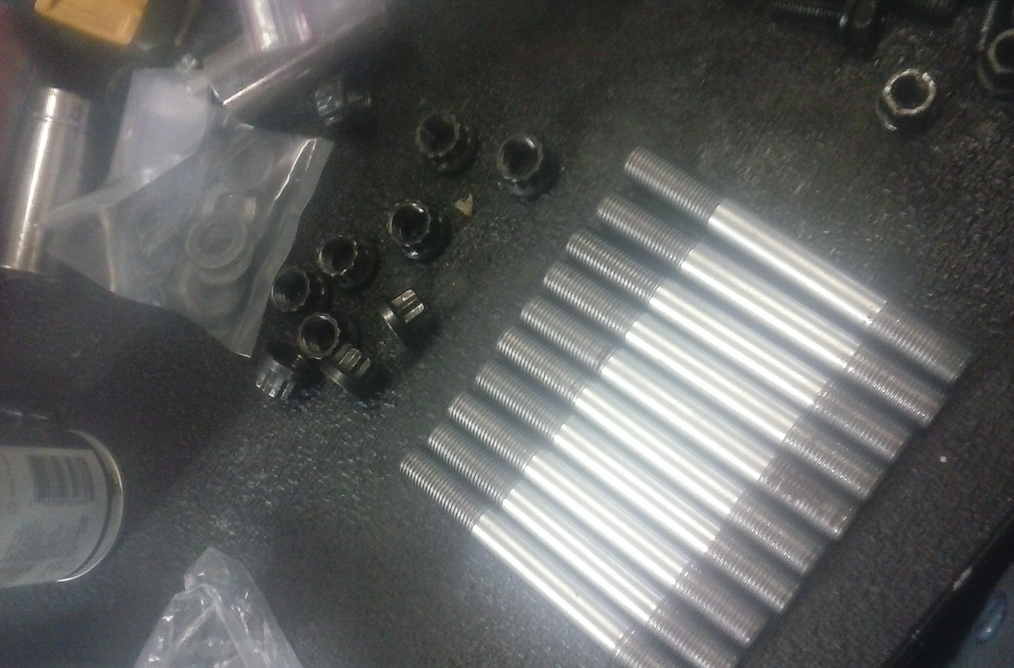

Ok so I bought this car about 3 months ago been driving it for about a month now. Figured I might as well share my pictures and such of the build and my problems I'm having. As of right now has
H11 head studs
Cometic head gasket
Totally stock 6 bolt

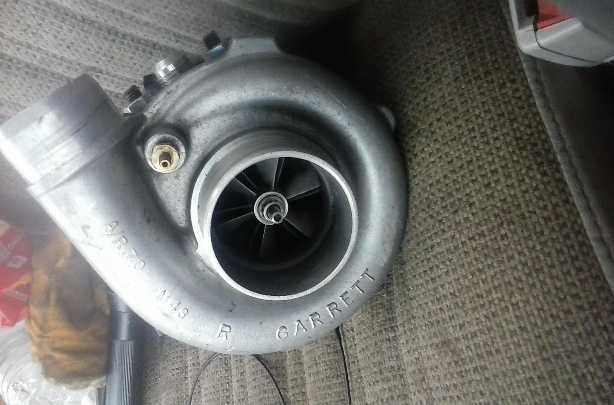

Unknown garret turbo with precision bolt on housing
Evo 9 maf
560cc injectors
10 gal cell with -8 braided line front to back
Aeromotive tsunami pump
Wideband
Boost gauge
Safc 2
4 bolt rear LSD with AWS deleted
Homemade o2 housing with emusa 38mm wastegate
So on to pictures in order of time

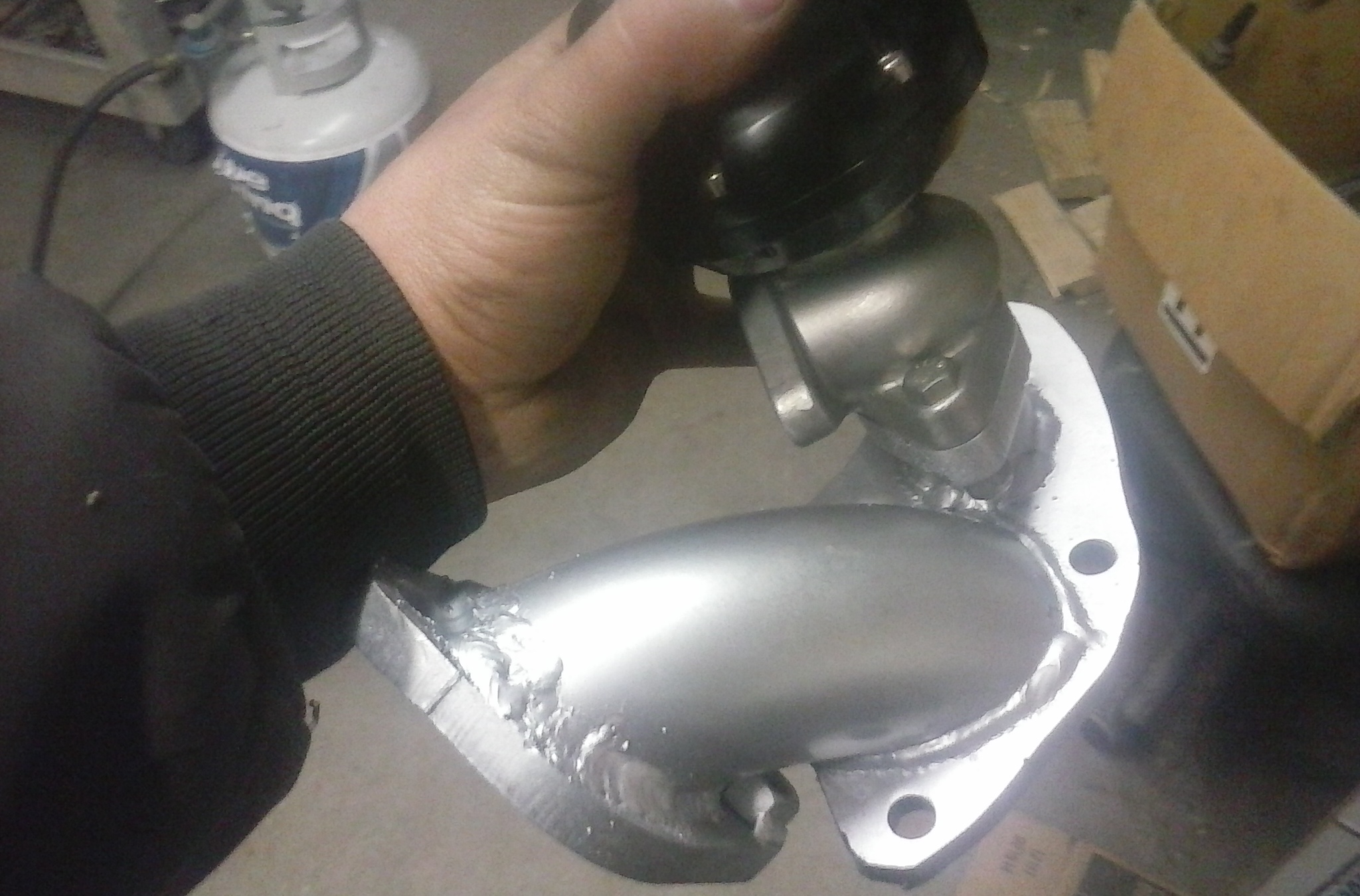

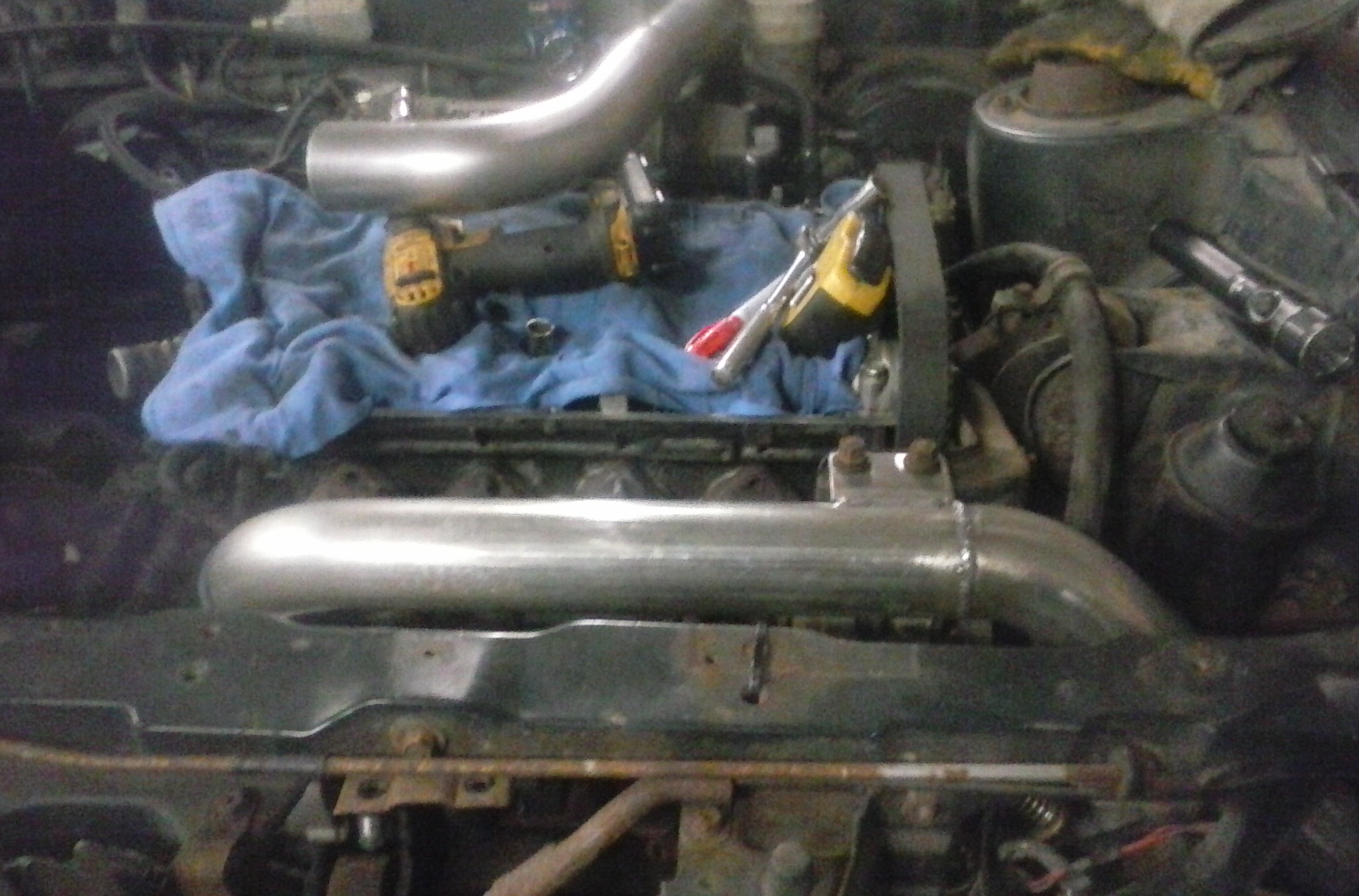

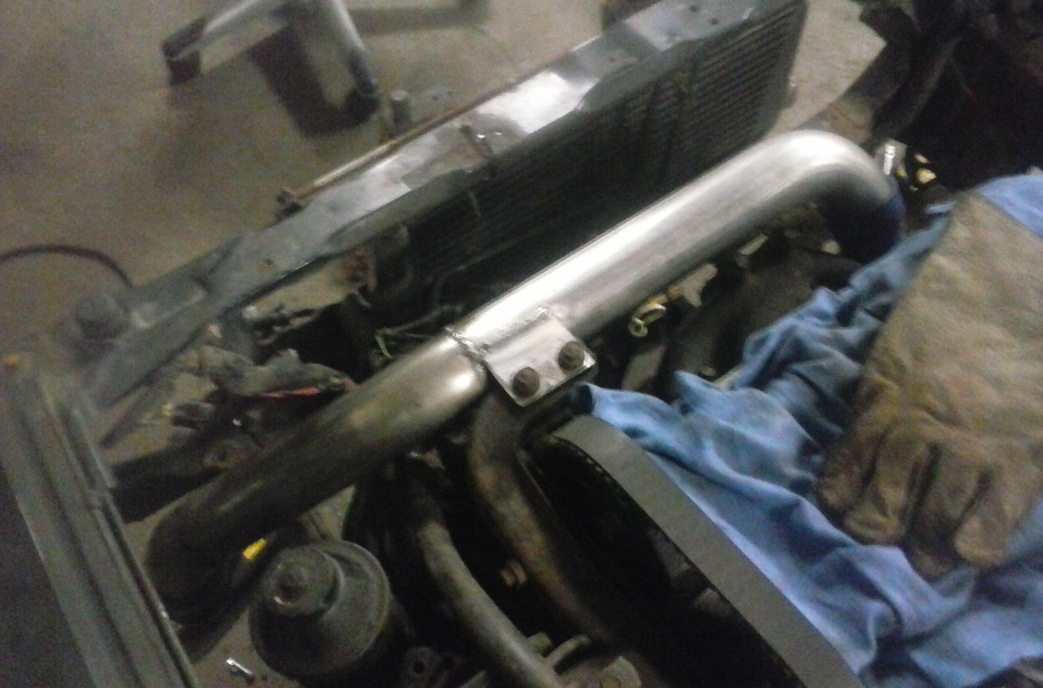

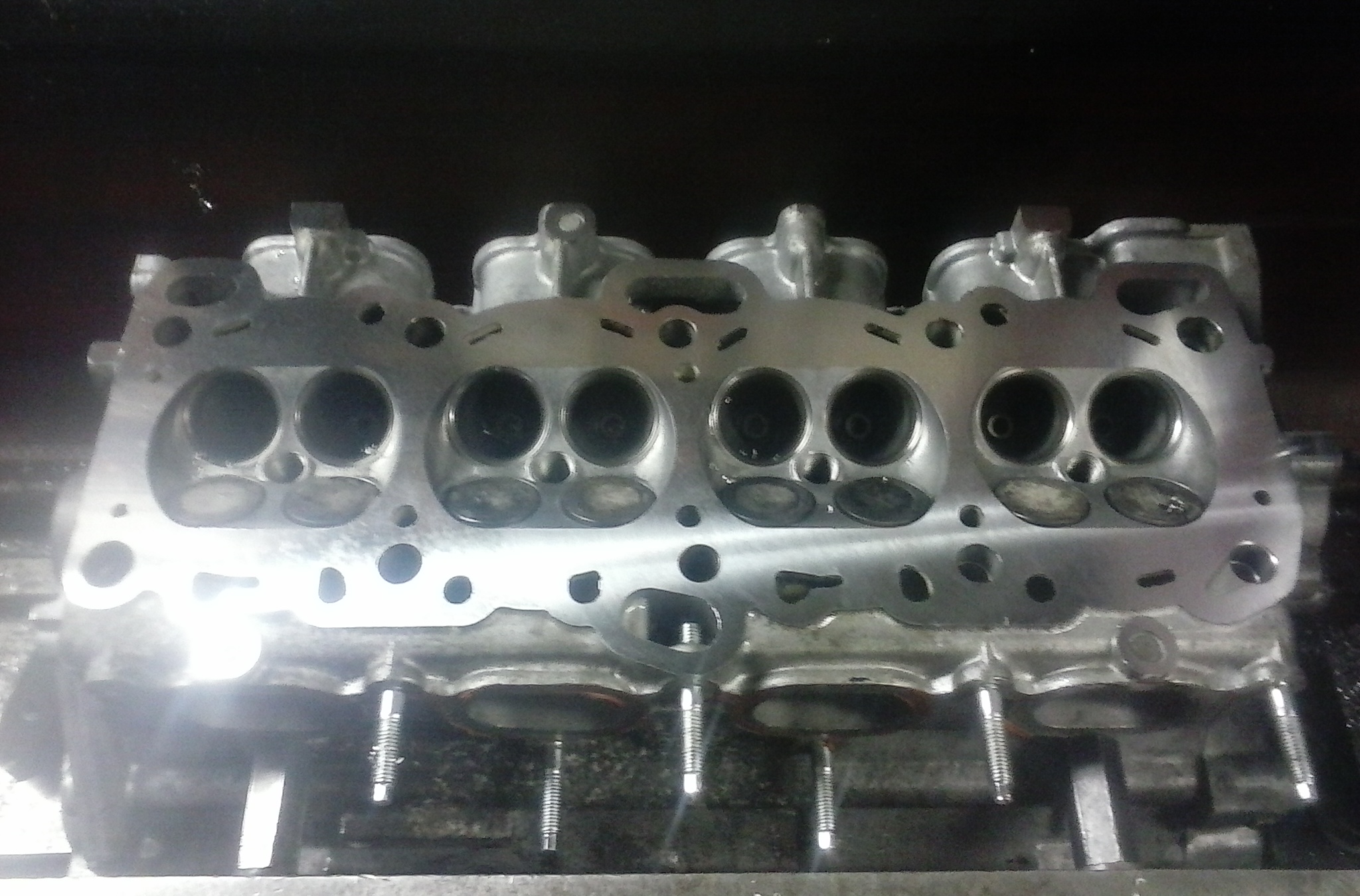

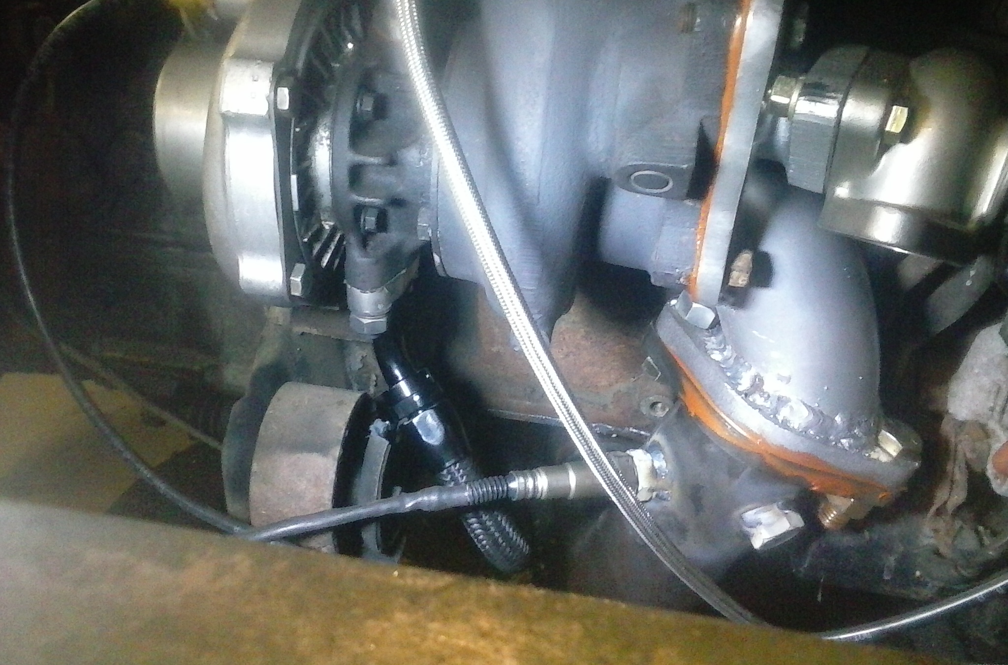

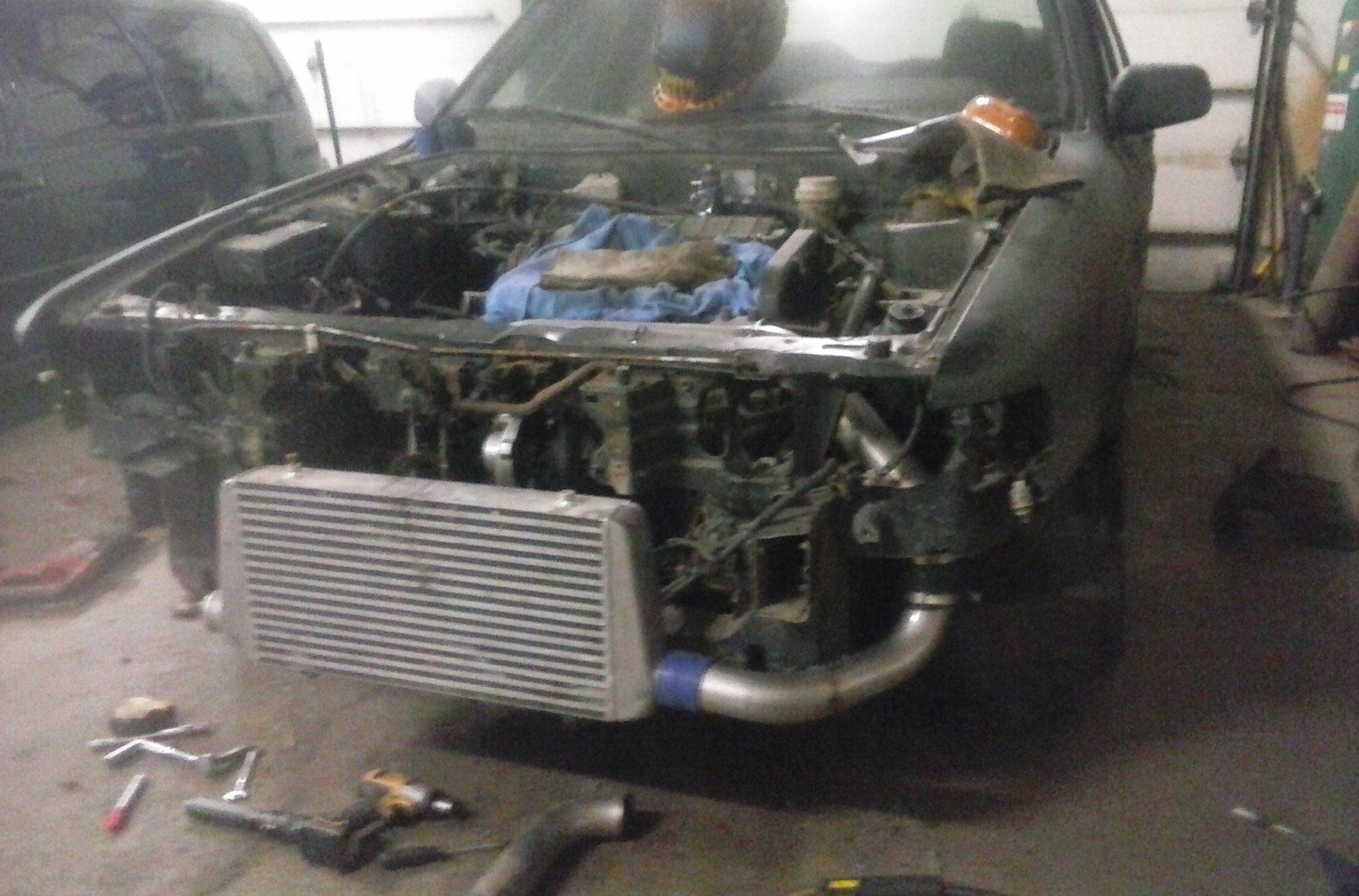

Turbo and intercooler piping build

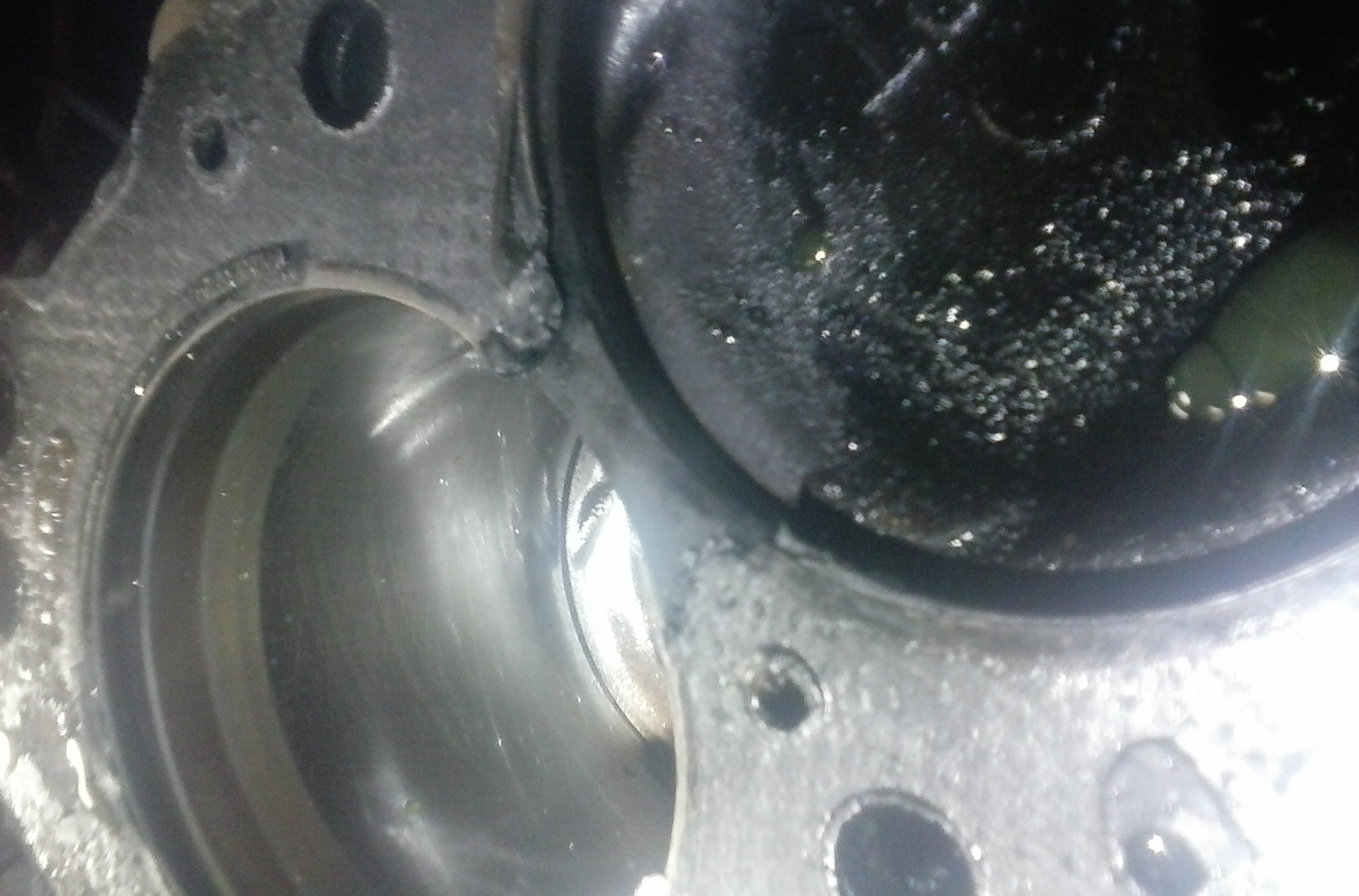

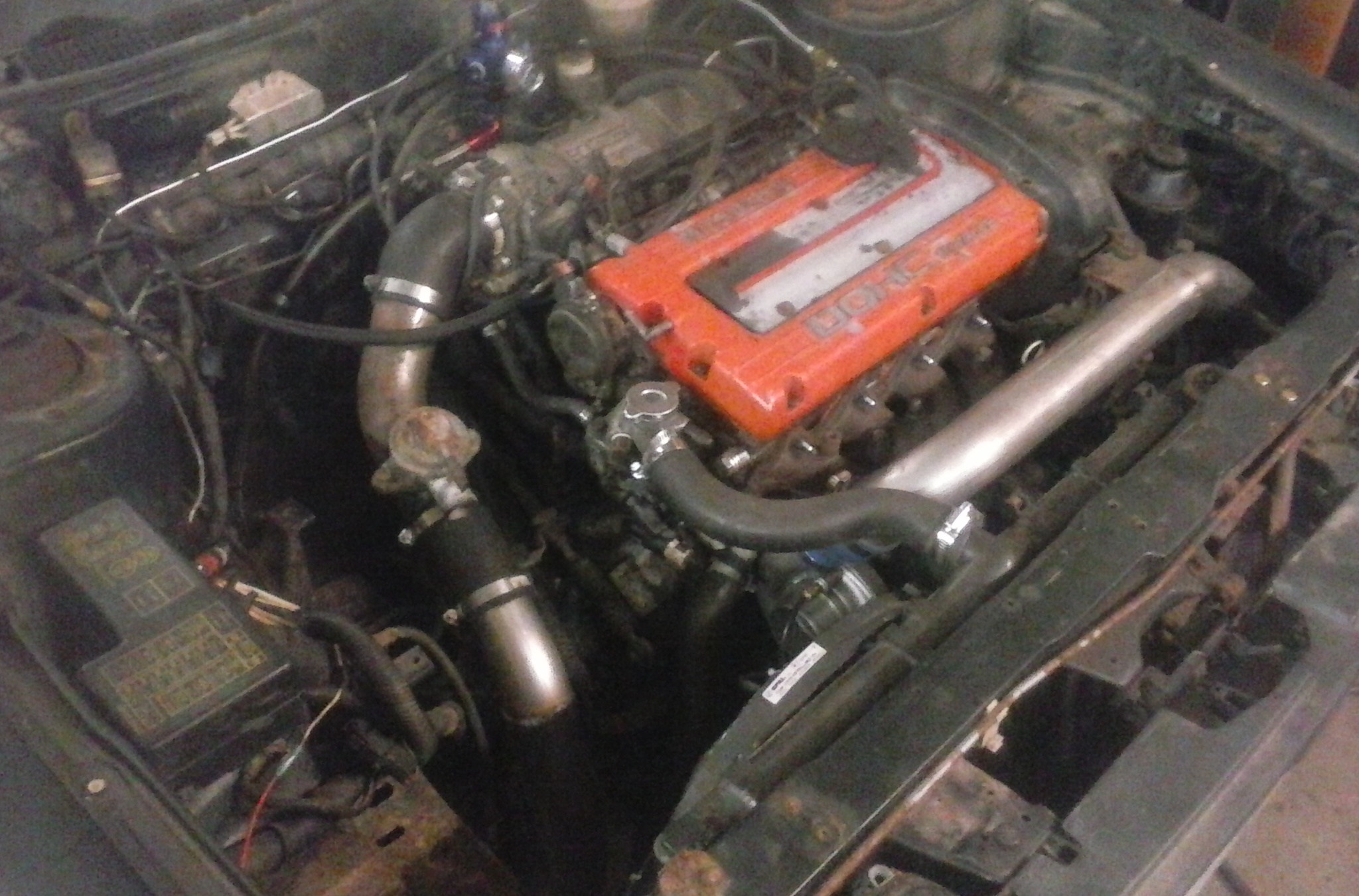

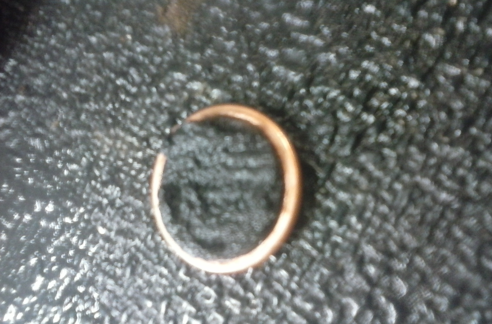

And when it leaned out because of a cheap fuel filter

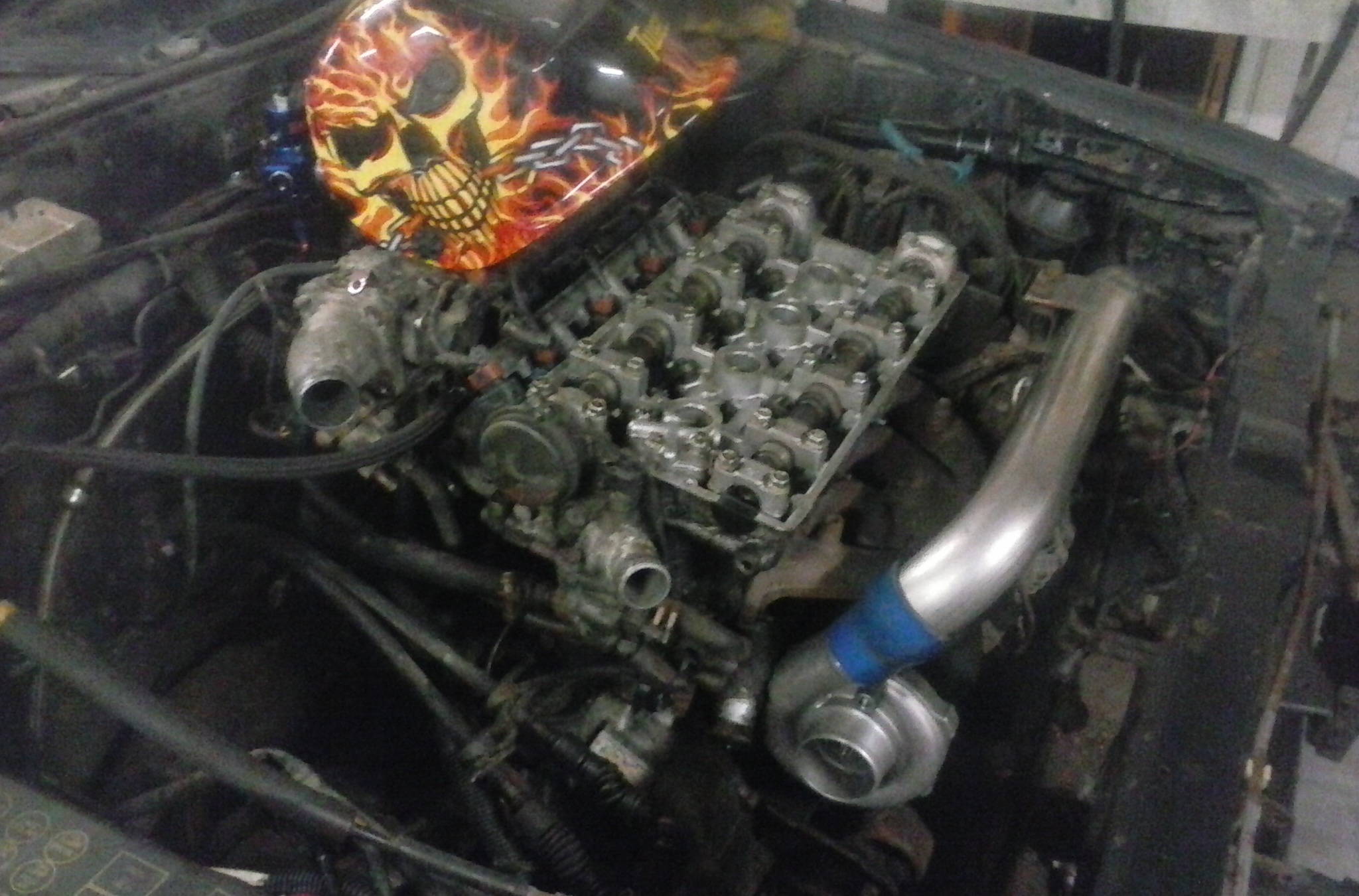

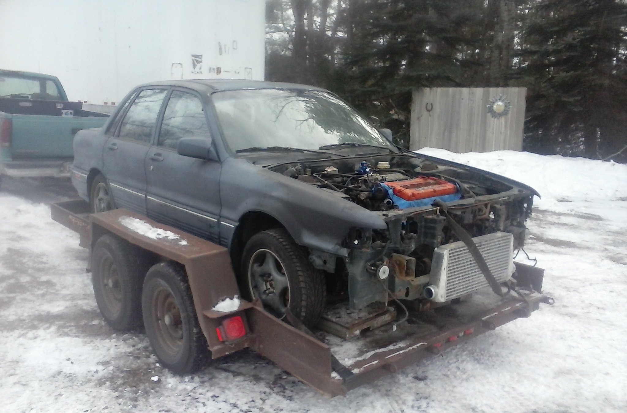

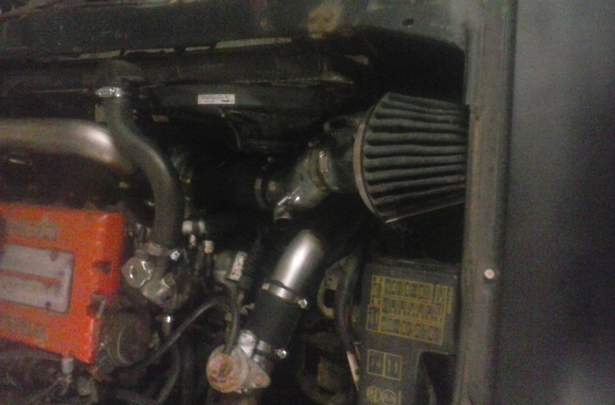

And lastly how it sits now

No money for o2 housing gaskets? Needs some E85 and proper tuning and this thing will be pretty legit DSMstyle! Keep the pics coming!

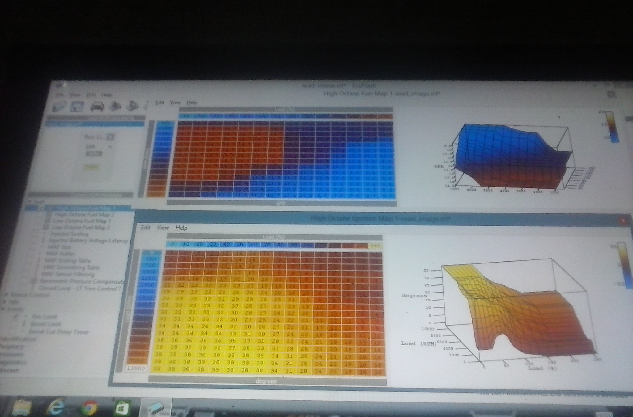

So got a new daily driver and pulled this in the garage. Managed to get a 2g flushable ECU wired up and beginning to tune on speed density with ceddy mods. We will see how it all goes.
