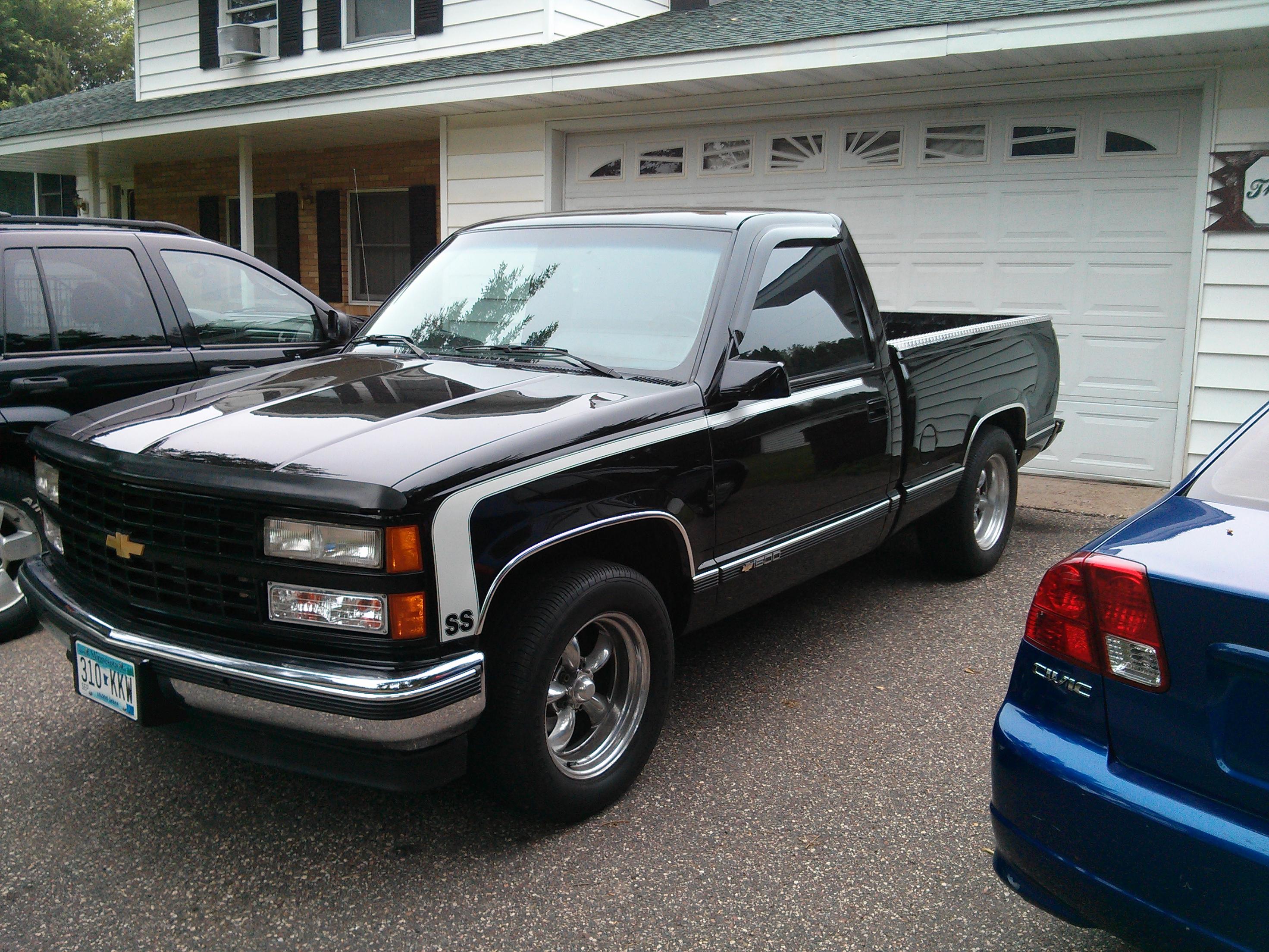

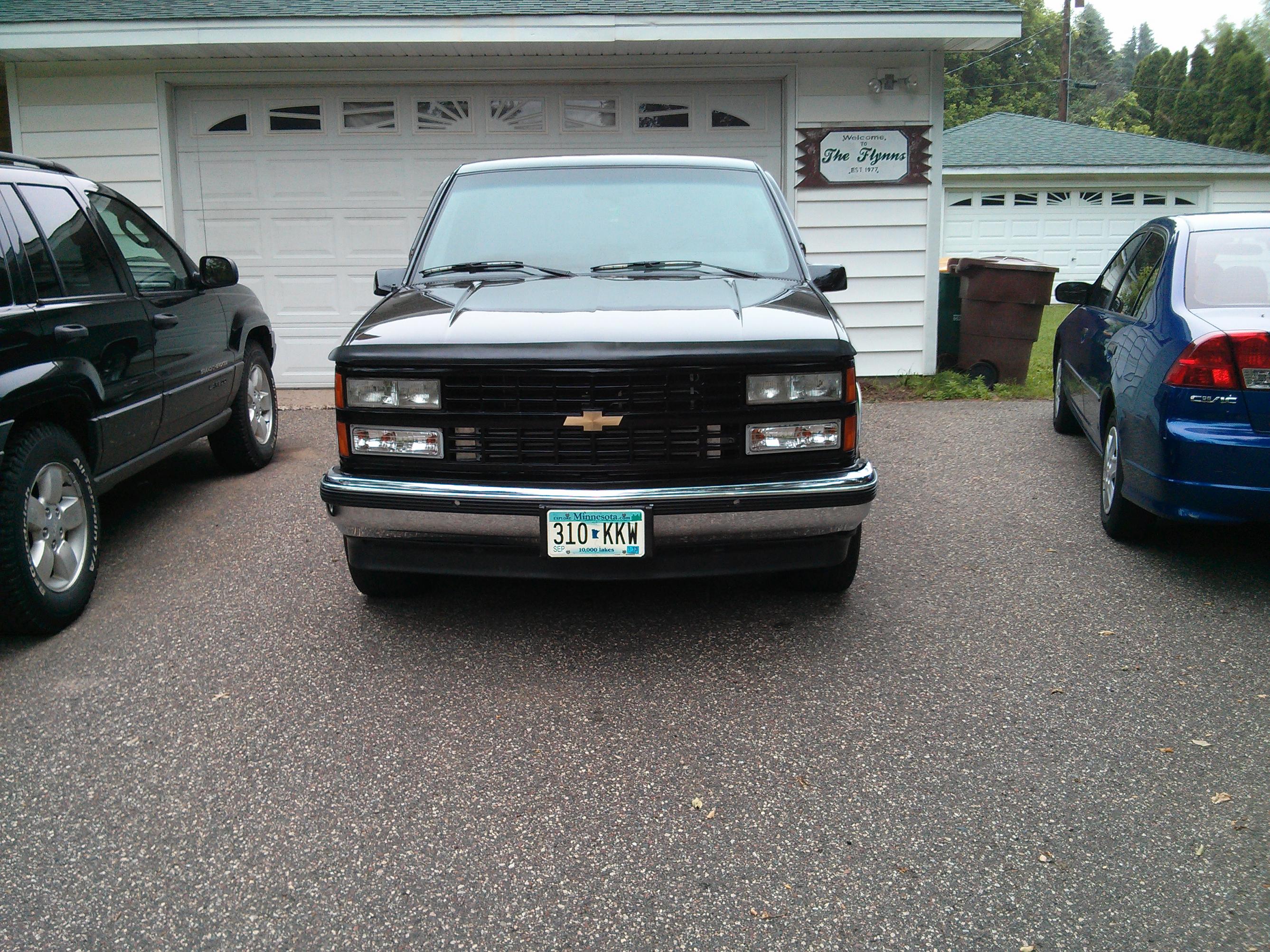

Just picked this beast up last night. Its a 1990 Chevy as Silverado. It has a 5.3 swap with 706 heads. The motor is all stock except for valve spring. It has a gt45 turbo mounted to it running 10 psi. It made 590 at 10 psi on pump gas with the old motor at APS auto works. The old motor had a came and different heads. The truck needs some work to be perfect in my eyes. I need to fix a couple things before bringing it in to get retuned. I am hoping I can break 600whp this year with it. I would like to clean up some of the wiring, fix exhaust stuff, cooling fan, install a trans temp gauge, waste gate dump tube, and some other small stuff.
5.3 swap
Gt45 turbo
80lb injector
Big fuel pump
Built th350 tranny reverse shift
2800 stall
Trans brake

hoo hoo hooo, daddy like.
There are a few fast trucks around already. I was with a friend last year and ran a 600whp truck on low boost makes over 900whp turned up.

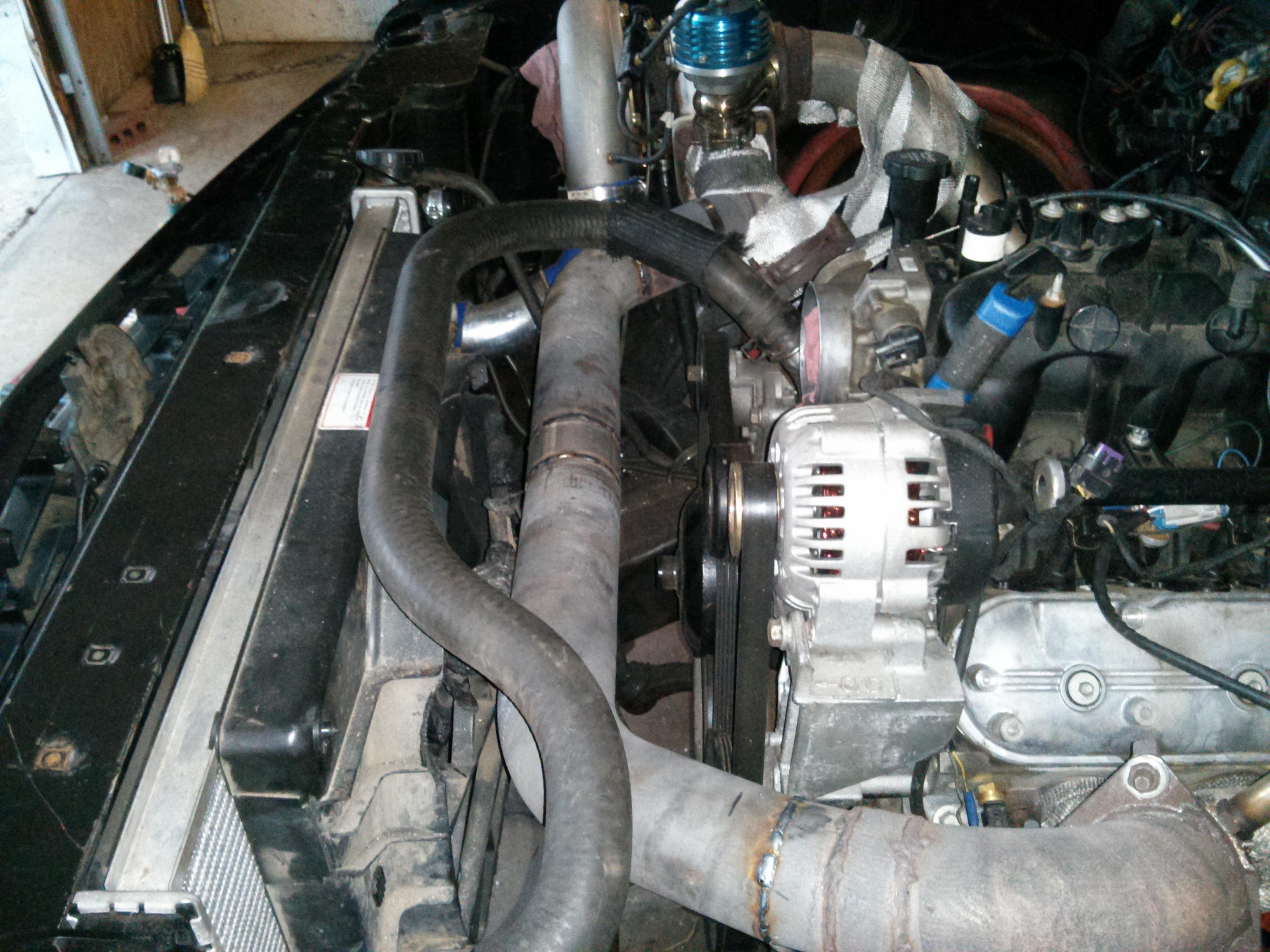

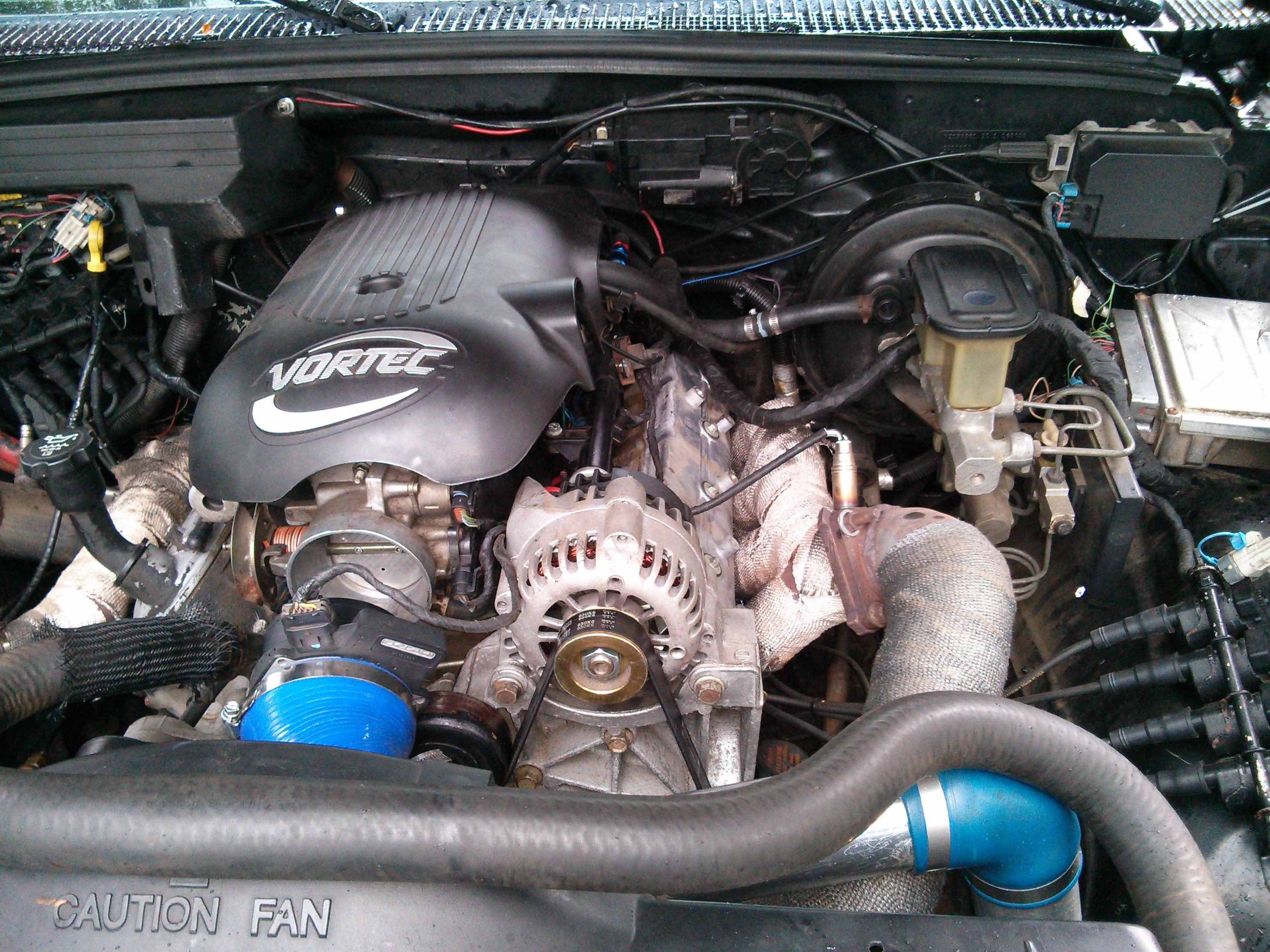

Badass! Where's the engine pic?
Old 06-26-2013   #7
93gtpeater
Location: stillwater
Drives: cbr 1000rr repsol
Posts: 1,451
Re: project darkness
I forgot to get them this morning. I will get some when I get home in an hour

Probably want to hook up the MAS and pipe as well.
Old 06-26-2013   #15
93gtpeater
Posts: 1,451
I took that coupler off to do some measuring...

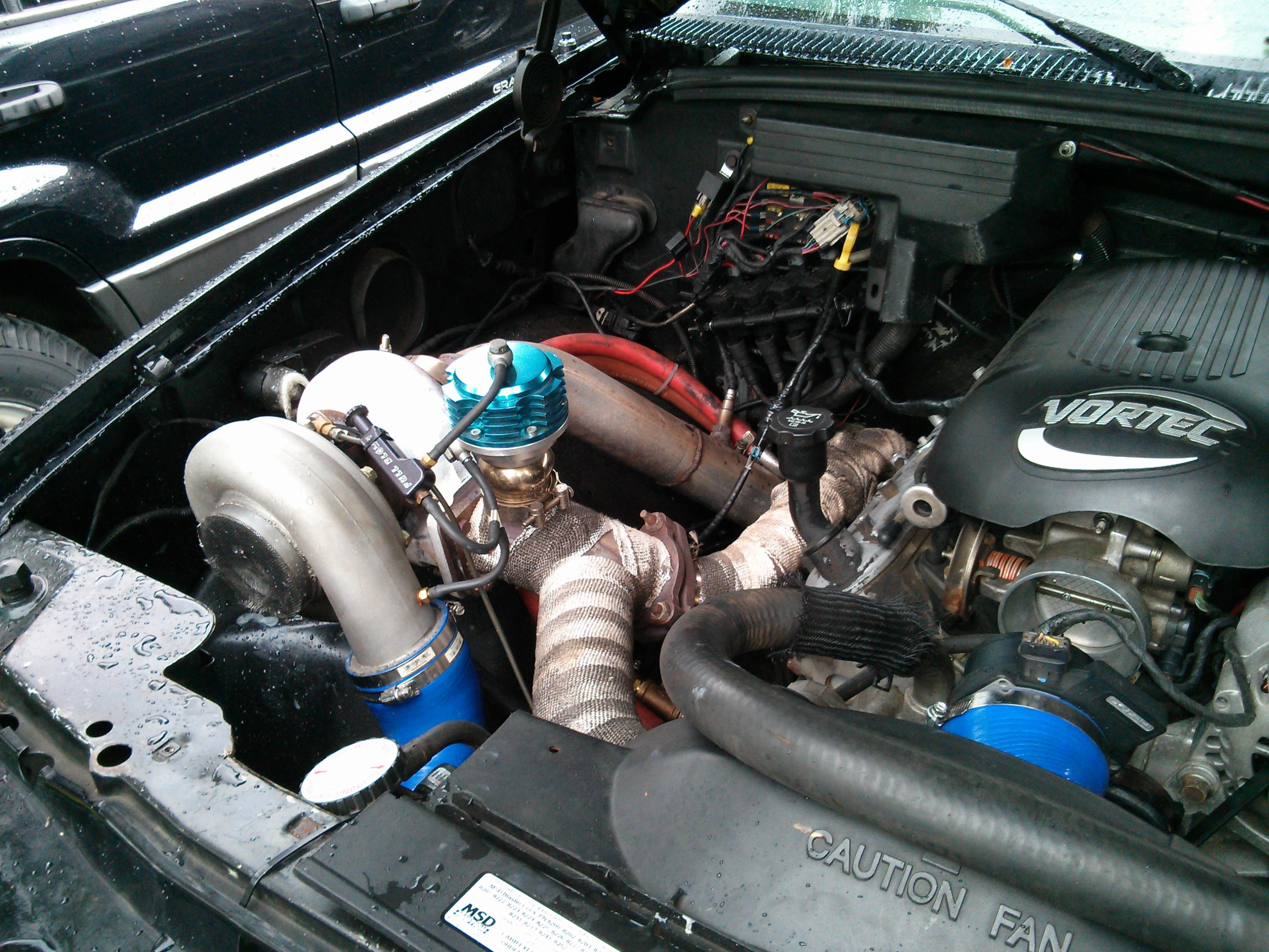

Gt45 and only 10psi do not compute in my feeble dsmer brain lol

Please put a wastegate dump tube on it... I have no clue why Jeff's dumbass couldn't do that..

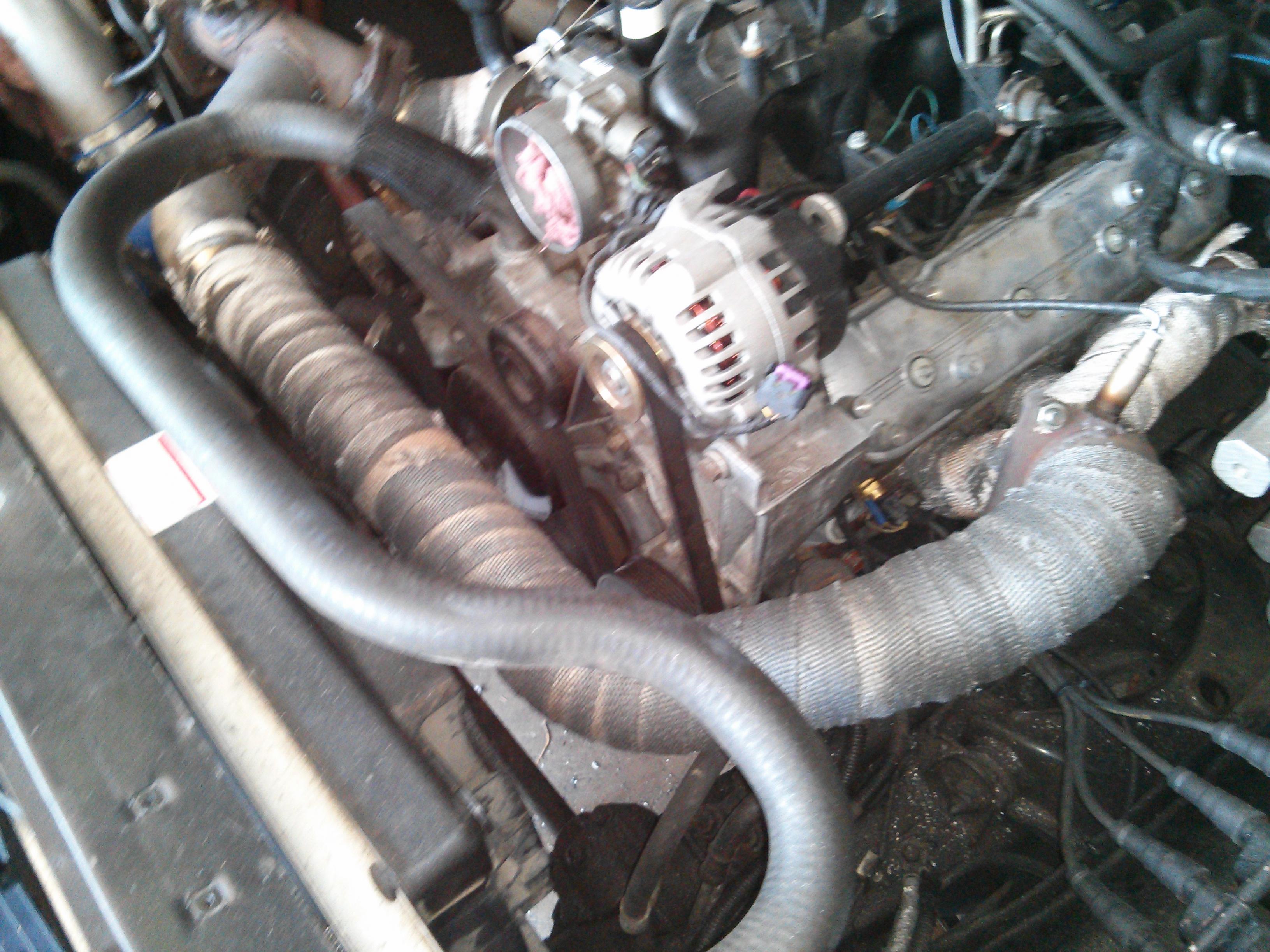

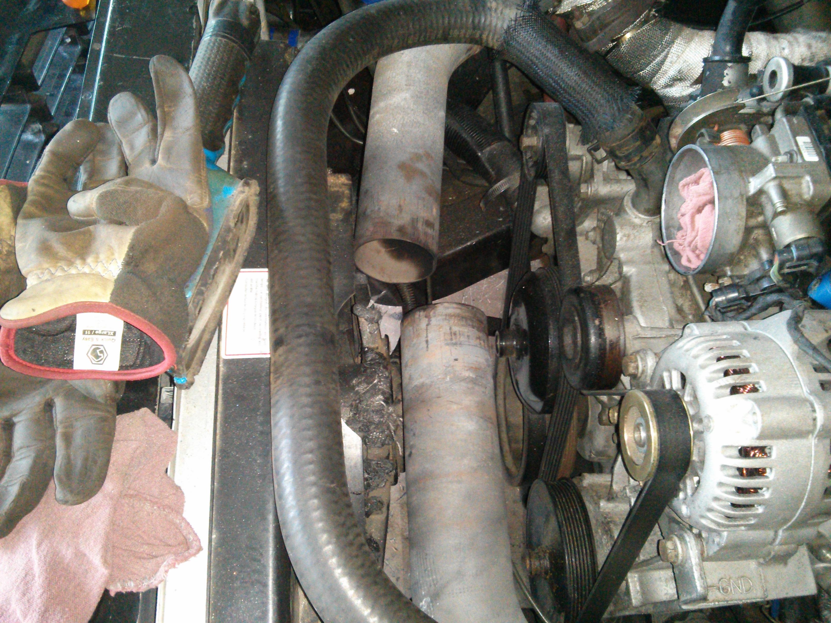

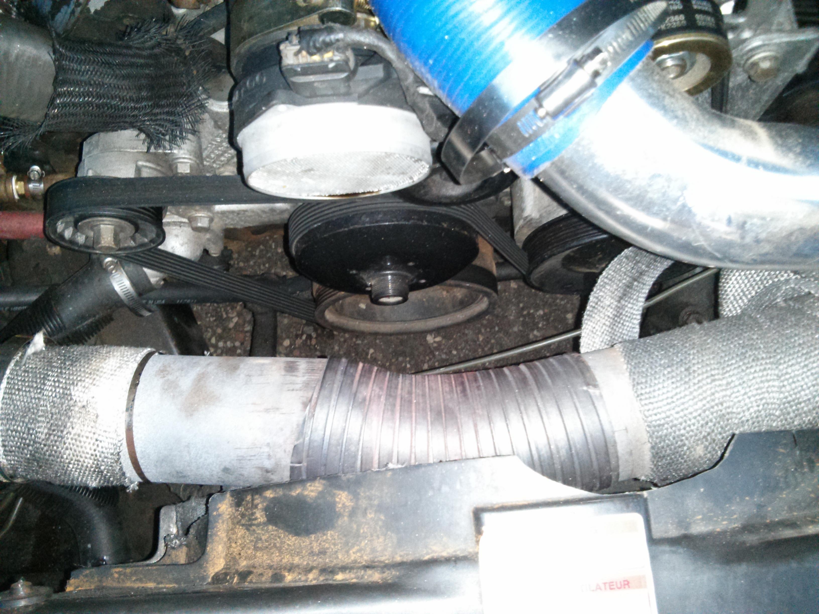

Well I been busy this weekend working on the truck. I fixed the exhaust cross over pipe this weekend. It was way to close to the radiator fan and they had a flex pipe on the cross over pipe. I ran out of exhaust wipe and energy to finish it today. I have a new turbo on its way. Hopefully by the 4th of july I will have the truck up and running again.
