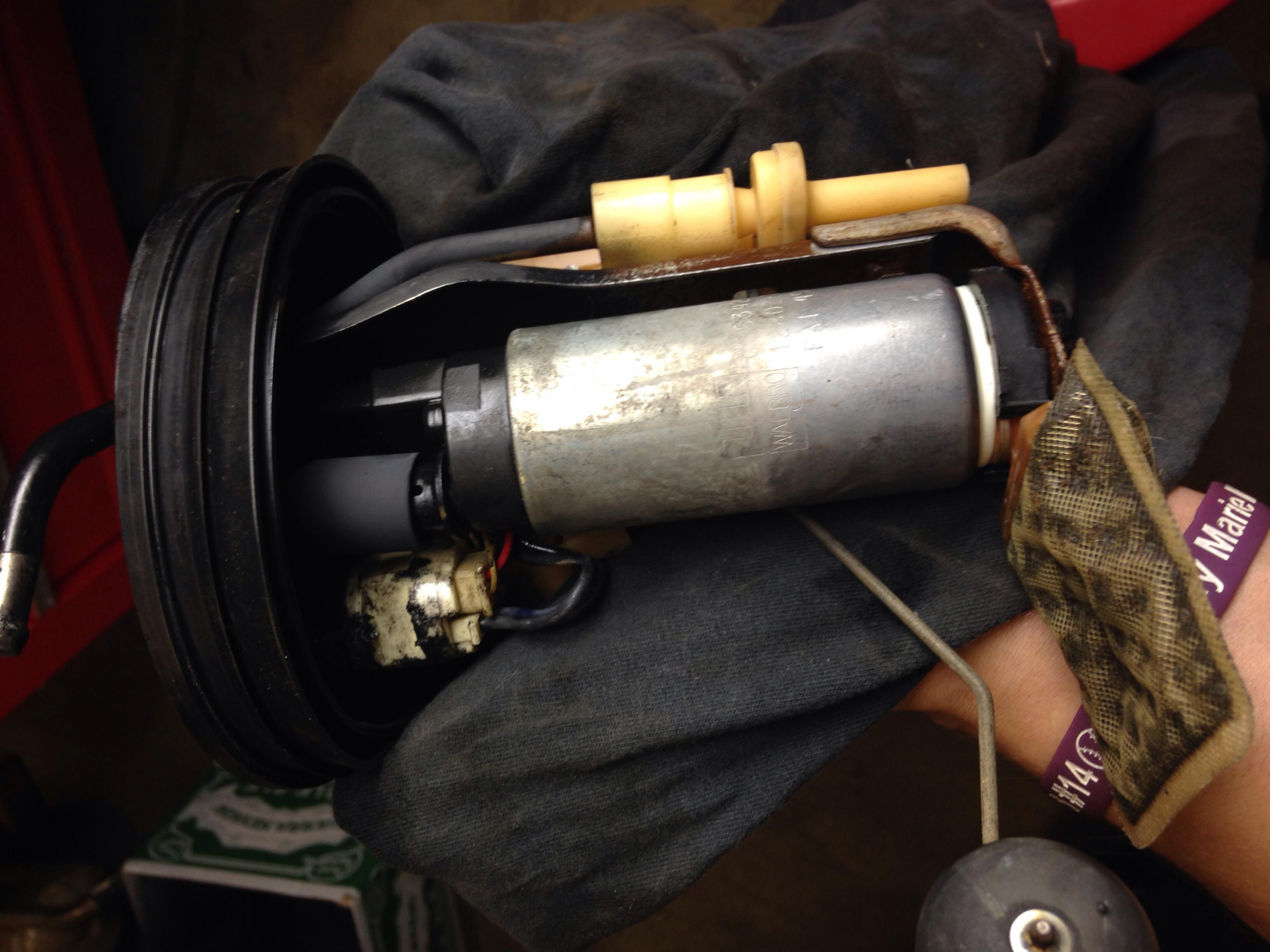

Fuel leak was at the rubber seal between the top of tank and the sending unit where the big white lock ring would sit. While fixing that I created a leak at the fitting for the fuel line and had to get one welded on.
From there I went full braided line from the tank to a fuelab filter (10 micron) then to the rail.

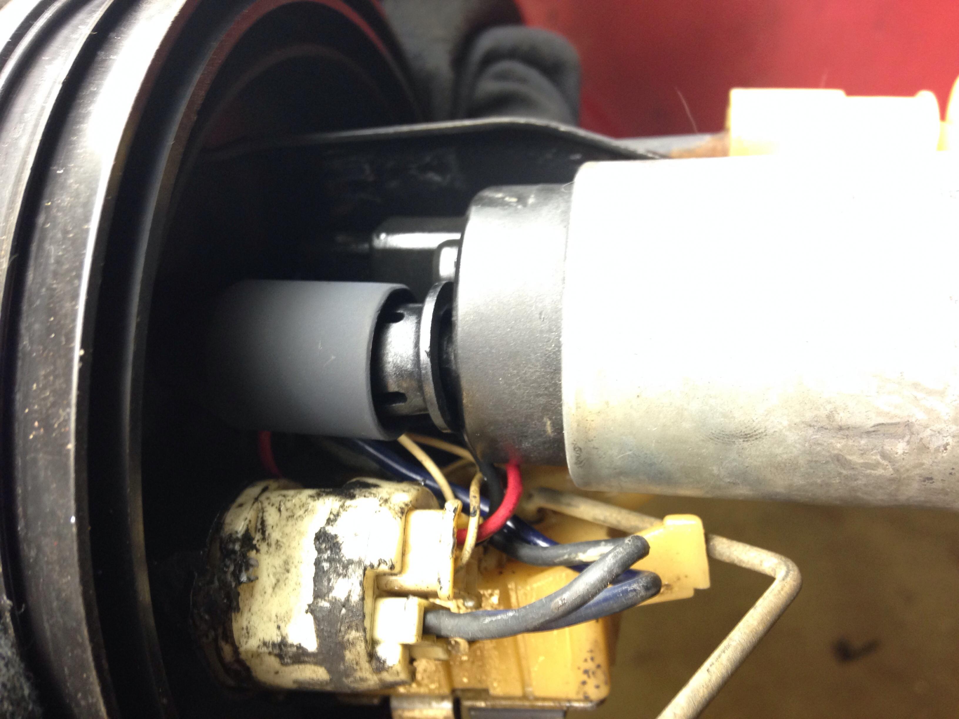

I do remember the pump sitting a little strange like it wasn't fully seated into the rubber o-ring thats on top of the pump between it and the sender but IIRC it was like this before.
Fuel pump is seeing ~13.4V after rewire.
Will check it out and make sure.
Thanks

Here's how the pump sits

Problem solved!
Thanks Asshanson.
Problem was the pump not fully seated in the sender.
