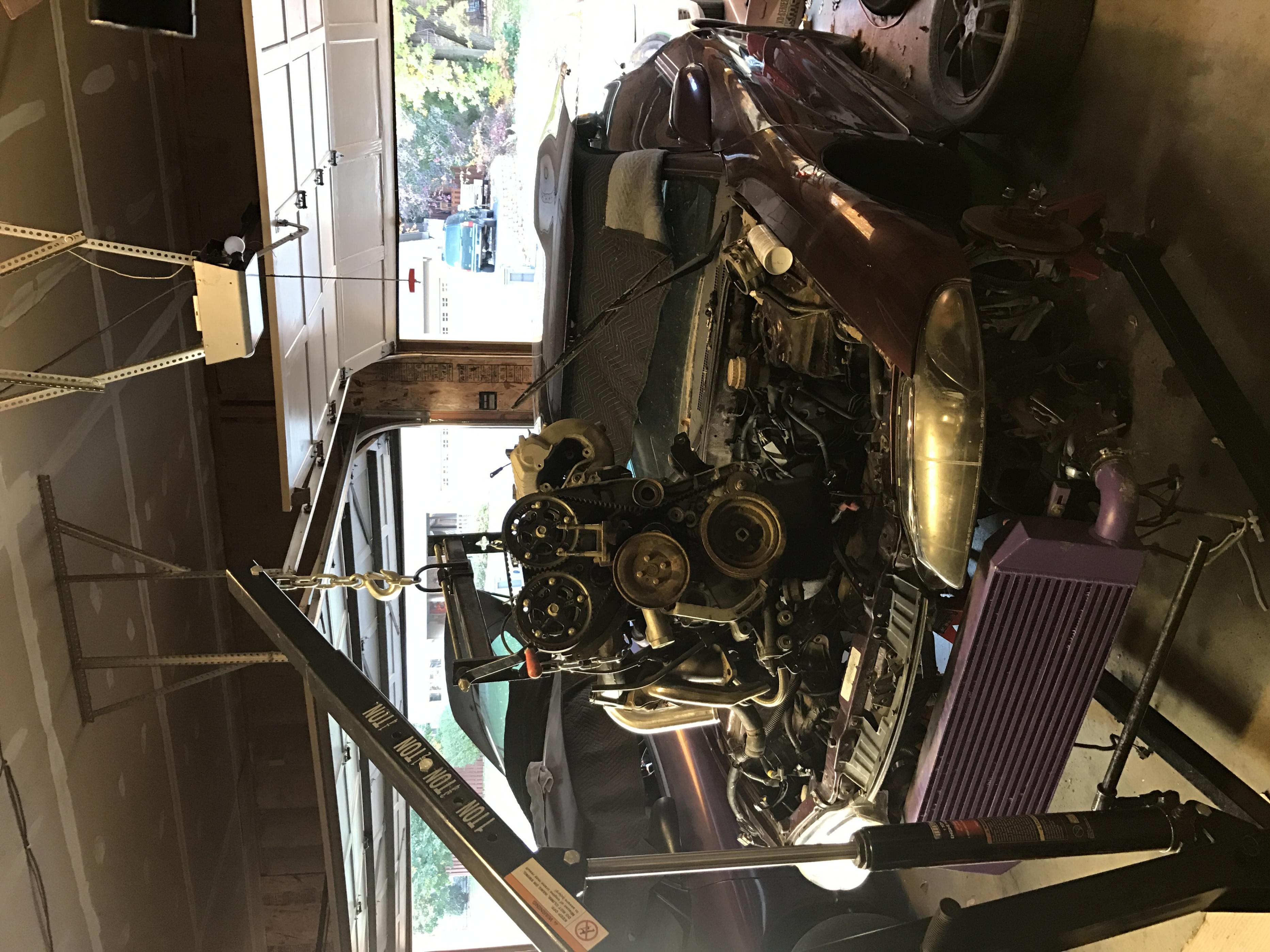

Figured this could use a build thread as well, since it's getting some attention and hopefully brought back to life. I picked this car up on Monday (10/17) after looking at it the previous Sunday. Got home and started to dig into the car and after some time realized that I've seen this car before and remember Mark (Tkr) having to replace the strut tower.. thas when it hit me. It's Blakes (97gsexx) old car! Thought that was pretty funny.
Anyways I bought the car knowing it had a few issues. The guy tried to do a 6 bolt swap and said he couldn't get spark when he tried firing it up. It doesnt have DSMLink and I also noticed he had the CAS wired up to the wrong sensors so I'm thinking that's the issue. It also has some rust (none on the body) and a broken drivers door handle.
While taking everything apart we realized it had some goodies.
Apexi 3" turboback
AEM cam gears
Aftermarket cams (unsure of brand or what size they are)
Newer 6 bolt swap (said to have 10k miles)
Sportcomp boost gauge
VRSF front mount
Precision 680cc injectors
ACT Streetlite flywheel
Plan is to get it running and maybe do a 16g or 20g setup.

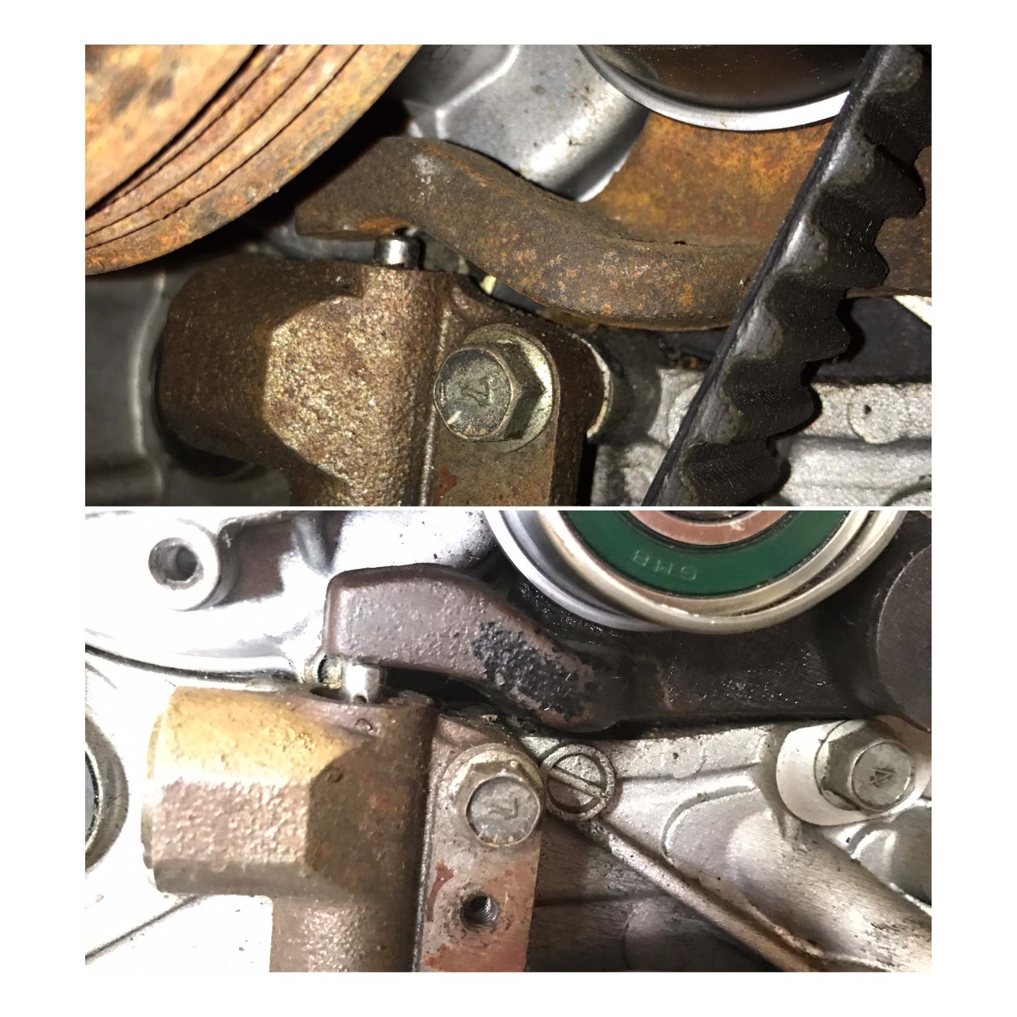

Got the bay cleaned up. Here's a before and after.. should be going back together shortly.

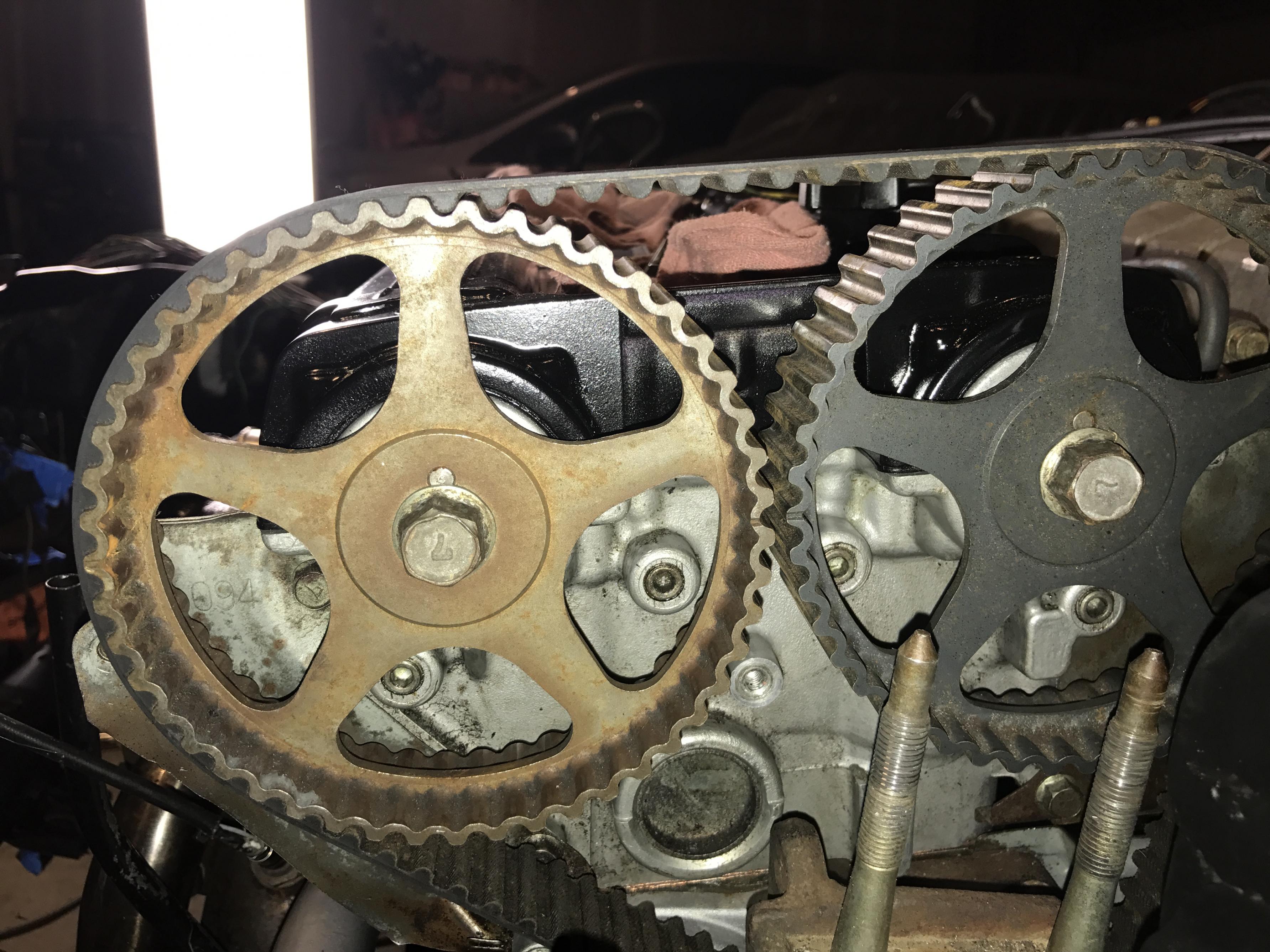

Got the engine back together.. should be going back in this week.

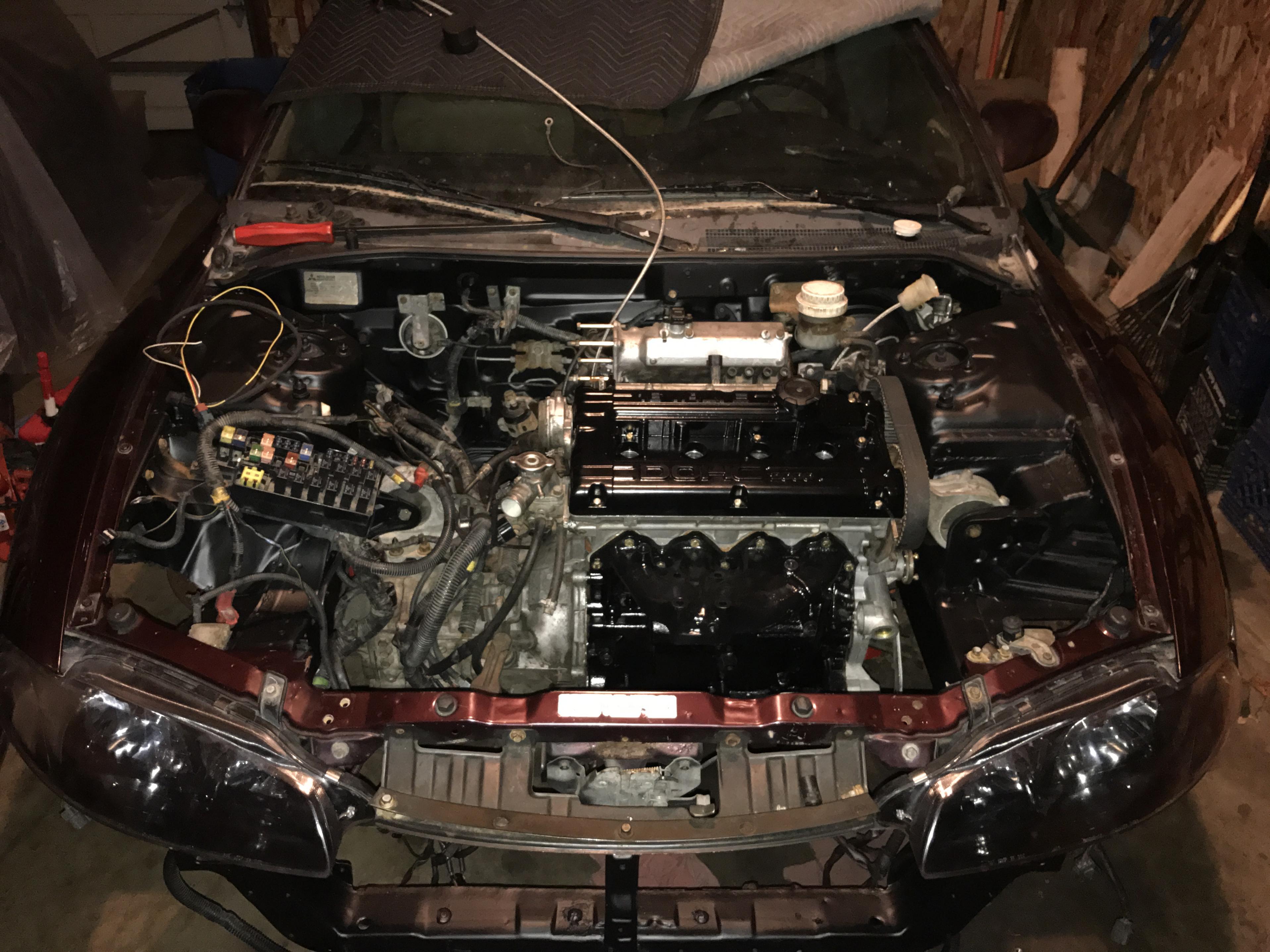

Old 11-01-2016   #8
mark4g63t
mark4g63t's Avatar
Join Date: Jun 2012
Location: Twin Cities
Drives: 95 Talon TSI
Posts: 941
Re: 97 GSX -The Rebuild
Just need a few more things and then we start it!
Put a straight edge on your cam gears and line up the marks with the center of the bolts, your marks look off a bit. The belt tension looks a bit tight as well, but that might loosen up once you rotate it several times.

Agreed, the marks look slightly above center.

Here are some better pics. I think I will be ok, only thing I could see would cause misalignment would be that I'm using two of the same gears. I did read and ask a few people if it would work and all said yes. Let me know what you guys think tho!
Your bottom marks are fine but your top isn't. Check it with a ruler, I guarantee you're one tooth off.
Same gear doesn't matter, they're marked on both sides to be universal, at least on 1g's, 2g's had the cam position sensor I believe.

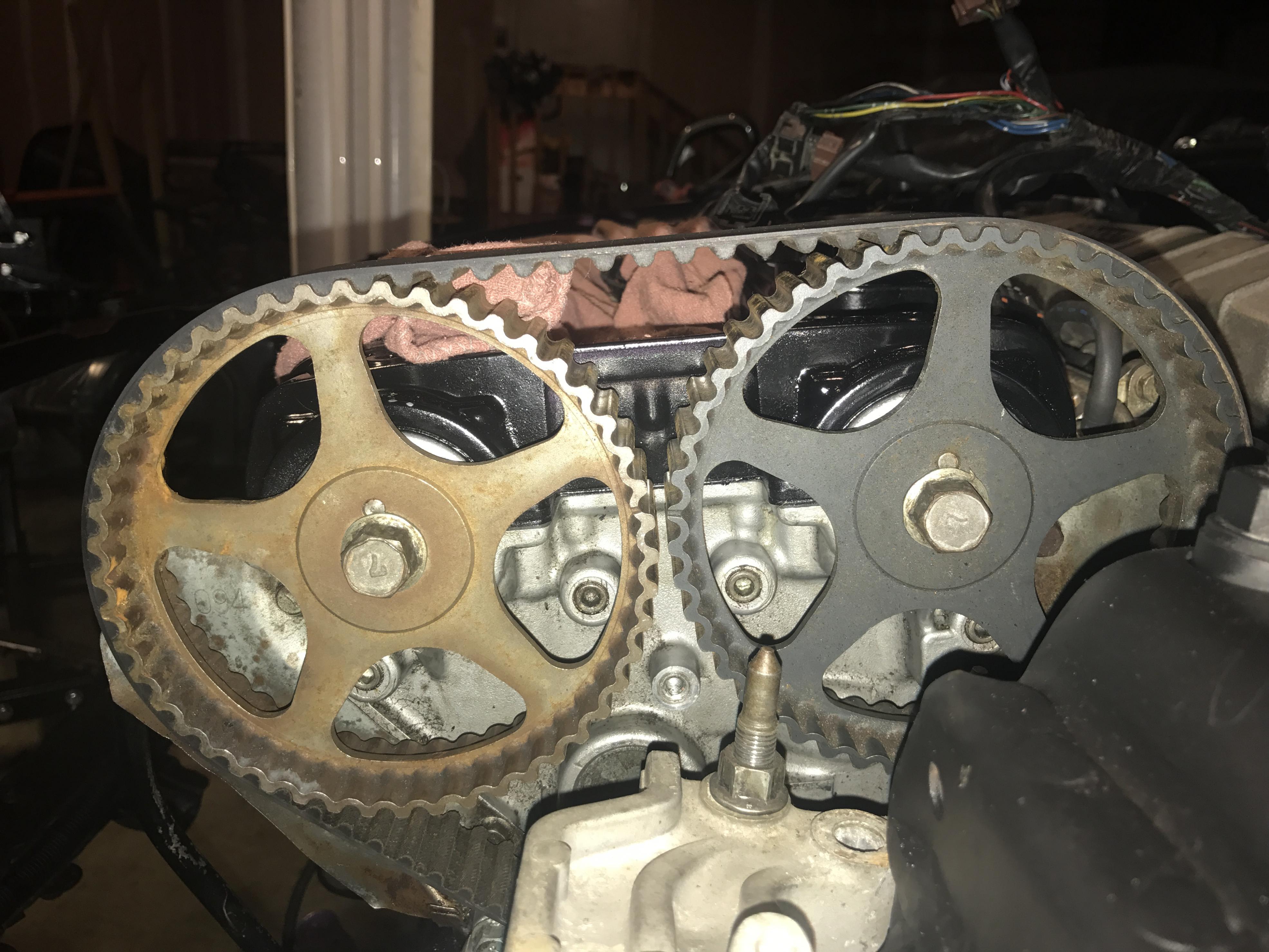

Redid the timing. Look better? Also got turbo on. Found out it's a small 16g! Been hurt and unable to work on the car much so it's taking a little longer now.

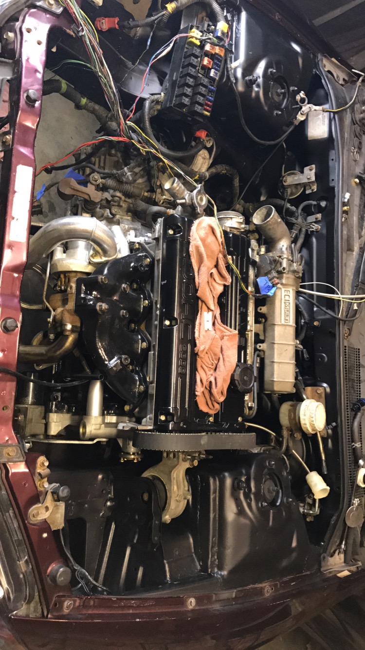

Finishing up the wiring harness. Had to lengthen 2 plugs. Hoping to start it up tonight then finish putting the suspension, tcase and exhaust back on.
Crossing my fingers this engine doesn't have any problems.
Much better.
