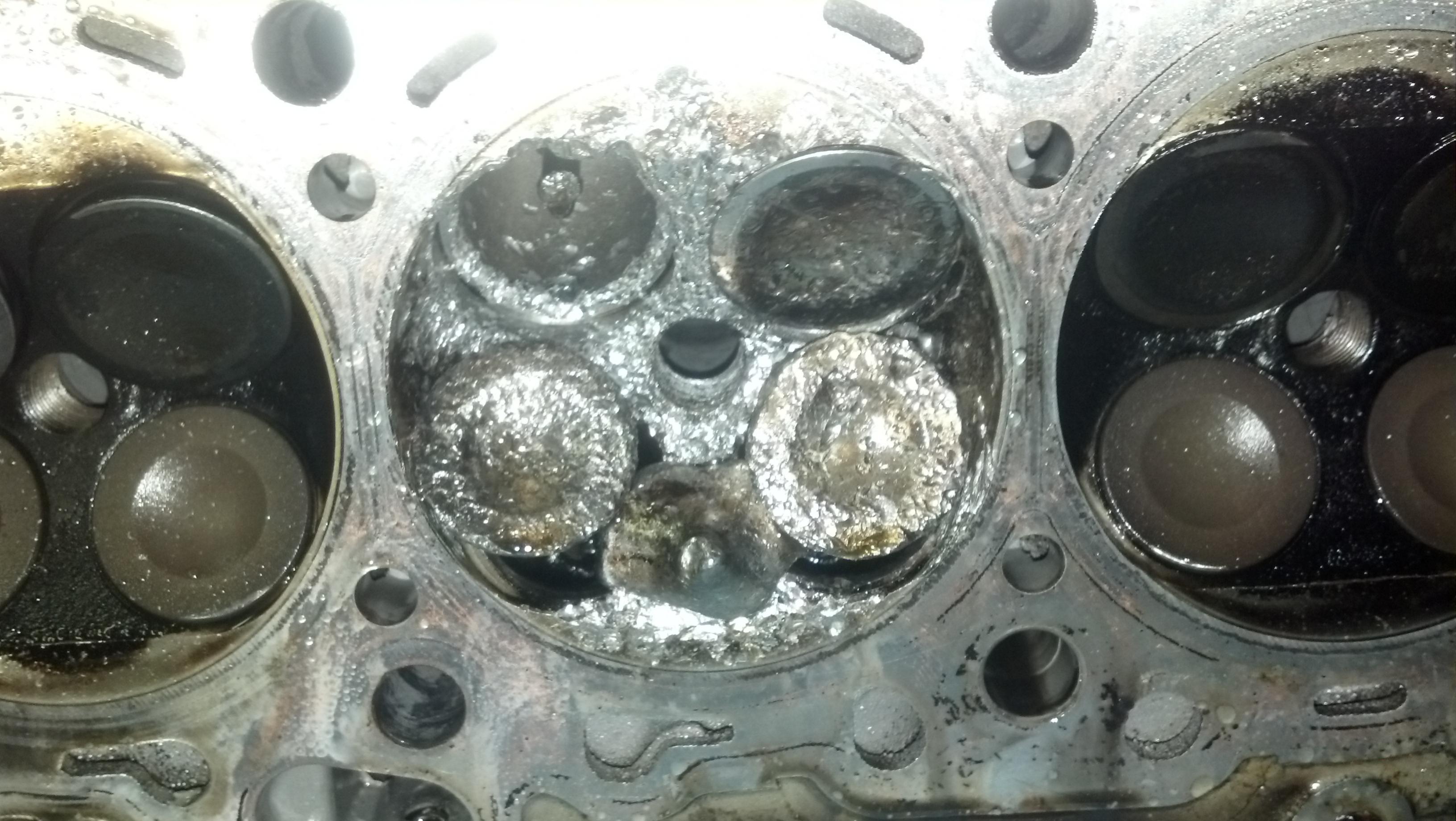

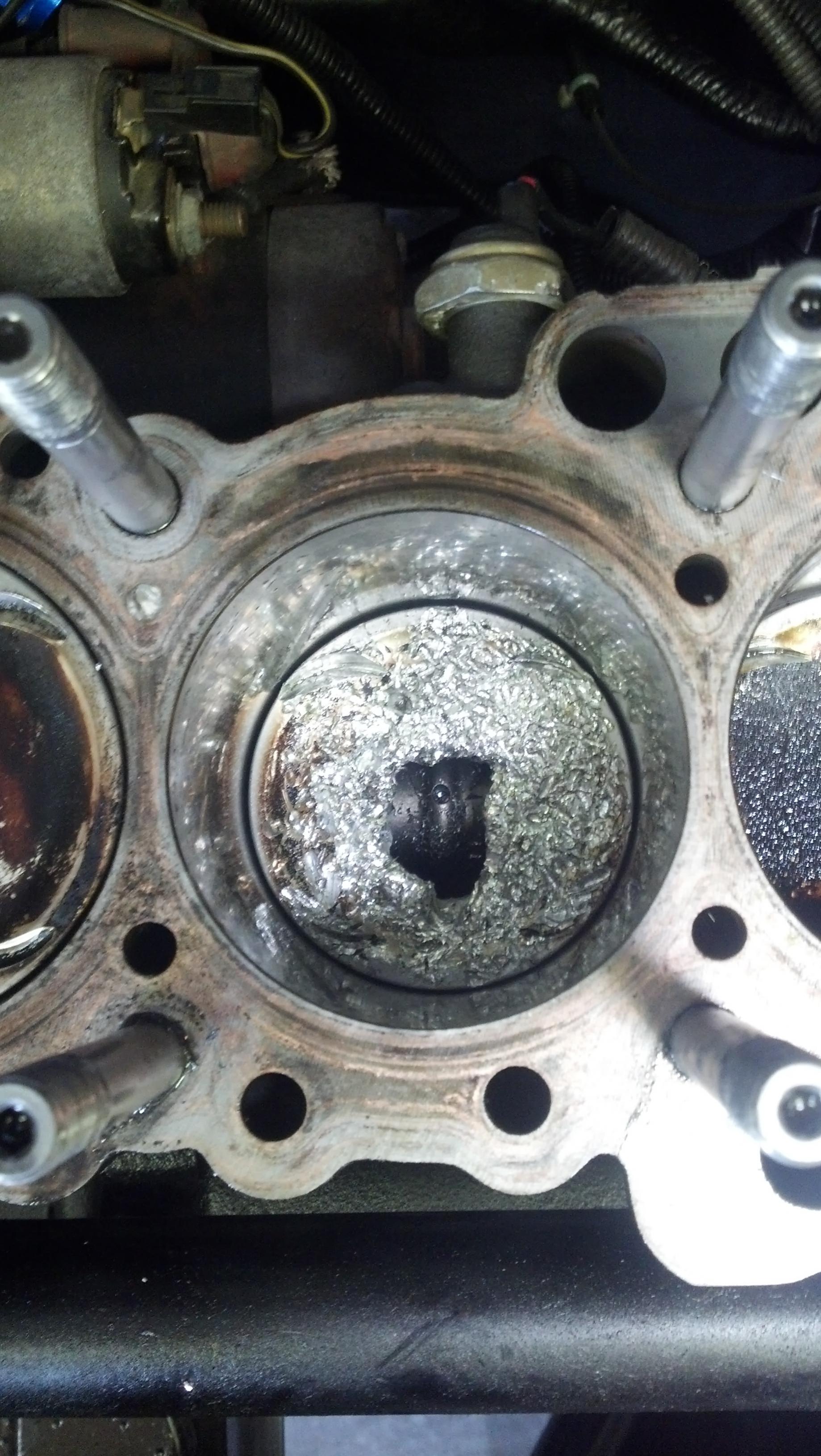

I bought the car figuring It I would be pretty set. It just needed to be tuned for new injectors and I'd have an awesome car to putz around in this summer. Well with the way my luck goes I'm about 90 percent sure something went wrong with the #3 injector (i'm going to have them bench tested to verify) and the cylinder pretty much ate it's self. they were brand new injectors too. I removed the cylinder head to inspect the damage. the cylinder head and piston were quite melted in cylinder 3 and one of the intake valves broke or melted off and did a number on the cylinder wall in cyl3.
Ok where I'm sitting now for the cylinder head. I have a good core to have my parts swapped into and it will need new valves for cyl 3 and it will have to be machined for the over sized valves. I'm debating whether or not to have it ported and polished too.
As for the block I'm not sure if I can get away with just honing it out so I'm going to pull the block and bring it someplace (not sure where yet) to have it checked out and see what the best route to go with it is. Idk if you can have a 4g63 sleeved or if it's just better to bore it out and go with over sized pistons. I would like to reuse as many of the parts as I can since all the rods look good and 3 of the pistons should be reusable. In regarding the block if anybody who has some experience with engine building as any advice please feel free to chime in. It will be greatly appreciated

Here are some pictures of the carnage

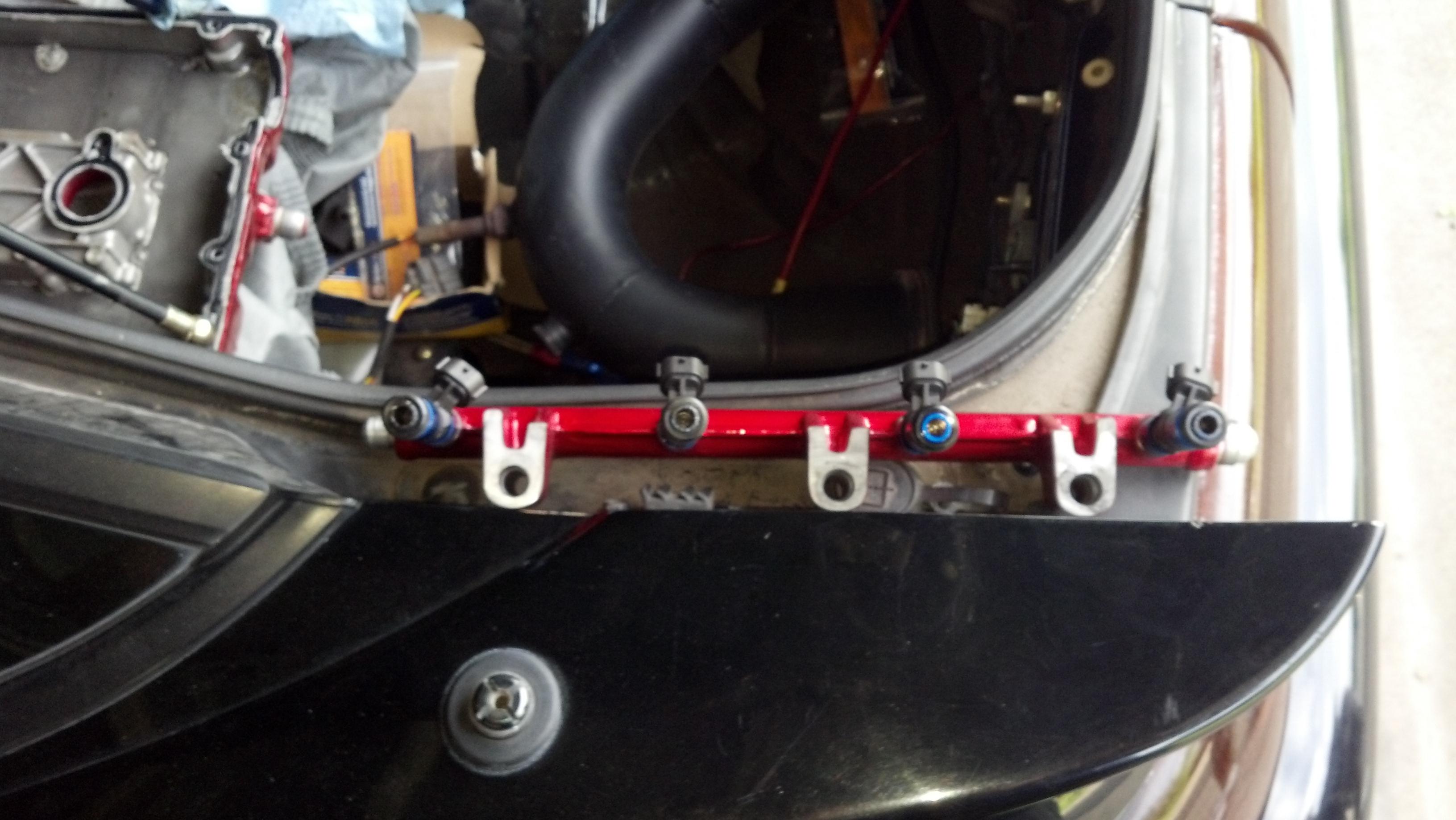

All I could fibd for failures doing a quick goggle search was that of storage. If they were not stored properly and cleaned water could get in causing irreversible failure.

That would make sense too. I guess I was leaning towards the injectors cause after it came off the dyno it was never beat on and I was just cruising when it happened. Im also leaning towards the injectors cause if you look at the picture of them you can see that 3 are starting to get dirty from the E85 and one still looks brand new. The one that still looks new was the one in the cylinder thats messed up and since its still so clean (I could be wrong) I would assume it wasn't flowing enough fuel. Im going to get them bench tested asap so I know whether or not the injectors are good

Here's a little update of where things are sitting right now. I finally was able to get the injectors bench tested and they tested good. The flow and pattern are basically identical on all of them. So it's looking like its just a broken valve that's the culprit.

I dropped the cylinder Head off at the head shop this morning and they said they think a valve seat dropped and that's what caused the valve to break. They also said that every valve hit a piston and is bent. Not sure what happened there either.
