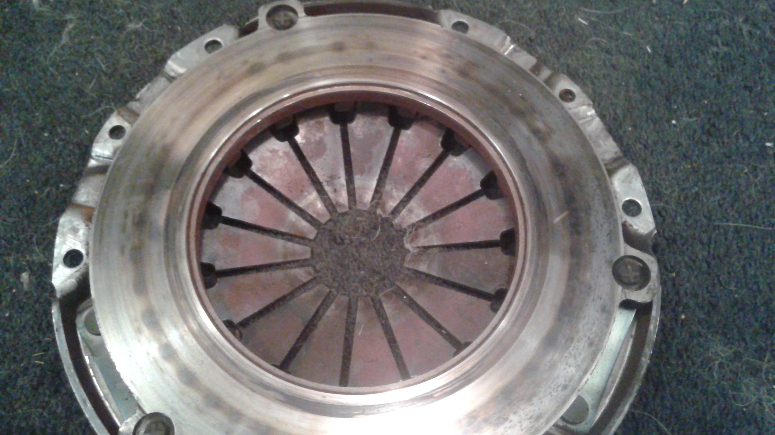

The clutch slipped under load in 3rd gear or higher. I checked all the basics,fluid,cmc adjustment and bled the system. Nothing changed so lets pull the trans. The previous owner had a clutch put in 7000 miles prior to my purchase. It appears that the flywheel was machined but the machinist did not consider step height,milling the friction surface and not milling the pressure plate mounting surface. Everything has signs of heat damage and uneven wear. The picture doesn't do the damage justice and I seem to have lost pics of the clutch disc and flywheel. Big thanks to Wade for helping pull the tranny.

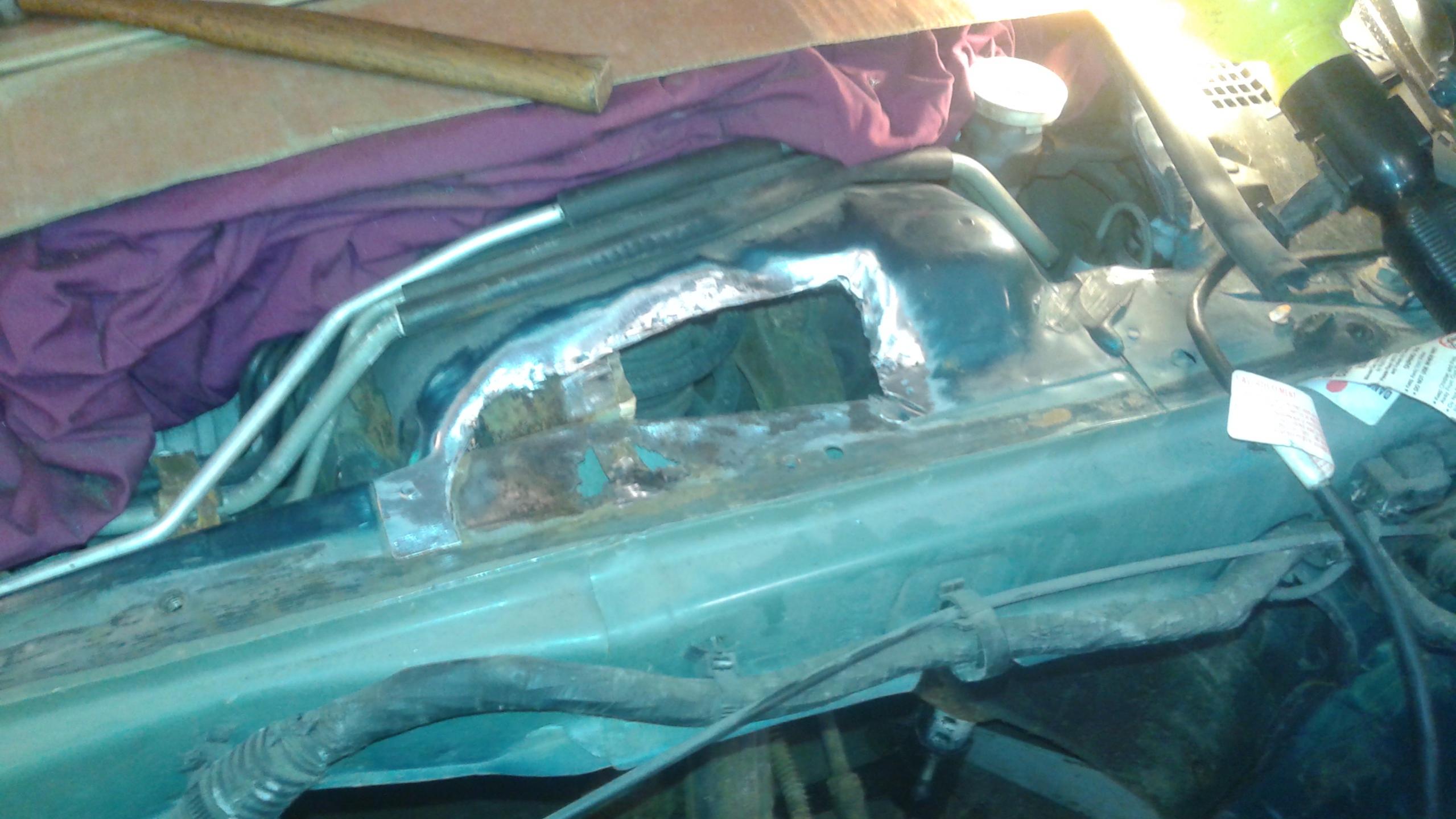

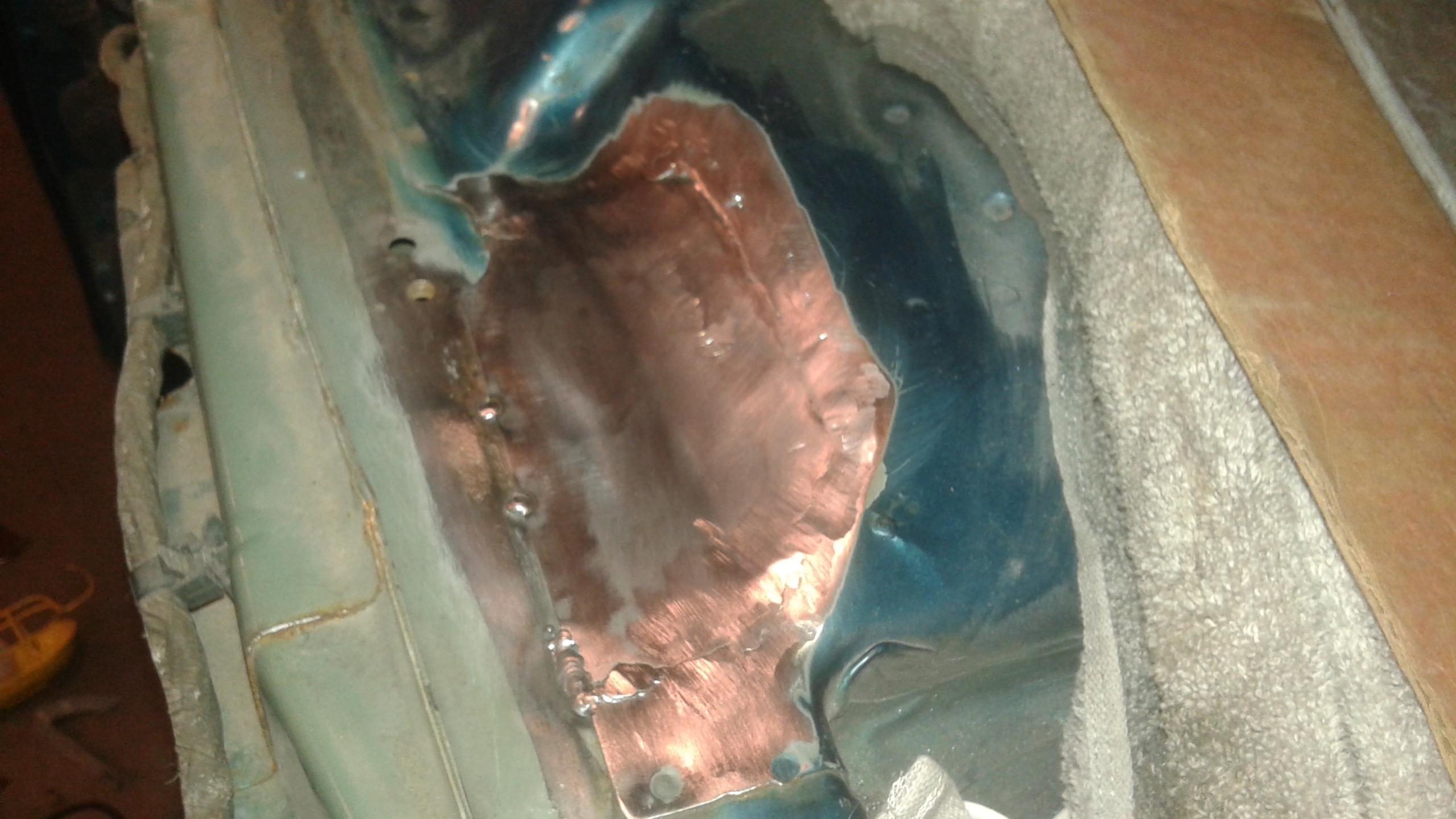

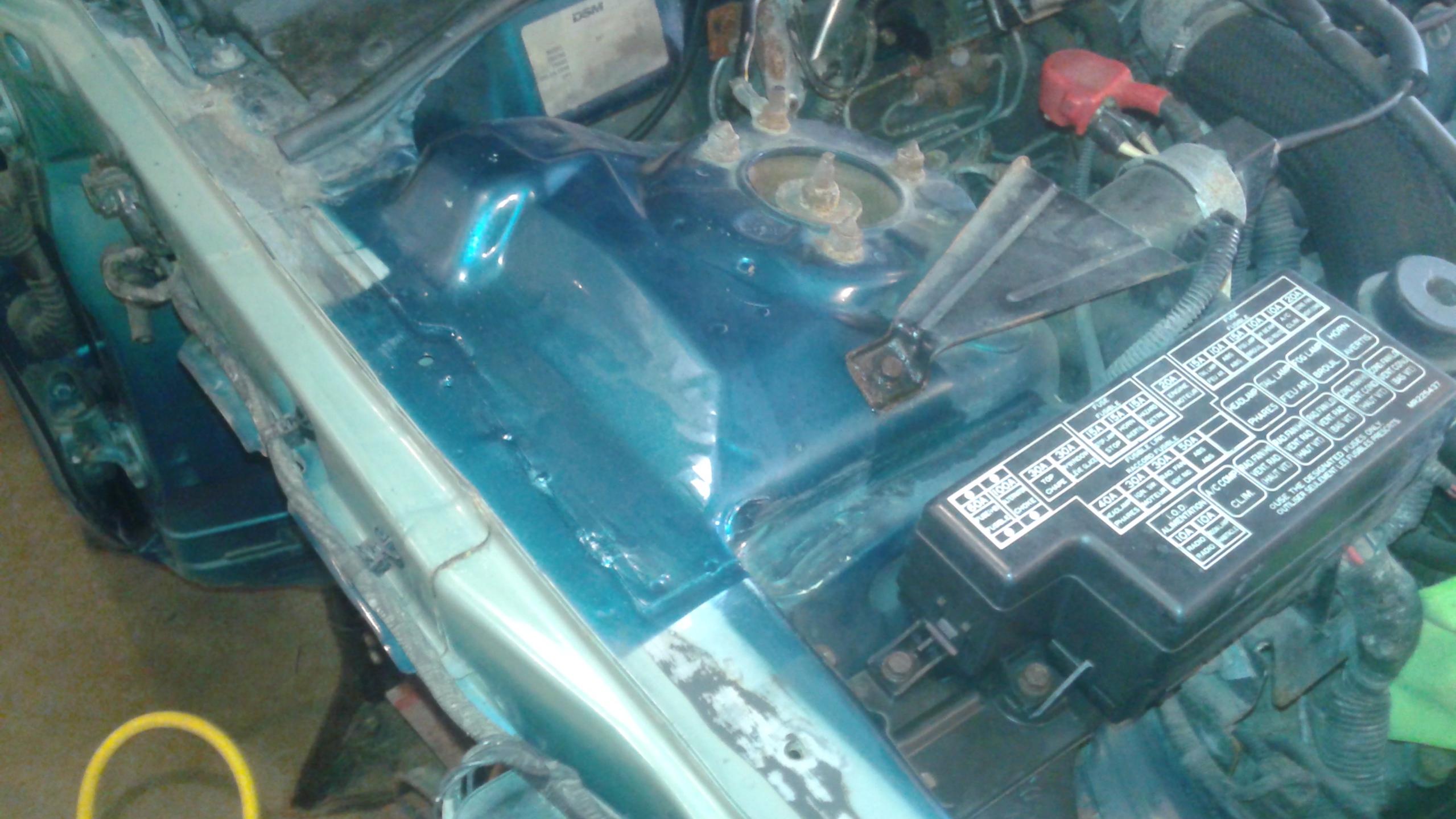

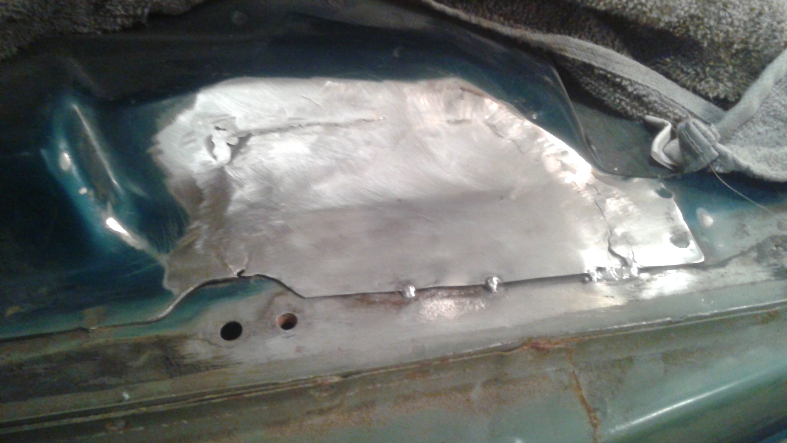

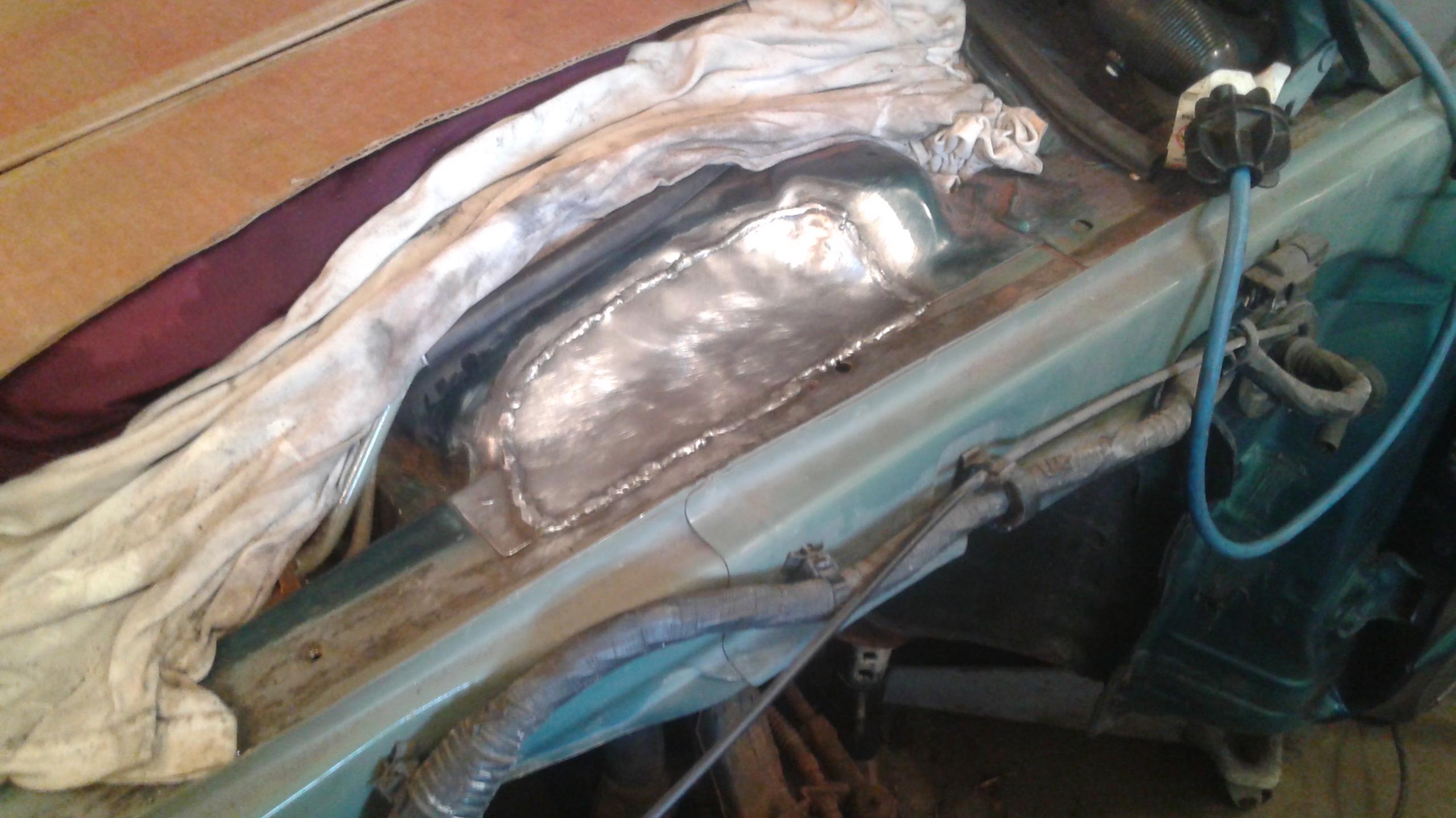

RUST!! Sometimes I hate MN. Typical 2G strut tower rust. I don't want that to spread so I cut it all out,welded in patch panels and got some PPG color match paint in a rattle can at Welle Auto. I am by no means a welder, fabricator or a body guy but I really like to do things myself if possible.

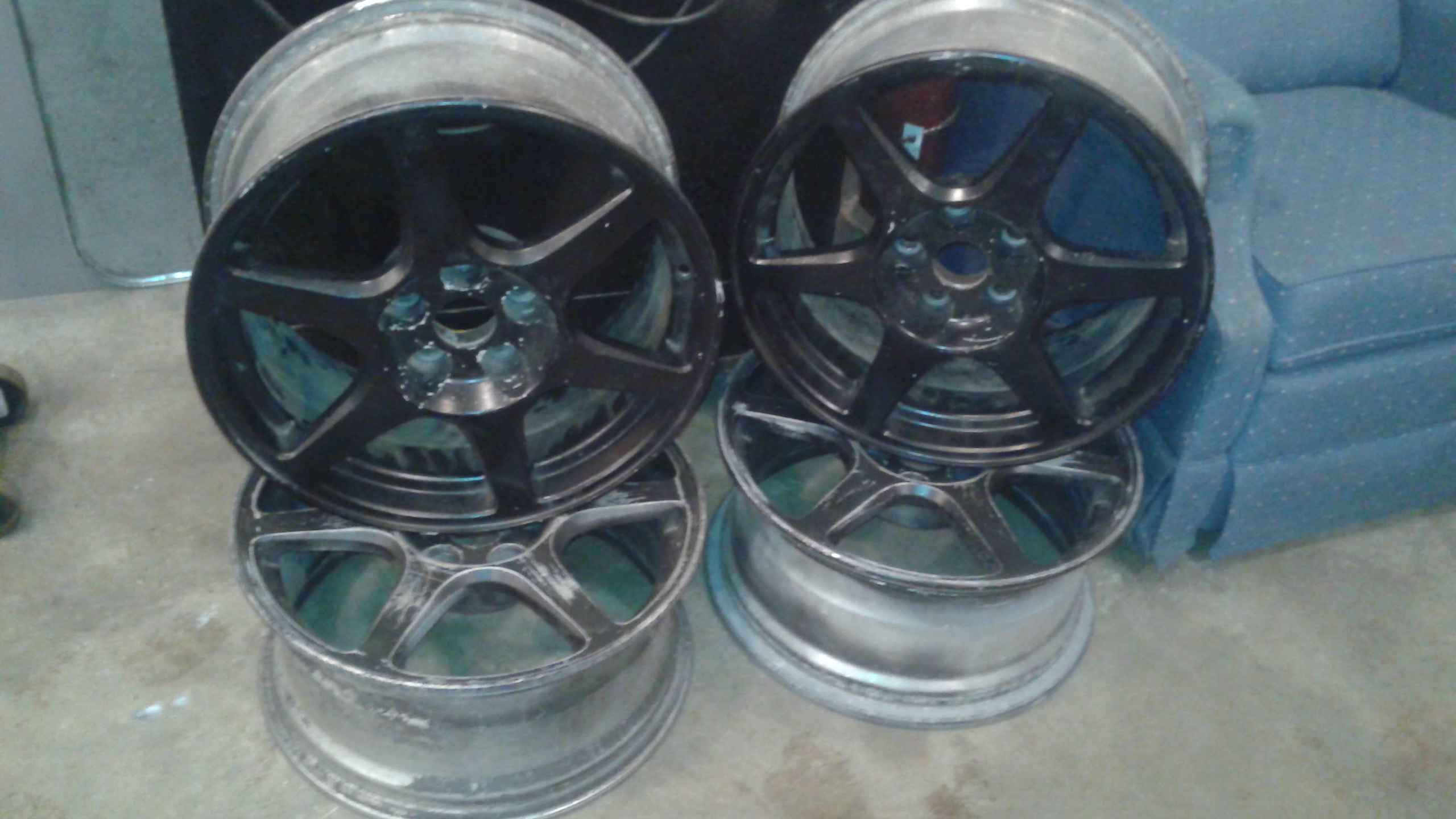

Craigslist find. Got me some Evo8 Wheels for $150. One ended up being non-repairable so I ordered another single wheel on Ebay for.....$150, dammit. Had all Wheels inspected at Alloy Wheel Repair Specialists in Mounds View. All are good so now I feel OK refinishing them.

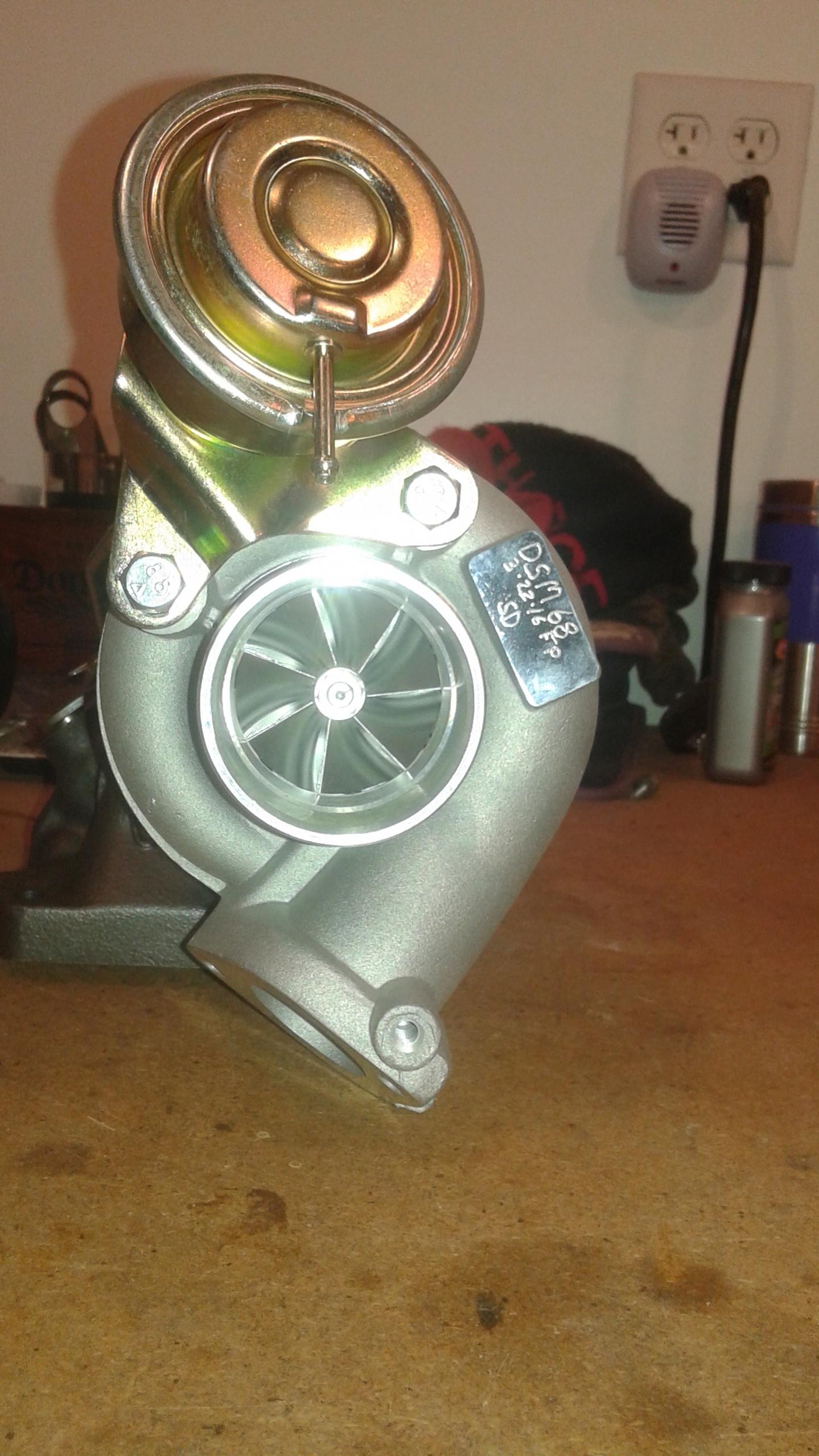

FP 68HTA
I hope this turbo lives up to the hype, a lot of people online say good things about it. I guess we'll find out.

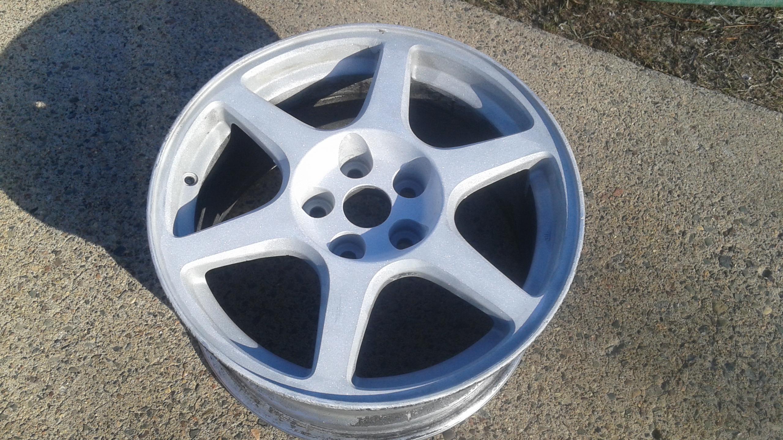

This Sunday was so nice I decided to push the car out and blast the bay and wheel wells. (and knock off a winters worth of welding,grinding and general garage dust from the paint) Getting ready for some more engine bay cleanup and POR15
I also tried out the sandblaster on one of the evo wheels.

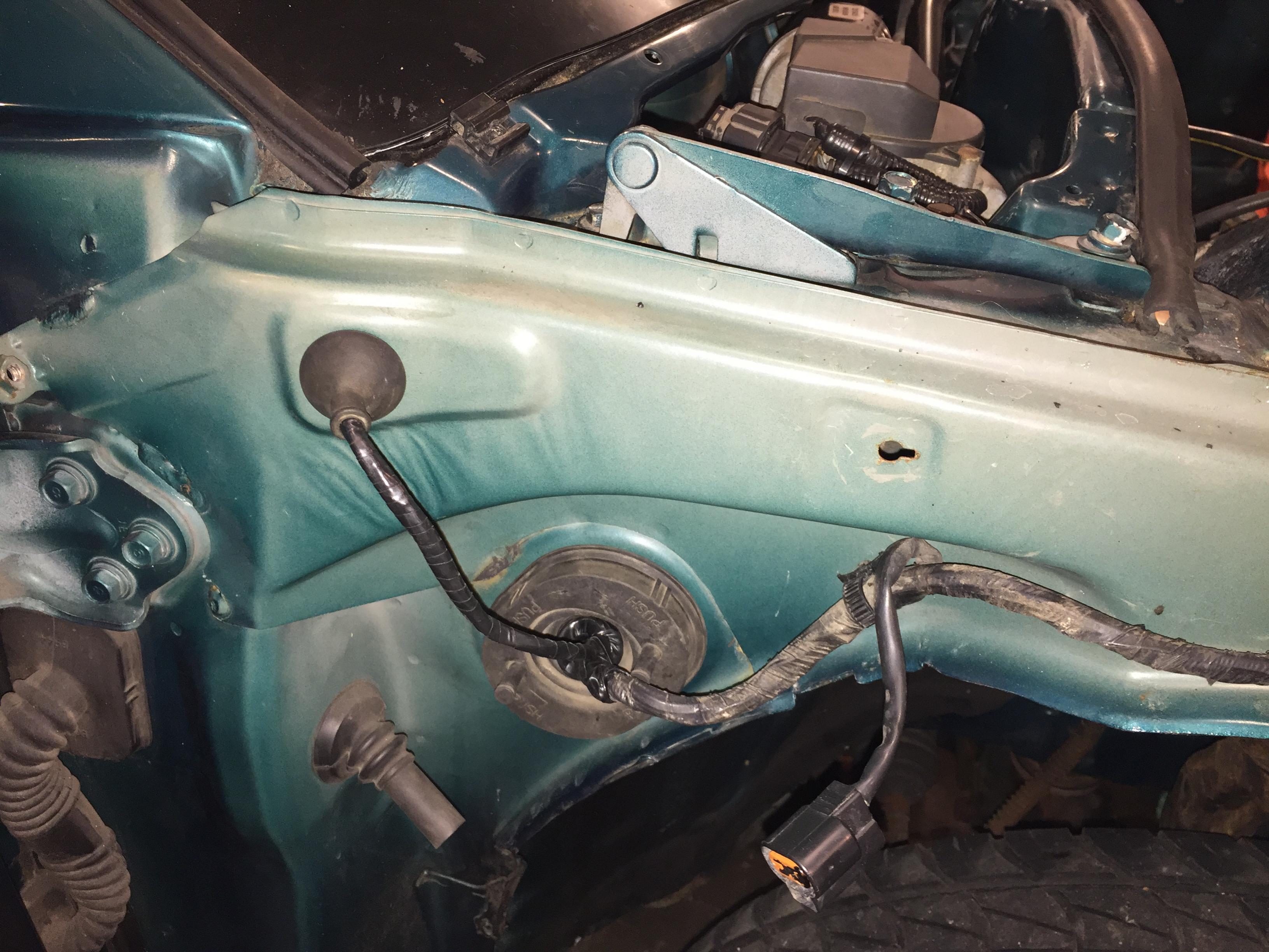

Re: My first DSM

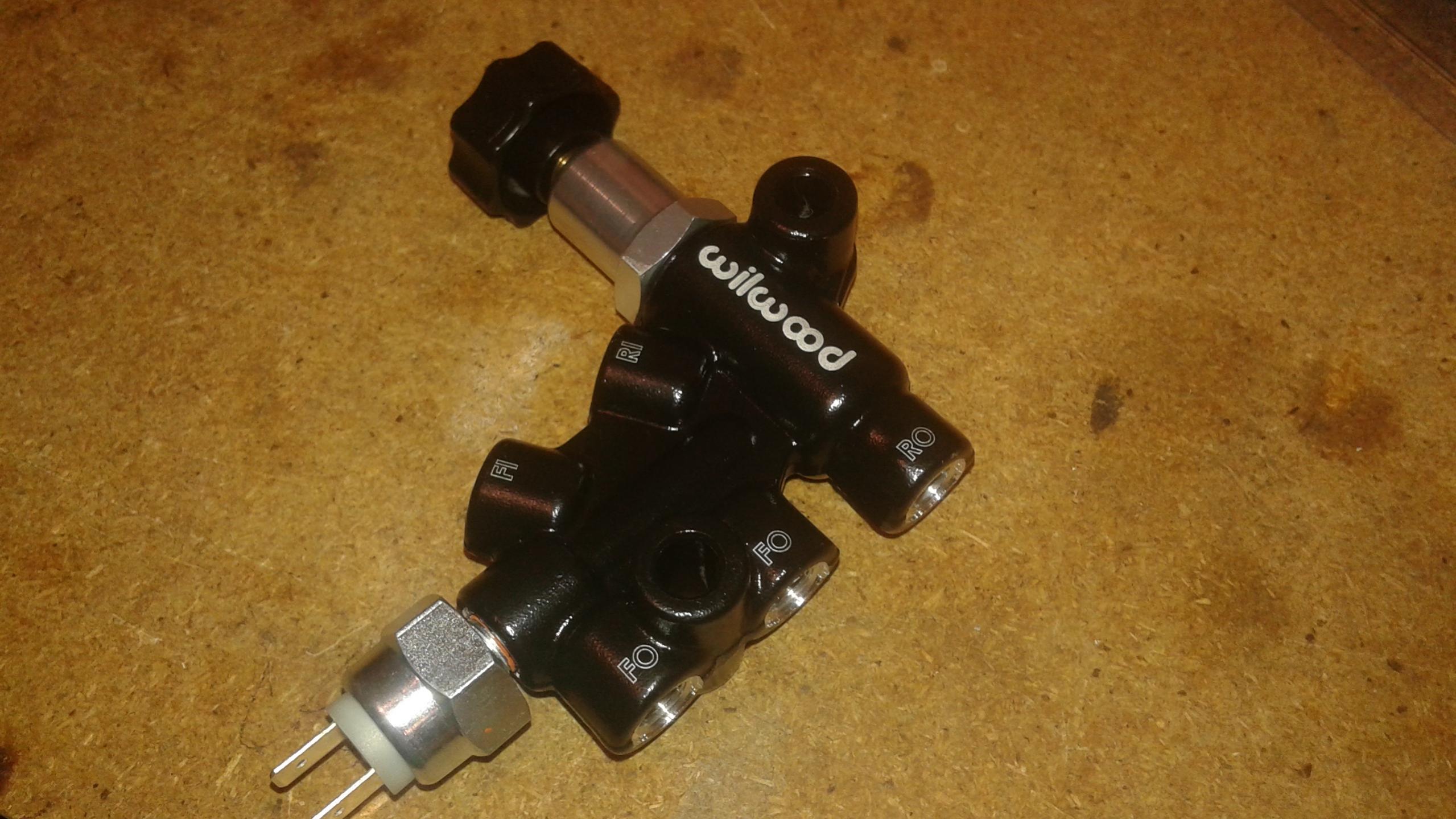

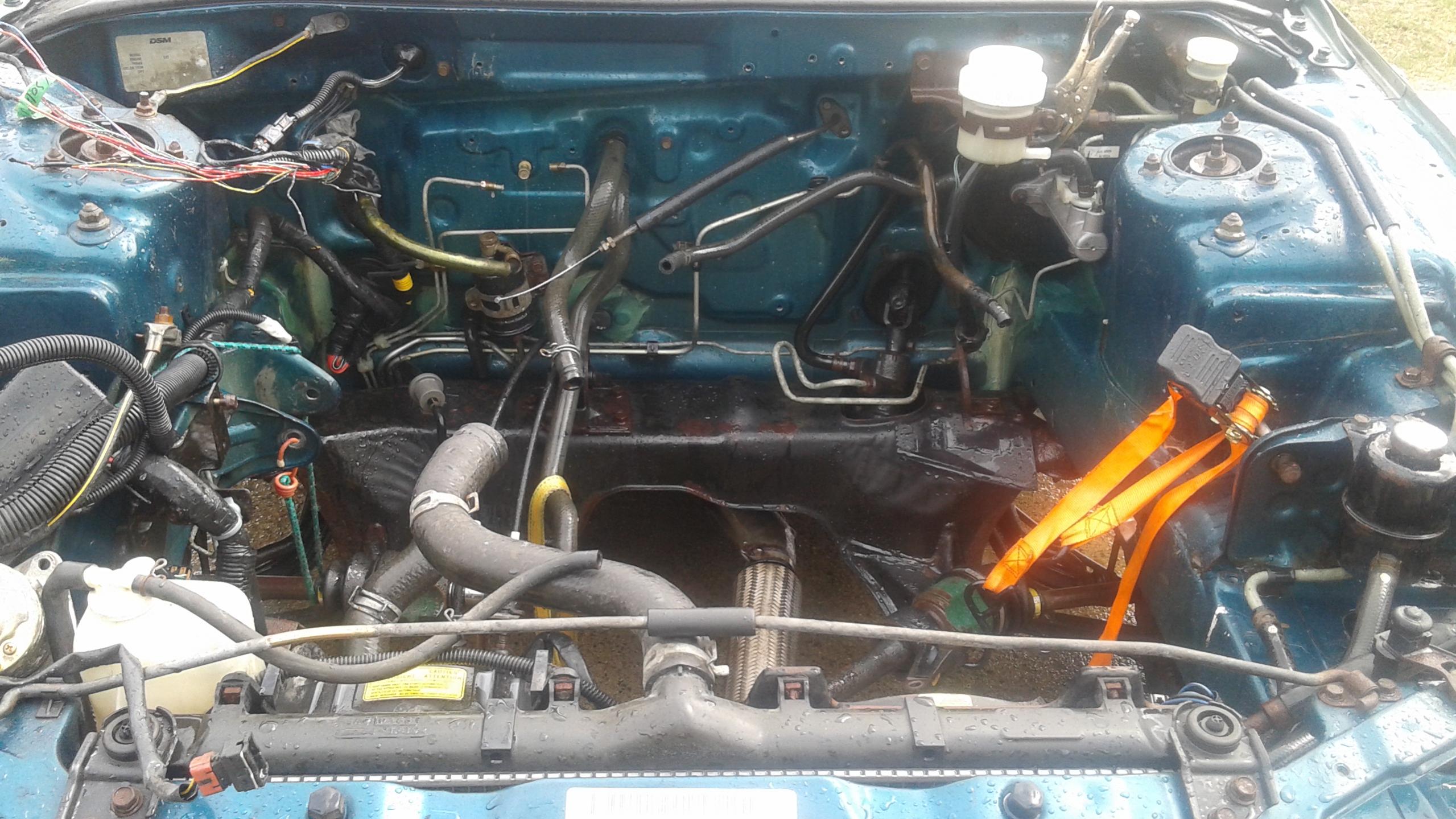

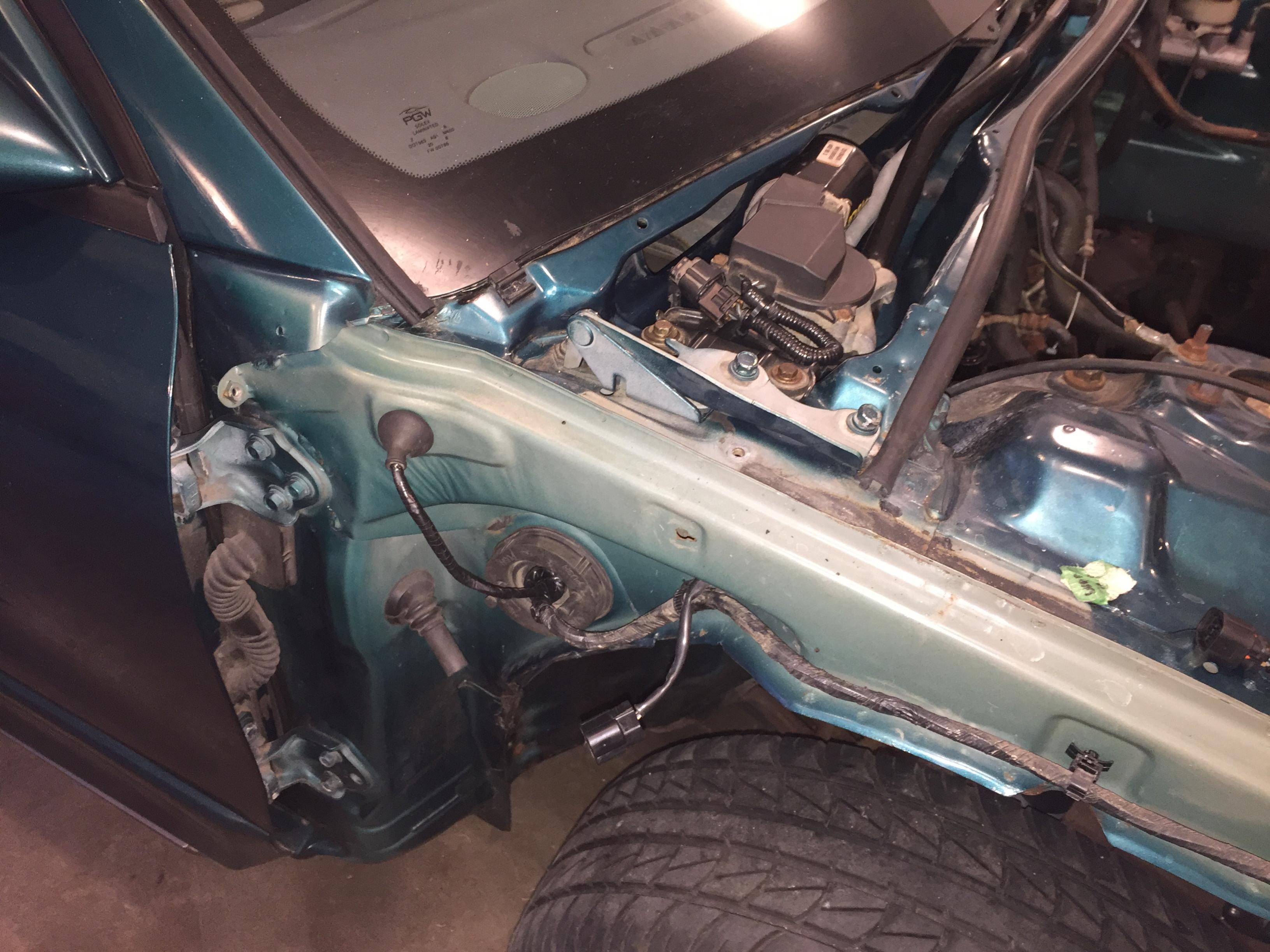

Rerouted the wiper motor wiring behind the passenger fender and down into the chassis harness into the cab. Shortened harness on the wiper motor side. Now it doesn't come out of the top of the firewall. My wiring is almost done and the wilwood combination proportioning valve should be here soon so I can begin the brake work.

Got a new toy in the mail. I need to decide if I'm going to paint the engine bay before I mount it and run brake lines though.

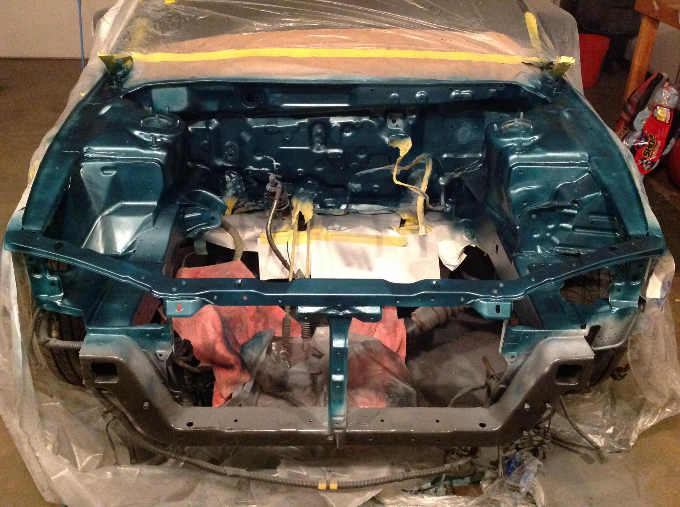

I got the engine bay painted this weekend. Lighting sucks in the garage, Maybe i'll push it out when there is some sun and take a pic. Time to start putting stuff back together.
