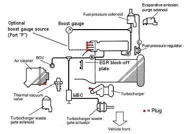

Remove them instead of just leaving them hang. If you need a good reference for a boost gauge or controller, the "P" port works well.

Just leave the important ones, BCS, BOV, Wastegate, FPR, etc...
There was a diagram from Taboo that explained what needed to stay and what could go, but I can't seem to find it right now.

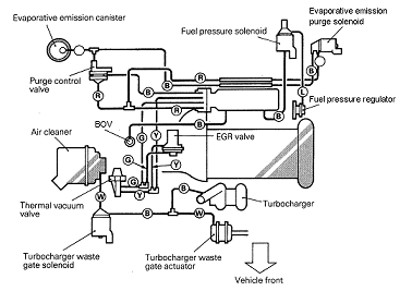

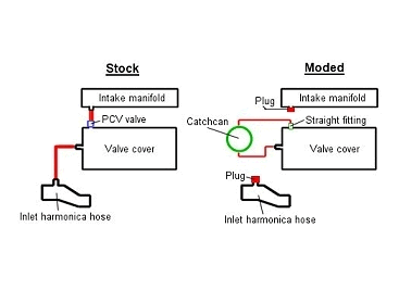

I saved these off Taboo's site before he skipped town. The first picture is what the stock system looks like. Pictures 2 is what it will look like after you remove the unnecessary junk. Picture 3 is optional. Hope that helps a little. It's pretty simple. And no don't need to keep those dangling hoses in there. When I did mine, I just ripped out all the unneeded hoses and threw them right in the trash. Good luck with it.

i hope no one uses that horrible catch can diagram

No, that catch can diagram assumes that the catch can has a breather vent on it.
