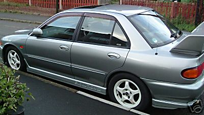

I checked before I got them
J-hot had the oem evo rims 15*6 in white that 2 were curbed and they wanted 380 shipped w/o tires
I got these for 250 w/the yokohamas
here is a pic of a evo III
