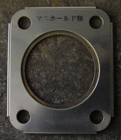

I just thought I would post up a quick pic for anyone looking to see what the visual differance is in the 2 turbo Gaskets.
The bottom gasket is the stock gasket. The top is the 7cm gasket.
Mitsu part # - MD171220 and MSRP = $22.73 + tax

Which means if you have any port work done, as in taking out the ring on the turbo, or exhaust manifold, it is a waste of your time to put the 6cm gasket back in.

Looks to be about 1 cm difference to me

And to think I thought it was an inch. LOL Yeah, I figued we have one, wh not post a pick so people can actually see a differance. And right now through Mitsu they are 3-4 weeks out for getting them.
