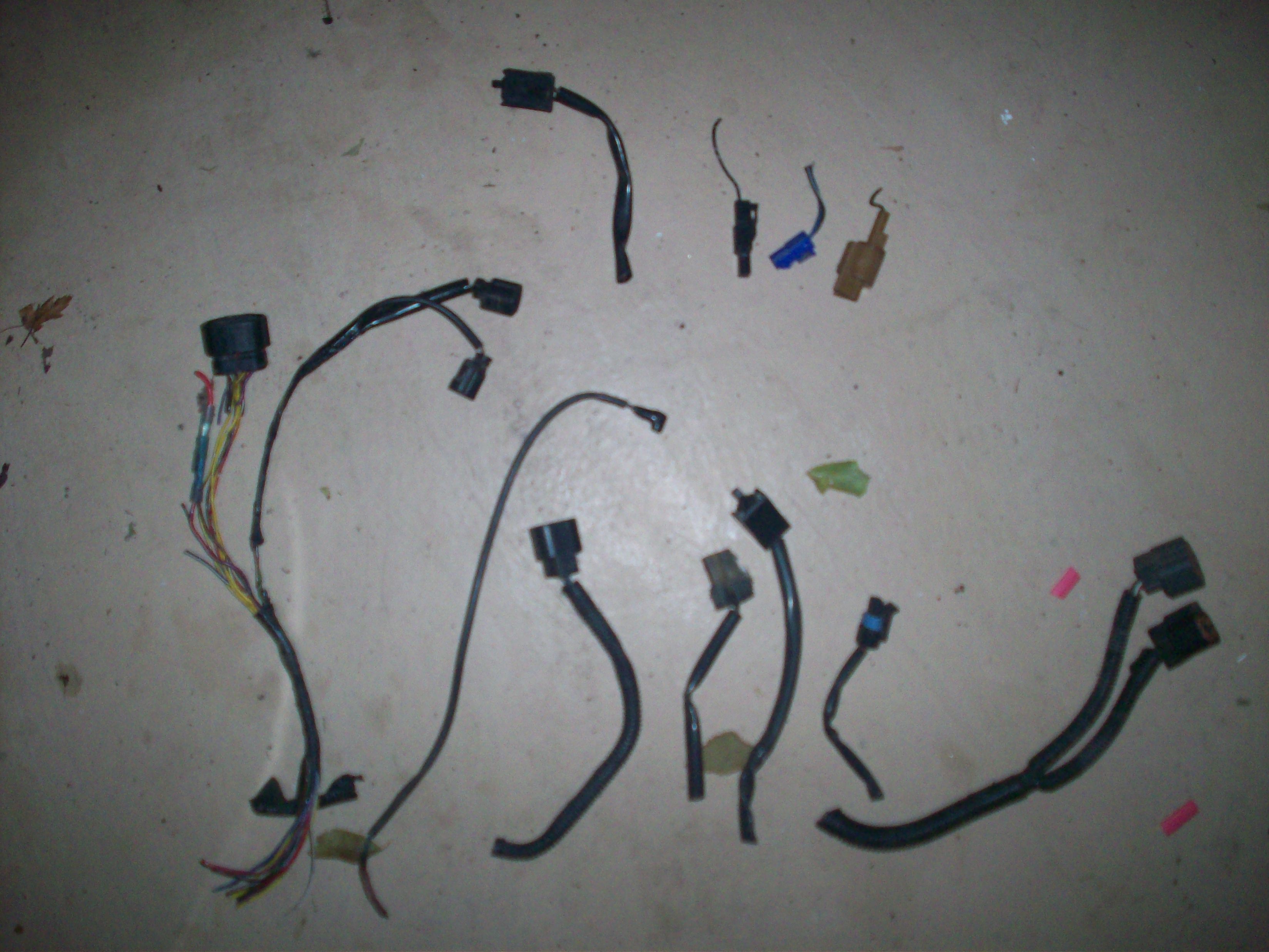

here are the connectors that were not connected to anything. now the big 12 point on the left was connected to my automatic transmission. it is looped already for the safety-neutral switch so that it can start. it starts. but runs like sh*t.... and there are 3 little connectors on the top of the picture. those 3 little connectors were taped up already from when i pulled the harness. in the engine bay, they sit high in the middle of the fire wall. do those connectors ever get connected? what are they used for? all of the other 2g engine bays i have seen do not have them 3 connected either...

i know thats what im sayin!! but no, i did not take anything off and everything worked great before i went slaughter happy... ok here are the pics of the connectors that i cut off.

Why did you cut all of that? It hides easy with not cutting any of it. Im 99% aure that you have to leave that stuff plugged in without dsmlink otherwise thats where you will get your issues with idle and drivability. Is your CEL on?

leave what stuff plugged in. there is nothing to plug in. unless you are talking about those 3 little connectors on top. and it just cleans it up that much more.

Leave the solenoids plugged in to make it run correctly. You cant unplug the wires, just unplug the vacuum lines.

Those other 2 wires are used for setting timing which you will need, also I would leave the iacv hooked up to run right but some may prefer looks over performance.

i did not UNPLUG anything kerry. the wires that are just hanging there, doing nothing. example. my ac compressor connector. i decided to snip. i didnt think that i needed them just hanging around the engine bay. but i guess i got a little crazy and snipped some shit that shouldn't of been cut. ya i do prefer my timing to be off. it sounds like a subaru this way. lol. i'm just trying to fix my mistakes and learn some shit. also. there is no CEL light on.

got it fixed. it WAS those 3 little connectors on top. THANKS!
