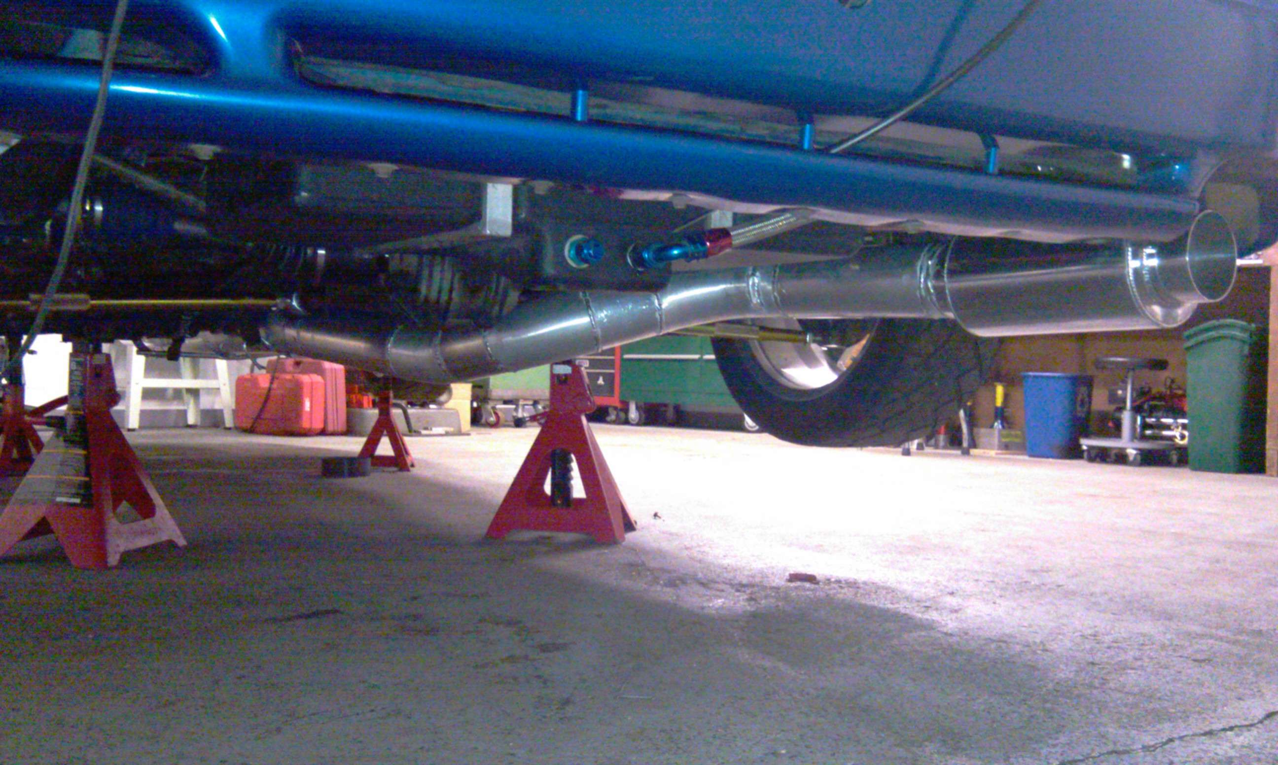

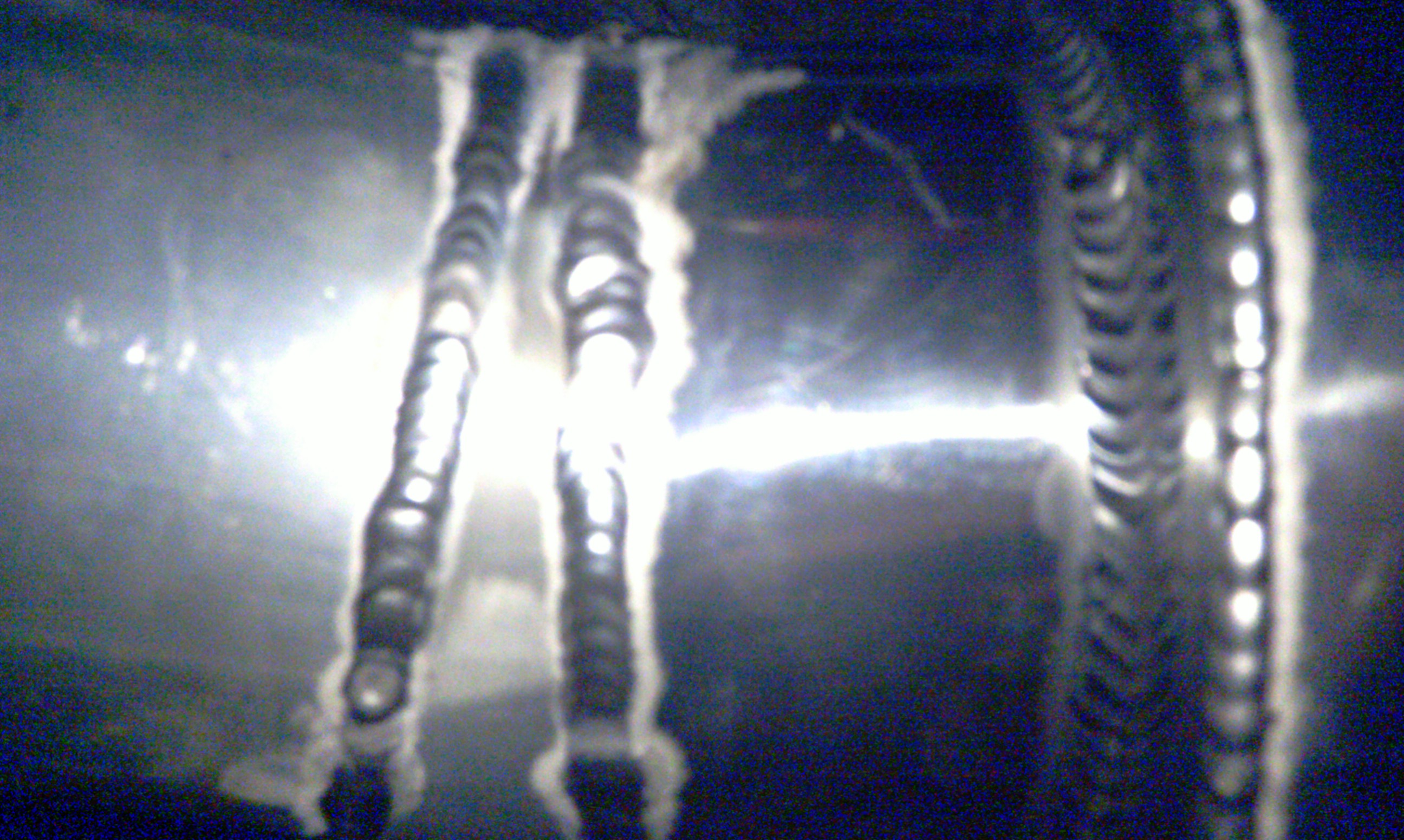

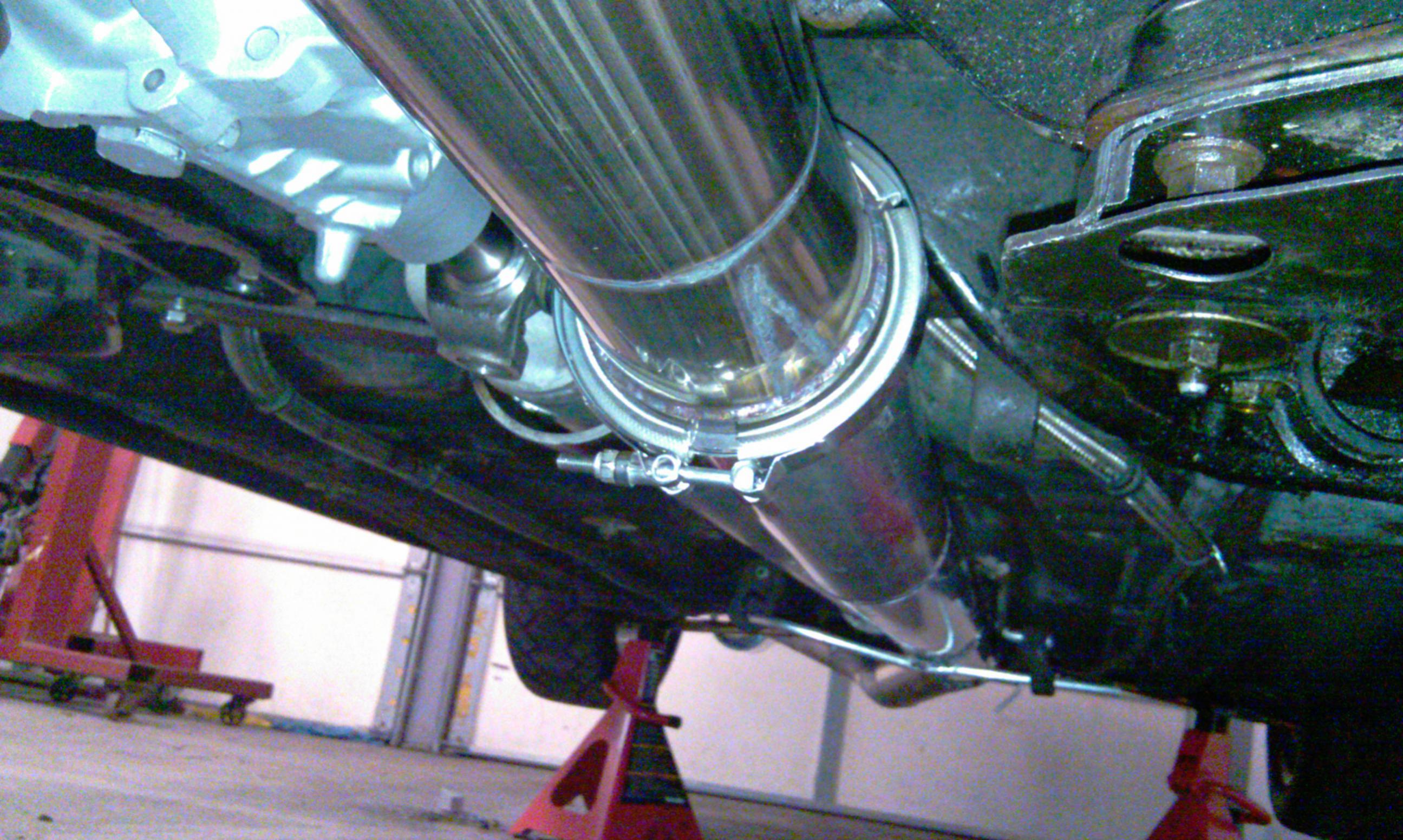

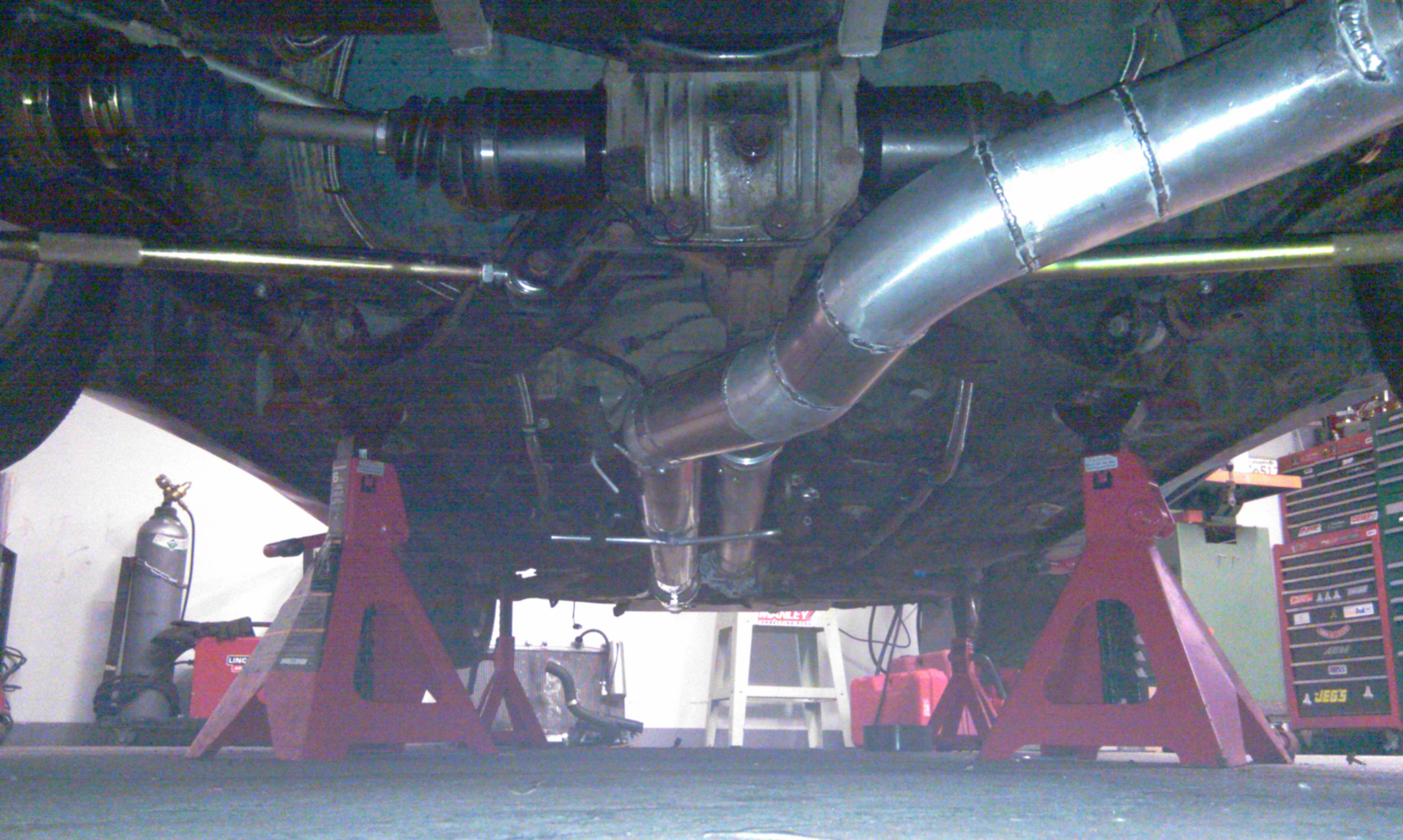

Just finished up my 4” aluminum exhaust this winter on my 1G and thought I would throw up some pictures. I want to drive the car on the street and didn’t want to do a fender dump, so this is a great alternative. It transitions over from stainless steel to aluminum at the back of the oil pan. Its 3.5” stainless from the turbo to the transition at the pan. I made the 3.5 to 4 inch transition to a v-band. It uses a vibrant aluminum muffler. The total weight of the aluminum section is around 13 lbs. I cannot wait to hear what it sounds like!

daaamn...that looks insane...freakin' cannon. would love to take more photos of this car. car was amazing to look at the cookout.

Yep, I added a DSS driveshaft, a set of stage 5 axels and a new revised Shep transfer case. One of the pics has the driveshaft installed, but it measured up 2” too short, back to DSS it went for modifications.

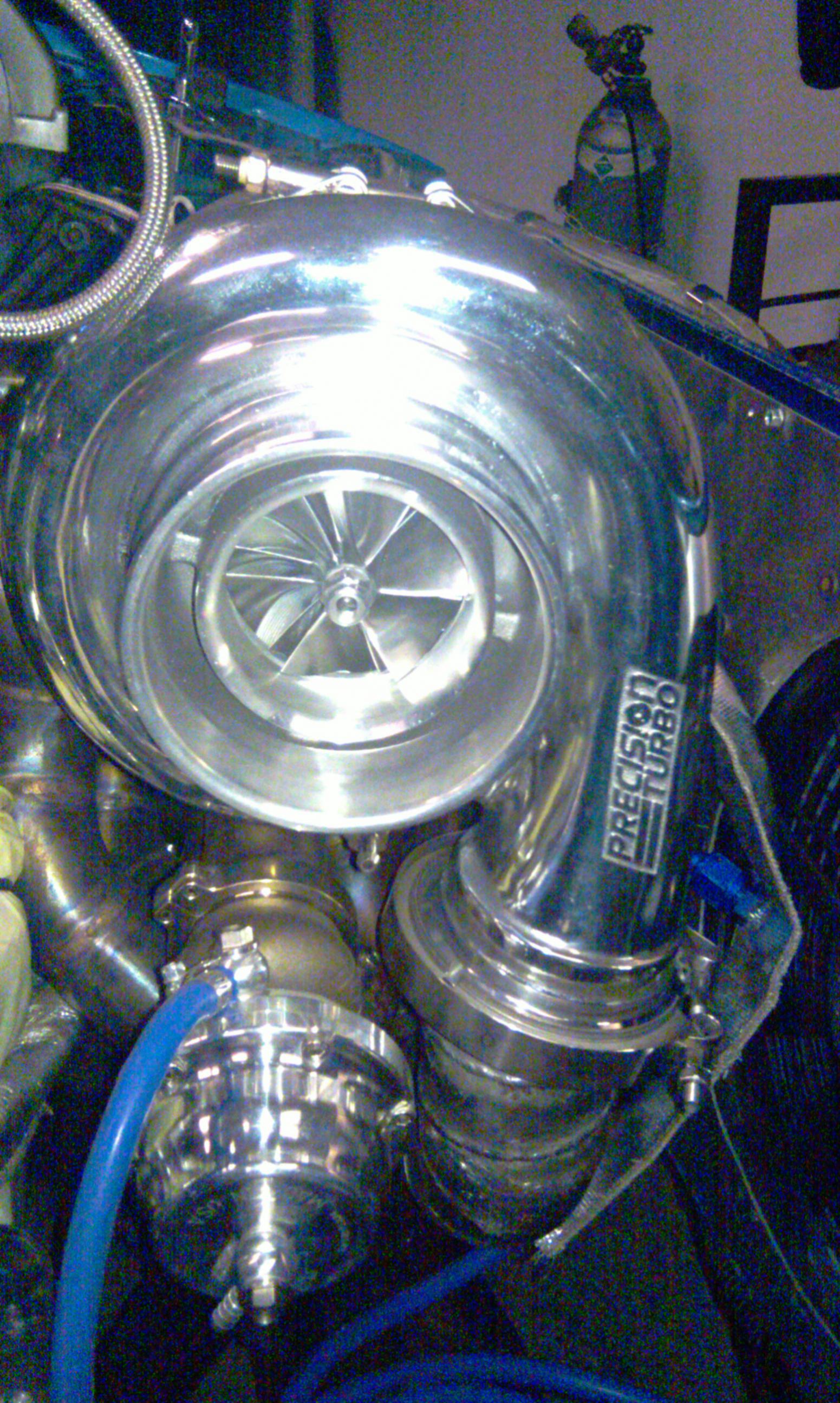

I upgraded the snail, it’s a PTE billet wheel on my 42R! Should work great, I have heard that one of the Buick guys picked up something like 125 whp with the billet upgrade. It’s the same compressor wheel used in MAP’s Evo drag car. The old cover and cast wheel have turned into garage art. More to come later.
Dude I love the little mural on the wall!
Billet 42R, drool! Glad to see you're still making progress with this thing, you just don't quit!

Looks good, Mark. Is your car lowered at all, and if so, and concerns about the exhaust scraping where it goes under the rear differential?
