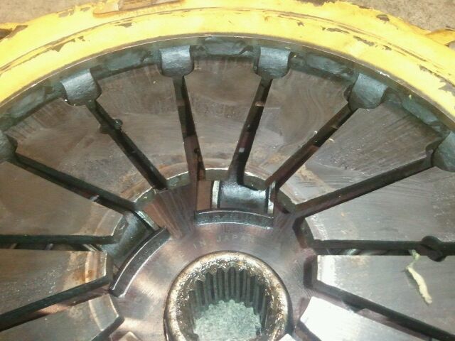

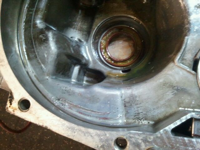

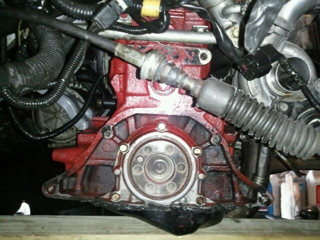

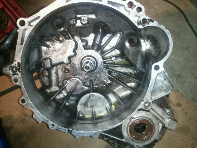

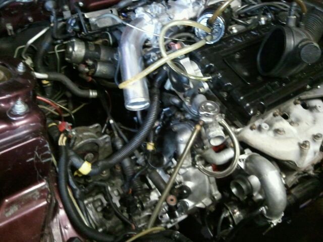

Hey guys, so I've been battling a slipping clutch because of what I suspect to be caused by contamination. I've dropped my transmission 4 times now and have replaced my rear main seal and its housing, oil pan gasket, and axle seals. Had the flywheel resurfaced to .610 and got a new 2600 pressure plate, because I thought mine was a 2100, and a new sbc-tz disc. Somehow I believe motor oil is getting through my bell housing and onto my clutch. From the pics below it looks almost as though it is coming from the headgasket, oil galley plug or its gear oil and coming from my input shaft (fwd).
Any thoughts?
Thanks, Mark

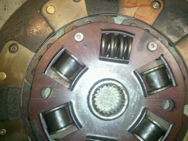

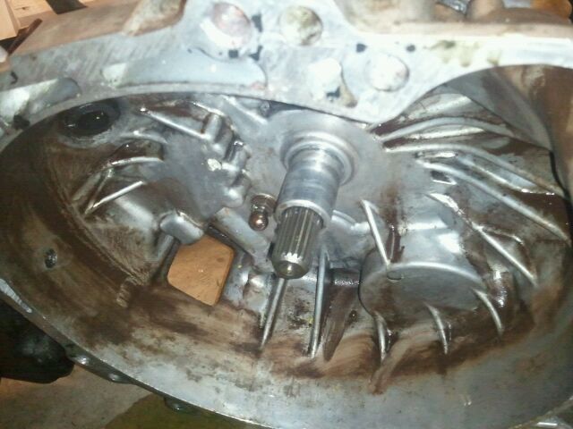

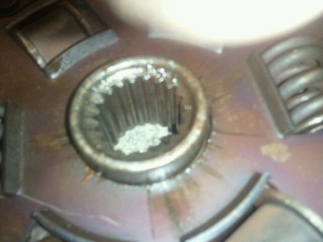

Pulled the trans, found what seems to be gear oil. Judging by the splat pattern in the pics of the disc and PP it looks like it was leaking towards the block. let me know what you think I should do/ look for now.

Hard to tell what's going on in those pics.

Mostly showing the splash pattern starting in the center working its way outward

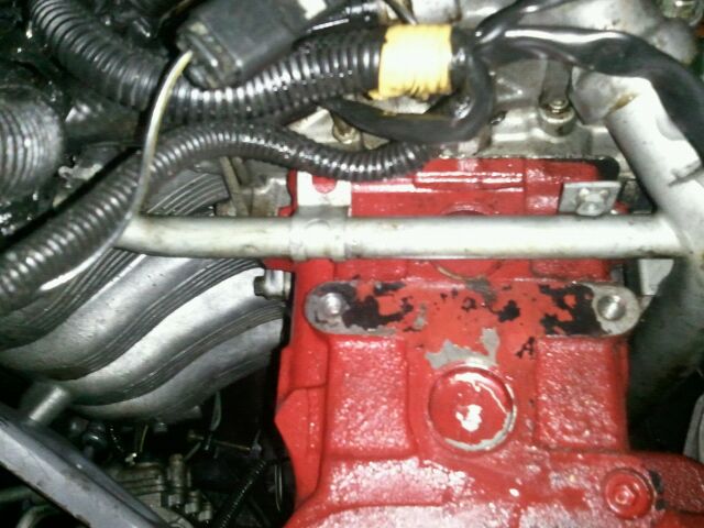

Got the input shaft seal replaced by Mark. Put the flywheel and clutch back on last night now I just have to lift the tranny in tonight when I get off work. Also wasn't going to take a chance of oil leaking out the galley plug so I jb welded it closed. Here are some more pics. As Mark was taking the gears out a crush washer fell out and reveled a nice size gash in the case. Glad it didn't cause more damage.
First pic is the leak shown by the UV dye on the input shaft
Second and third are the seal and location of seal
Fourth is the gash left by the random crush washer
