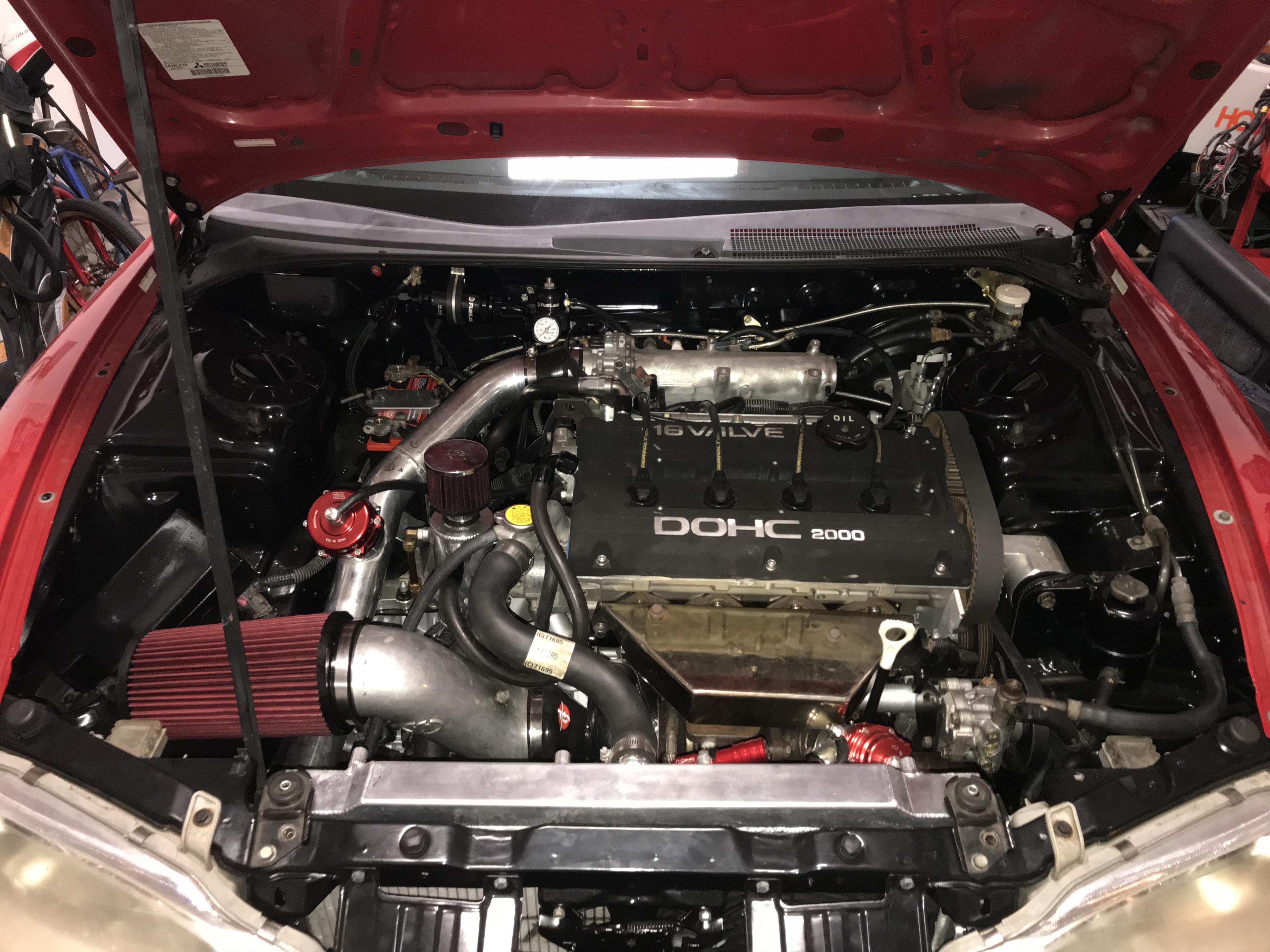

Re: Dsmdolney’s street/drag build
Got alot of stuff done tonight to wrap this thing up. Got the fuel lines all done and everything hooked up, installed and wired in the aem gauges, installed the jay racing alternator relocation, and a bunch more misc things that needed to be done. Slowly getting there.

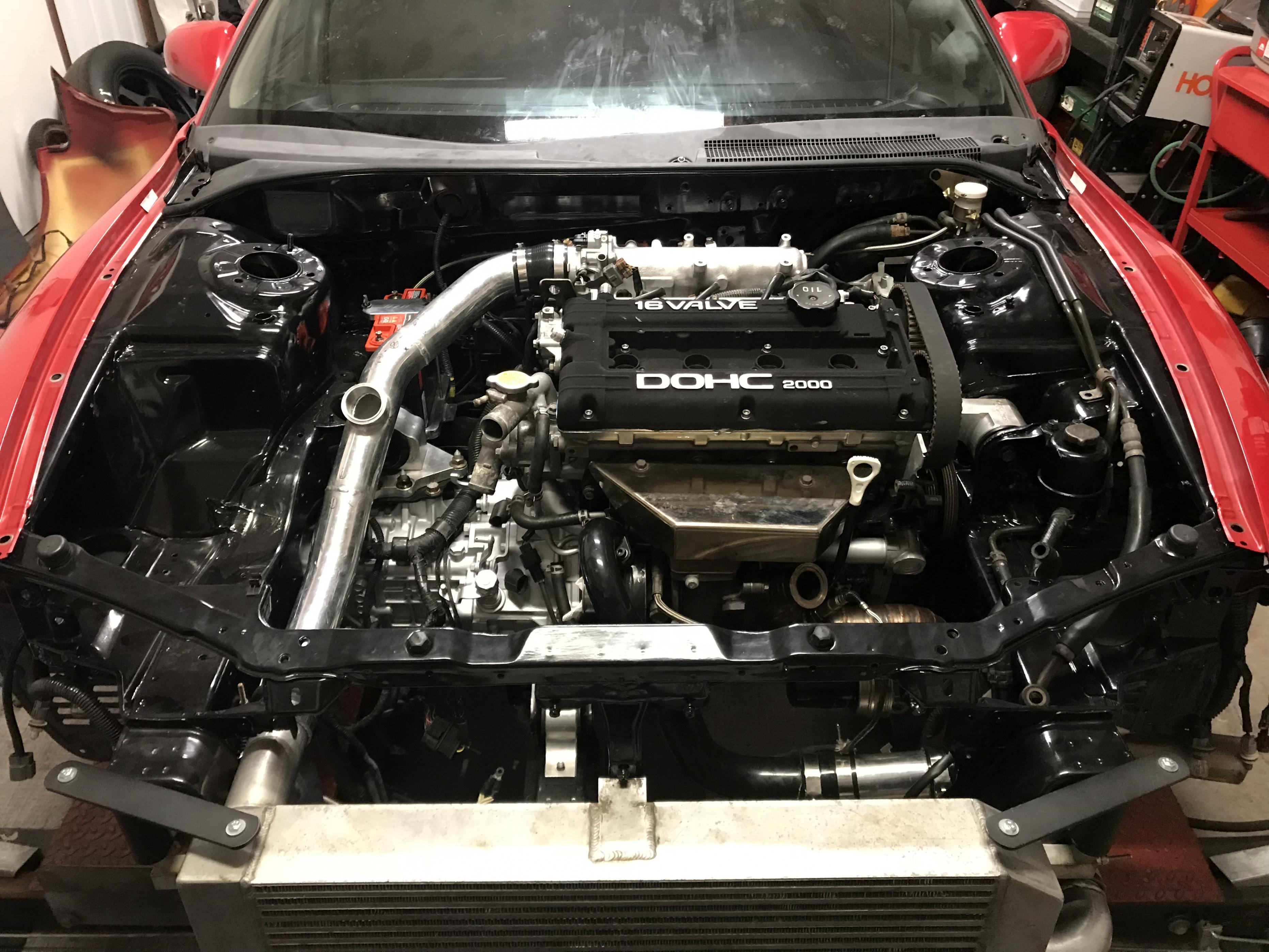

Fenders, hood, front bumper all mounted up and still have to make a heat sheild for the side exit exhaust. Trying to make this thing ready for the cookout so we are trying to bust it out now.

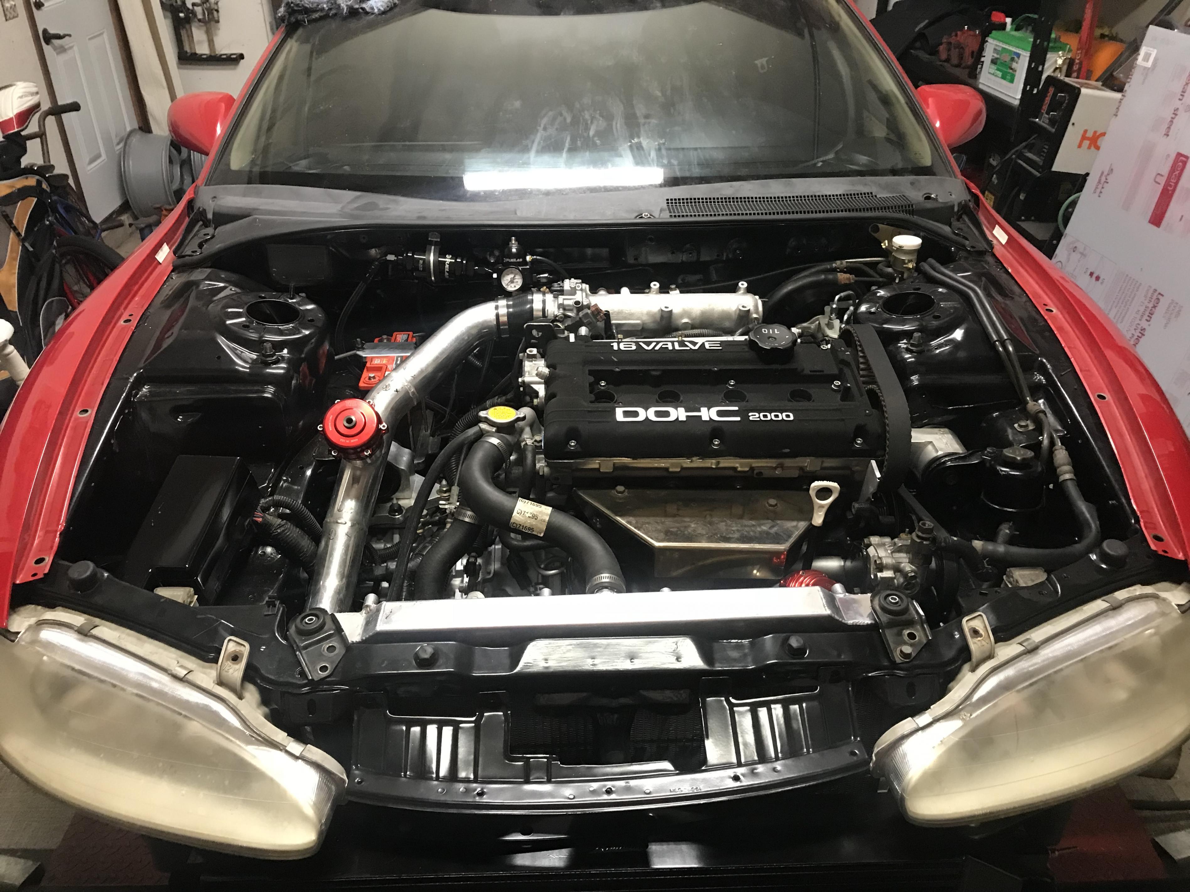

Well we wrapped up the engine bay tonight, all that is left is fluids and we are ready to start it. We hope to make it to Pg with the car next weekend but it will be cutting it close.

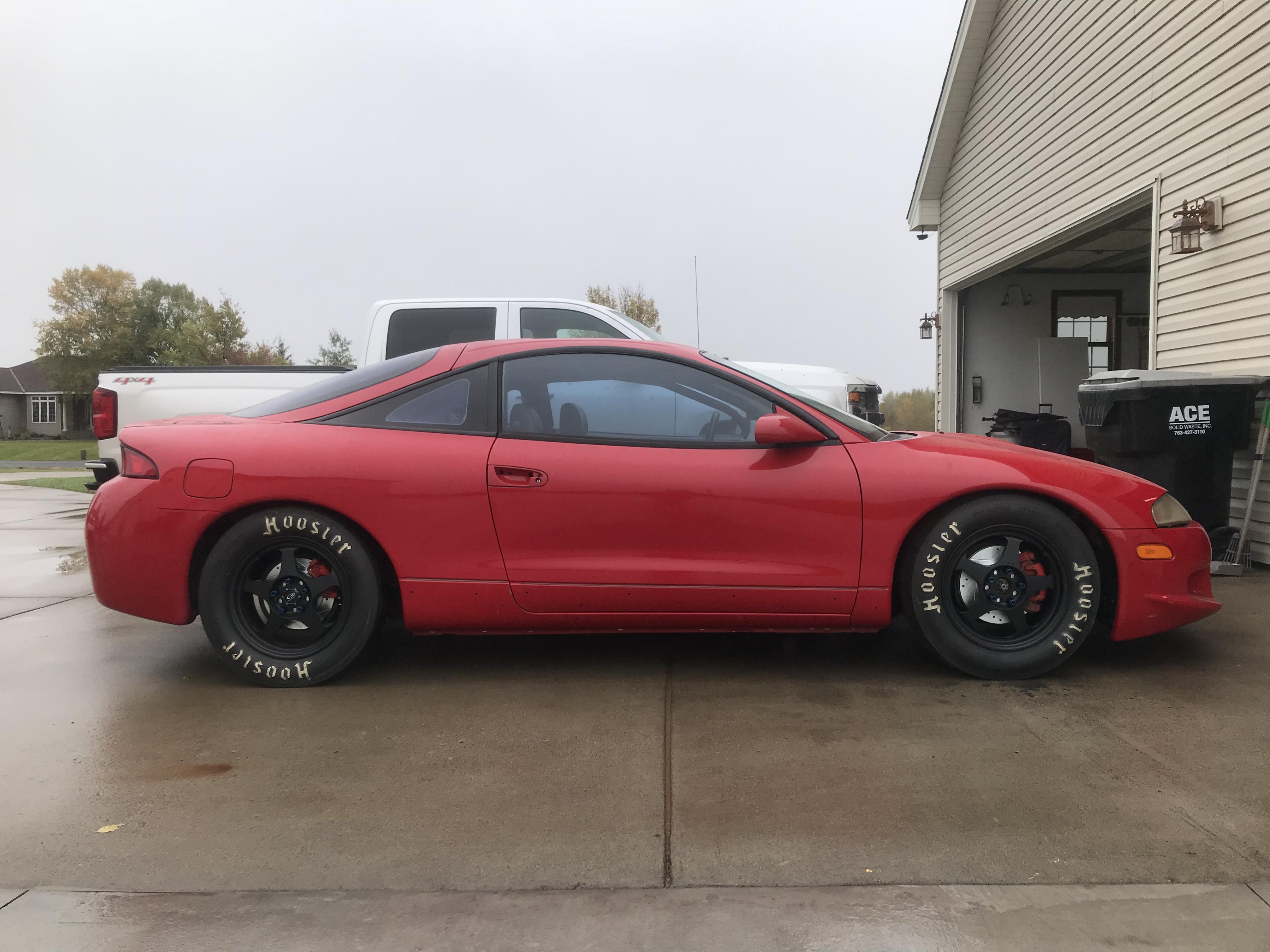

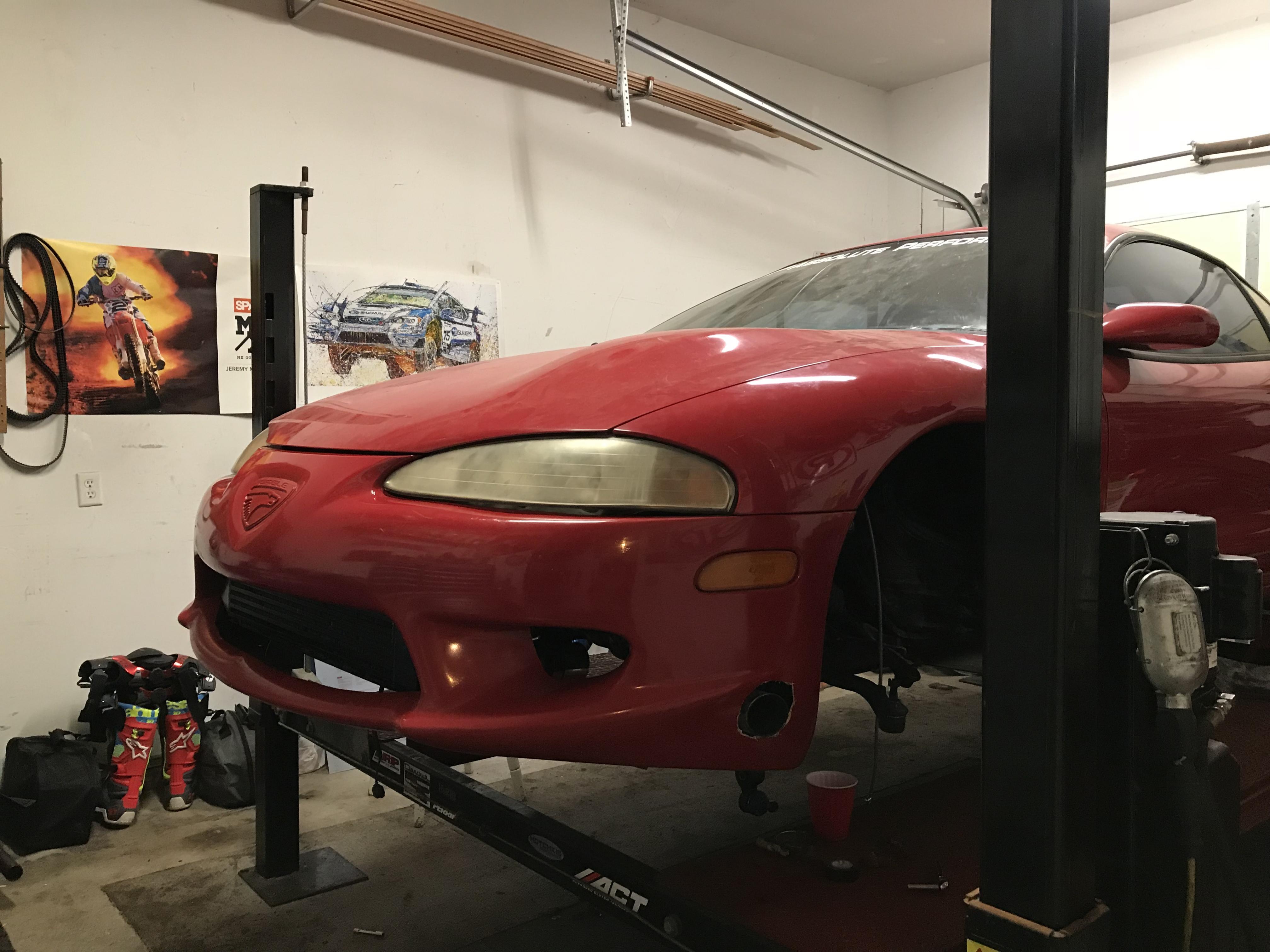

The car is a rollin. Few small things that need to be addressed then we will look into getting dyno time to see what this little 16g can put down. Also in the near future I plan on swapping coilovers in instead of the kyb / megan shock and spring setup we have in it now which sits way to low for me.
