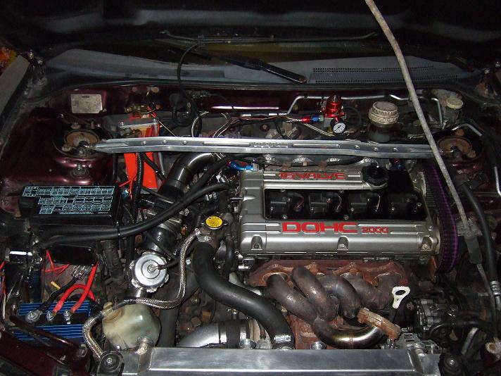

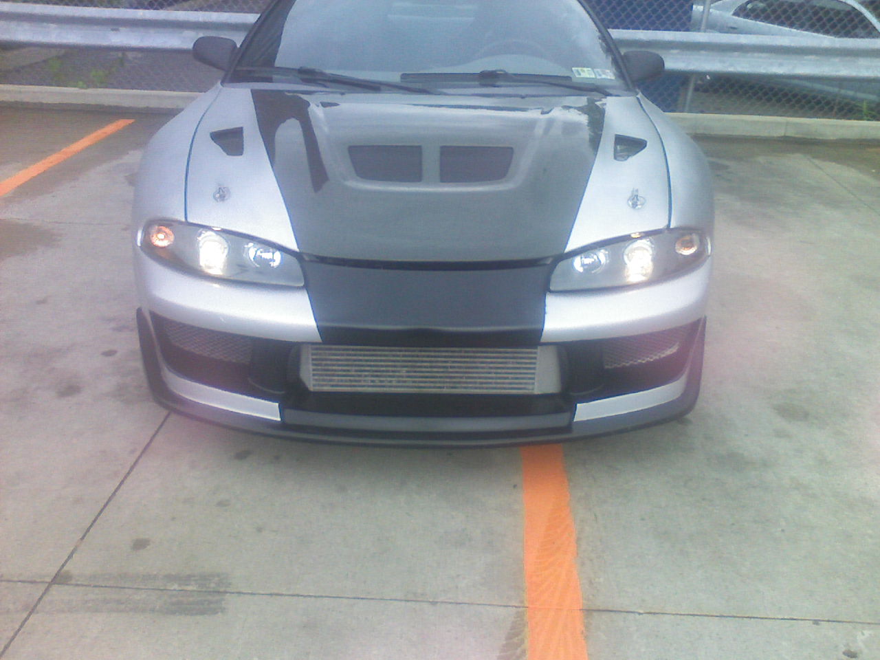

My ricey talon
Some things happened before I bought it, most happened after. The engine was completely stock ( a list of mods can be found in my profile thread) and thats where the majority of my money went... as well as the interior

It doesn't look that ricey its still clean. Its a nice car just not my cup tea. Nice work though!

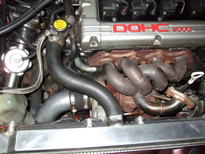

But what's up with the WG? Or is it a work in progress still?
Looks like you picked it up with quite a few nice mods.

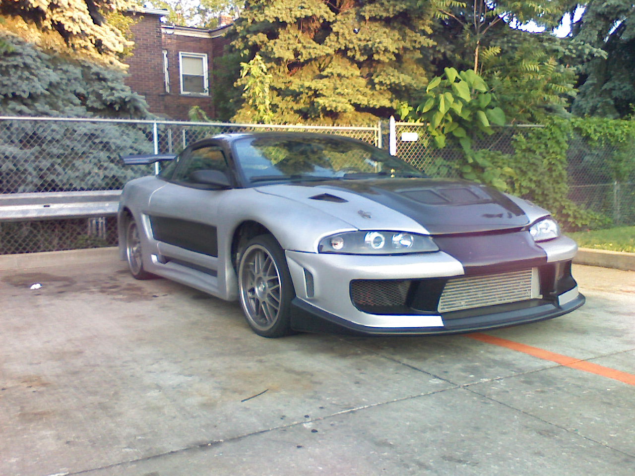

Needs some wheels that actually fill the space, and a nice body panel alignment.

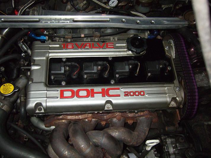

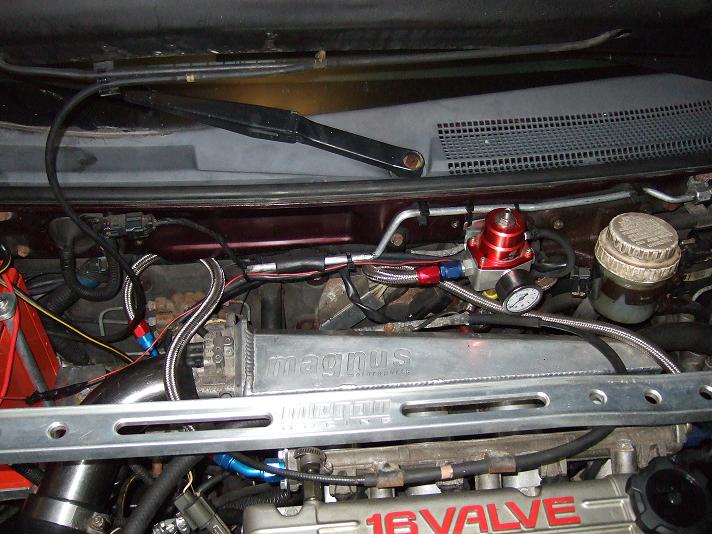

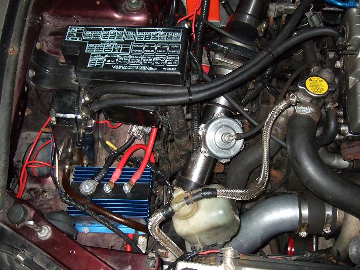

i fixed a lot of the body since those pictures.. I just haven't gotten pics of the exterior yet. my mods for the engine are:
-Dejon tool 1G intake pipe with K&N filter (locates filter in stock sidemount locations)
-PTE 50 trim
-SBR FMIC (biggest intercooler on the market right now)
-Short route 2.5" Intercooler piping
-Tial BOV
-GM Maf and MAFT in blow through
-1G throttle body
-Magnus intake manifold
-COMP 101200's
-Ported and polished rebuilt head
-3 angle valve job
-Cometic head gasket
-arp head studs
-SBR equal length tubular exhaust manifold w/ tial wastegate flange (none yet unfortunately)
-VRS 3" turbo back exhaust
-FIC 650 injectors
--6an Stainless steel fuel line (tank to filter, filter to rail, rail to FPR, FPR to tank)
-Aeromotive AFPR
-255 lph pump w/ rewire
-SBR Coil on plug set up
-Mishimoto Aluminum radiator
-Flex-a-lite dual slim fans w/ shroud
-Prothane Motor Mounts
-ACT 2600
-ACT Prolite Flywheel
-140amp alternator
-Battery isolator
-Odyssey Slim fit battery in the front
-Optima Blue top in the rear
-Mach V shifter cable bushings (skate bearings)
-HKS kevlar timing belt
-Symborski Shift kit
-B&M short shifter
-SAFC-II
-DSMCHips stage 3
-AEM Uego wideband gauge
-AEM truboost
-Evoscan Datalogging software w/ laptop hardwired
That was all me.. Like I said the engine was stock when I bought it. 3500 for an awd turbo... can't go wrong even if it looked like the batmobile.

Looks really good under the hood man! Outside is a tad ricey for me but it honestly it is pretty nice. If it were mine, I'd ditch the wing. Other than that nicely setup DSM. Time for some dyno numbers!
Old 05-25-2008   #7
Re: My ricey talon
not really a fan of wide bodys on dsms but the engine has a good start

Not bad under the hood, but wtf is with that body kit rofl...

It looks like you took a 1g, a 2g, and a 3g and mixed all of the body parts together, I like it. I think 123abc is right, you need bigger tires for your ricer.
