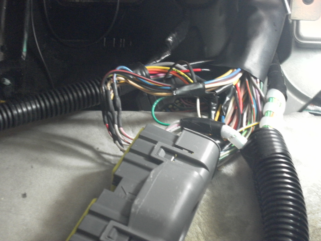

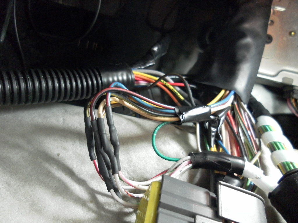

Started on Phase 2 of the MS3 install. The injectors and ignition are all wired up. I had to actually cut these wires, and solder and heat shrink them to the MS pigtail, since MS is taking over full control of them, stock ECU has no control of them anymore.
I need to run a vacuum line to it now for the MAP sensor, then get a base tune from Jordan @ Powersquirt, and another start-up video shall be made

I'm impressed that you picked up a soldering iron and went to town on your own car like that, very nice. Even tinned the wires and used heat shrink tubing!
Now don't lie, how many wires did you solder and forget to put the heat shrink on first?

Haha, only once (the first wire). I'm a quick learner
And also, probably no one on here will really care, but as Ive been going, I've been constantly updating my earlier post with exactly how I am hooking up the Megasquirt. But if anyone on here randomly wants to know how to hook up an SC300 to MS3/MS3x the same way I'm doing it, it's all written down in my earlier post. There's still a couple things I have not hooked up yet (wideband, knock) which will come later. But I'm updating it as I go so it'll be complete once I'm all done for others to see.

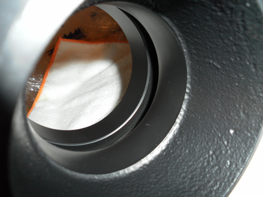

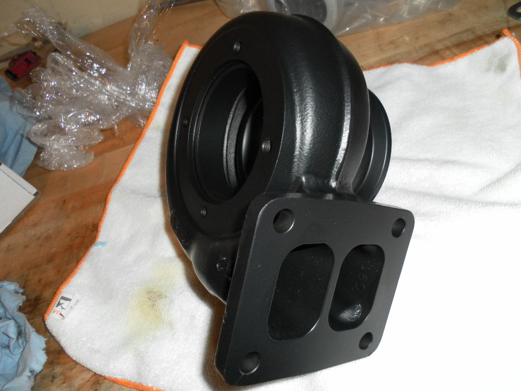

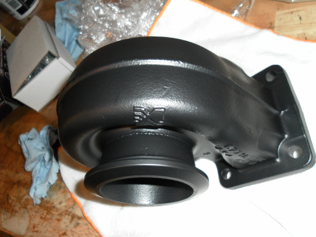

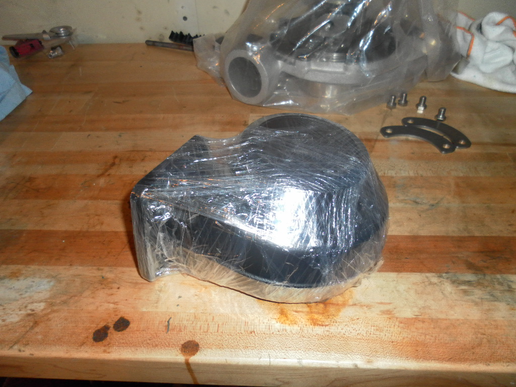

Got the turbo exhaust housing back from Primo Performance from being coated. Looks great thanks guys!
