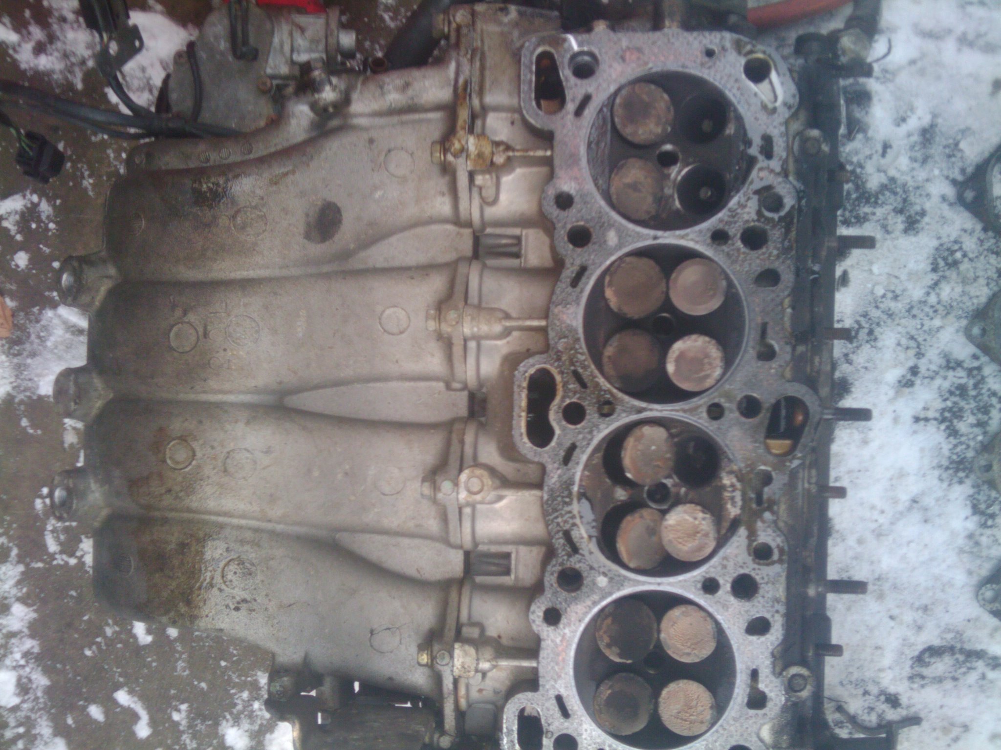

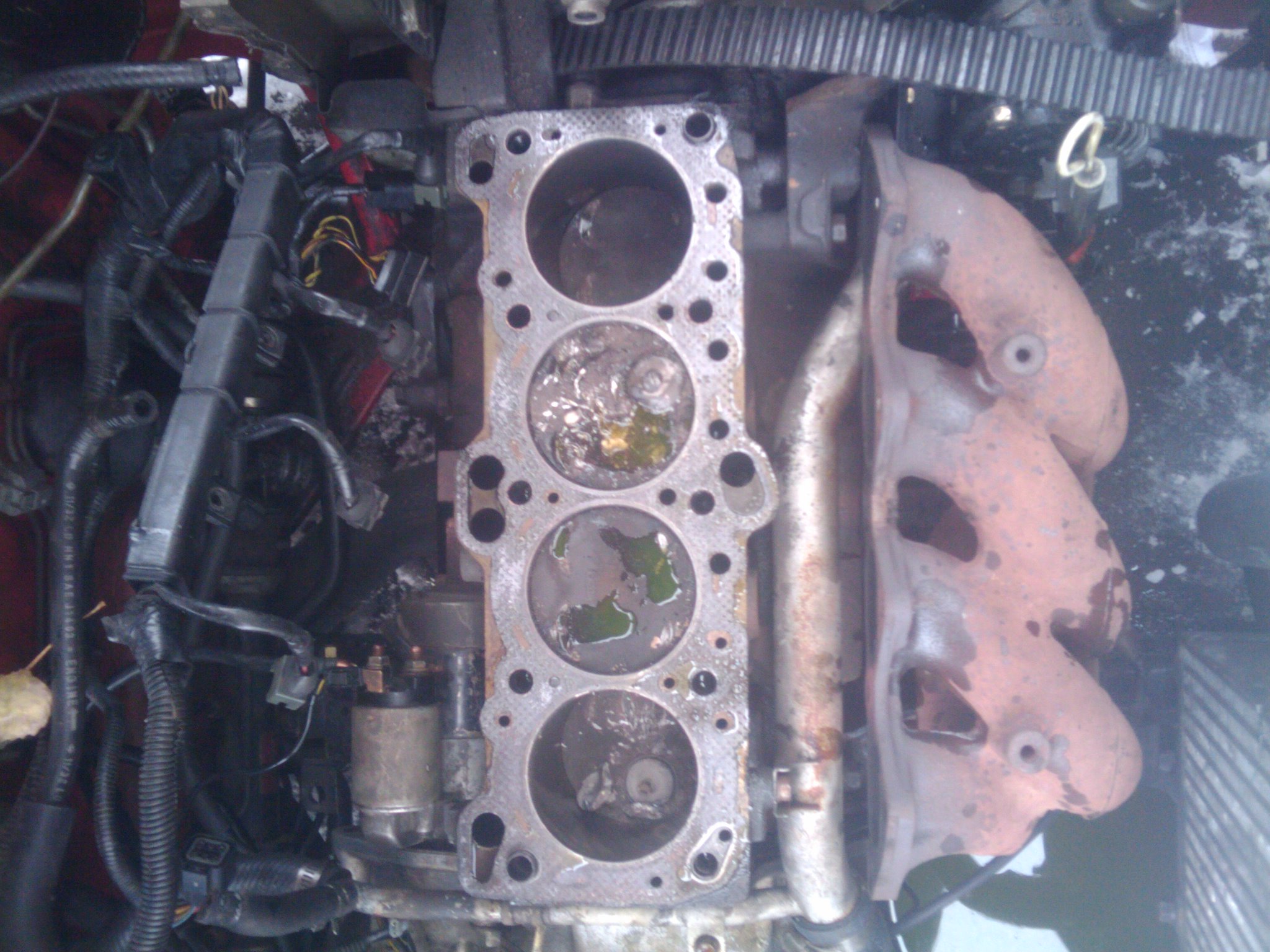

As some of you may know, this thing blew up a couple weeks ago. Mark and I tore the engine apart and this is what we found.

Wow, how did that happen? Timing belt come off and break all those valves?

Yeah. A few days prior to this an oil cooler line came off when she was going down the freeway. It still started and ran ok after the line was re-connected and oil was added, but it seized up a balance shaft and took out the timing belt the day we got all that snow

she was driving to work and the oil cooler line blew out and out came all the oil. the car still ran after we fixed on the side of 94 and got drove it home. the oil pump failed when I went to move it out and back into the drive way so they could plow it.
so pretty much
oil pumped failed
locked up the b.s.
took out the b.s. belt
b.s. belt took out timing belt
