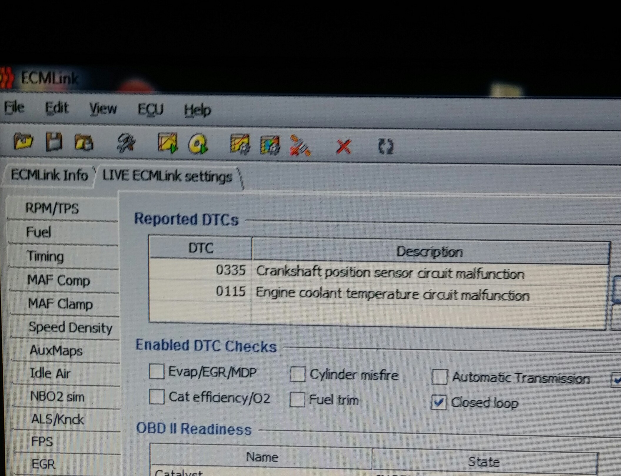

This is what link says

Old 08-23-2014   #4
Fran05
Join Date: Sep 2007
Drives: DSM
Posts: 319
Re: NON Start issue
Crankwalk

Old 08-23-2014   #6
mark4g63t
mark4g63t's Avatar
Join Date: Jun 2012
Location: Twin Cities
Drives: 95 Talon TSI
Posts: 941
Re: NON Start issue
Have you checked fuses? Is yours still 7 bolt? Checked that all the sensors are plugged in/clean?
I believe I have some extra crank and cam sensors lying around, i'll try to dig them up.

A bad coolant temp sensor will also cause a no start.
Old 08-23-2014   #8
Re: NON Start issue
Coolant temp shouldn't matter much, it would just run really rich on startup. Check your crankshaft end play, hopefully it's just the sensor.

Got a new sensor already does it need to be aligned with the cam sensor or anything or can i just swap the crank sensors
Tyler
2011 Subaru Sti 11.0 @135mph
Old 08-23-2014   #10
carltalon
carltalon's Avatar
Location: Big Lake MN
Drives: 98 Eclipse GSX Auto
Posts: 1,516
Re: NON Start issue
I was thinking the same thing when I read it stalled when he pushed the clutch in. hopefully it hasn't gone walking and the sensor is just bad or the plug came loose. good luck.

Originally Posted by dsmDolney View Post
So im guessing it dont have to be aligned with the cam sensor correct
The crank sensor just bolts in next to the crank under the timing cover there is no alighnment or adjustment,

Well i think it walked it keeps poopin up that the cps is bad and i got the new sensor in. So i dont know what to do if someone maybe wants to come check it out before i tear it apart and give input thatll be cool but otherwise im done with it.

Endplay check http://www.angelfire.com/pa4/awdcrankwalk/
Crankshaft endplay 0.0020 - 0.0071 per AllData for 96 AWD Turbo
Could be wiring issues also, so checking for crankwalk without tearing things apart might save you some time.

So im like 100% positive it walked so now to decide to part out and get an evo or just rebuild it
