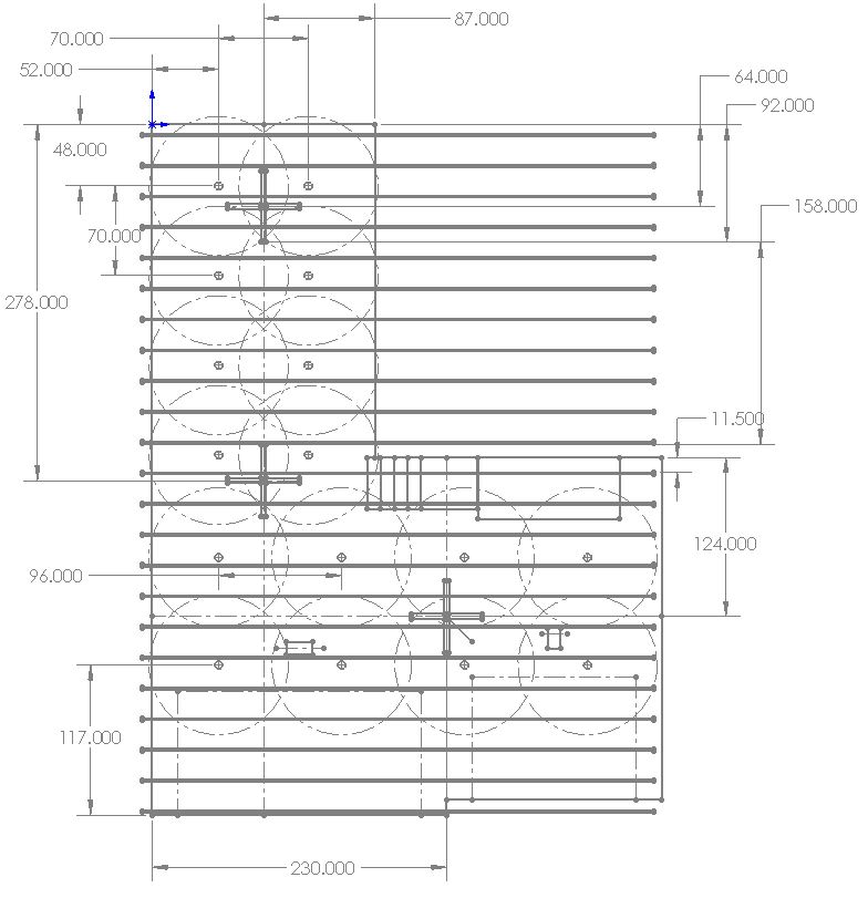

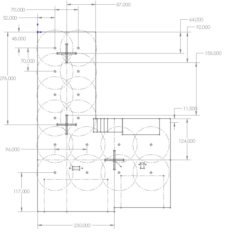

I drew up a pretty accurate / to-scale drawing of the garage using SolidWorks. Some things may be an inch or two off here and there, but overall it's quite accurate. It shows the internal sheetrock dimensions, the 6" can placement, their overall beam width assuming 45* beam width and a roughly 11.5' ceiling height. It shows the 3 fan locations as well as stud locations, garage door openers, and garage doors at full up (wanted to make sure the last row of lights wouldn't be covered up even if garage was open).
The interesting thing is I did the math on wattage as I wanted to make sure I'm not overloading my current 15A lighting circuit. Assuming 15A @ 110VAC, I should be OK for roughly 1650W. So to be a little conservative I just said my limit is 1500W. I'll be using LED bulbs which are advertised as 9W (65W equivalent), so again conservative I just figured 10W x 16 bulbs = 160W total. Lol, not even hardly scratching the surface! Then the fans, I'm not completely sure but I believe they'll pull roughly 60W at full speed. Even if they pulled 100W, that puts me at 460W which still is only using barely 33% of the circuits rating. Comparing it to what I'm currently at, I calculate I'm currently somewhere around 700-800W. So overall I think it'll be quite the improvement, and still leaves me with plenty of room to either keep or add some extra fluorescent lighting or something.

Very nice project, that'll be cool when its complete. Do you have any attic insulation above there? I'd love to do the same but I have a foot of cellulose type stuff on the ceiling that would make it impossible, or at least really suck. I have the standard three bulbs, and they're CFL so they take several minutes to warm up in the winter. Maybe I should just replace them with 100W equivalent LEDs.
Regarding circuits, they're rated at 80% of the amperage. So you could safely draw 12A on that circuit, or about 1300W.

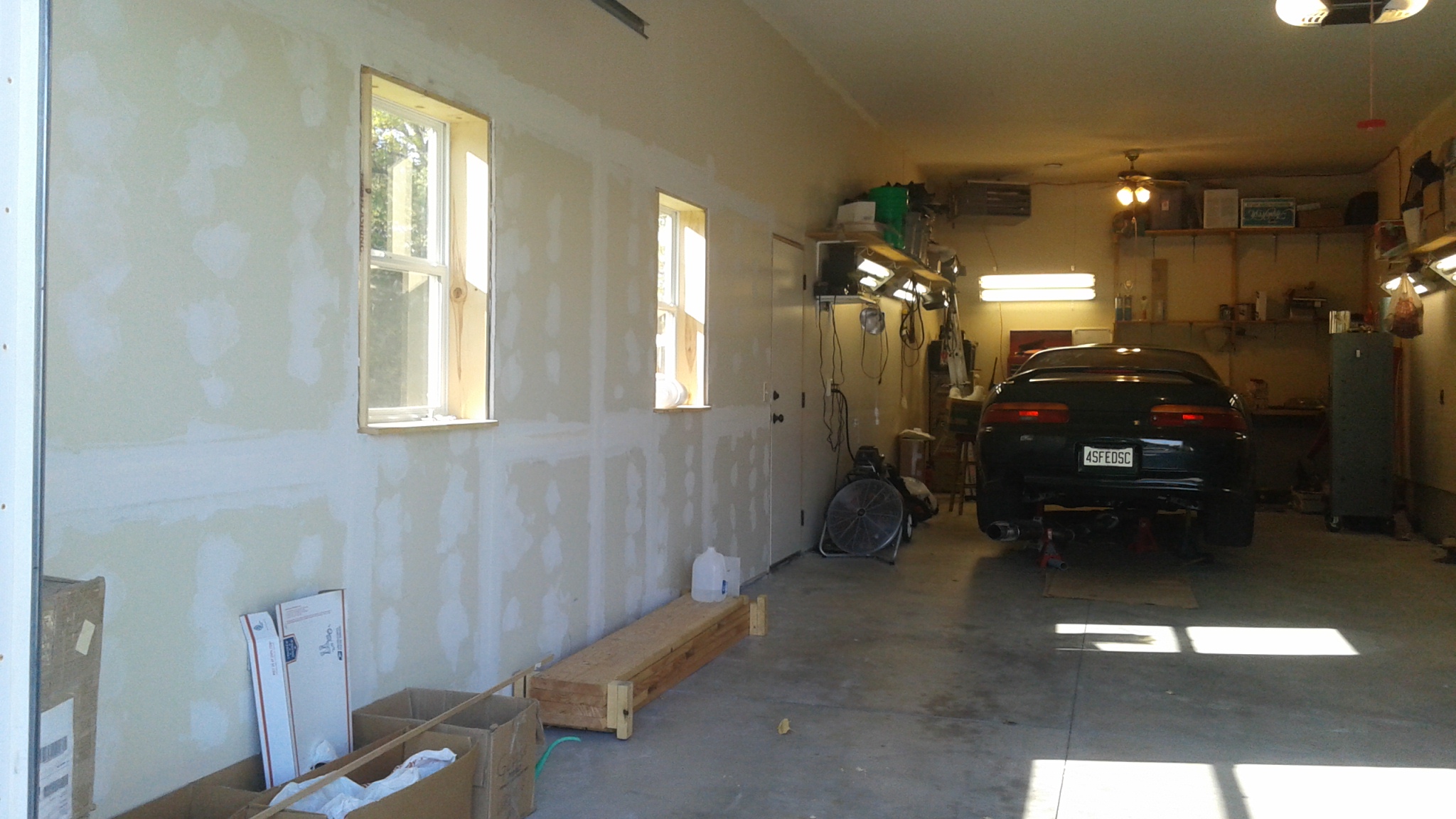

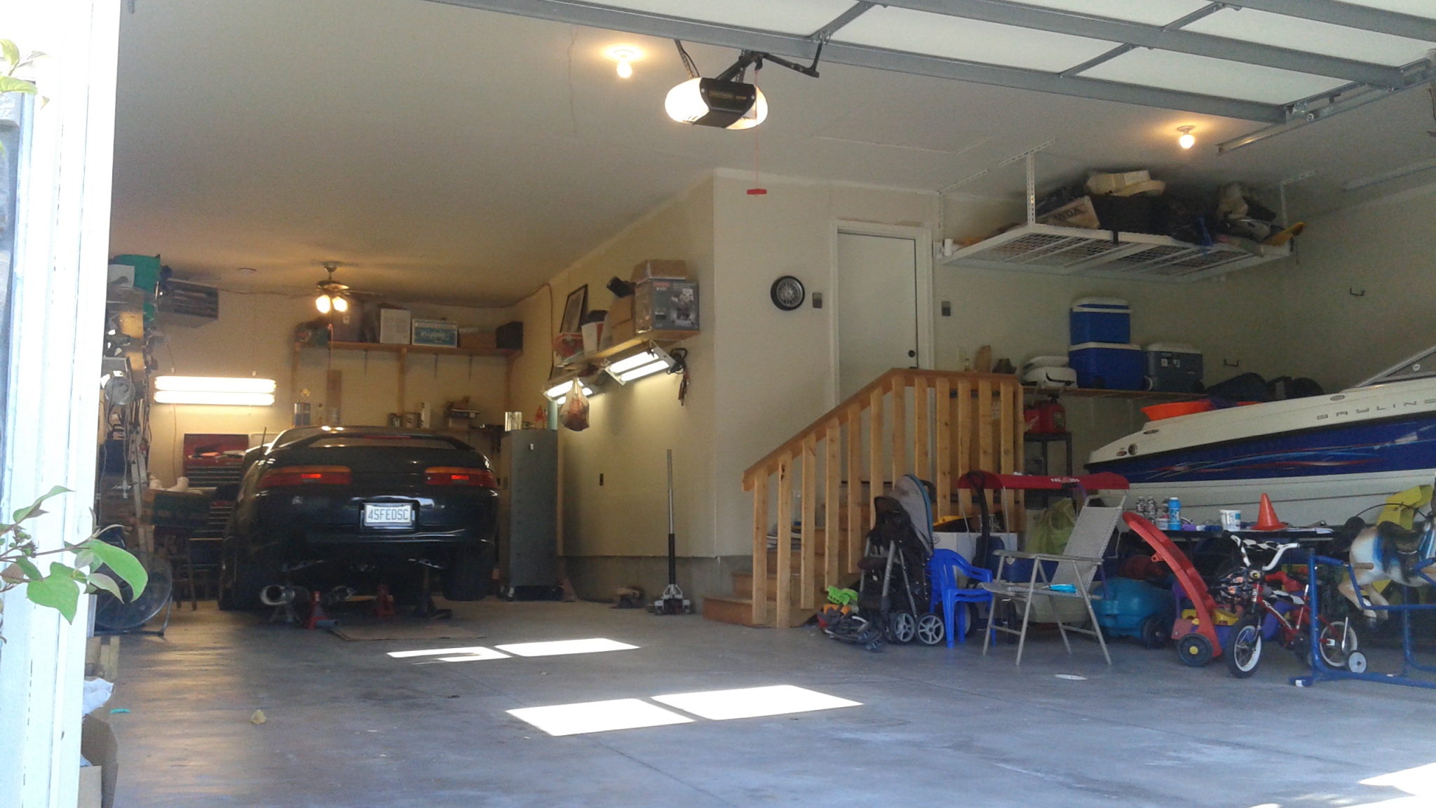

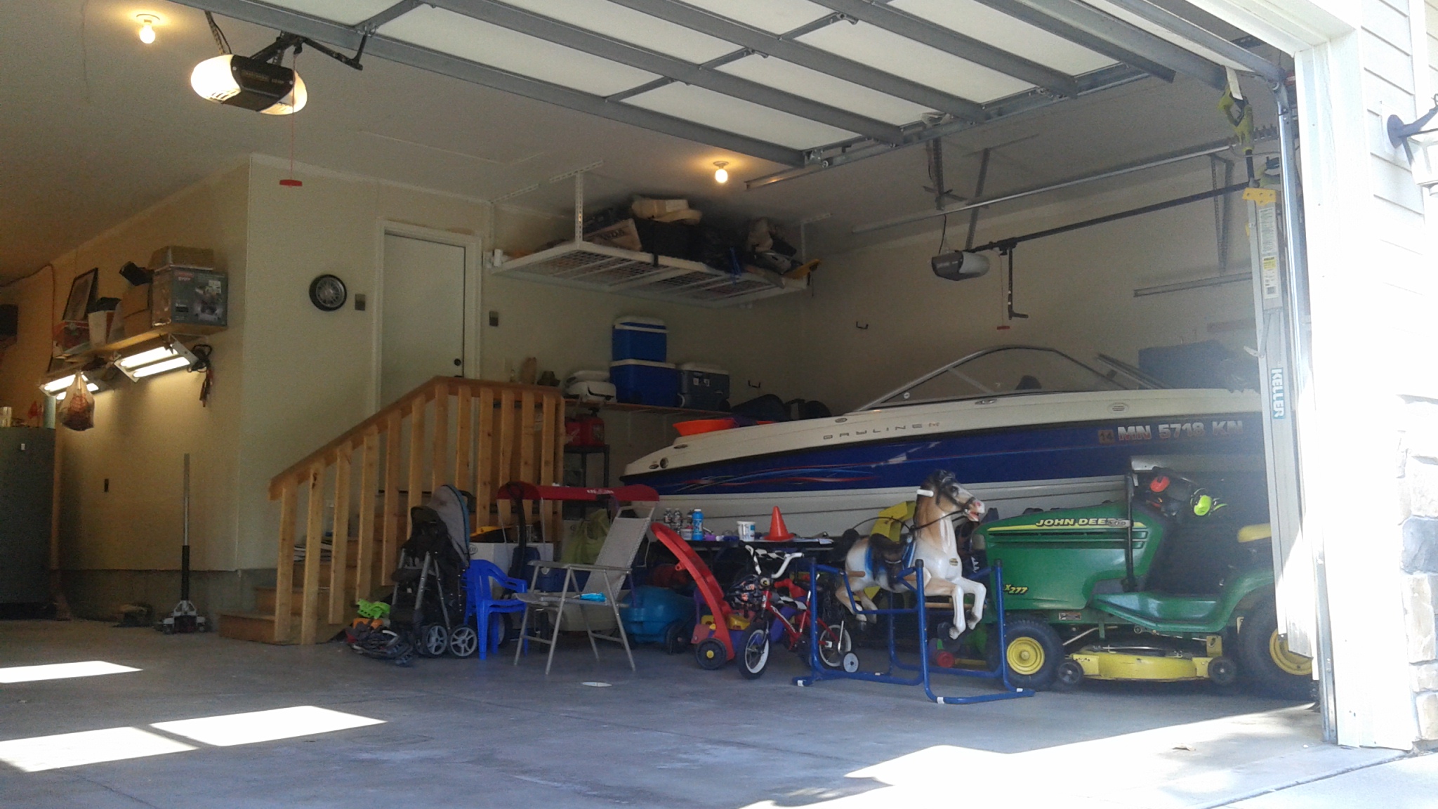

Here's a few before pictures that basically show the garage as it sits today. You can see the two single bulbs up front, and the one bulb socket in the car shop are that I hung a ceiling fan at. Anyway just a record of what it was before. I'll be starting on the new lighting soon.
I ended up buying four 4-packs ($40/ea) and thre 56" fans ($40/ea) and some house wire ($30). So in the end right around $300 worth of material.
