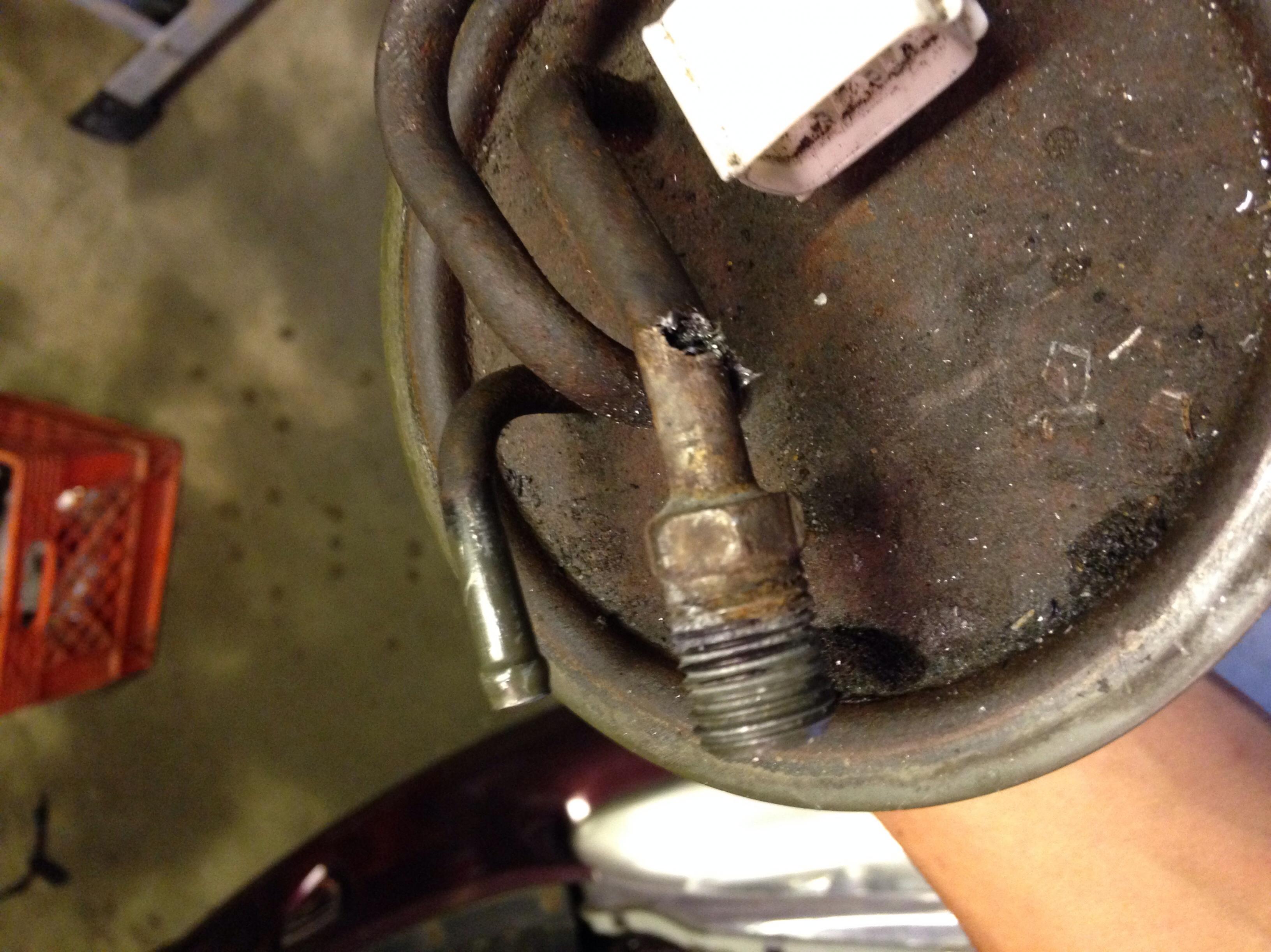

asap. Well I need a new sending unit/ hanger. 2G AWD. or If someone is willing to weld an -AN fitting onto mine.

I drilled mine out where it meets the top of the sending unit then put a 90 degree barb to AN fitting there and used JB weld to hold it in place. Not very good pictures but you get the point.

Thought about doing that. I even went to db and got the fittings, but didn't want to mess with the factory pump o-ring piece thats on the other side so instead I ended up cutting one of the male -an's off drilled it out to match the line diameter and welded it onto the line. I'm hoping it will not leak. Last night I f'd up the hardline under the car trying to drill that out so my next question is, will it leak if I just put the hose over the line and clamp it down? It's the feed hose right after the pump.
