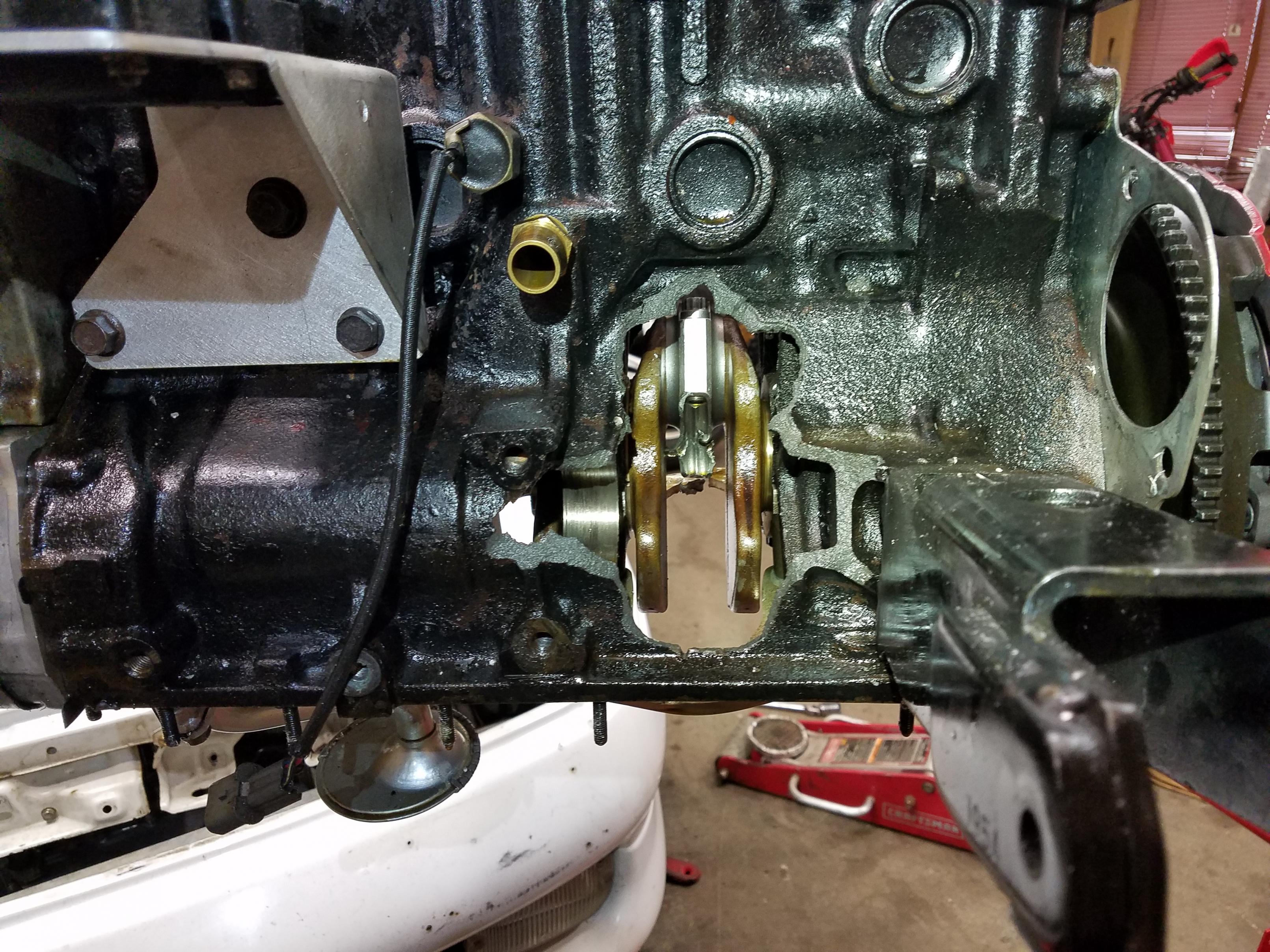

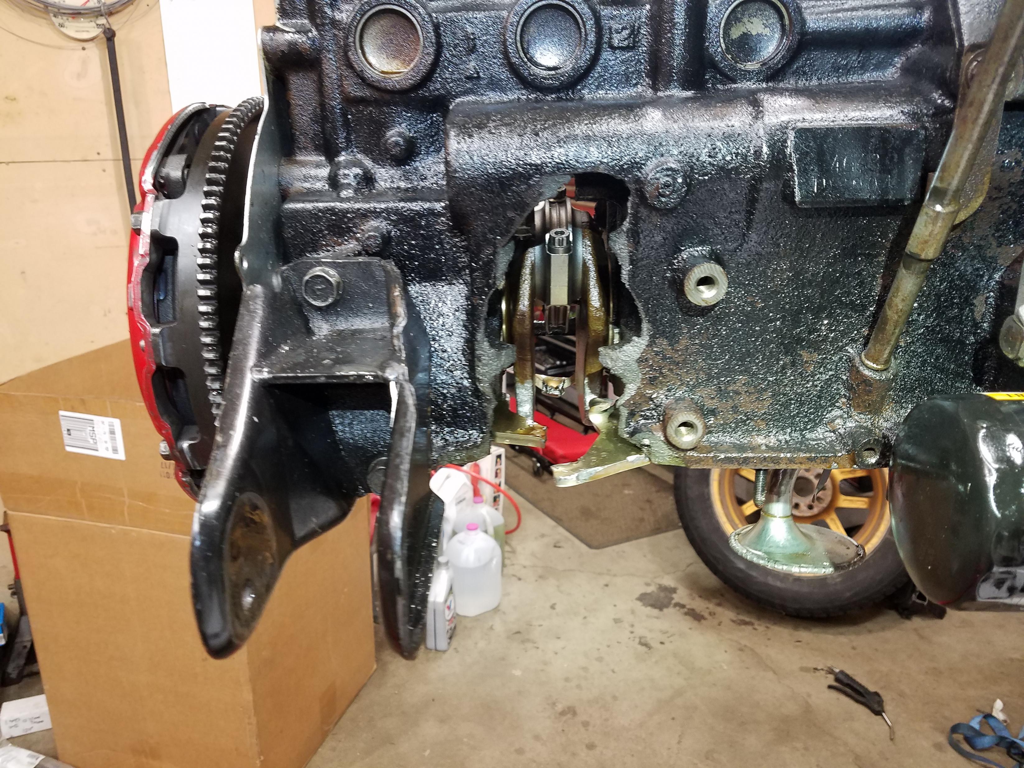

Well this isn't as good as that, but close. Clearly that's too much for the h beam eagles Johnny...

several of us want to know the how the rod failed? RPM/Boost? Time for I beam rods?

Boost/timing is my guess. I was asking alot out of them. 38ish psi, 9.5:1 compression, and still had around 11 deg in it at around 6500 rpm when it blew. Wasn't rpm, happened right as it hit full boost.

Thanks, I have the a similar build with eagle rods weisco pistons@9.0:1. I'm too cheap to get the upgraded rods.
was it ethanol or gasoline?

Running e85. I use the stuff from Bobby and Steve's in Eden Prairie. Usually tested at 83%, I'd get a barrel at a time. Lot easier to keep things consistent that way.
