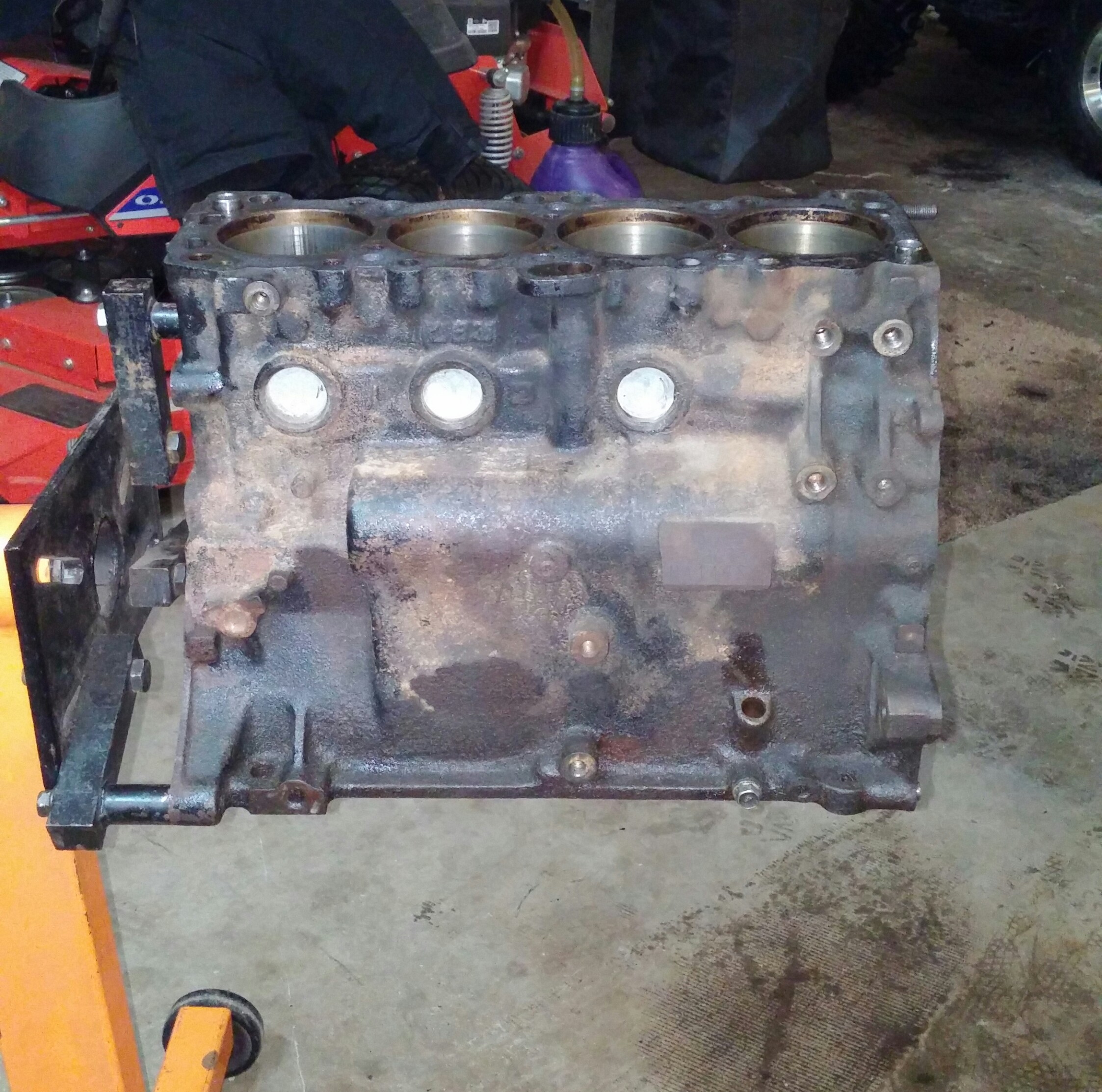

Figured id start a new thread for this years winter/spring build and all the rest off the stuff that goes down with the car.
Specs:
1995 eclipse gst awd converted
Welded diff
Gutted
All autometer carbon fiber gauges : boost, oil pressure, coolant temp
Battery relocated to the trunk with cutoff switch
Thats all as far as the car sits right now.
List for this winter :
Pte 6766 .96 a/r undivided t4 (have)
6 bolt 2.0 .020 block
Pauter rods
Wiseco 1400 hd 10.5.1 pistons
Stock polished and balanced crank
6 bolt stockport head (have)
GSC s3 cams
GSC adjustable cam gears (have)
GSC power division springs and retainers
GSC power division zero tick lifters
GSC valve stem seals
Supertech valve guids
Not sure on valves yet standard size tho
Arp hardware
Kiggly main griddle
Acl bearings
Built trans (not sure who yet)
SD
Jmfab drag intake manifold
Theres the plans for the motor some things i havnt decided on quite yet but input is good. Kind of a big goal for me right out of the gate but go big or go home. Alot of time and money will be invested and cant wait to start putting her back together. Will keep posting updates as the build continues. Enjoy
ID:	14888   Click image for larger version
