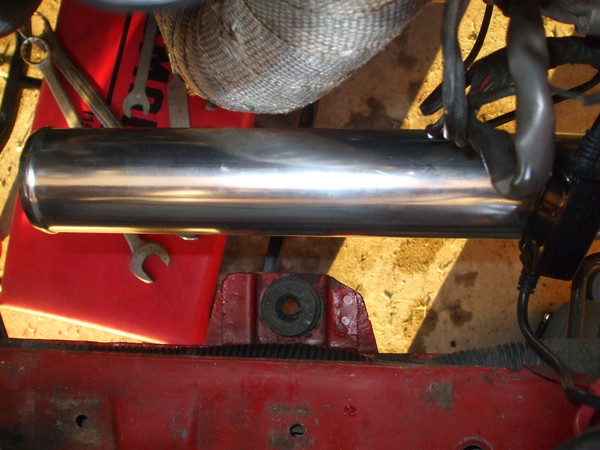

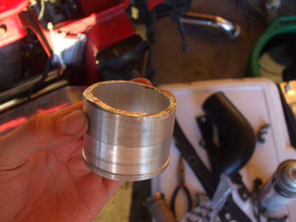

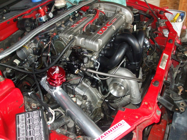

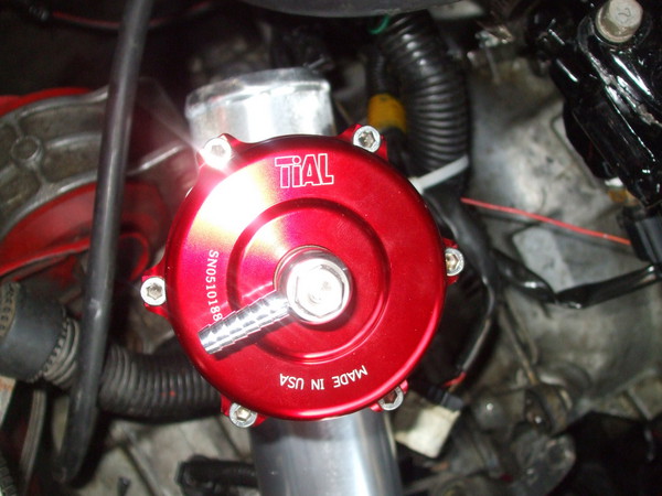

some pictures

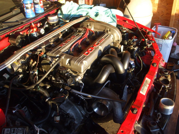

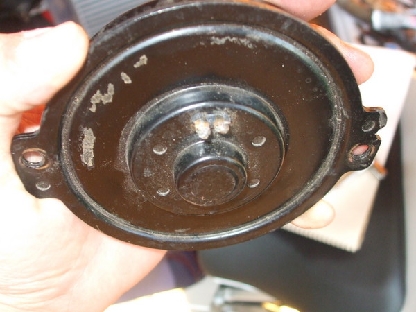

Some more pictures

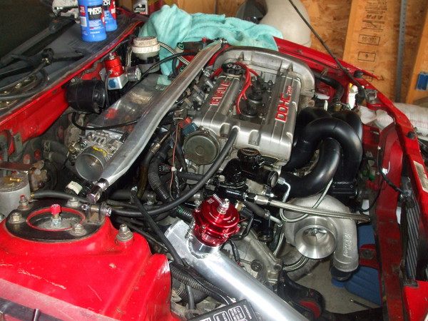

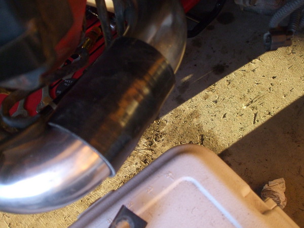

I'll Go take some quick and get back to you. Also, I'm not the only one that had problems with this kit. Nick (cornfed2.4) has the same kit as me and had trouble with it.
Yea. you are better off customizing the piping to fit exactly to your setup with clearing things like DP, radiator and or fans, turbo, intake, ect. Looking good. whens it going to be on the road.

^ first things start up. Then I will button things up and make them look better, I could have this thing on the road next week. BUT, I need to get at least 2 to 3 more things befoe tuning it. BAP,A1's, and make my exhaust. I am going to use the downpipe that I have on there and then cut the one that I had on there before and weld it to fit the downpipe.. I like everything about thermal exhaust better then the one that I was going to use.

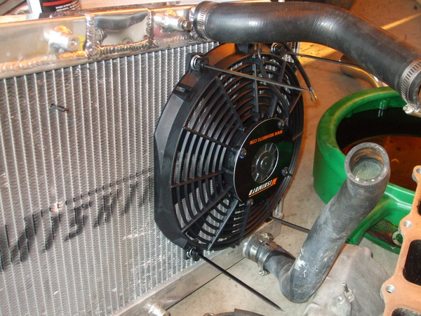

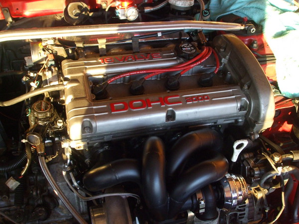

Ok so I went to MAP today after work to pick up my second fan that had just came in. When I got home I took my 1g n/a throttle body off and went up to Primo and had Jesse make me a block off plate. I then went to ACE to pick up some new hardware for the block off plate.
When I got home I began putting this stuff on my car. I used some gray RTV for the block off plate and I'm going to let it sit snug over night then tighten it the rest of the way tomorrow. Got both fans wired up and put on my radiator along with the radiator installed in my car, then I hooked up my LICP. Put the throttle body on the SMIM and I am done for the night. I have tomorrow off and if all goes well this thing will be ready to start!
On a side note I picked up some H11's today and am picking up a Boost a Pump tomorrow! not much farther now!
