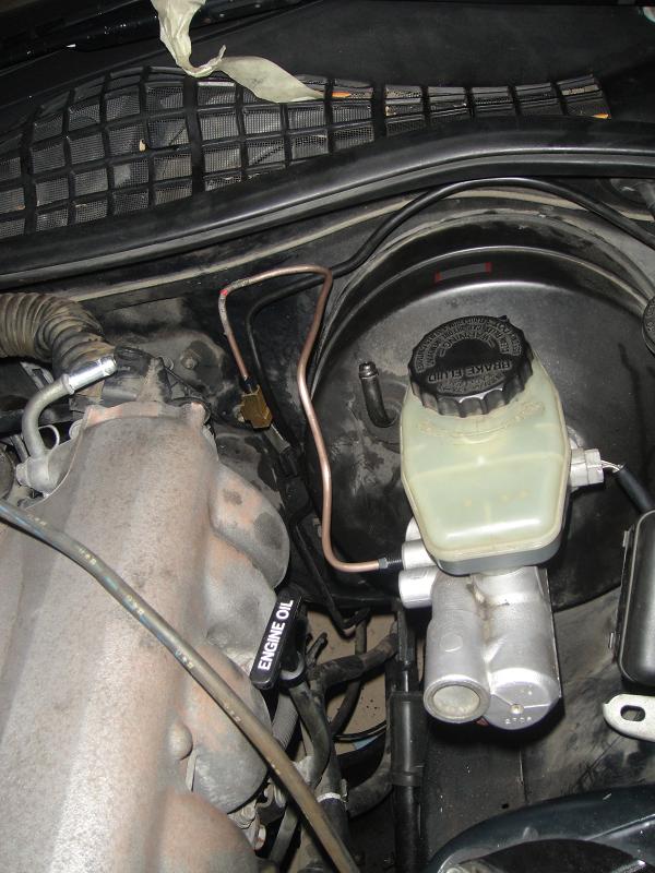

Front brake lines are all mocked up. All I need to do is some flaring which I think is going to suck, haha. Here's some pics, showing how the line is routed.
The line from the bottom of the Tee, coming down then bent right under the brake booster, then bent straight again to continue going towards the front of the car

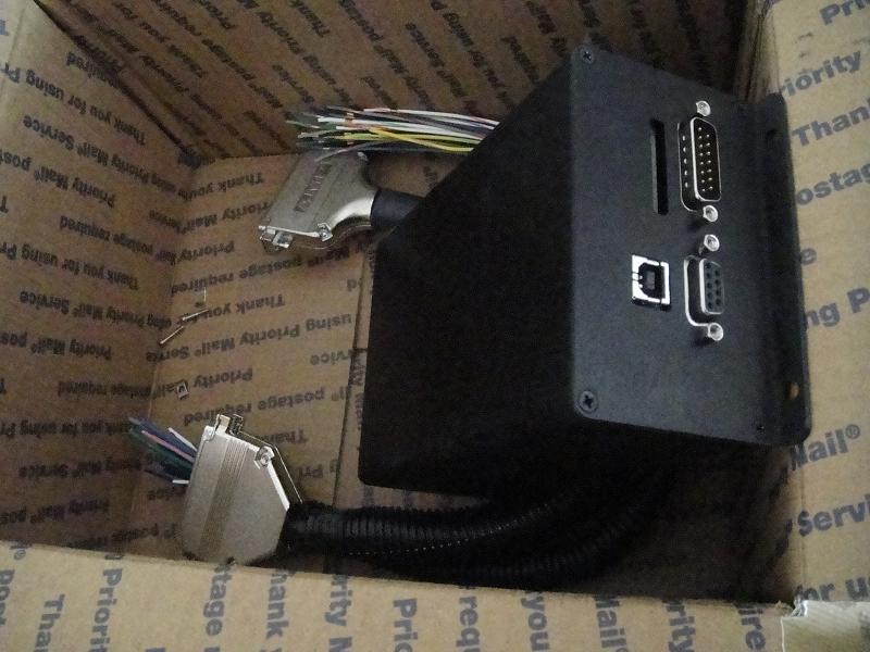

Megasquirt has arrived. Pic attached

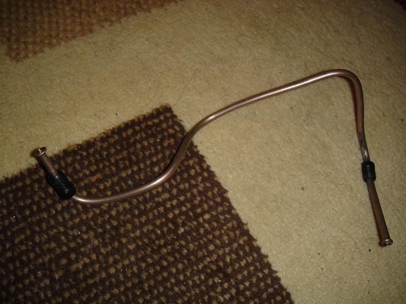

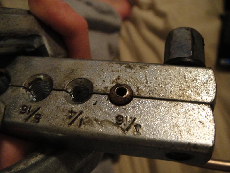

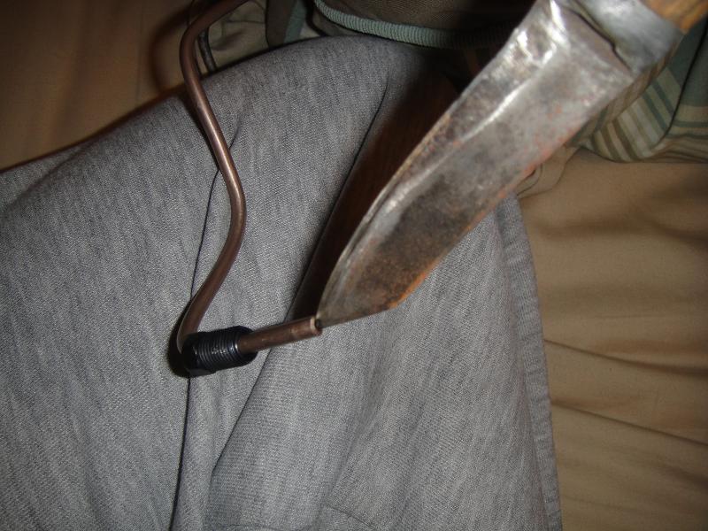

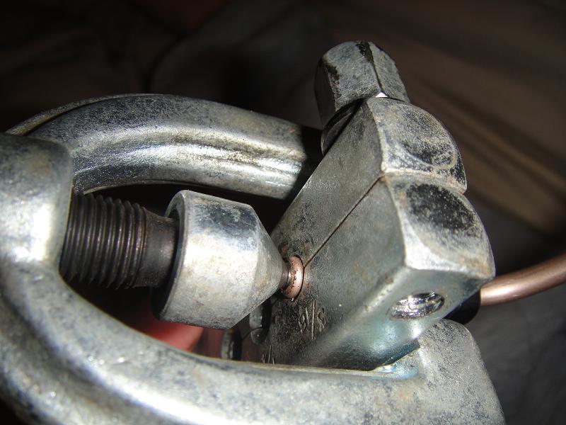

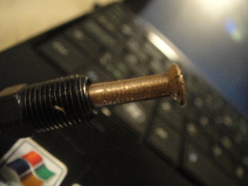

Didn't have much time today, but was able to go to my cousins today and borrow his flaring tool. I removed that first upper line and decided to just give this flaring tool a shot while laying in bed. One end was already flared, so I only had to flare one end. So here's my pics of the process of applying a double flare to the line. Was pretty simple, and took only a couple minutes. Turned out just fine it looks like. I suppose the real test will be once it's installed and hopefully doesn't leak.
Break out your professional deburring tool:
Use the die to measure the correct amount of line is protruding out of the clamp
First flare created with the die
Use cone to make the double flare
Double flare done

I thought for a second your flaring tool was the giant buck knife. That would have been skill to do a double flare with that.
Old 12-15-2010   #237
Re: Project Lex
Nah, just the deburring tool
