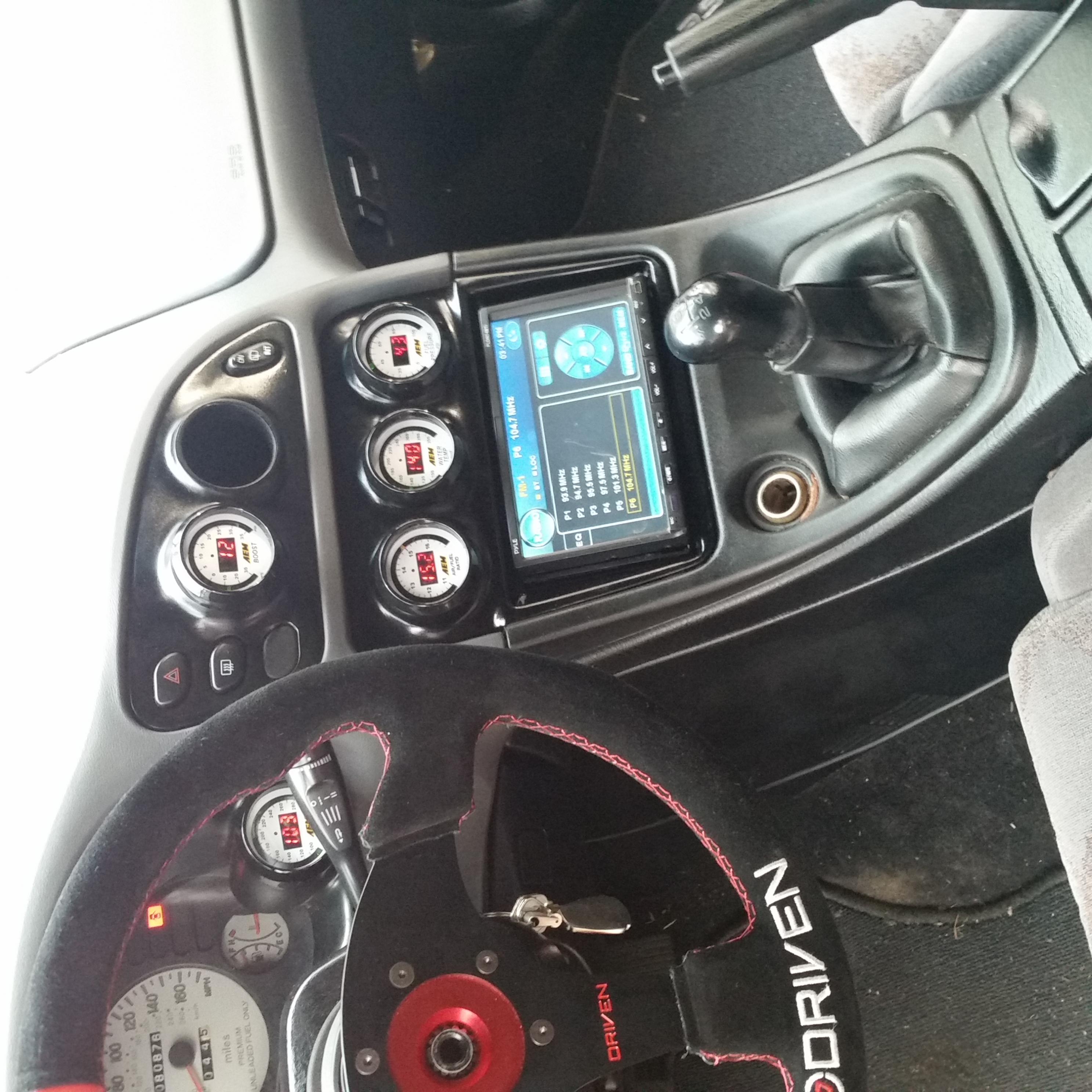

Decided to just keep the pod. Went ahead and wired up all the gauges. I still need to make the final decision on either getting a Trans temp gauge, oil pressure gauge for turbo pressure, or if I should located the battery cut off in the remaining hole.
I don't like having the A/F gauge below the boost gauge. So I'll be moving it up into the open hole probably later this week.

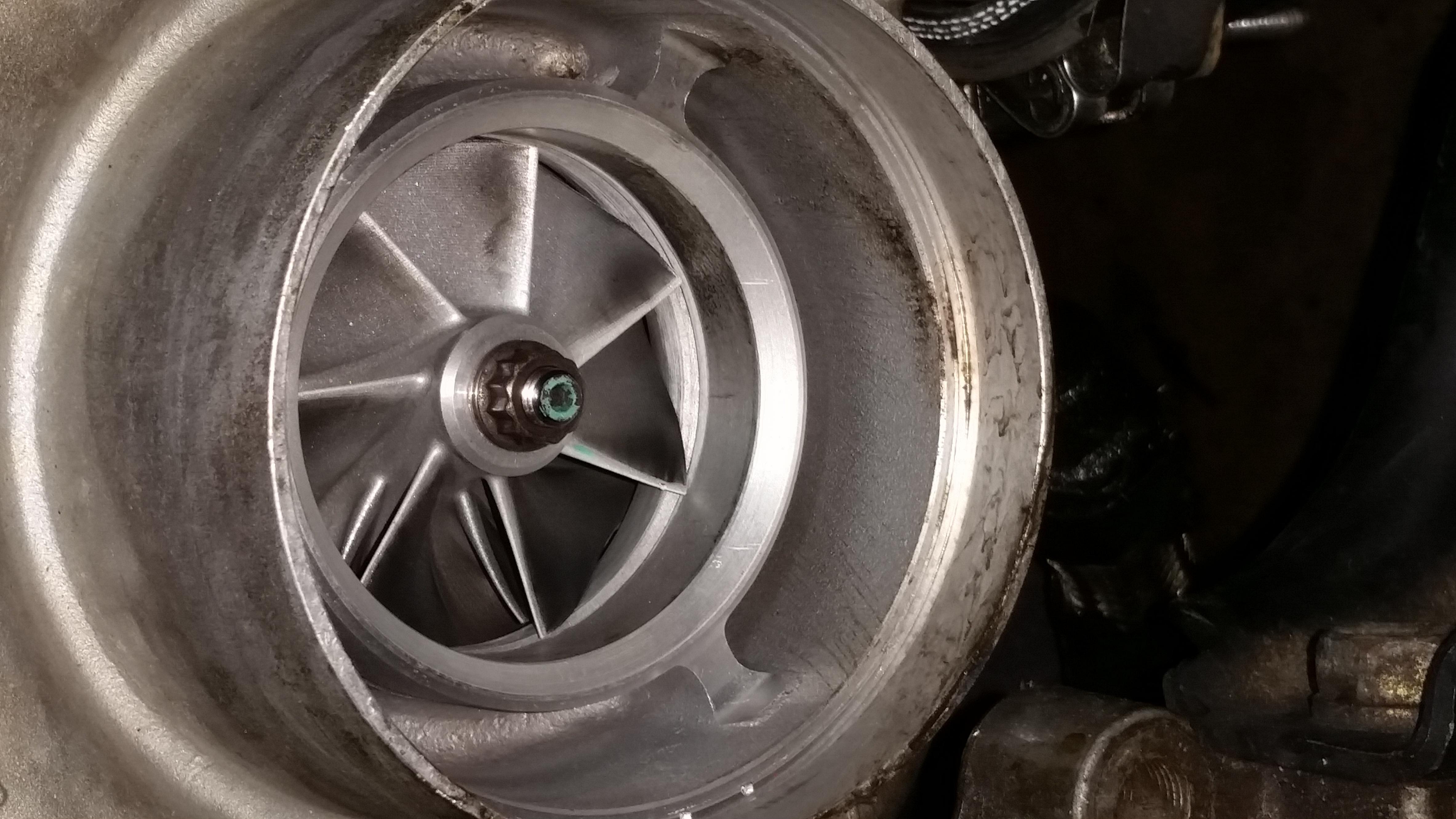

Well turbo spins. But has a lot of up and down and side to side play.
Looks like it started to rub on the compressor cover.
You can see scrap marks on the bottom on the inlet in the picture

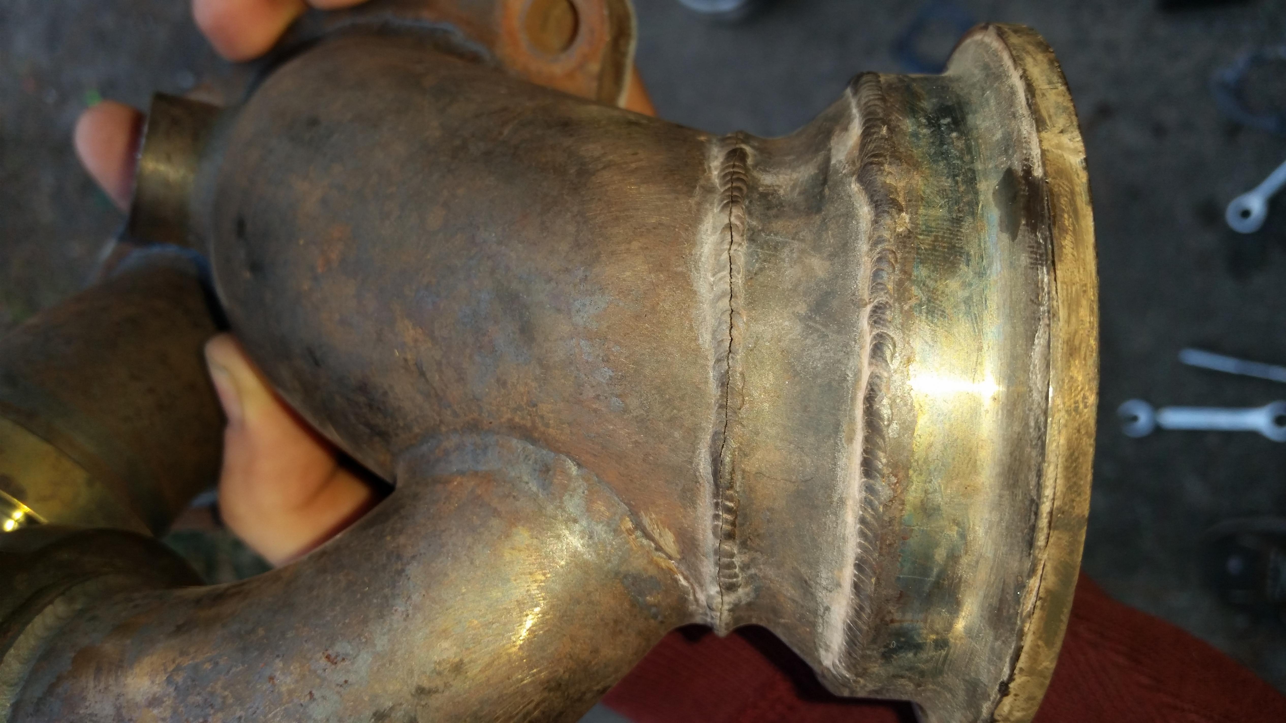

But what I don't get is. It almost looks like something came through the exhaust side. There is no up down, side to side play on the exhaust side. But several of the fins are missing. Any thoughts of what would have caused this?
Also found my O2 housing is cracked.
