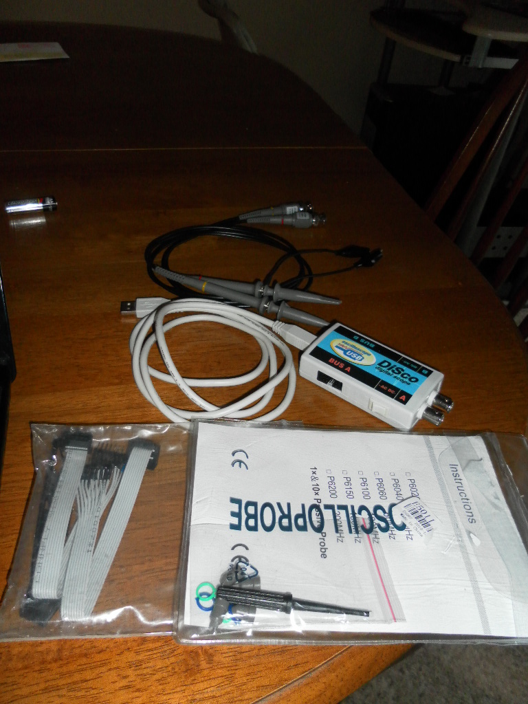

Got the new O'Scope in the mail Funny because I'm pretty much to the point where I don't think I'll need it now. But whatever, it's a good little tool to have!
ID:	11385   Click image for larger version

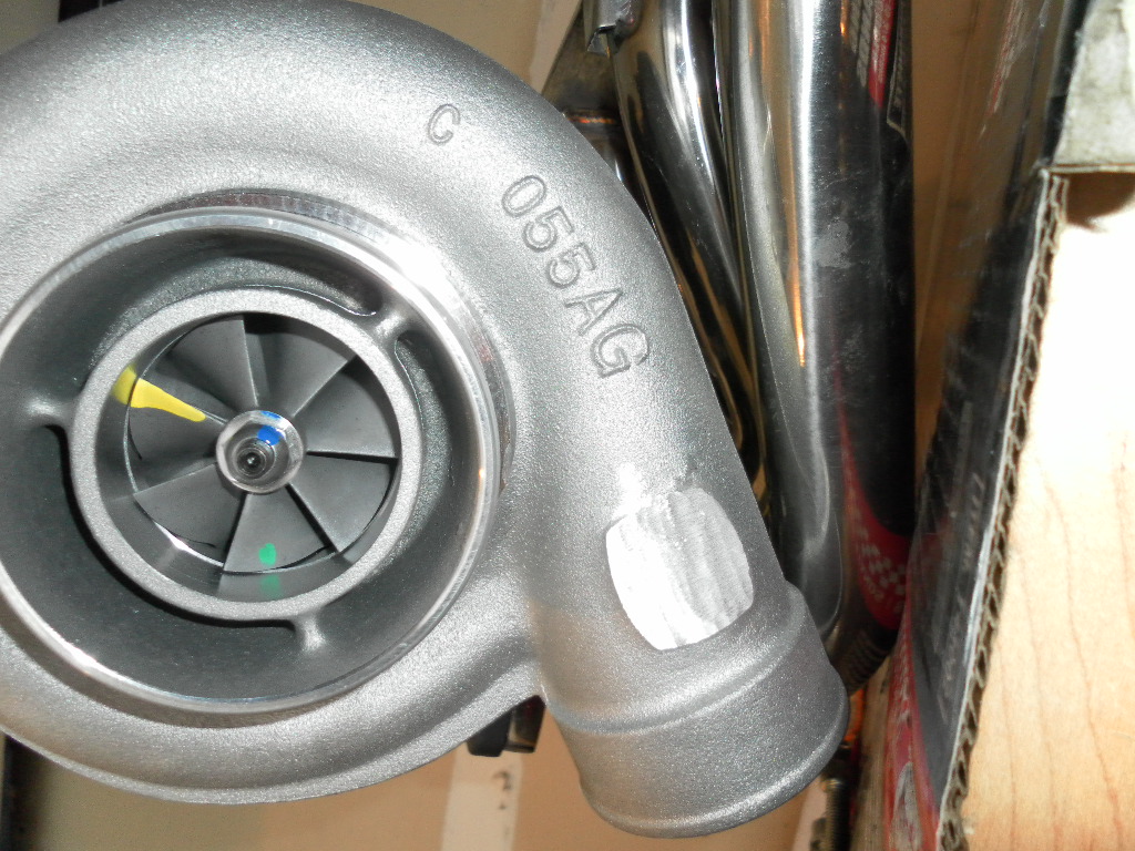

Also, it looks like DB's dyno schedule is a bit busy, so I may opt to not get it tuned before doing the turbo, since it does seem to be running fairly well overall as-is. Bolted the turbo up to the mani today just to see if there is any clearance issues with the compressor housing hitting the manifold. It clears like this, so this is prolly how it will end up being aimed. I also put one picture showing it clocked to the point that it hits the #1 runner.

Looking sweet. Are you going to ceramic coat the mani? Or have the welds reinforced by someone at all? Polish the compressor cover? Turbo blanket? Since you have to take the cams out to put the new head studs in anyways, are you doing cams or just leaving stock ones? NOZZZ?

Yeah I plan on having Primo coat the manifold black eventually. Have been waiting though until I figure out the wastegate situation. It's currently flanged for a ballin HKS wastegate which I more than likely won't be buying. So I was either going to chop it off and have a different flange welded on, or just make an adapter flange. If I end up chopping it, I want to wait until I do that before coating it.
The welds, I was planning on leaving it as-is. Might be a good idea to have a local shop look it over quick though just to see what they think. Compressor cover, I think I'll be leaving it as-is for now. But it'd be nice to get it polished in the future. Turbo blanket is definately something I've been considering. It's already coated from Primo, but having a blanket as well wouldn't hurt I'd think. And knowing me, I'll probably go find the cheapest one that can be over-nighted from Chiiiyynahh.
Cams, I'm staying stock for now. Reason being is I really like a nice idle now a days. So I want to change as little is possible. Once I get it running good turboed on stock cams, then I'll consider dropping in some better cams. I haven't even researched them yet so no clue what I'll get at this point.
And definately no Naaawwwsss I'm scared of that sh!t.
Originally Posted by awd-drifter View Post
snaps brandon! that a t88!! lolol. lookin' and soundin' good man.
Borg Warner baybay
