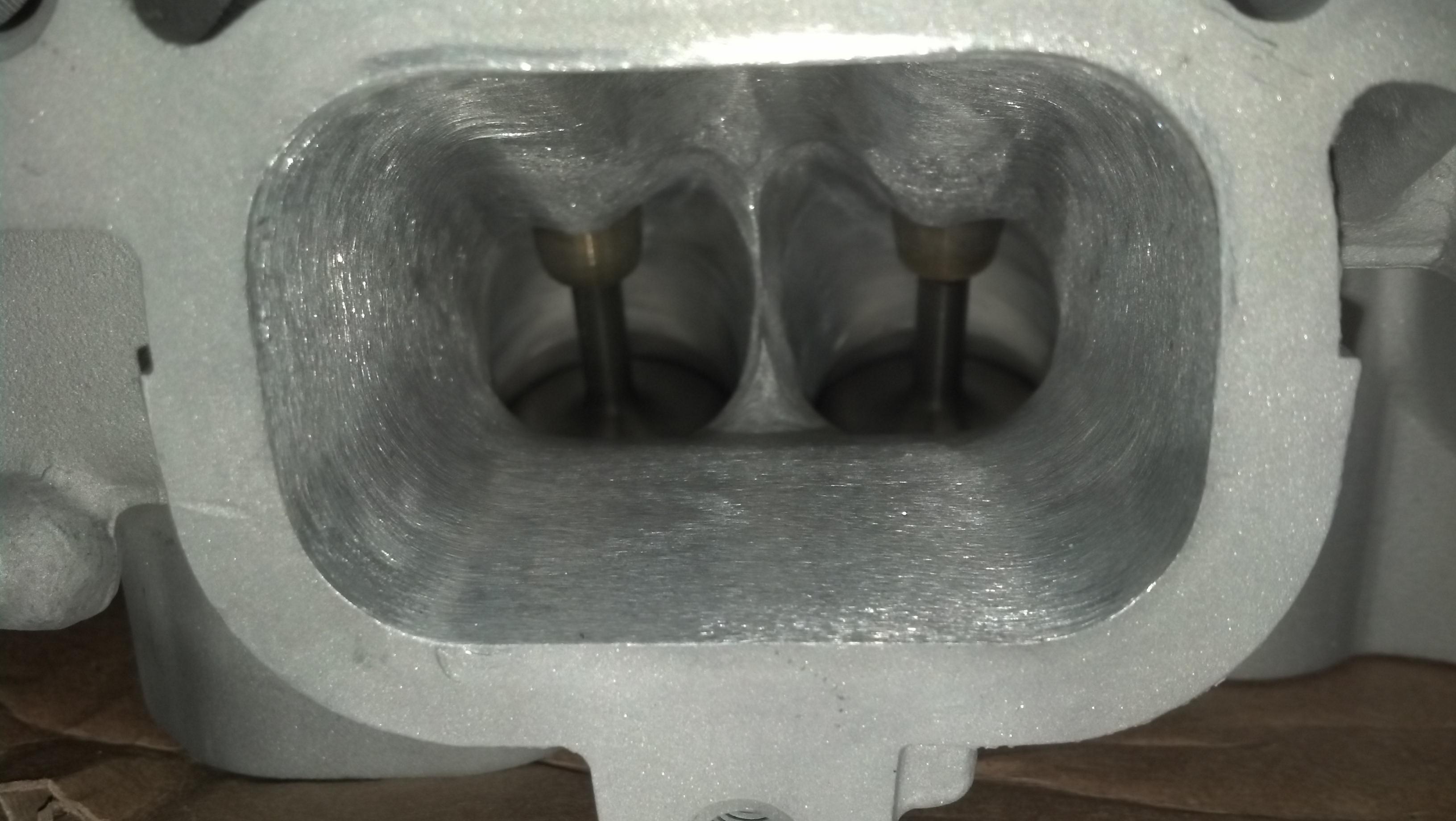

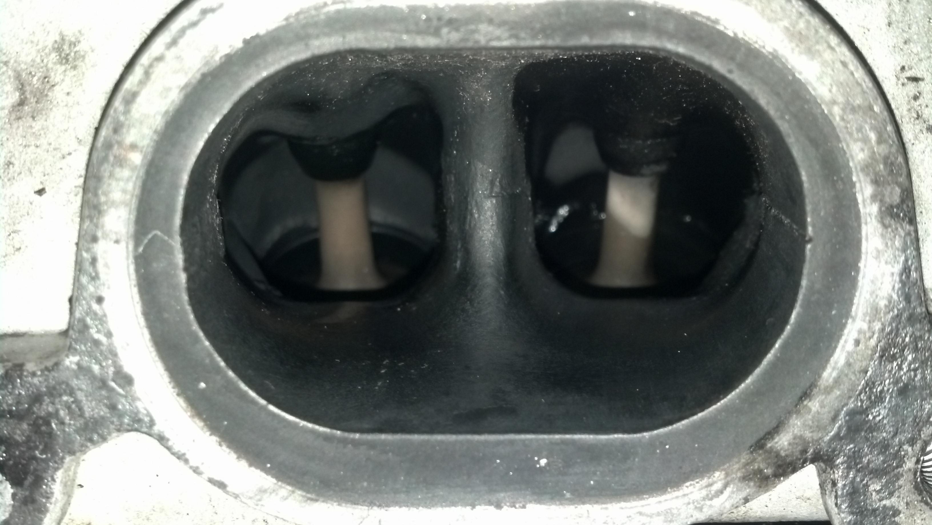

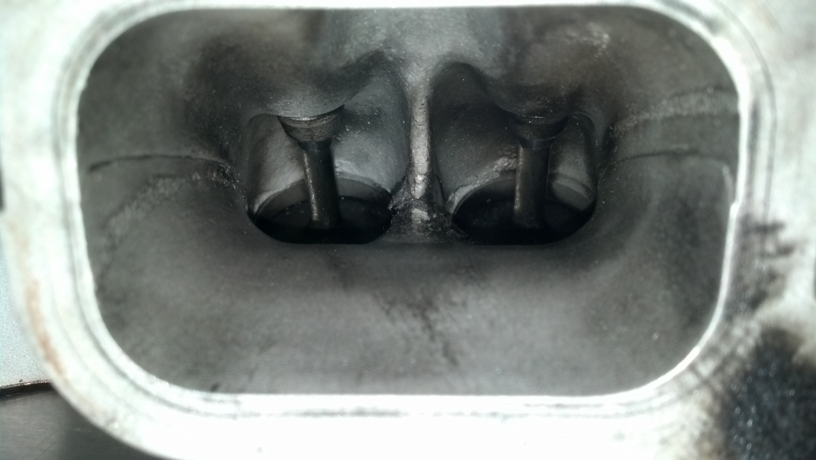

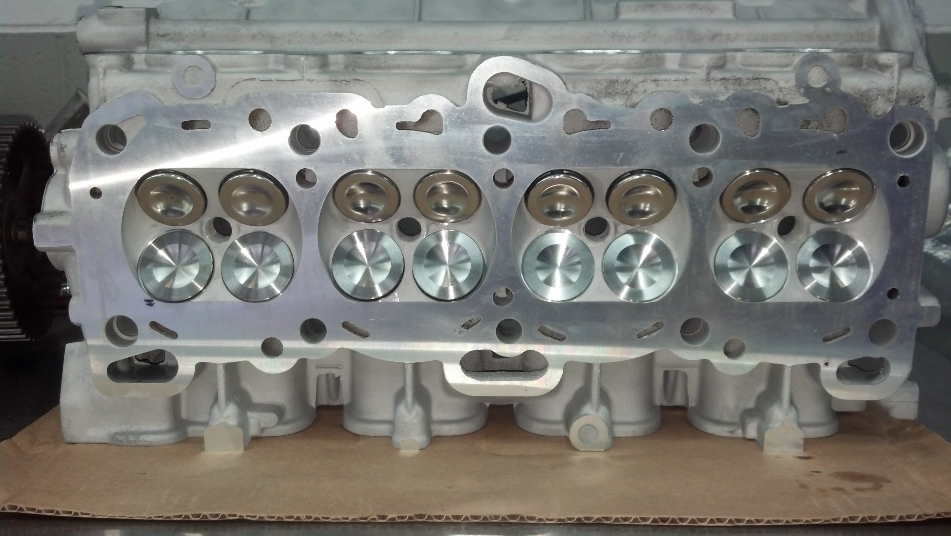

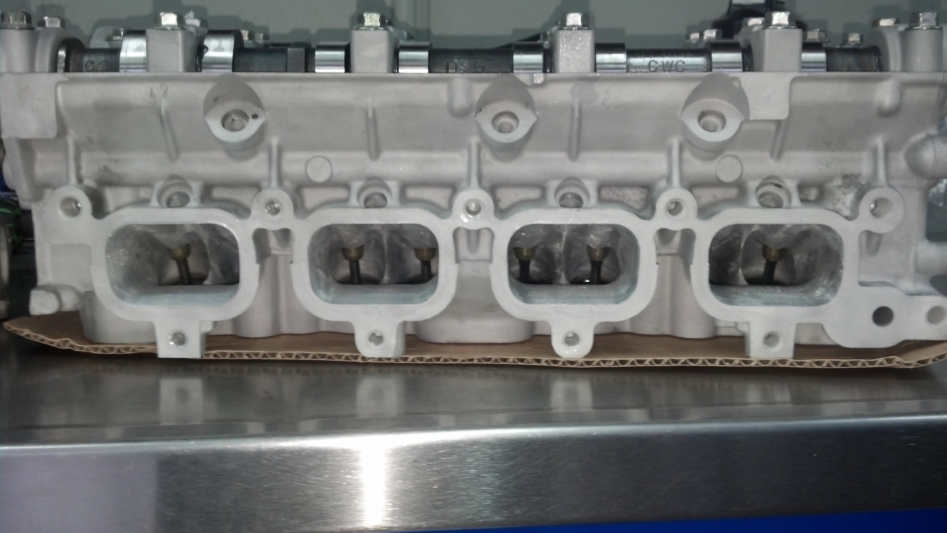

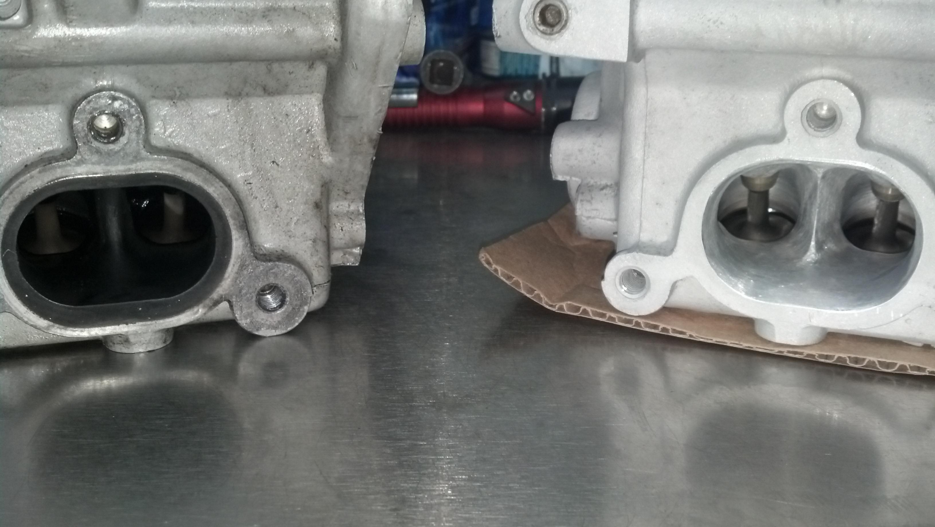

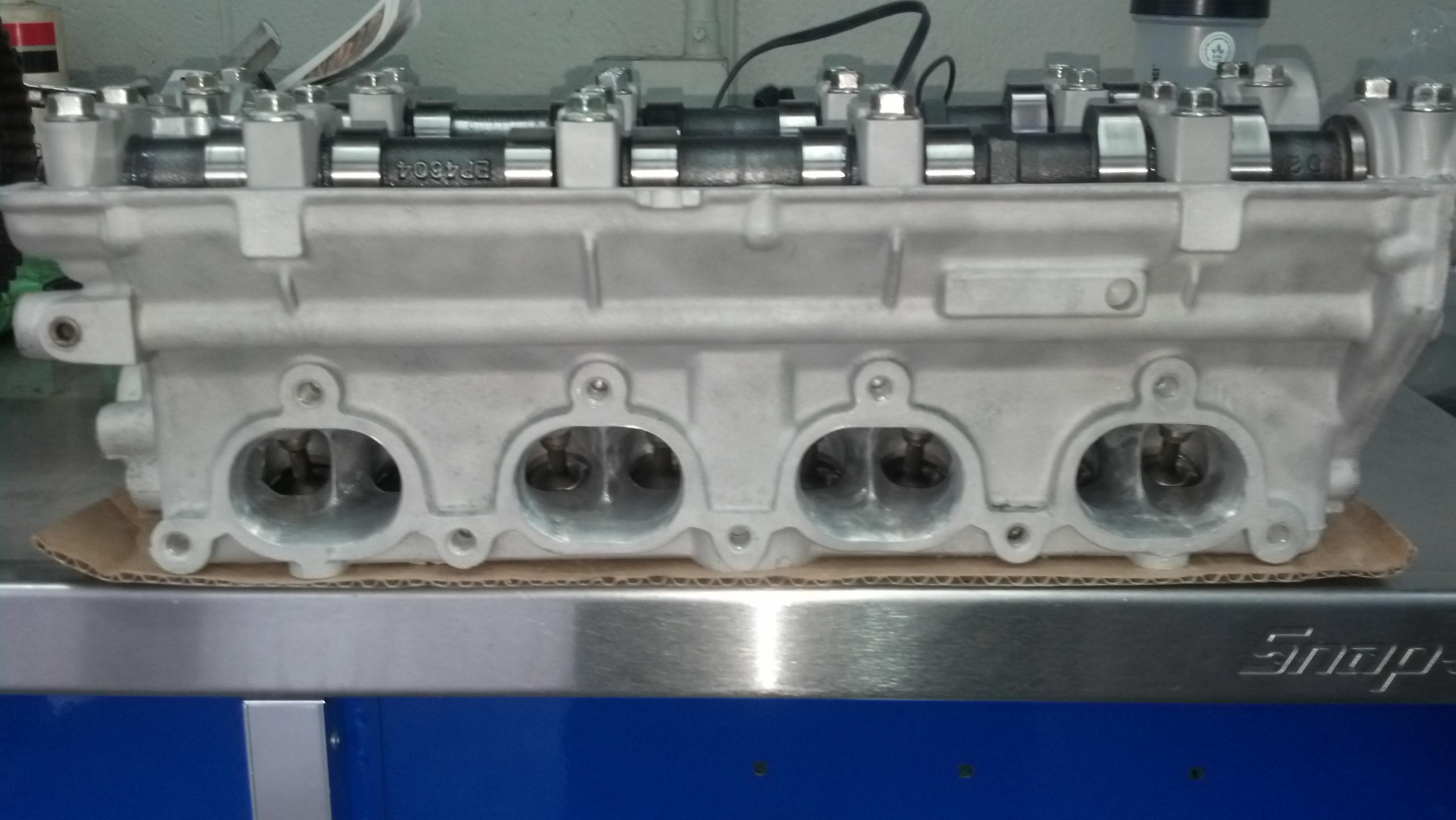

Ok so I got my head back from the head shop today. It's got ferrea springs and retainers, ferrea competition plus +1mm valves, it was ported and polished and port matched to the manifolds. I just need a head gasket and a few other things then I can start putting her back together. Here are some pics.

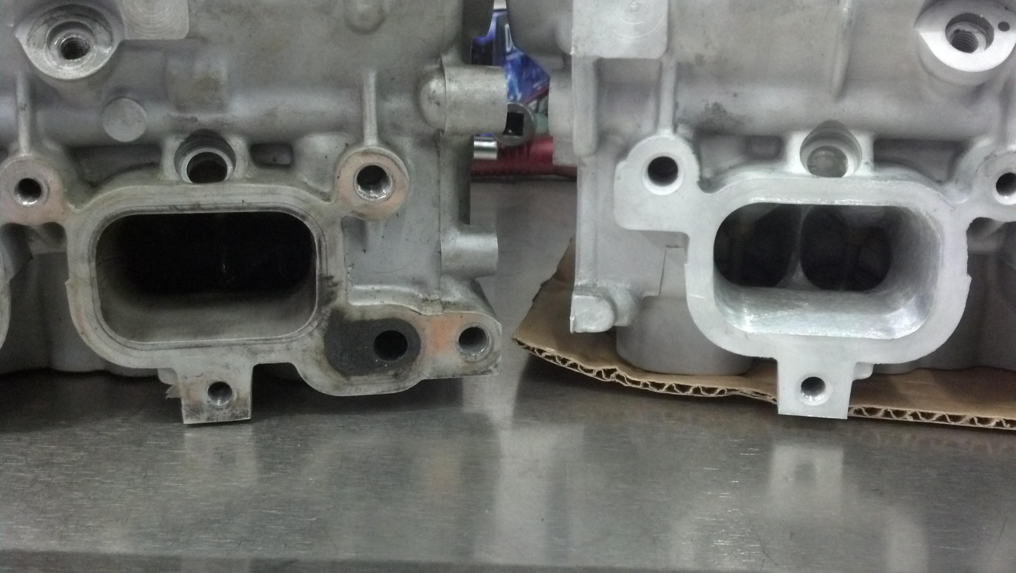

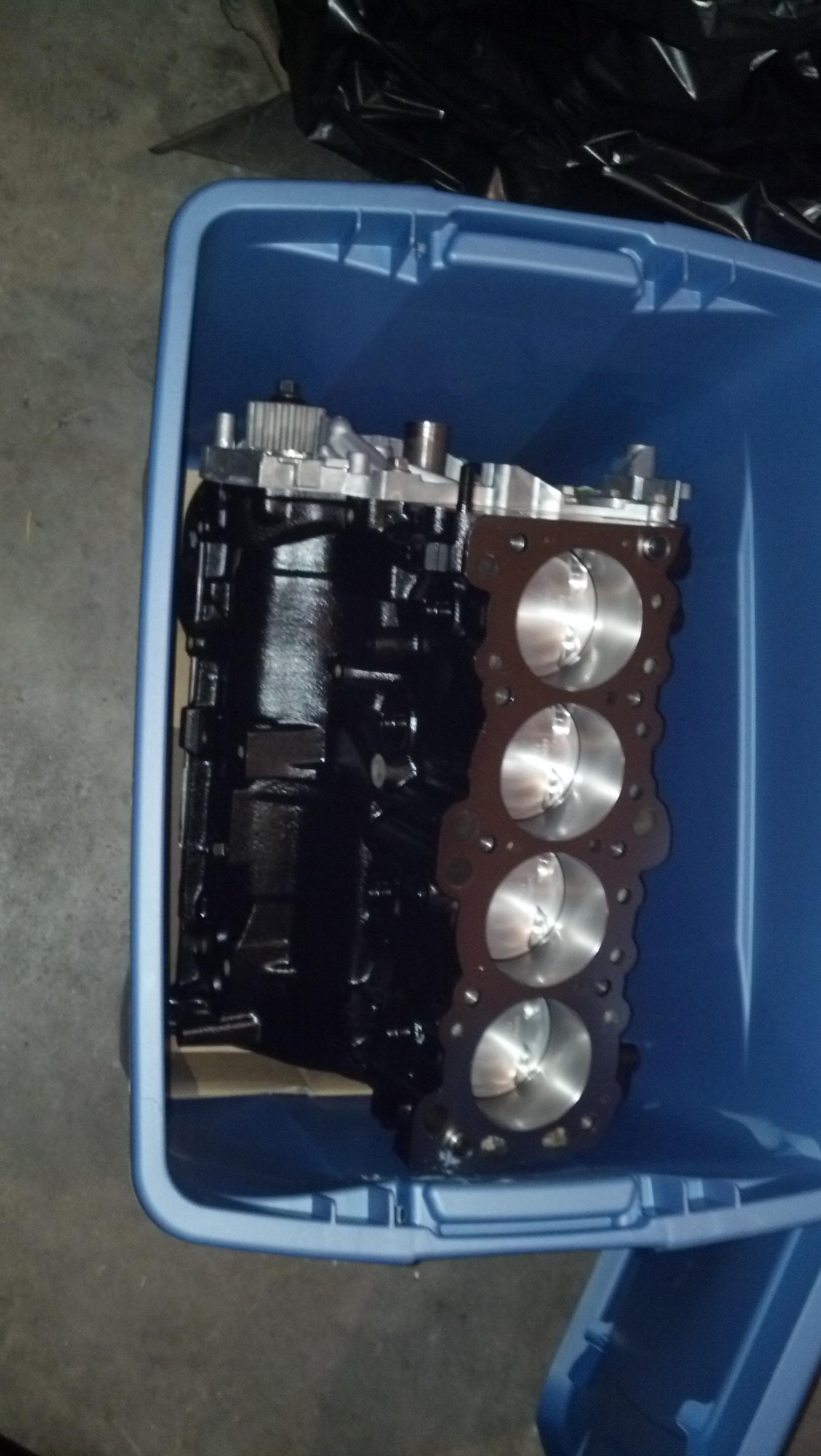

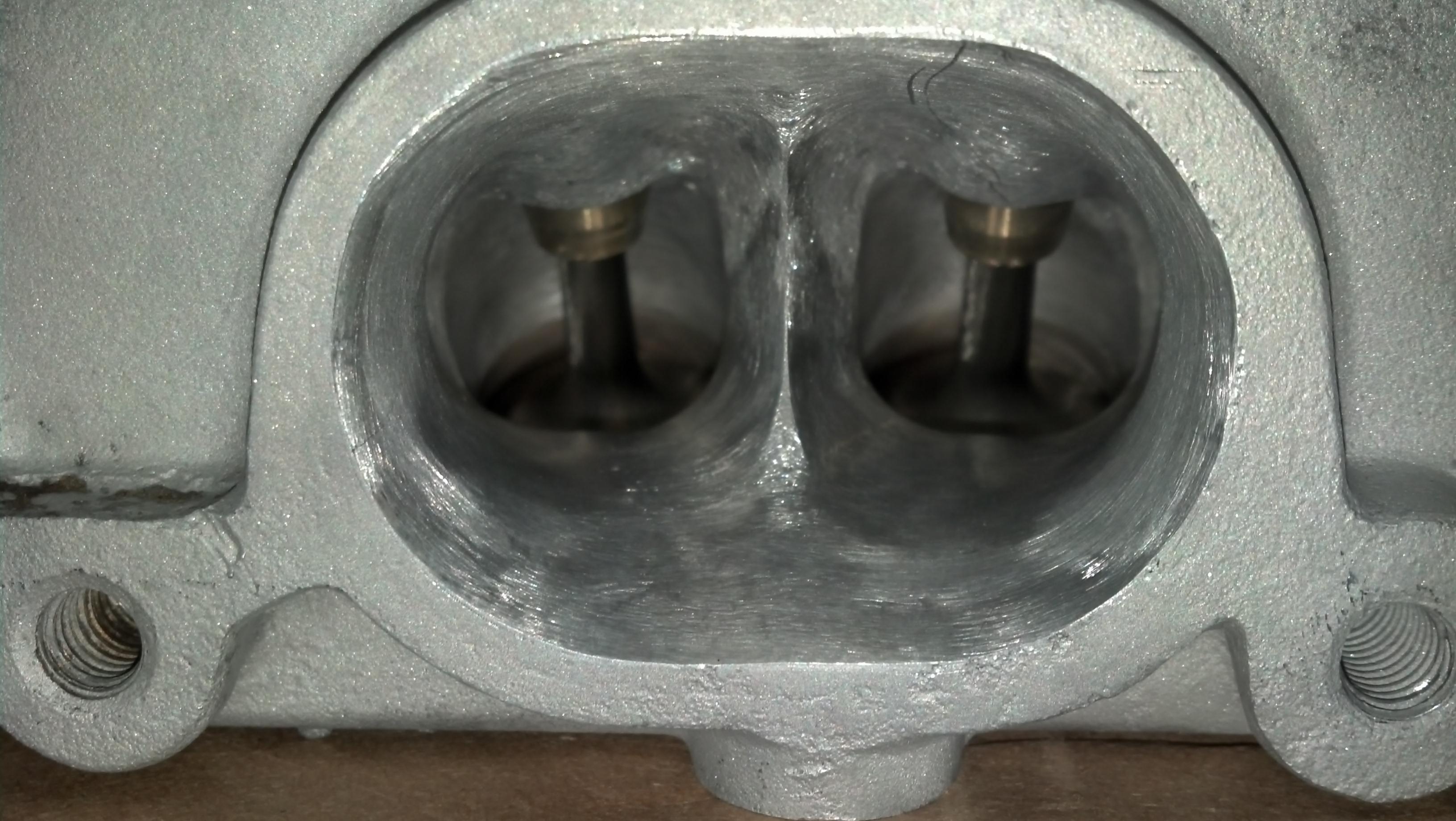

Some more pics of the head. Can't wait to start putting this thing back together!
