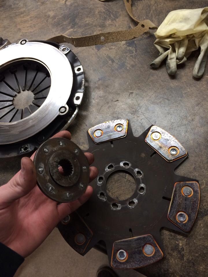

Okay sounds good I wondered. I'll definitely call them tomorrow morning! Unfortunately the ACT plates are sold out but maybe I can convince them to separate a kit and sell one. Or I'll see if I can buy a competition clutch stage 5 plate.
-Adam
aneujahr@maperformance.com

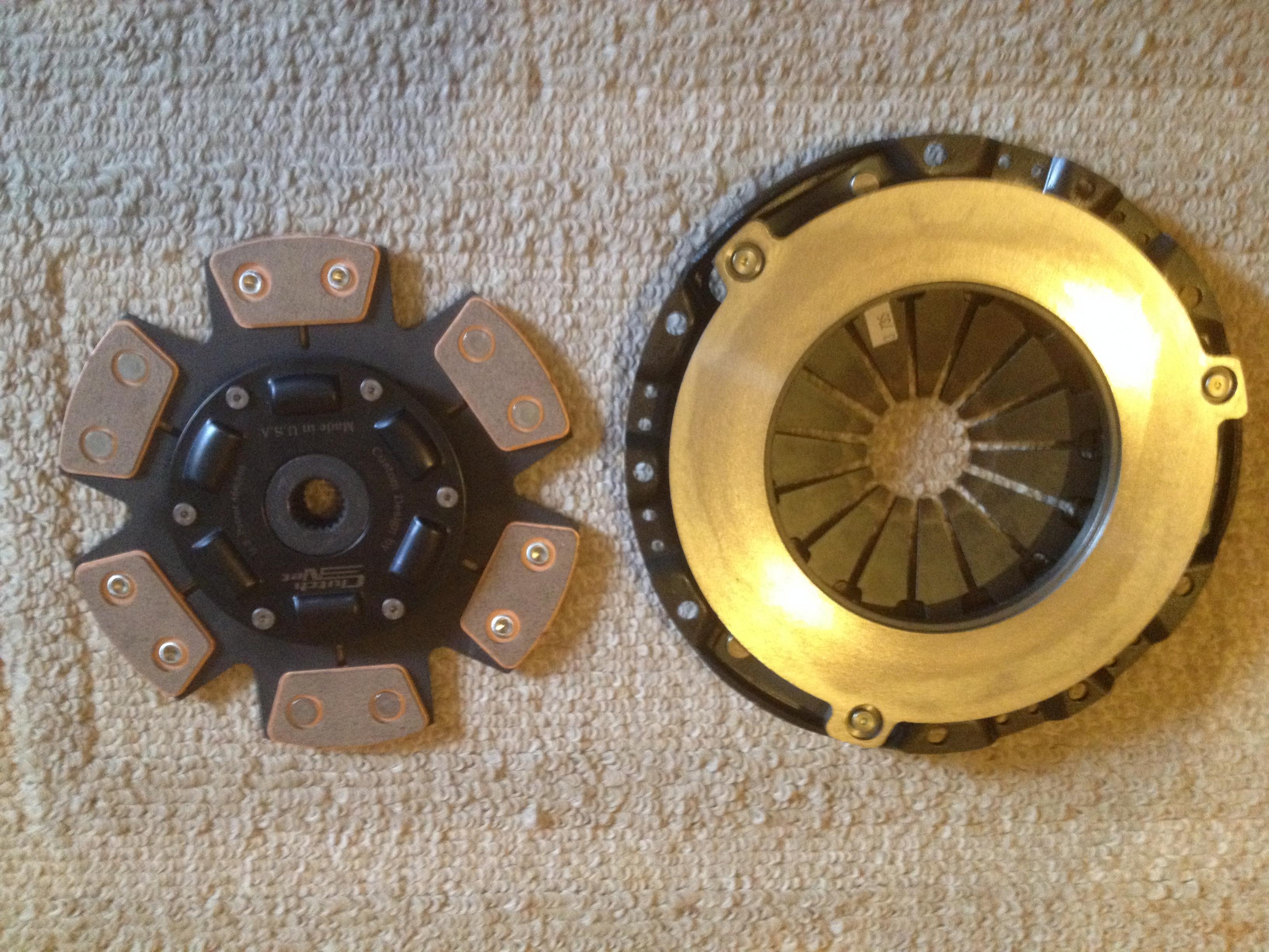

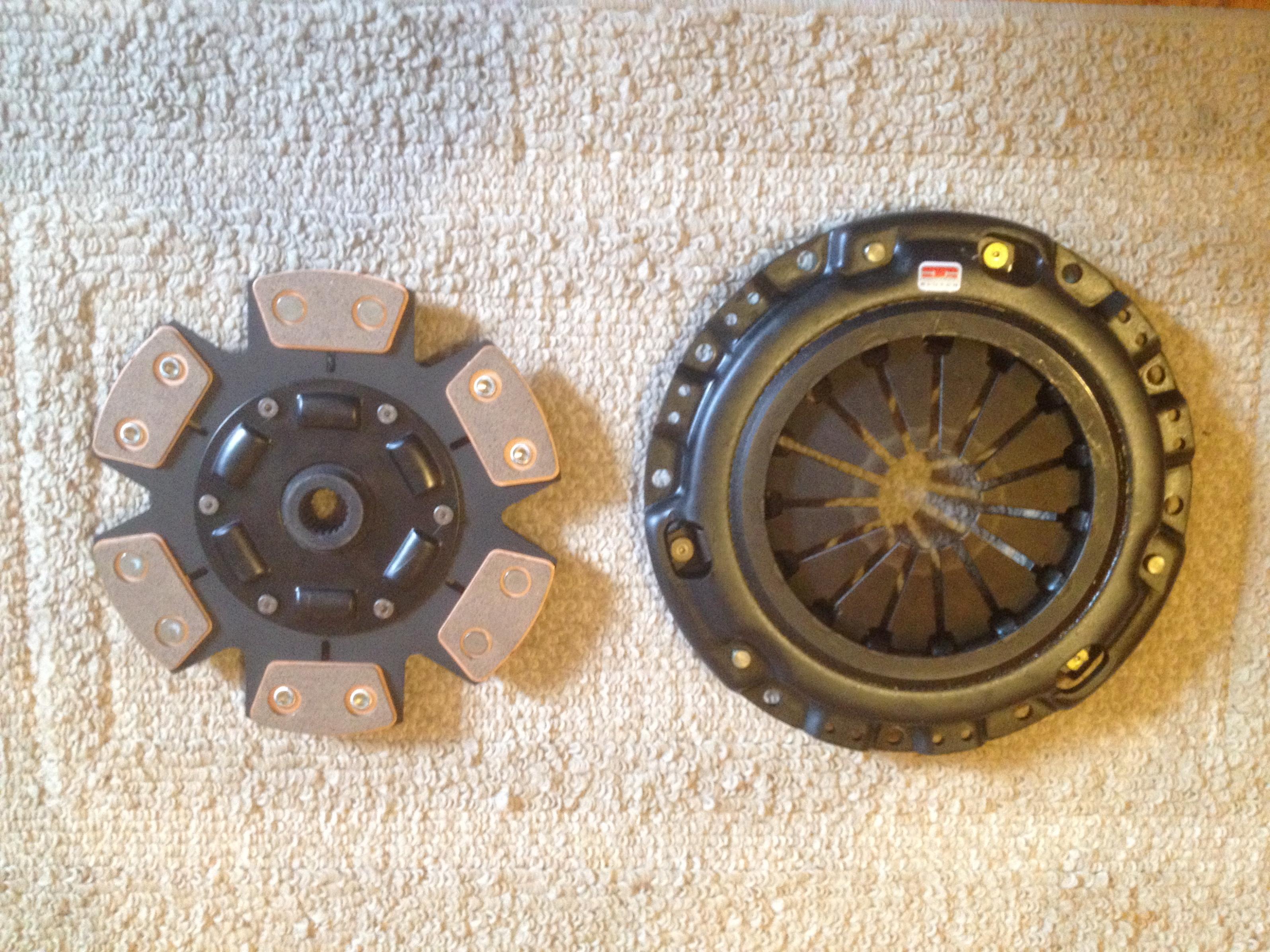

New goodies finally came. Time to get going!
ID:	14090   Click image for larger version

Old 12-02-2013   #31
Re: Clutch explosion
Clutchnet disk and Comp PP?
Old 12-02-2013   #32
dogwhistle
dogwhistle's Avatar
Join Date: Oct 2012
Location: St Paul
Posts: 551
Yep! The pressure plate runs 2700# and the disk, well, you guys know the disk. I look forward to seeing how well it works and I'm sure it's miles ahead of my old setup. I'm saving the XTD plate for another idea later on...
