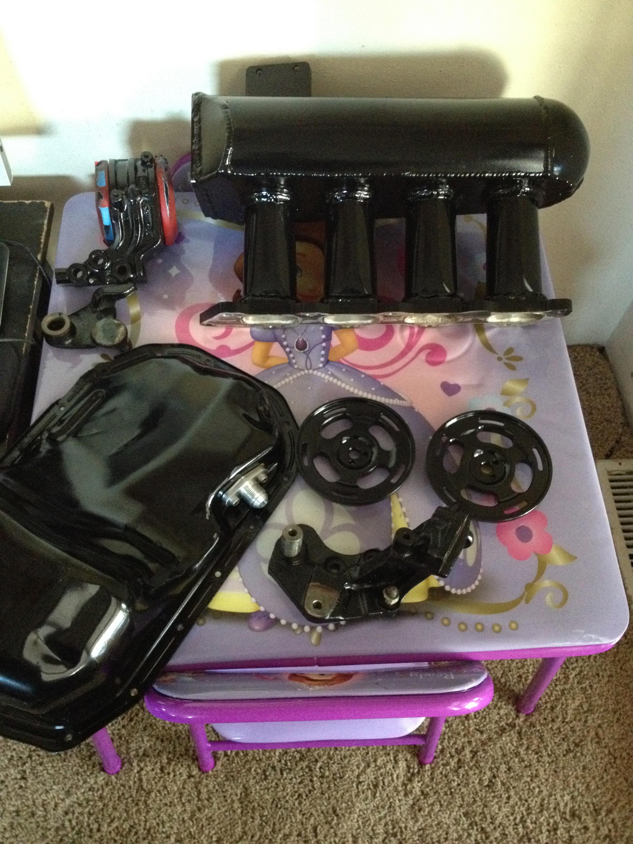

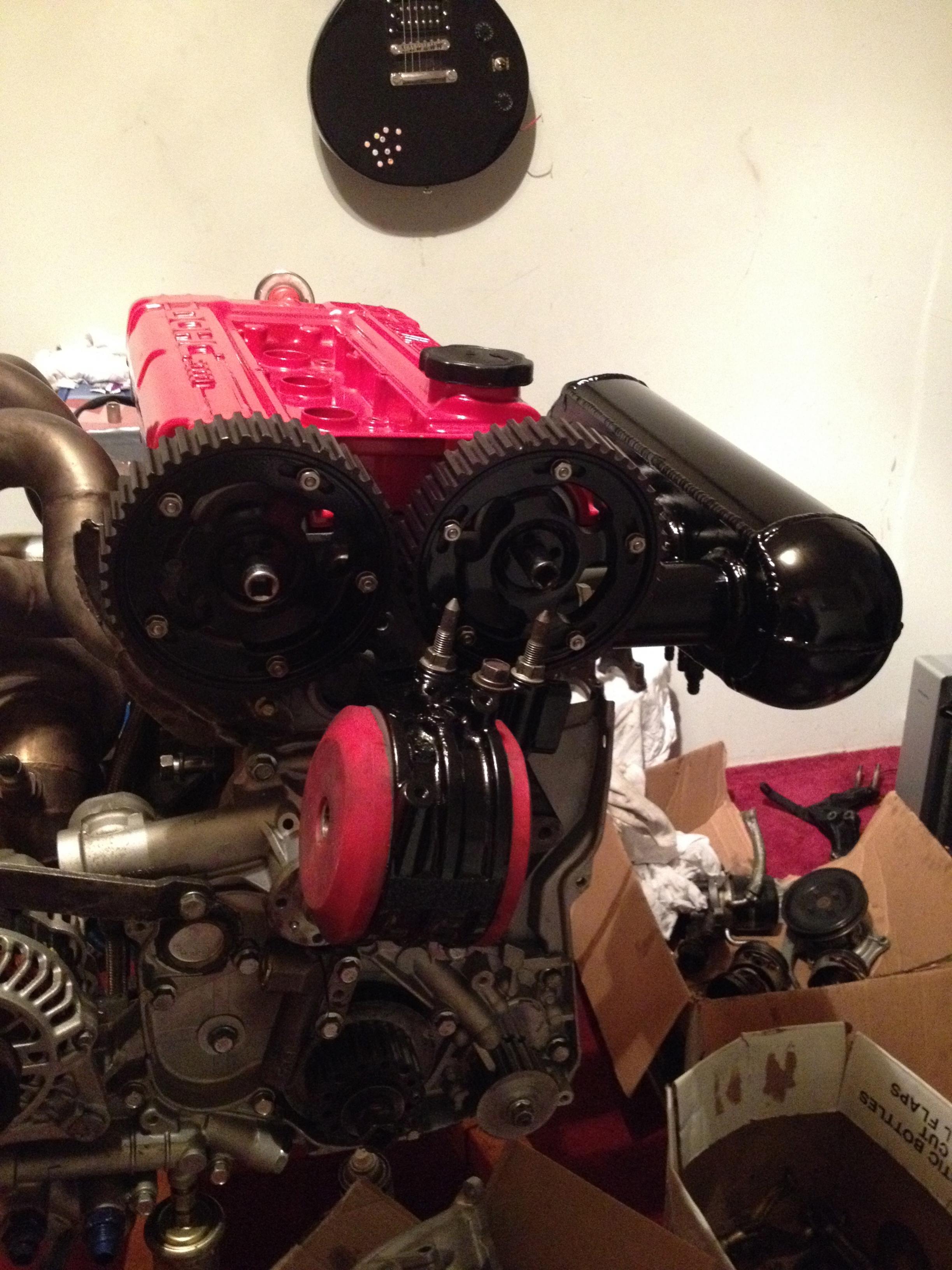

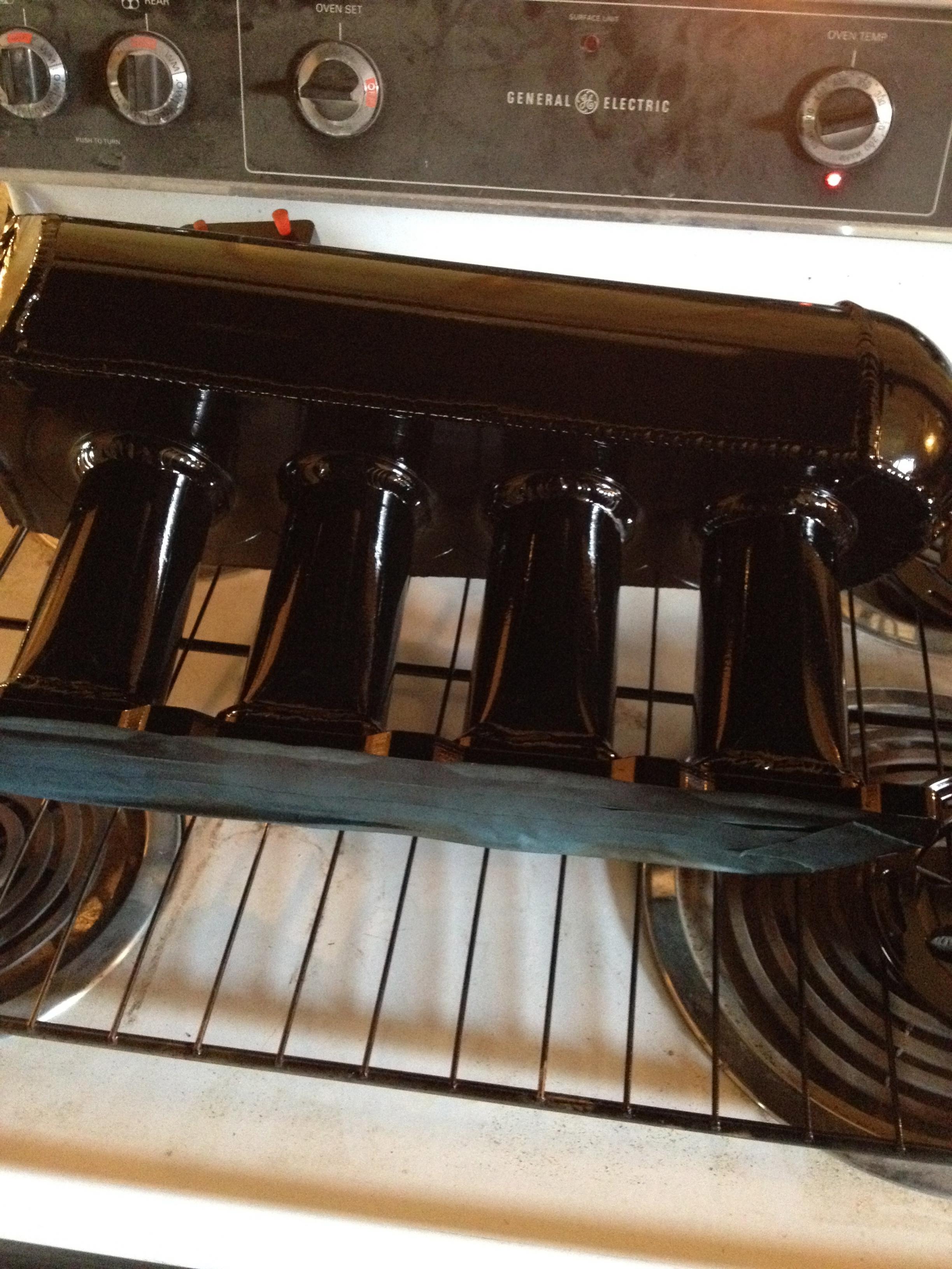

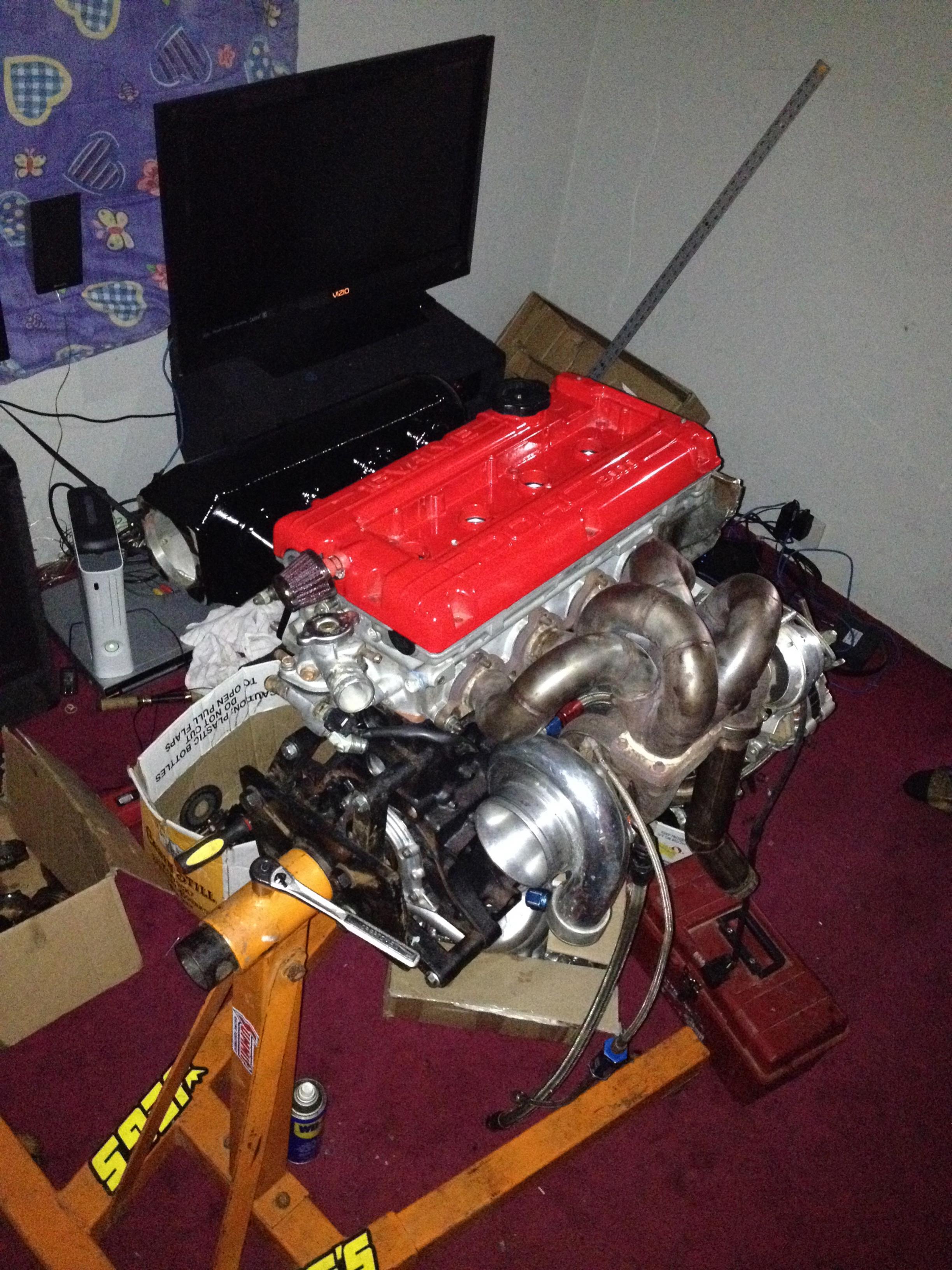

Did some powder coating today for the first time and the results were awesome. Next will be that ugly compressor cover and who knows what else. Should add around 50 hp or so.

What about Ron at RS Motors? He does tons of rebuilds on Evo transmissions. Just a thought.
Also nice work on the powder coating, did it yourself? You must have access to some of the tools needed
