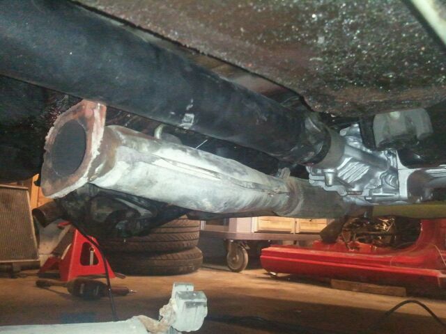

The driveshaft looks pretty darn straight when it's bolted up and I tried my best to align it exactly where the other bracket that I removed was. But I don't have a tool to measure the angles of it, so I have no real evidence.

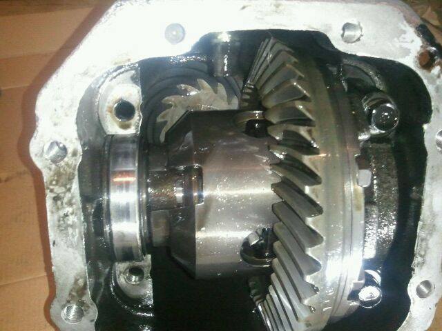

Idk if this pic helps but this was right before the last cap went on. There was no excess play in the pinion gear when I grabbed it from the flange where it connects to the D.S. And I never touched the lsd part...If that's what you are referring to?

Yeah with a new ring and pinion, you will most likely have to re-shim the pinion or differential carrier. Without the proper pattern, you can get vibration and can cause a lot of damage to the differential carrier.

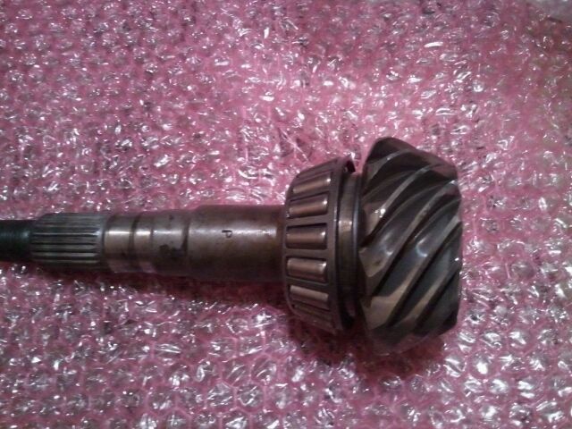

Just thought of what it could possibly be!! When I did the ring and pinion gears I never swapped this bearing and spacer over I just used the one already on the pinion gear that I received!
I'm guessing I was supposed to do that!? f me if I was lol
