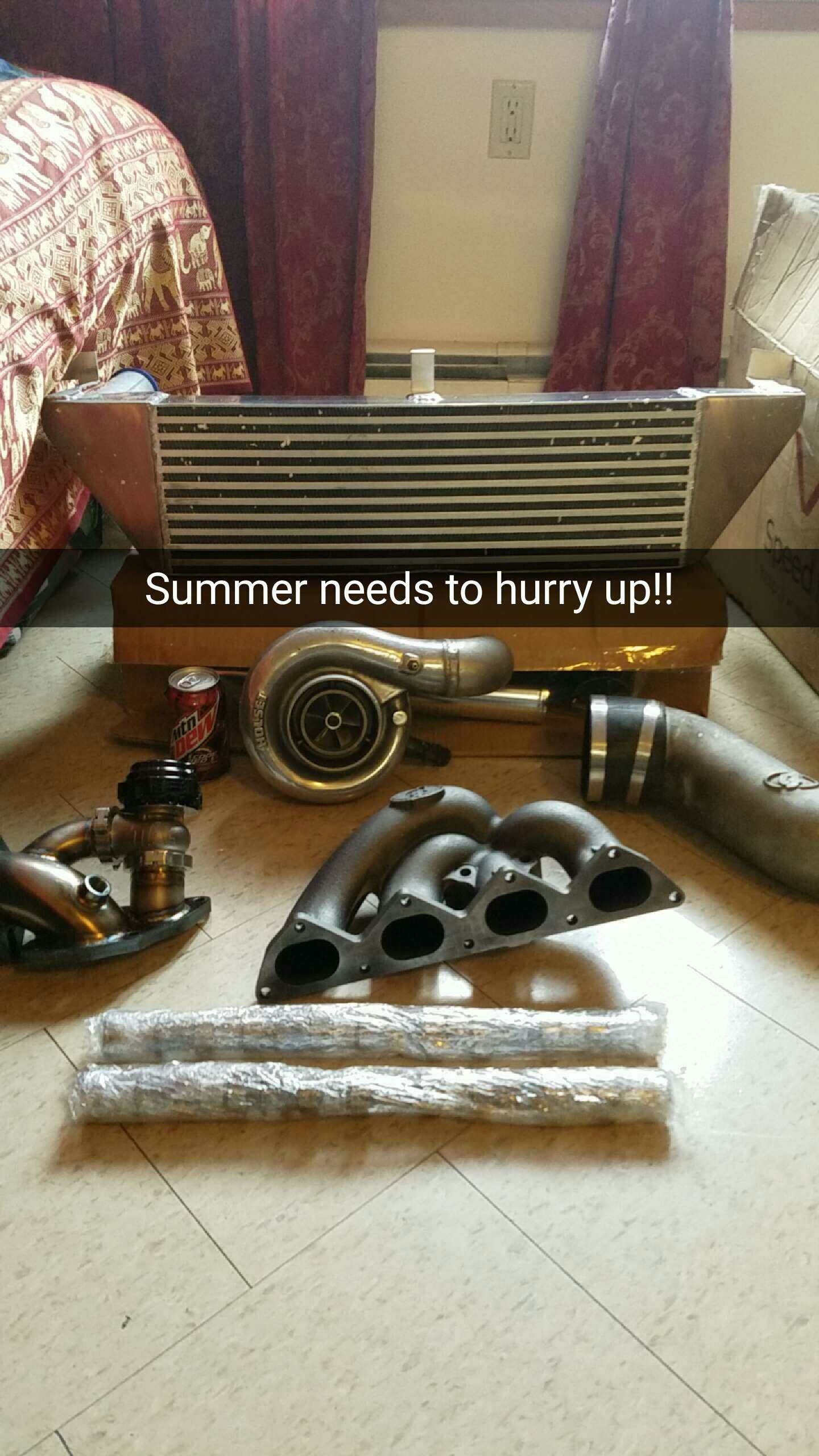

DSMLink and a premium built Jacks transmission are on their way!
I currently have a gm maf and my dsmlink came with a gm maf cable. What's your opinion on gm maf vs speed density? Would it be worth it to sell my gm maf + cable and add a little cash to get speed density? Or just run gm maf? The engine is still stock, just going to add cams and valve springs/retainers to rev a little higher. With that in mind I won't be pushing the car past 500hp until I get a built motor and bigger injectors next year.
