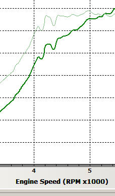

Originally posted by Raptor@Oct 6 2004, 11:13 AM
Good to see the new piping was effective
too damn effective
becaue at the track i was pushing same boost without piping, and i didn't have the surge problem.
but it also could be the fact the ambient temps are lower and air is more dense as well..
-E

here is part where the turbo bites back..

ipt
Posts: 25
Have you done a compression check lately?? I was getting compressor surge and I was getting it because I had a burnt exhaust valve in the #1 cylinder. It was all pissed off.
ipt is offline   Reply With Quote
Old 10-06-2004   #26
Enes
Enes's Avatar
Posts: 2,789
I will check it tomorow night.. good point, if the exhaust can't escape it should have issues..
but then again i should have issues with making boost as well, or at least delayed..
-E
