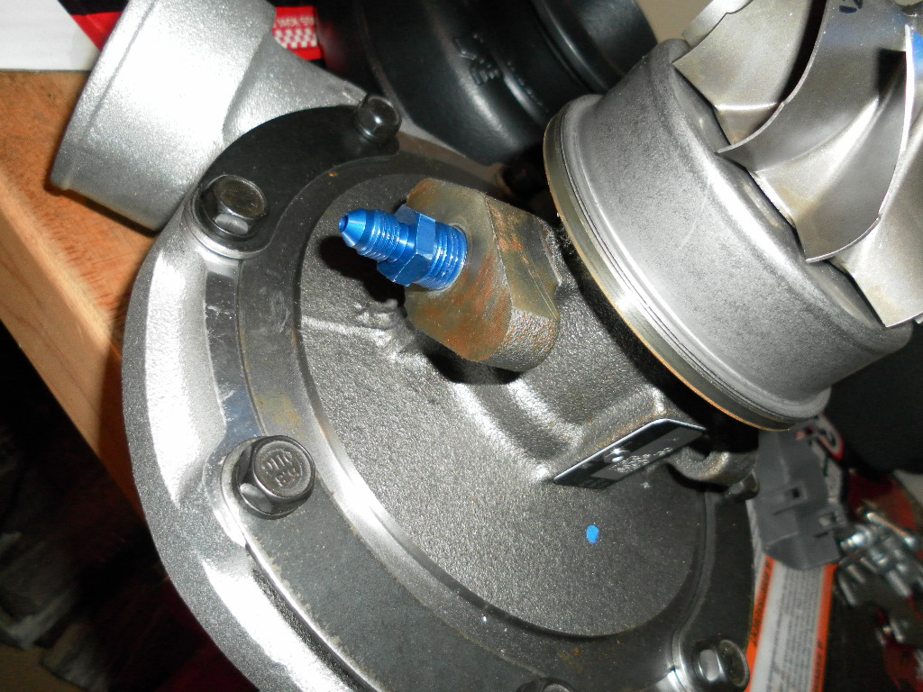

Installed the oil feed fitting into the turbo. I used a little bit of liquid pipe thread sealer.

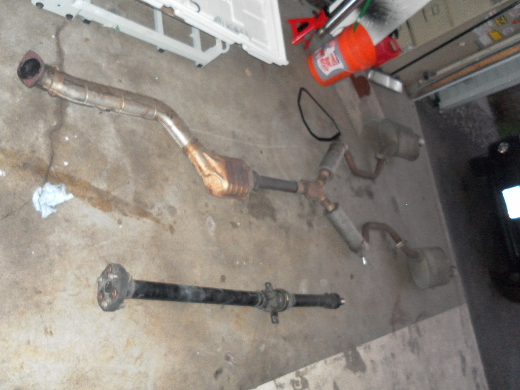

Decided to try and tackle the tranny. First I had to remove the rest of the exhaust. Once I got that off, I removed the driveshaft.

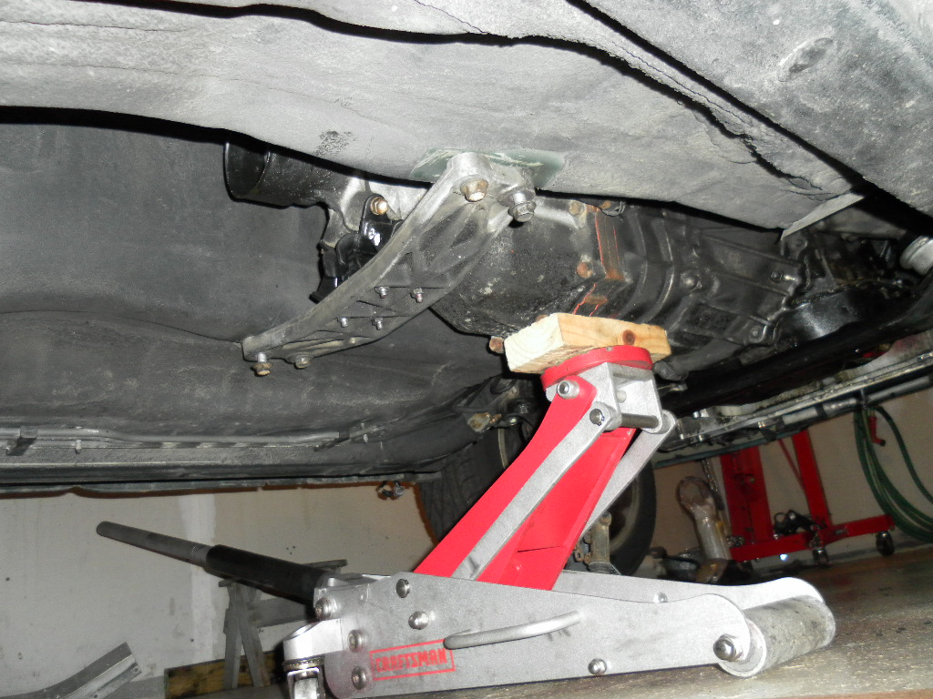

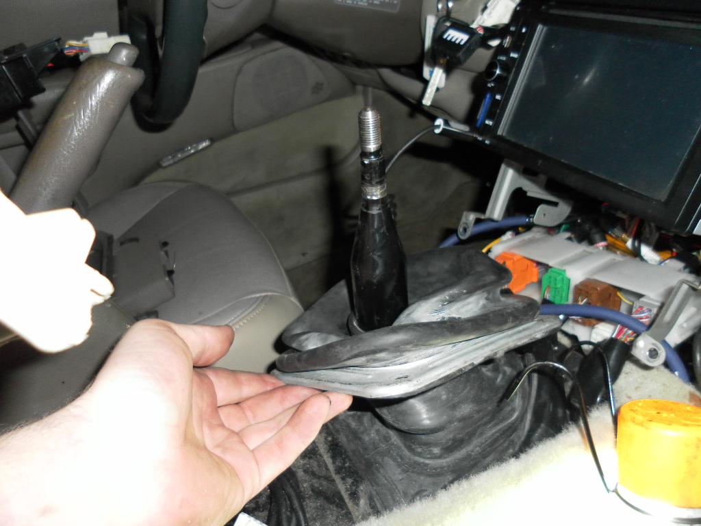

Then started at the Tranny. I got all the motor to tranny bolts off. Slave Cylinder off, Starter off. Took 2 of the 4 tranny mount bolts off. Took the reverse light plug off. And that's where it sits.
What's left is I need to find the speedometer cable and remove it. Then I have to figure out how to unhook the damn shifter in the car. I took the 4 bolts off that hold it to the tunnel. Looking online people say the shifter should just lift off? Mine doesn't budge. Dumb little thing I'm sure, just gotta figure it out. Then just remove those last two bolts on the tranny mount and she should be on the floor. Aaron hit me up tomorrow I need to borrow that tranny jack if at all possible.

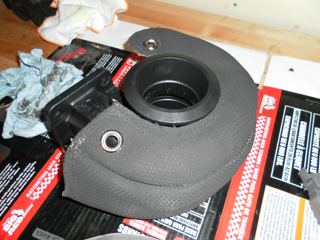

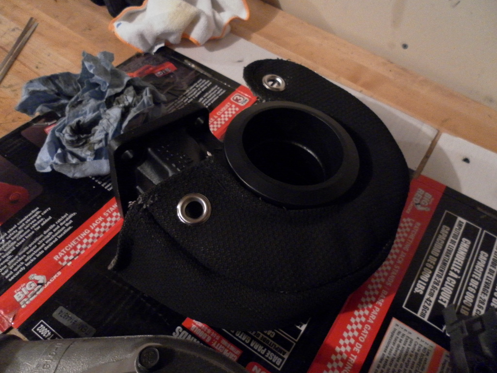

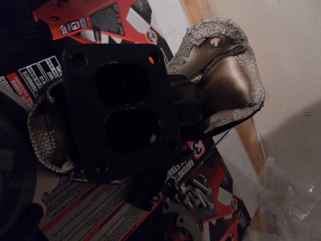

Also pics of the sweet turbo blanket

Also, did that turbo blanket come black, or did you paint it? Looks pretty good in black I must say!
Old 05-11-2011   #393
Re: Project Lex
Yeah clutch job. Just throwing in a cheap 6-puck ebay disc using the stock PP to get me by this year.
And yeah the turbo blanket came black already. Does look nice. Wonder what it will look like after a season of abuse though...

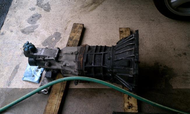

Tranny is off Yaay.
