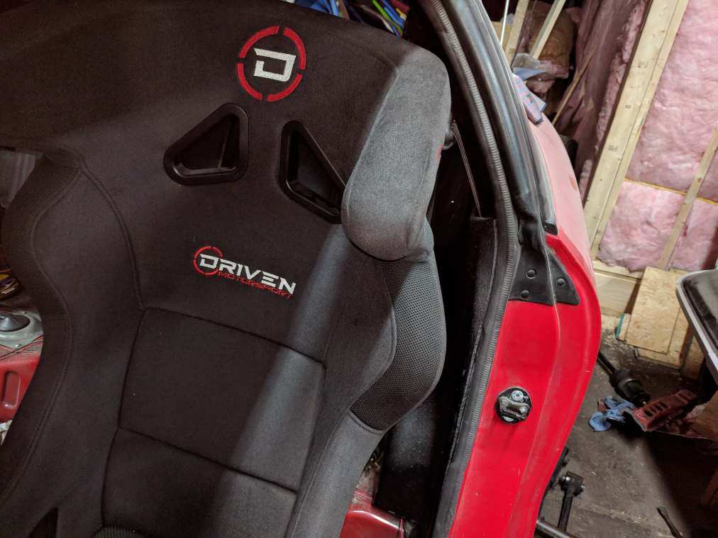

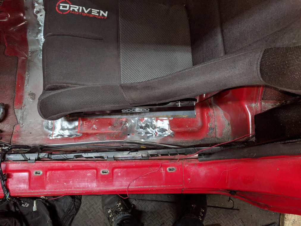

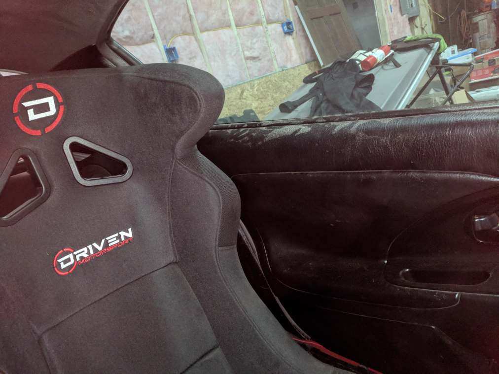

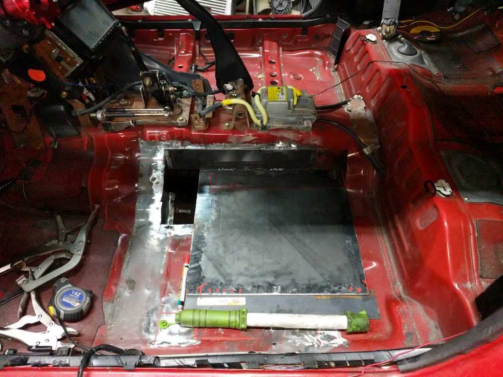

Update on the car. Finally got some pictures of in progress of my seat mount mods for the car.

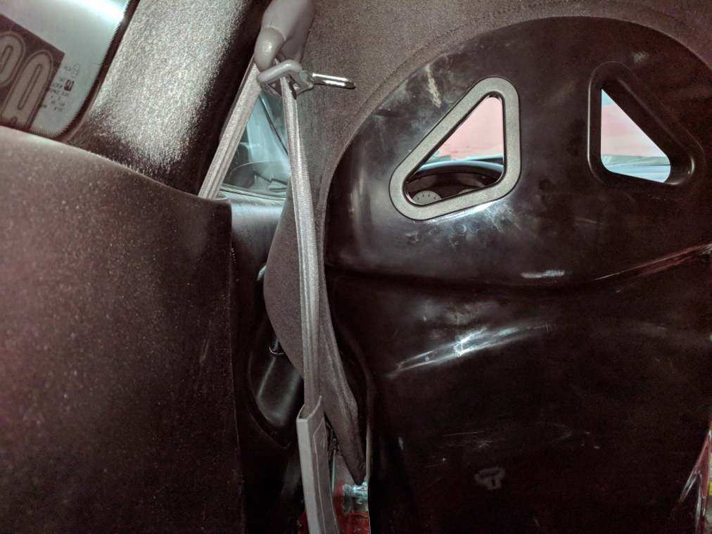

Old 08-03-2018   #385

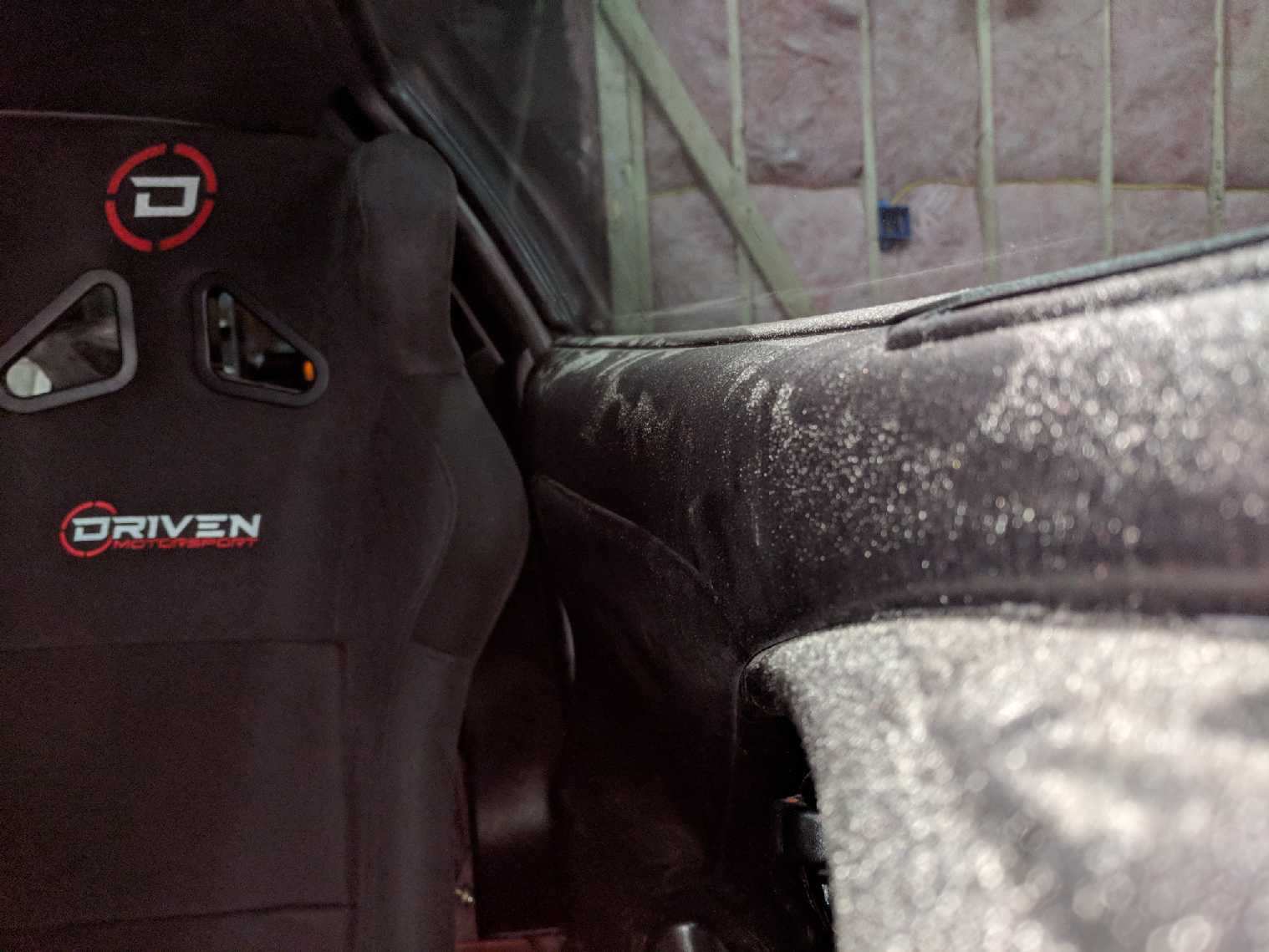

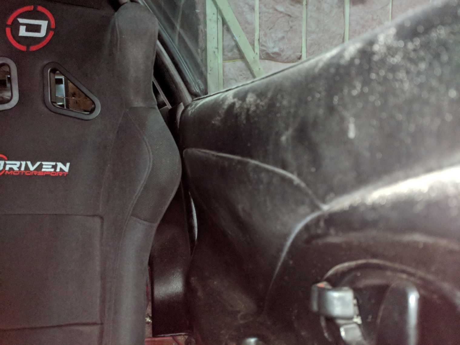

For reference the Halo section of the seat, when I remove the cushion from the seat that section runs right under my eyes when I sit in the seat. Should give me the clearance I need for being 6'4"

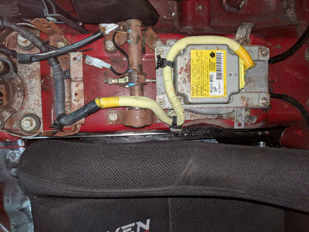

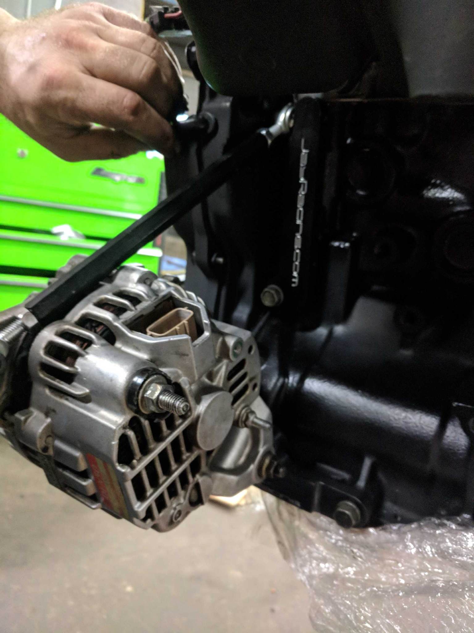

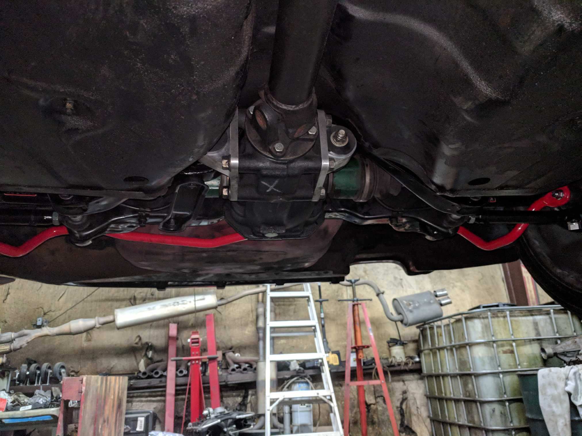

Old 08-22-2018   #386

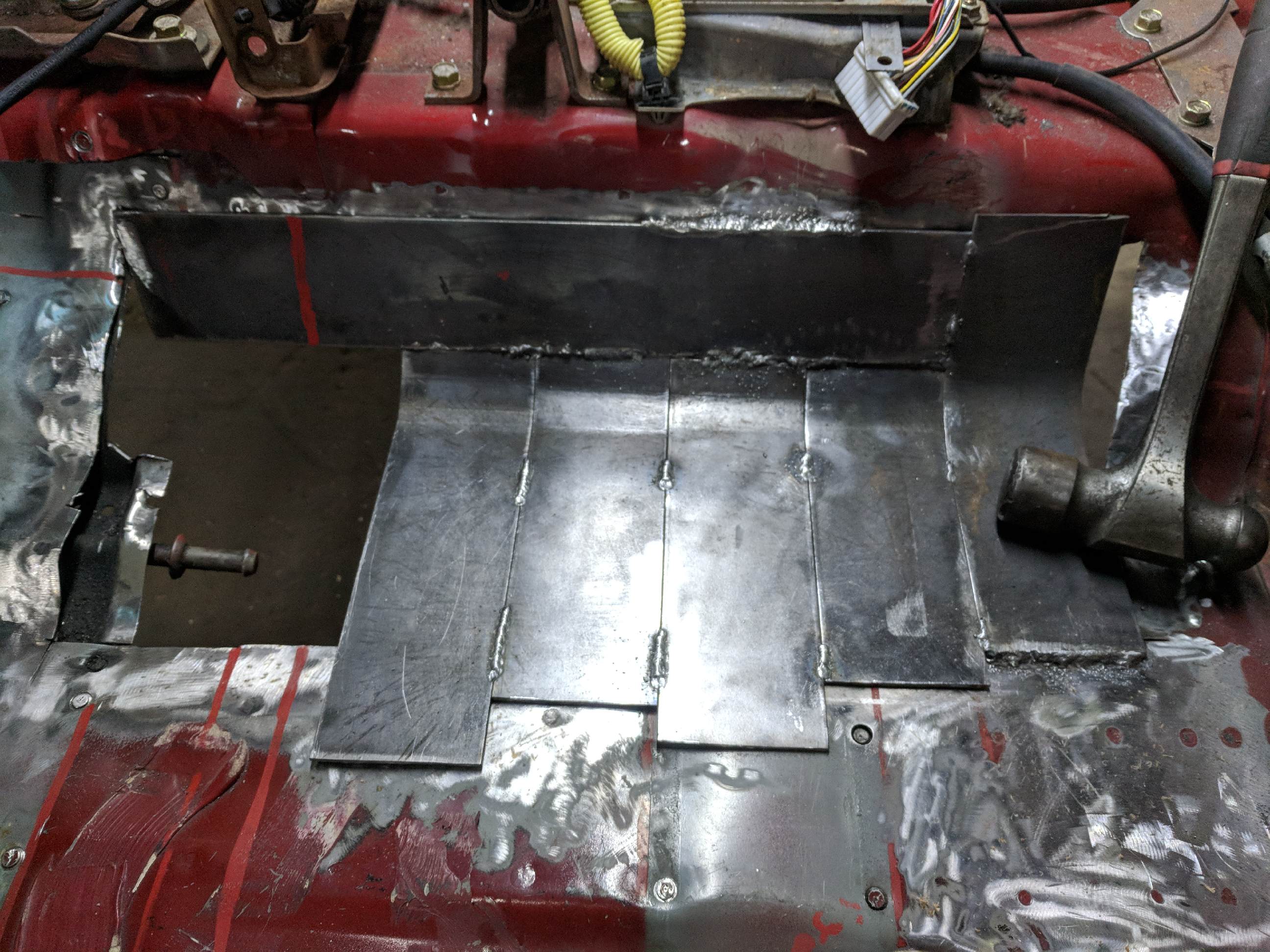

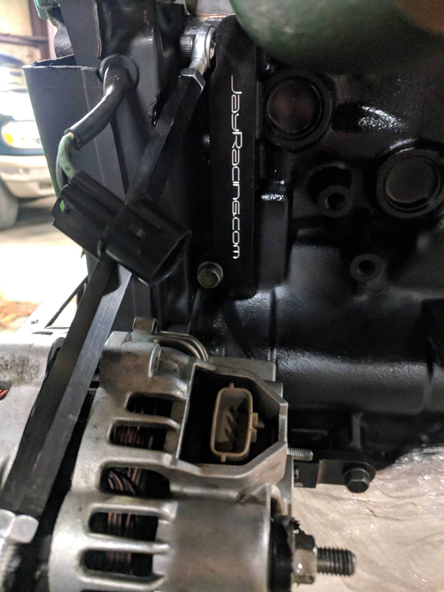

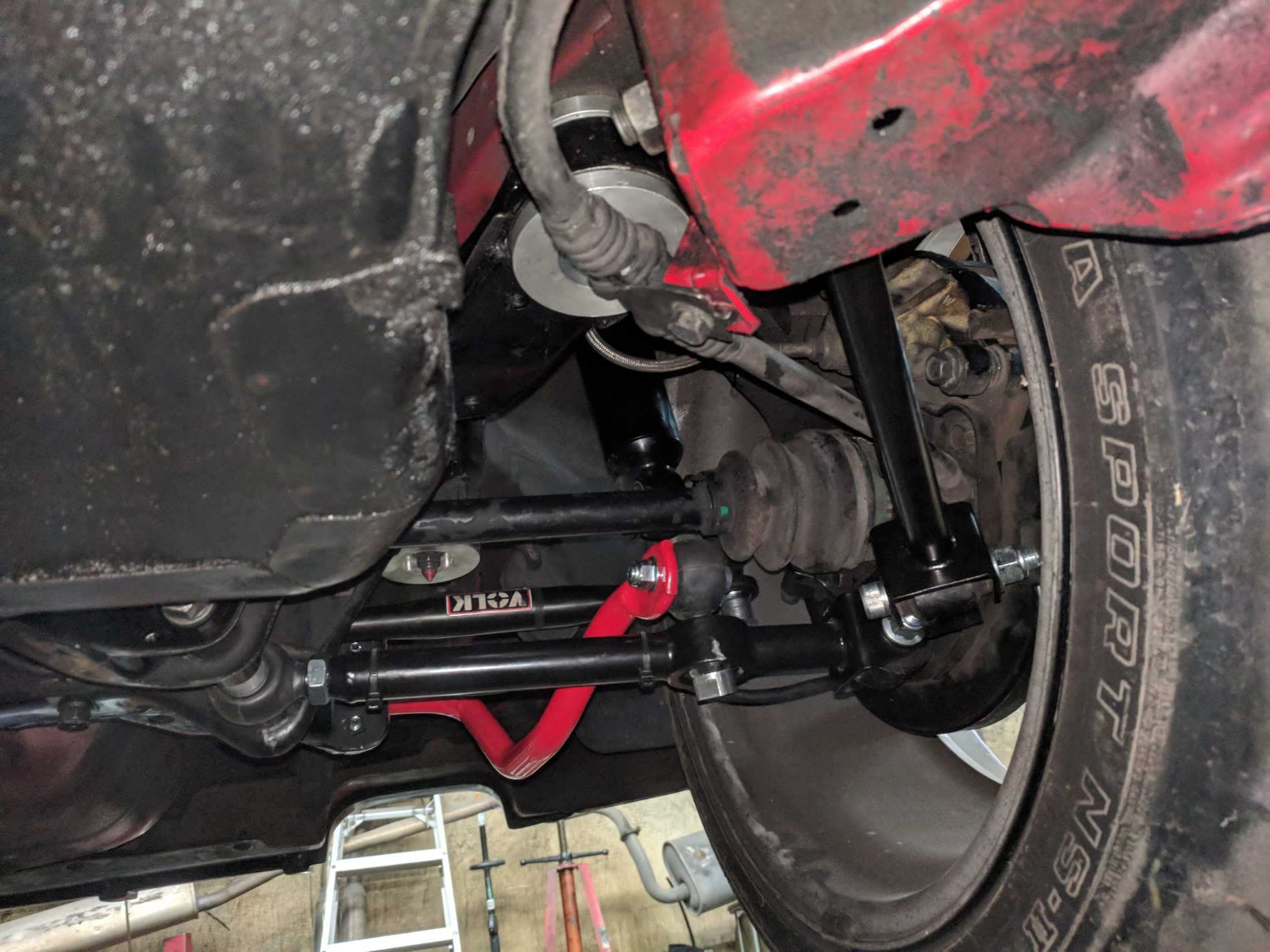

So although my car was supposed to be ready months ago. Progress is still progress I guess. Got these photos of him installing my Jay racing relocation kit. As well as pictures of my suspension and subframe bushings installed this week, and other parts finally.
However I'm worried he's chopped the hell out of my frame and may have ruined it between my fender braces and my seat mount work he did.

Old 08-22-2018   #387
You can see here he changed his mind on the way he did the seat mount. Went from one piece of metal to several. Said he had issues with the exhaust clearance with the single sheet. And now he's telling me he has to brace the seat mount becuase it flexs when you sit in the seat

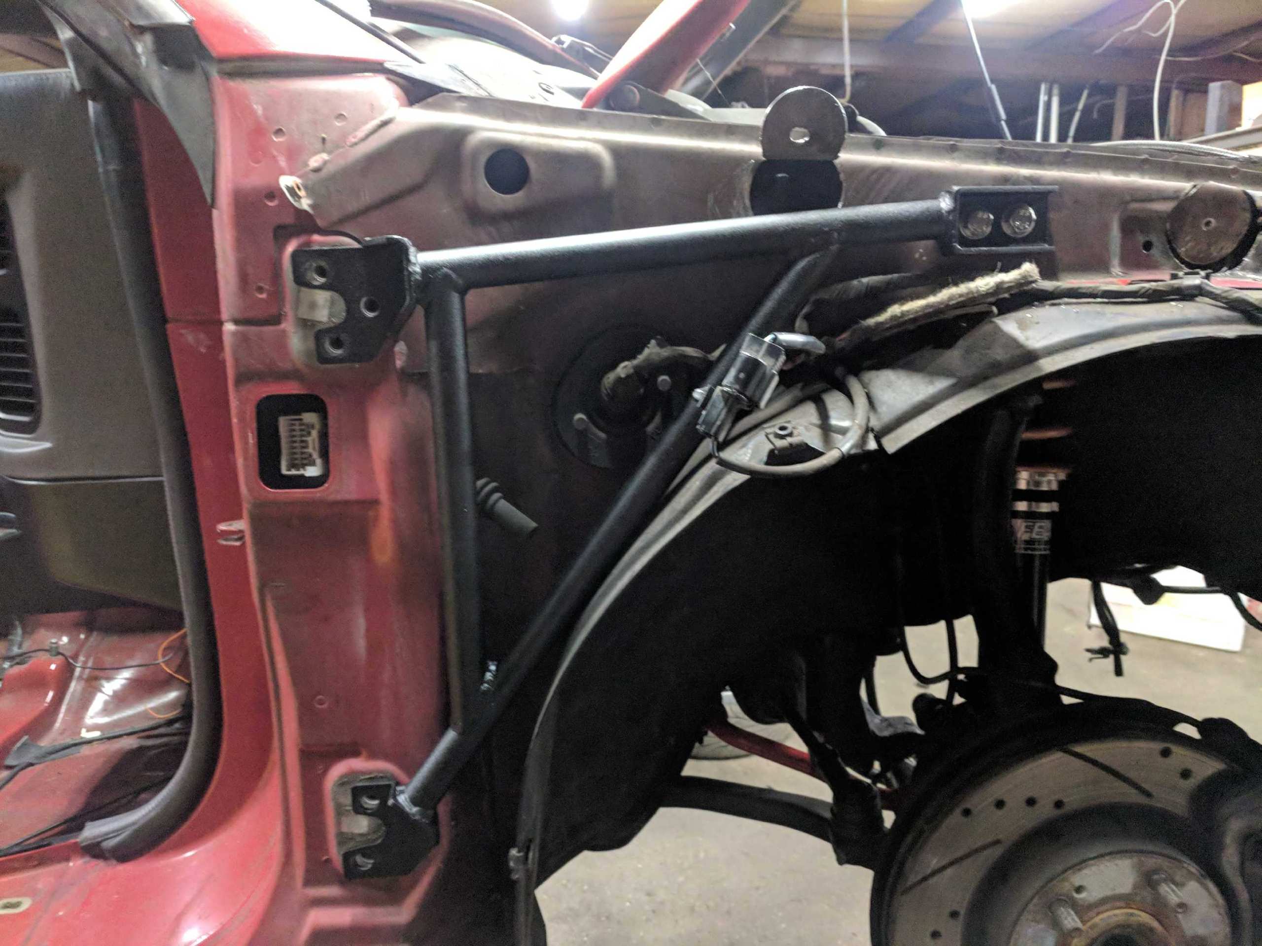

The upper rail braces don't look bad, I wonder if they are going to cause your doors to sit further out being it will have an additional layer behind the hinges? Those floor cut outs he's doing would make me a bit nervous as well.

The fender braces have been around for years. And I haven't read anything about clearance issues yet. So not to worried about that.
I am worried about the circular holes he did however rusting.

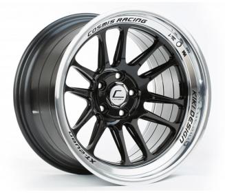

But yes I can't wait to get it back. My front upper control arms from bobbys group buy will be here monday.
I still have to decide on which rims to go with.
(Trying to stick around a 275-285 tire)
Enkie rpf1 17x10+18
Enkie rpf1 18x10.5 +15
Cosmis xt206r - 18x9.5 +10
Cosmis xt206r - 18x11 +8
Cosmis xt006r - 18x9.5 +10
Cosmis xt006r - 18x11 +8
I think the 18x11 +8 will be to wide for my fender flares but not 100% sure.
And ithe show side of me just can't seem to stop coming back to the cosmis wheels.. black with polished lip (22lbs)
The eclipse is the 18x11 but I think he has like a 245 tire or something if I remember correctly
