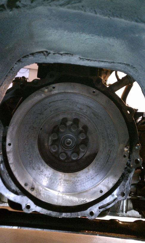

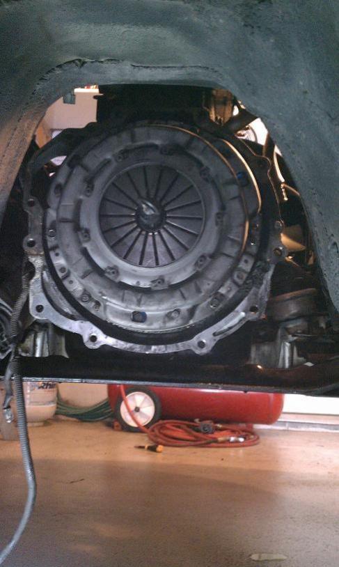

Clutch is in. Big thanks to Andy @ Elite for lending me the Clutch Allignment Tool.
That's right, 8-bolt mufukkas:
Egay 6-puck:
Stock PP back on:

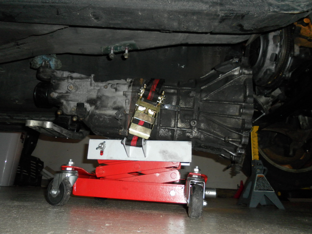

PP torqued to 14lb/ft. Tranny is back in, woo woo. Driveshaft and all that stuff is back in. Thanks for letting me borrow the tranny jack Aaron. I don't think I coulda done this job without it.

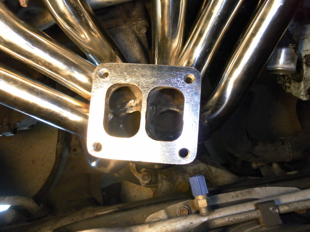

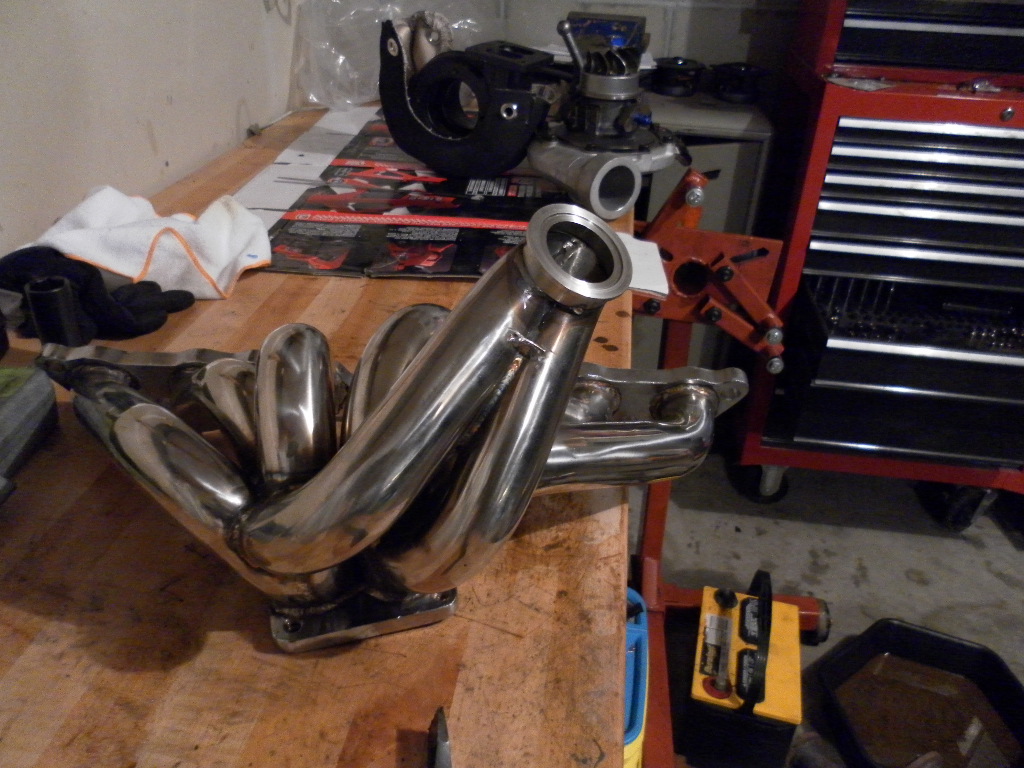

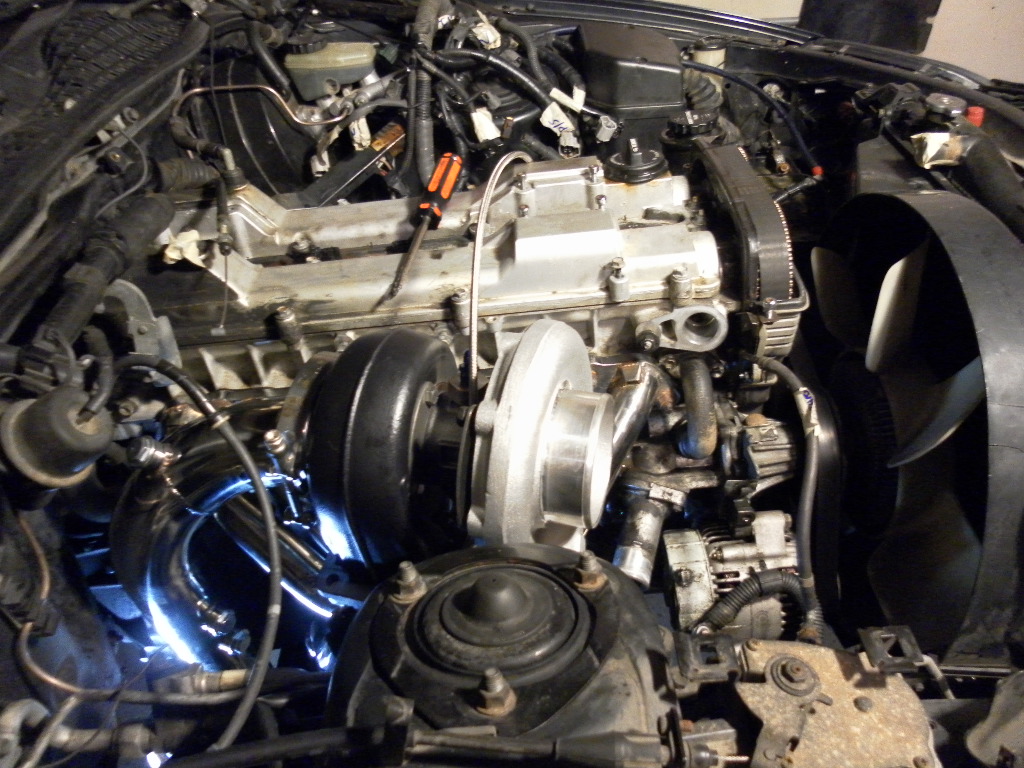

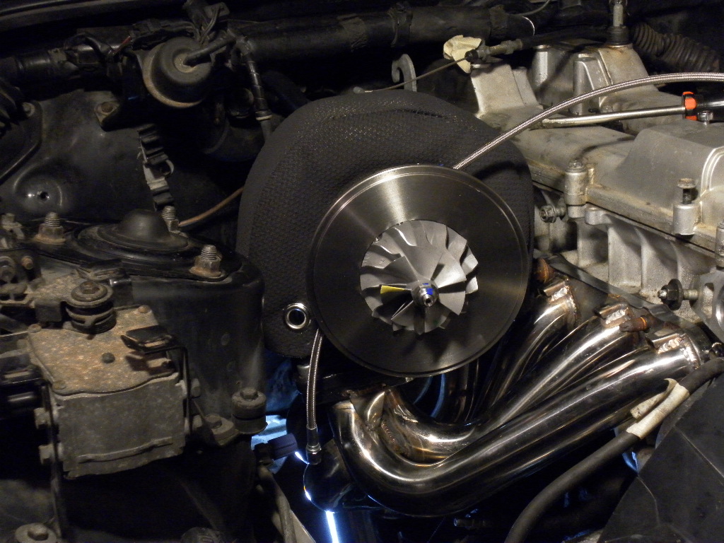

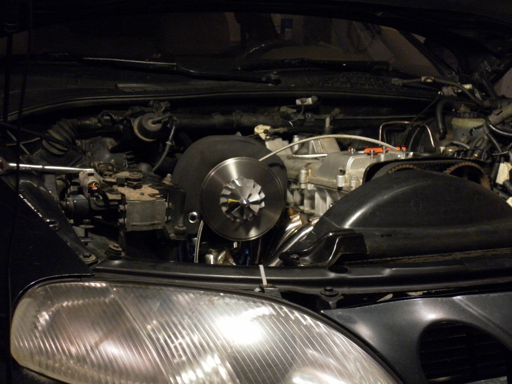

SO with that being done, what's next? Manifold. Thanks again to Andy at Elite for chopping off the old WG flange and tacking my new one in place.

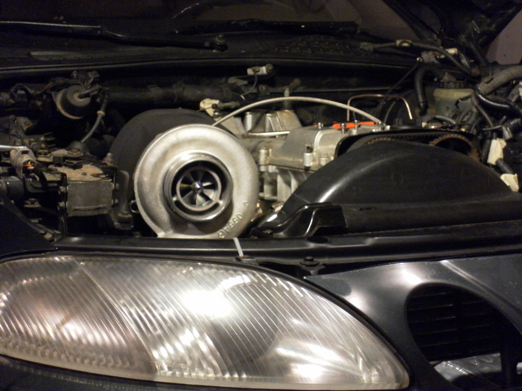

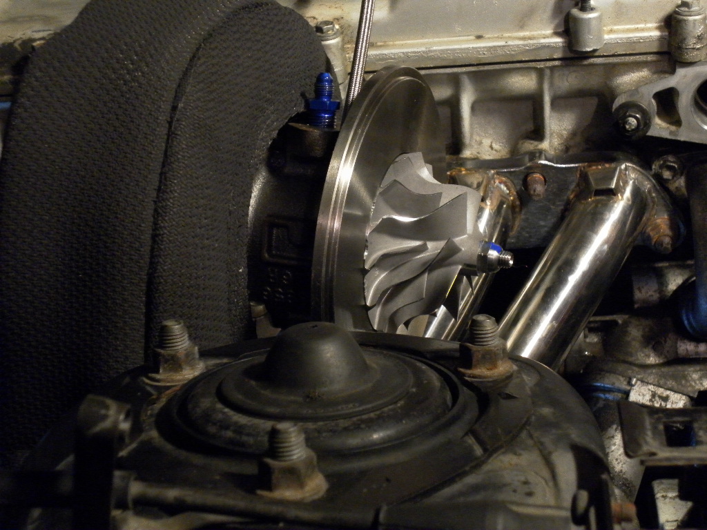

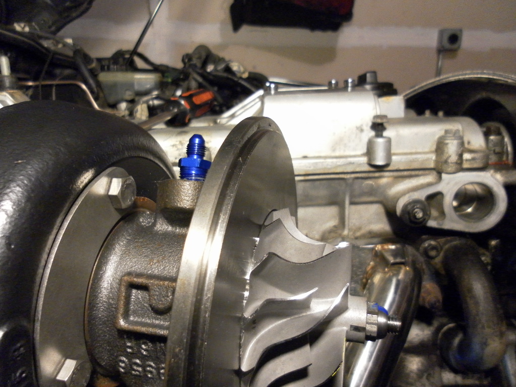

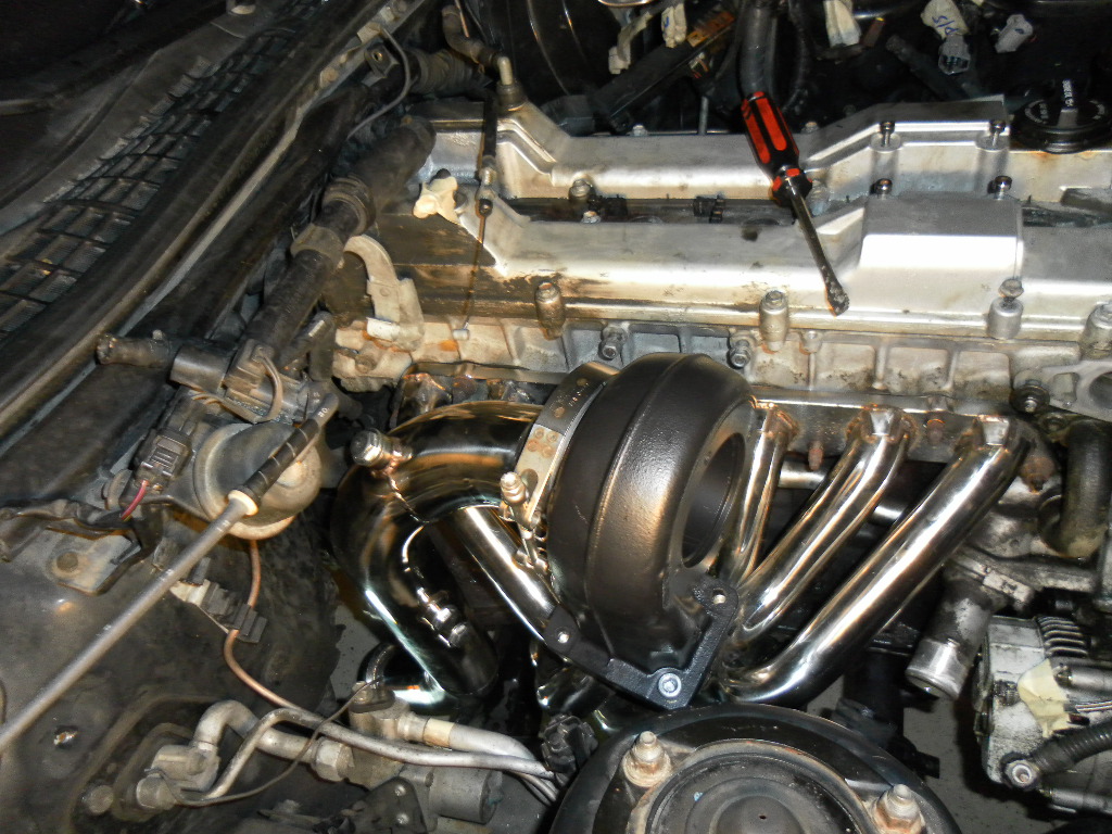

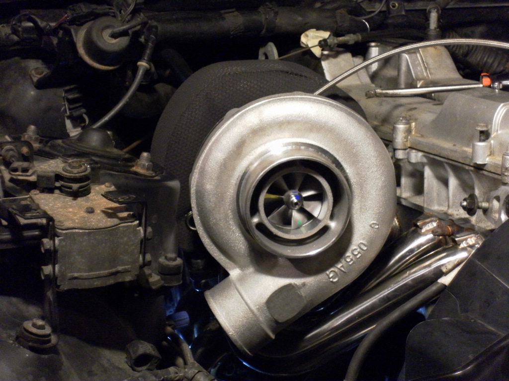

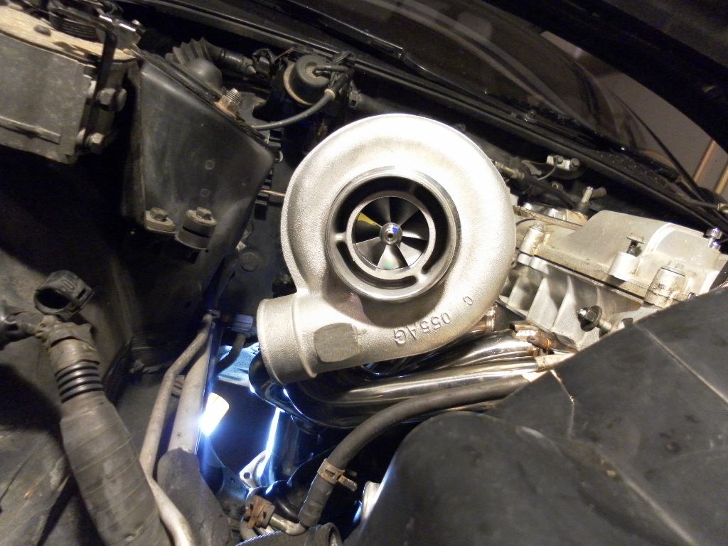

Test fitting everything up. Brand new exh. mani gaskets Going to chop the end off the comp housing and get a 90* welded on that. Mo lemme know when you got your welder all setup!!
Onto the pics!
Collector. Seen better, but seen worse. It'll do just fine for me
Exh. Housing on, and downpipe halfass installed just for me to see how it lines up.
More test fitting:
Extended Tip Son!!

Re: Project Lex
How far is the turbo from the hood? Cant tell in the photos. Looks great!
