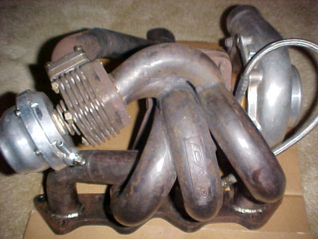

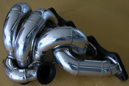

Id be worried with high back pressure on 2-3 and low back pressure on 1-4. When the wastgate is open. But like Steve said people have been running gates of the #1 cly forever. I would try to do a single setup like in these attached pics.
ID:	5251   Click image for larger version

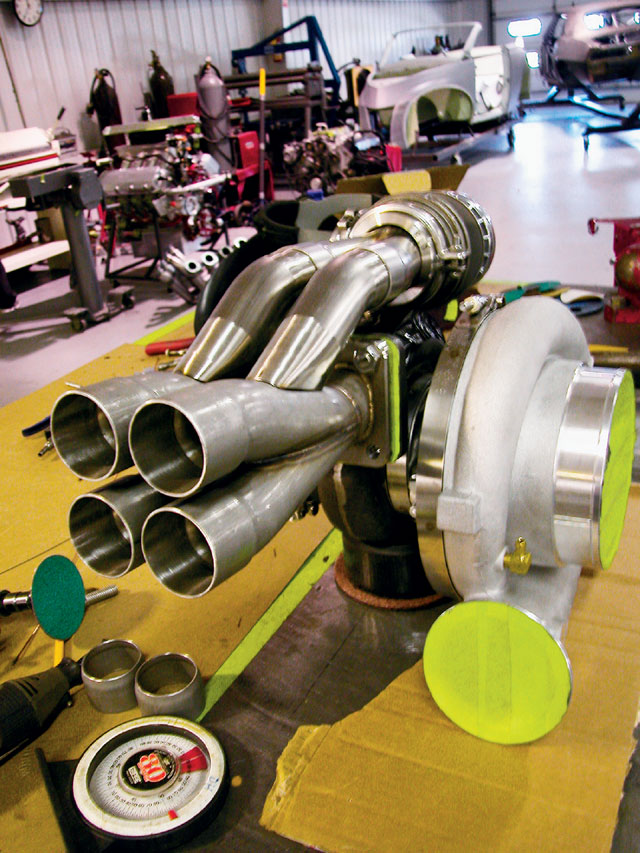

There is another way.

Goat Blower is offline
I thought of that as well. Unfortunately, that would defeat the purpse of keeping the runners separated.

Re: Finally getting stuff done on our cars
Not really unless you're running real low boost.

That was my first plan, I do have room under the turbo or under the primary runners, we will see. I would have it divided all the way to the bottom of the valve seat, which should be close enough.
