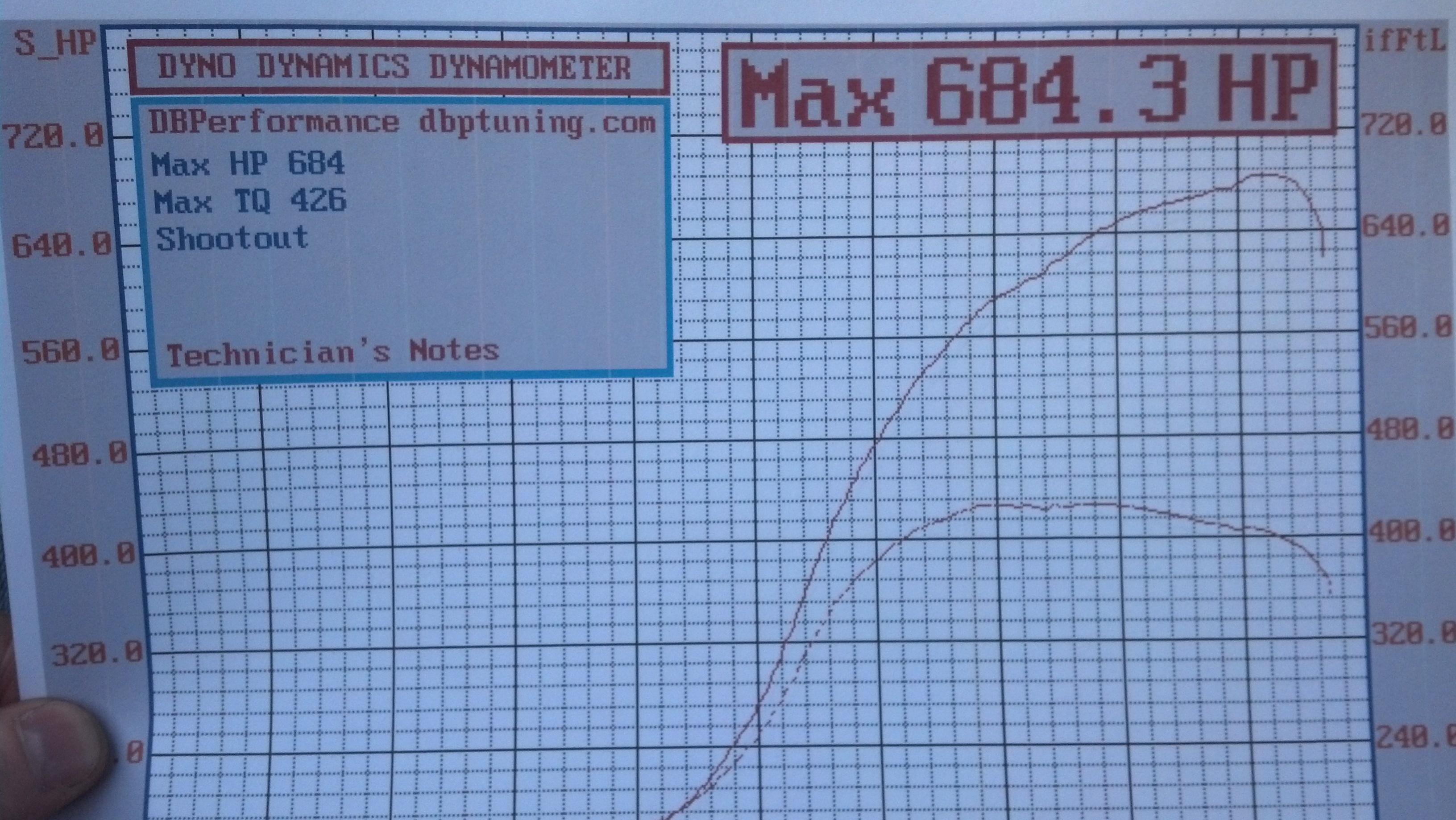

Aaaannndddd the never ending shitbox saga continues. More fuel pressure issues. We're kinda stumped. Thinking maybe it's in the tank. Idk if it's not a cheap/easy fix the car will probably sit until next year.
I might just completely redo the whole fuel system over the winter and go from there.
And a couple more crappy charts with dropping fuel pressure
ID:	13900   Click image for larger version

So i putzed with the car a little bit last night. I ran the pumps one at a time and used the pressure regulator to raise the pressure to 110psi. One of the pumps sounded good and strong at 110psi the other got so quiet you could barely hear it.
So I'm going to run the return line into a gas can and the flow for each pump at 85-90psi.
If the one pump comes up bad I still have those ford gt pumps so for testing purposes I'll see what those flow if it's close to the 255 I'll put a video camera on the fuel pressure gauge and do a couple high way pulls and see what happens
